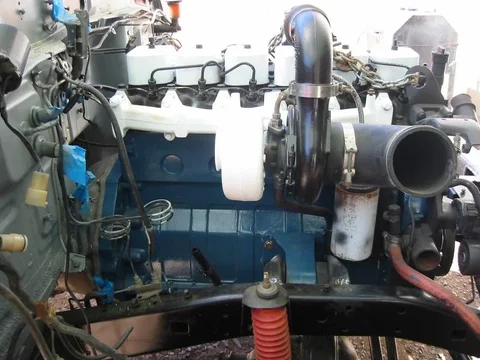

You know there was some issue still outstanding----but I was so engrossed in my new dilemma, I hadn't the patience to pay attention. Small hiccup in the plan to install the AC pump and radiator: seems I overlooked a measurement or two and being the rookie-in-training I still am.... engine placement was about 1/2in too far RIGHT and 1 in too far FWD in frame. Exit on rad didn't clear crank and AC was 1/4in to wide.
Oh well. Be about a 1/2 day's worth of cutting moving and re-welding engine mounts.

Next up was doing something about my crossover tube... out of the turbo and into the manifold. This is what I have:

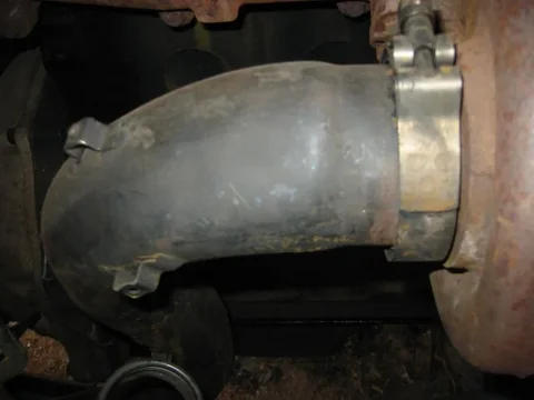

I ended up hacking up the old xover tube and just welding it to fit. Not the prettiest thing but this is to keep things moving and funds available for more important things:
With this done, I had to think about finally machining a piece to weld into the downtube going into the turbo. I'm making the whole exhaust from scratch using a few 180deg mandrel bent 3in tubes and straight pieces. So, that downtube doesn't exist yet. The downtube *end* needs to have the right grooves to match the ones currently on turbo to be able to clamp down.
Turbo end:
