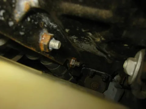

Eey Kyle---- well springs as they were always except for the hi-steer and SOA. Simple, but I think there's more to be done with the suspension... oh nothing crazy just a few things maybe to up the articulation? I'll post some pics showing where Cumminscruiser took his on the suspension side. There's a few changes he made I'll probably do. But----only do after mine drives, after all, this is a Rehabilitate because while it has a 6BT resting on its rails, the 2F simply was too badly running for my tastes or temperament. And, well, DMV---Cali was around the corner.
You know----you mentioned you have parts for all things 60----I'm trying to put this newly-welded radiator into the frame and noticed last Sunday that the darn thing has not "L" brackets on either side. Those are the ones mating to the horizontal supports-"L"s directly bolting to front panel. Any chance you have two of those? They have 4 holes for the bolts on each side of rad.
Thx Man----
Oh, and here is R-----f'r for ya.
