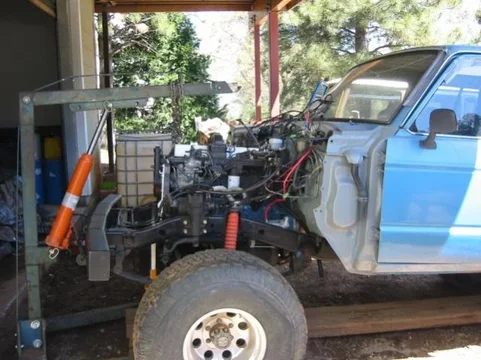

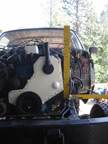

So in moving forward with progress you have to always make sure you throw in a challenge or two and go backwards once and awhile, right? Turns out since I didn't have the AC compressor when I put the engine in I was a little off in placing the engine. The distance to the right side rail was too close and the engine was too far forward to front of rig frame....

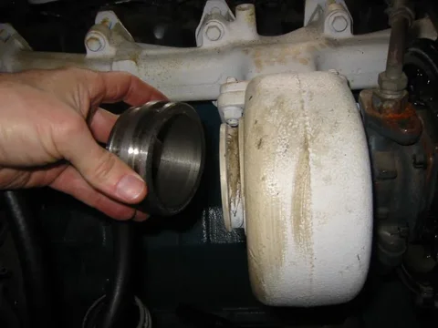

The 6BT block I have was intercooled and so the AC mounts up directly to a cast piece already bolted onto side of block on left side:

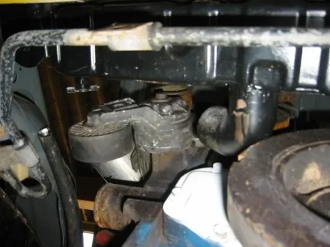

This is about as far as I could get pump in:

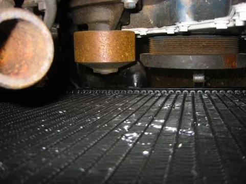

View from top of radiator as it *tries* to fit in---note the bottom exit and the crank damper:

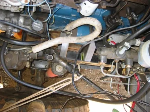

So, things as they stand is that NO WAY an intercooler possible, heck lookee here, I'm just hoping for room for the darn radiator to fit:
And, the copper tubing to route from out of the radiator exit to the inlet at based of 6BT block:

The net result is the whole engine and tranny have to move over 2-1/2in toward the DRIVER/LEFT side rail. Also, it has to move BACK at least 1in but because of how the transfer case/TC mounts, I'll be moving it back a total of 1-5/8in.

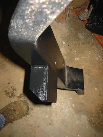

TC mount off and measuring off new hole placement. Only one (1) hole, that's nice:
Small section of "C" channel is cut and will be welded to TC mount side to extend surface for the new hole:
Net *stub* welded to existing mount and nice little cut made for what Cumminscruiser calls Esthetically Sensible People. Oh, wait, I said that.

My Warning, or really the problem was that there was no room for the radiator exit plumbing to clear the crank damper....

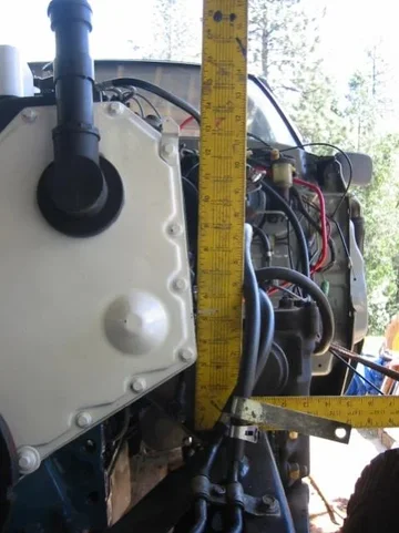

Really, just not enough room for the darn radiator :)
Also, while my vertical gap between the tie-rods and the bottom of the oil pan would have been improved once I brought some proper curve into the leaf springs....I really just need to get the engine higher with respect to the rails. I wanted the gap between the bottom timing cover and the top of steering box to be larger too.

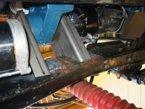

Position nailed from engine to either rail and templates made for the engine mounts. They are drawn, cut and fitted ....LEFT and RIGHT distances from rails are roughed out so AC fits .... we set the LEFT side rail mounts first and then cut to get the height/angle right.
Afterlude to a Small Regression... Some Forward Steps
Ah, yes, yes...you ask, starter... well that now becomes a "remove from bottom: down and out" sort of thing moving forward..... there's about 3/4 in gap there though
From here, get the rotation of the engine right, double-check the RIGHT side engine height and... AC gap to rail, again. Nail the LEFT side by blocking. This allows those rail mounts to be trimmed to fit the rail.
