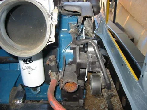

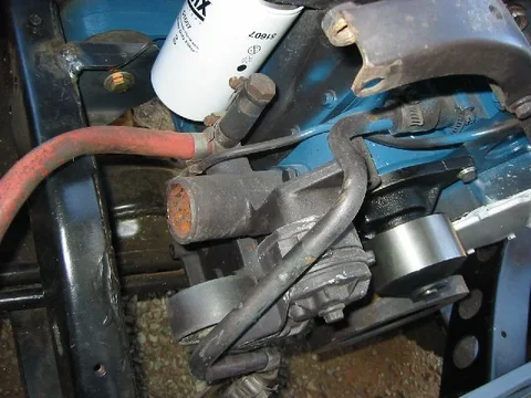

So, regarding engine color. Man, I'm opening myself up here for ridicule to no end but ....before anyone says it, yes the engine is blue. It's the paint I had and we are trying to stay on budget. Or in my case, no budget.

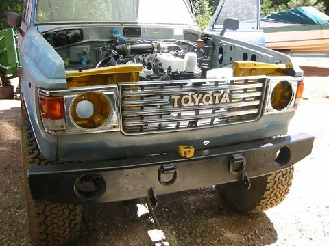

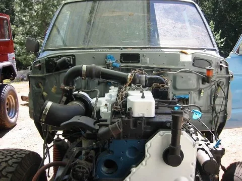

So I've rebuilt only two engines in my life and none of them were a transplant requiring custom fit-up. Check everything twice before, you know, you say "final position" and start cutting. And, welding. Can you find the problem, Houston? It's there....

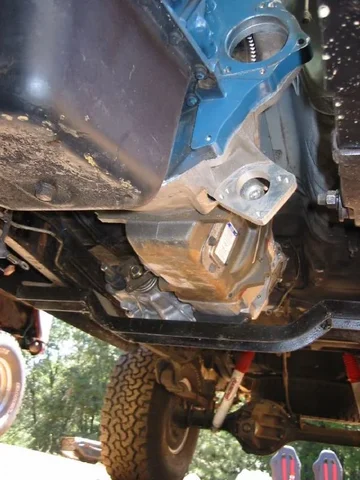

Positioning happens ABOVE the engine and, well, below it....

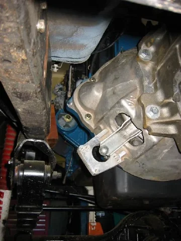

The clutch release needed to be dealt with---turns out, the Fiero clutch release cylinder is just the right force, throw and size for the, um Landcruiser. Doesn't seem right to put "Fiero" and "Landcruiser" in same sentence much less the same vehicle, but there it is....
Detail from below of bell-housing and clutch arm. That part should have gone in today, but Fate stepped in and, well, you gotta roll with these kind of little things...
Small detail of tranny/txfr case support
And txfr case there
