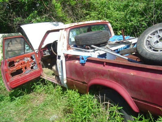

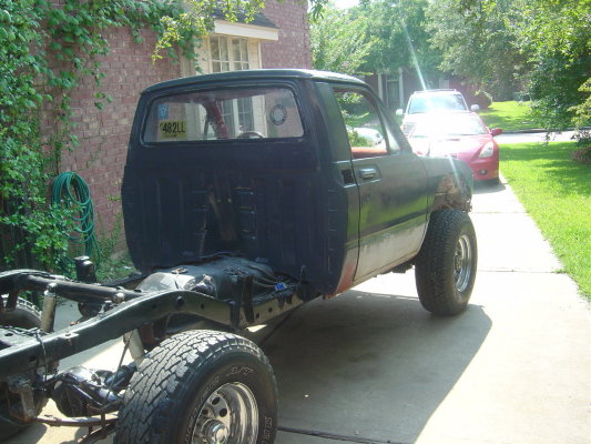

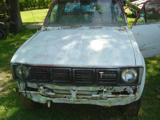

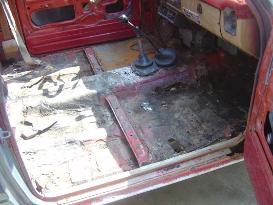

Well anyways I'm 17 and wanted to have a reliable daily driver and a trail rig I can have lots of fun with. I live in Houston(lots of mud) so Rock Crawling is rare but that's the type of rig I'm aiming for because I'm very inspired by everyone's builds. I waited a year trying to find deals on toyota trucks and none came up so some guy called me up saying he has an 80 4x4 Pickup with the windshield not glued and no rust so I rush over there and this is what I come to.

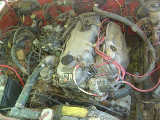

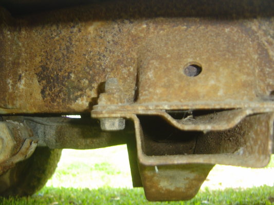

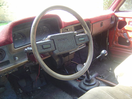

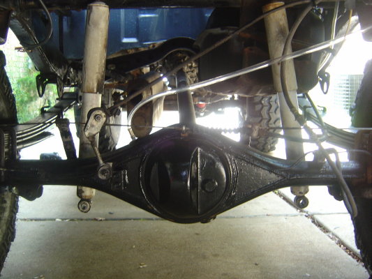

I swear this is the best I could find, the guy said the motor was good. I got it home, stripped the interior and Carpet and damn, I have a mexican stop sign as a floorboard, I pop the hood and it's filled witht a bunch of Mexican half ass ****. At this point I'm starting to regret, but Hey at least the frame was solid. I took out the Bed because it had a 3 foot rust hole in the middle of it, Sandblasted the middle to back part of the frame and coated it with POR 15, shortened the frame, painted the rear axle. I cleaned the starter contacts in the ignition because it wouldn't start and it started but the Carb was totally ****ed. So i rebuilt ti and the motor runs great and doesn't have a single leak. Wow something good for a change. It overheats so I changed the thermostat and instant fix. I had just recently got some 31' all terrains with some nice looking rims(I needed something to hold the truck up, it doesn't even have hald the wheels holding air. I have cut the flares, welded up the new floorboards, and welded in new sheet metal on the body. Right now it's being painted by me so pics are to come soon.

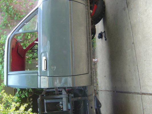

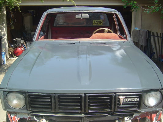

I'll have pics up tomorrow when I get my paint job done.
Hopefully you are keeping the same color. Terra Cotta is an awesome. You can hardly tell it's dirty. Maybe with a truckload of TLC, your truck will look like mine one day. (Before you make it a rock crawlin machine that is.) Good Luck!:cheers:
Nice truck man congrats, unfortunately I don't have that color because mexians rattlecanned it white, but I chose to paint it a dark gray.

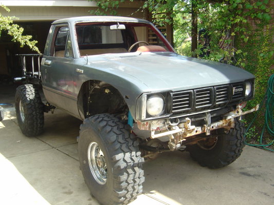

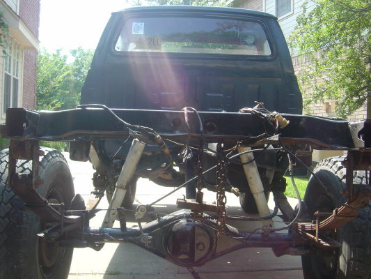

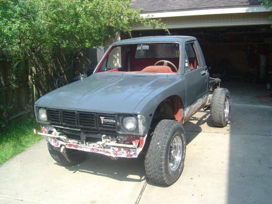

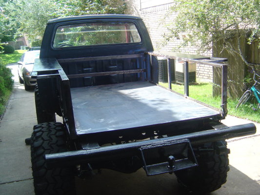

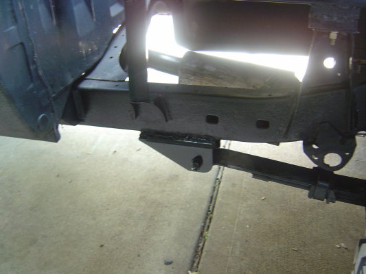

Well after doing a ton of work this suwmmer I have the truck almost built up. Steel prices are way too high, and tires.
Stupid houston, can't find anywhere to flex

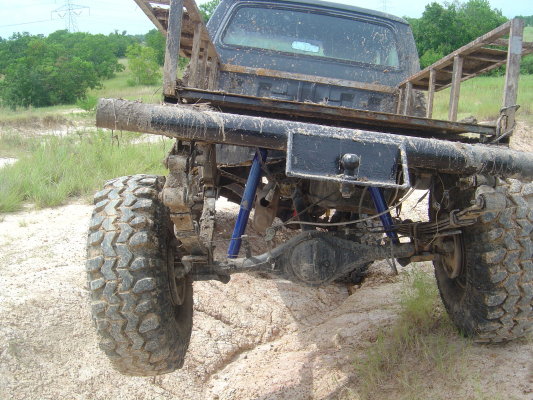

Must make front bumper/winch mount, any ideas, examples?
20, 11 gauge tube and 11 gauge center sheet, it's tough. But not finished
GOt a pretty much new pair for 100, fronts cost me 400
Love the stance but want to go 2" spacers all around, safe?

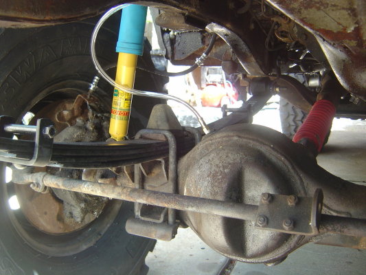

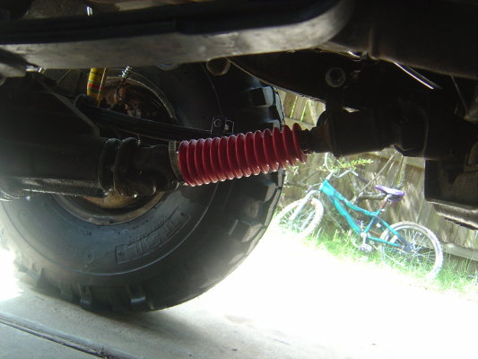

300zx lines and diff breathers
This short thang fell out on me on flex so going with " stretch and trailgear shaft
I realized the neediness of shocks on the steets, scary stuff, also pulls hard when braking randomly

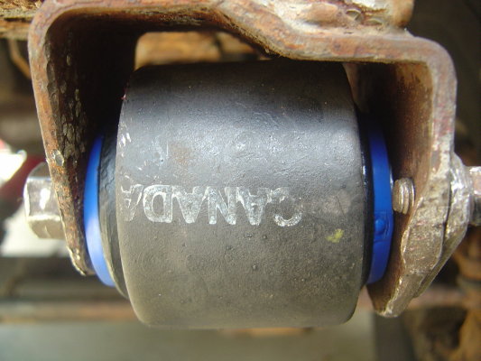

63" chevys

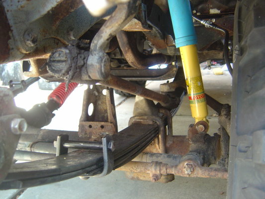

2" YJ BDS springs( lifetime warranty)
Toyota Bilsteins

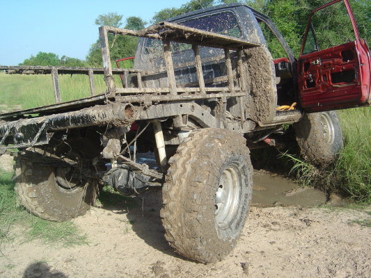

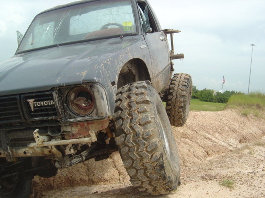

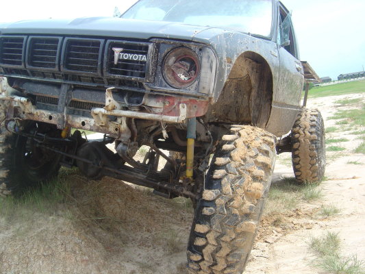

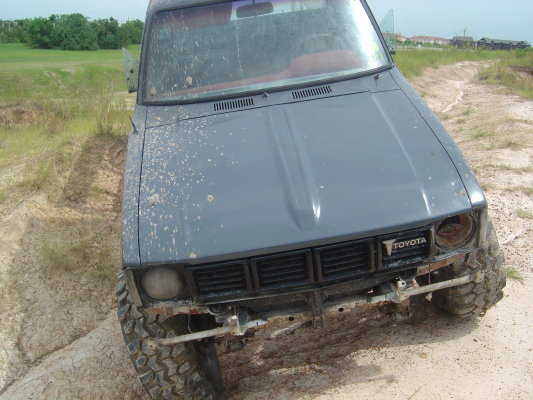

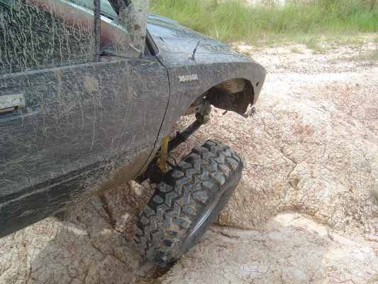

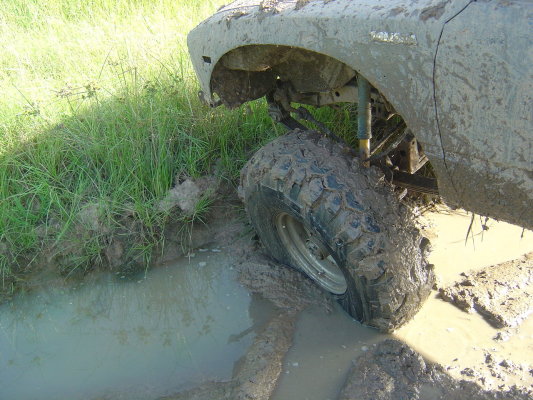

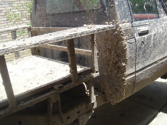

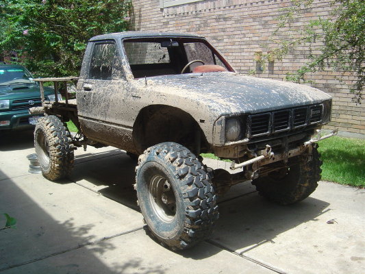

Just some wheeling pics.
I need to make new shock mounts, do a 1" wheelbase stretch because I messed up my fenderwells by warping them a bit Nothing a hammer can't fix. I snapped I cracked the outer part of my front driveshaft where the splines meet, so sq. shaft here I come. Overall the truck does pretty good except that whole steering 36's with your bare hands.
