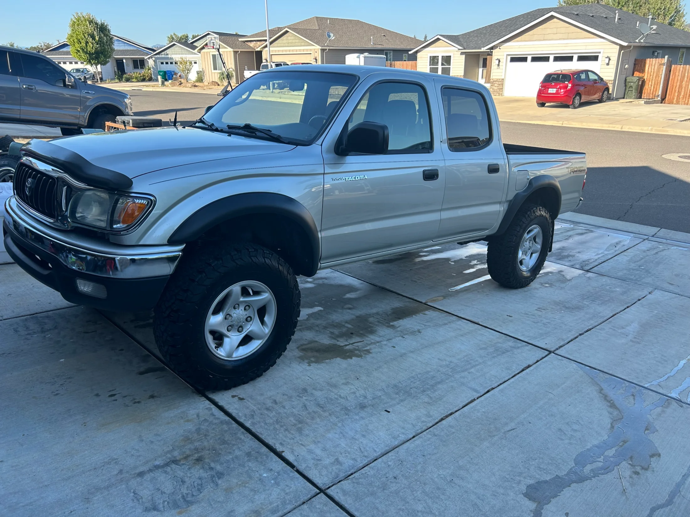

Build another one just different. I picked up
A very clean 2004 double cab. .

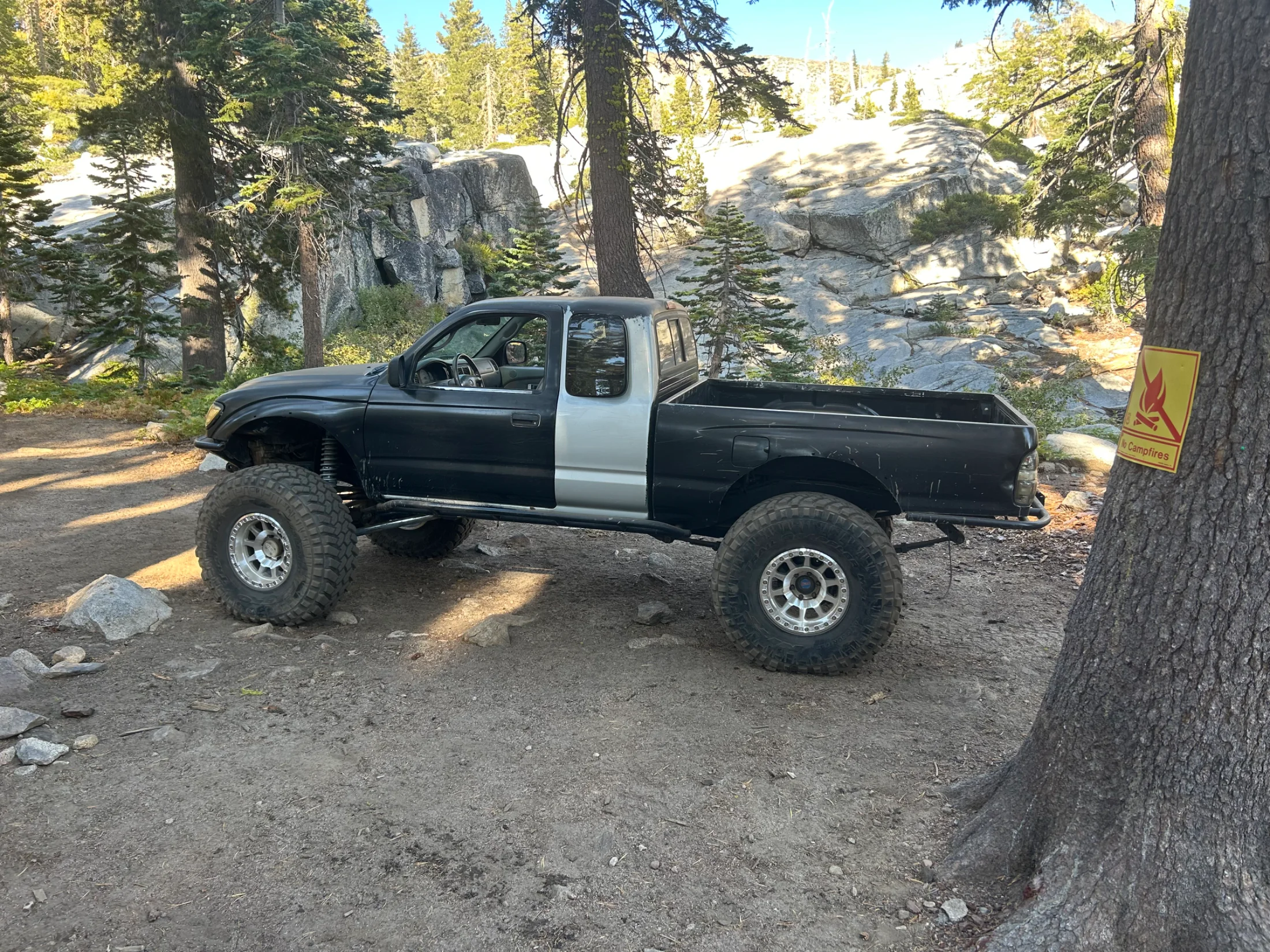

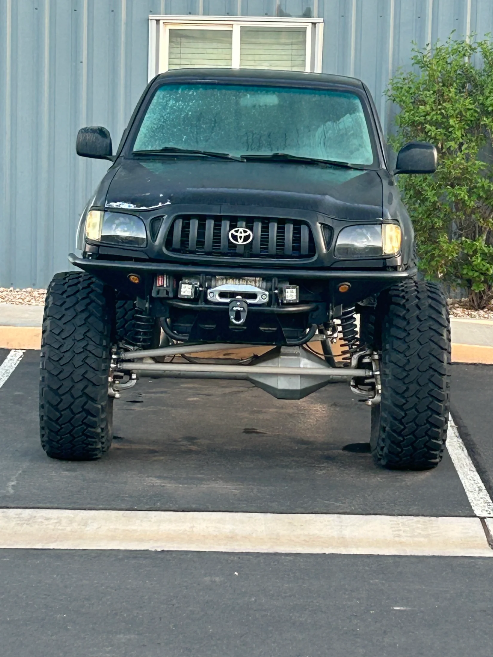

I then found this 2002 that had A lot of great parts . After crunching some number . I jumped in my car and drove 14 hours to get it . For what I paid I could not get the parts that it had . It has 609 axles with a hi pinion front . ARB lockers front and rear with wilwood brakes . It has duell Marlin cases with the 4.7 gears . Brand new Battle Born. Beadlocks. And 40 in Nitto tires . The front is 3 link with an All pro kit. 14 inch fox 2.5 coilovers with dcs . All pro bumpers and a warn winch . I figured I could give that to a homeless 🤷‍♂️. And a switch pro. That controls all the add ons . The interior is clean and the body is in good shape. Someone just painted it black . They painted right over the stickers and everything 🤦🏻‍♂️. . The truck is actually a pretty nice truck
On my way home I got invited to run Barrett lake train 🤔. At that point I had just driven about 23 hours straight. I literally drove down loaded the truck and was driving back. . Anyways I thought sure why not . I stopped filled up
The gas tank and off we went 😀. At that point I knew nothing about the truck. I was not even really sure how the lockers worked since I had not even touched the switch pro . I did plug in the winch controller just to see if it worked and it did nothing 🤷‍♂️🤔. . O well I will worry about that latter off we go . I have never done the Barrett trail so I really did not know what to expect 🤷‍♂️. What could happen lol on a trail I know nothing about in a truck I know nothing about and I have been up for a few days now 😄. At the gatekeeper there was a couple jeeps having a heck of a time . Once they got through. I cruised right through. 👍. Ok this thing is kinda fun . Let’s go 😀. We made it to a section that has a buggy line and I figured why not 🤷‍♂️. Put it in low low and away we went. . It went through with zero hesitation. At that point I was feeling confident. I kept messing with the switch pro as we were driving and I figured out the lockers as well . I did notice that the compressor would cycle often so I figured I had a leak somewhere 🤷‍♂️. . We made it to a section the call the S Turn And there was a group of really nicely built Toyotas there. They were winching a 80 up . Then a very nice 2nd gen Tacoma on 40 gave it a shot and was struggling 🤔. He ended up winching as well . I then pressed more buttons lol and drove up without even spinning a tire 🤩. After that the Toyota group had to come look at what I was driving haha. 🤷‍♂️. . That night at camp I kinda messed with the winch a little more to see if I could figure it out but no luck . I was not sure if they had some switch on it to disable it or what . My only complaint at this point is the steering seemed to get harder through out the day . I checked the fluid that night and I was a little low. So we topped it off and kinda gave the truck a good visual inspection . The next morning we headed out. And the steering seemed to be a little better and I literally was putting tires on the biggest rocks or hardest lines I could. Just so I could get a feel for what this truck can do . . Things I noticed. It is very quiet. I actually had the radio on . And the gas gauge. 2 days of wheeling and I only burned 1/4 tank this can’t be real 🤔🤷‍♂️. . We made it out with zero issues. And loaded up

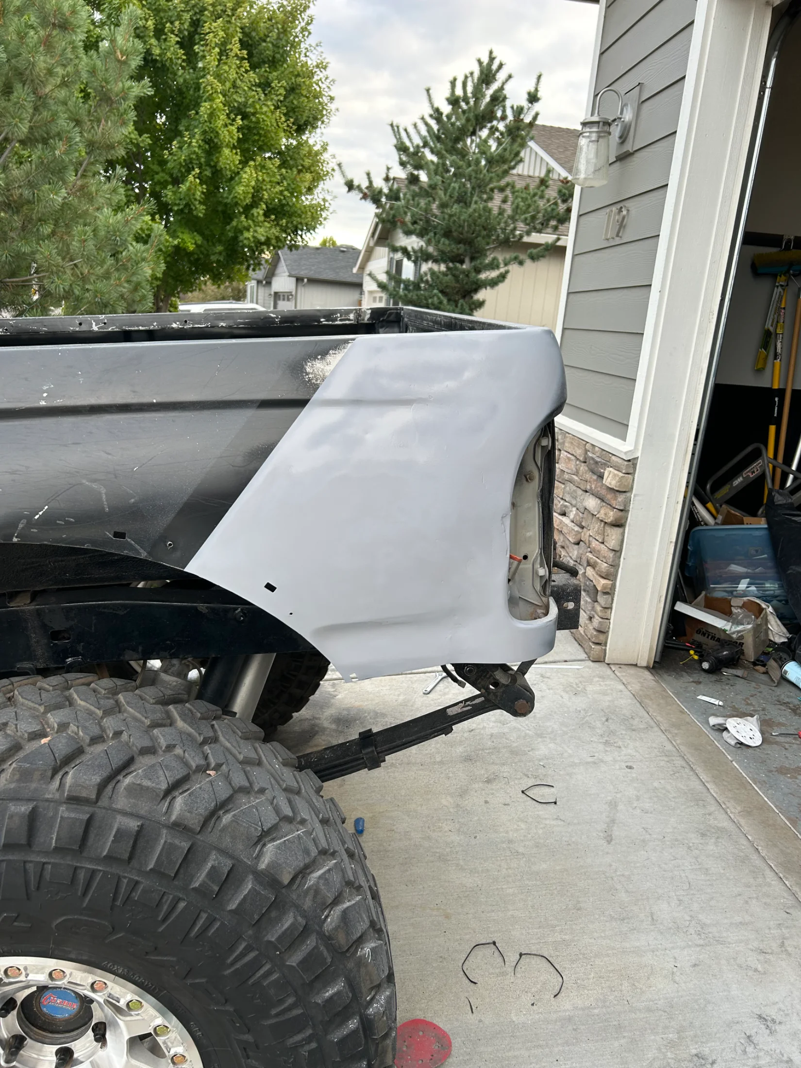

Once I got home I started thinking 🤔. Maybe just keep the Ex cab for more extreme wheeling as it won’t bother me if it gets a scratch or dig. Just have fun with it. . Then build up

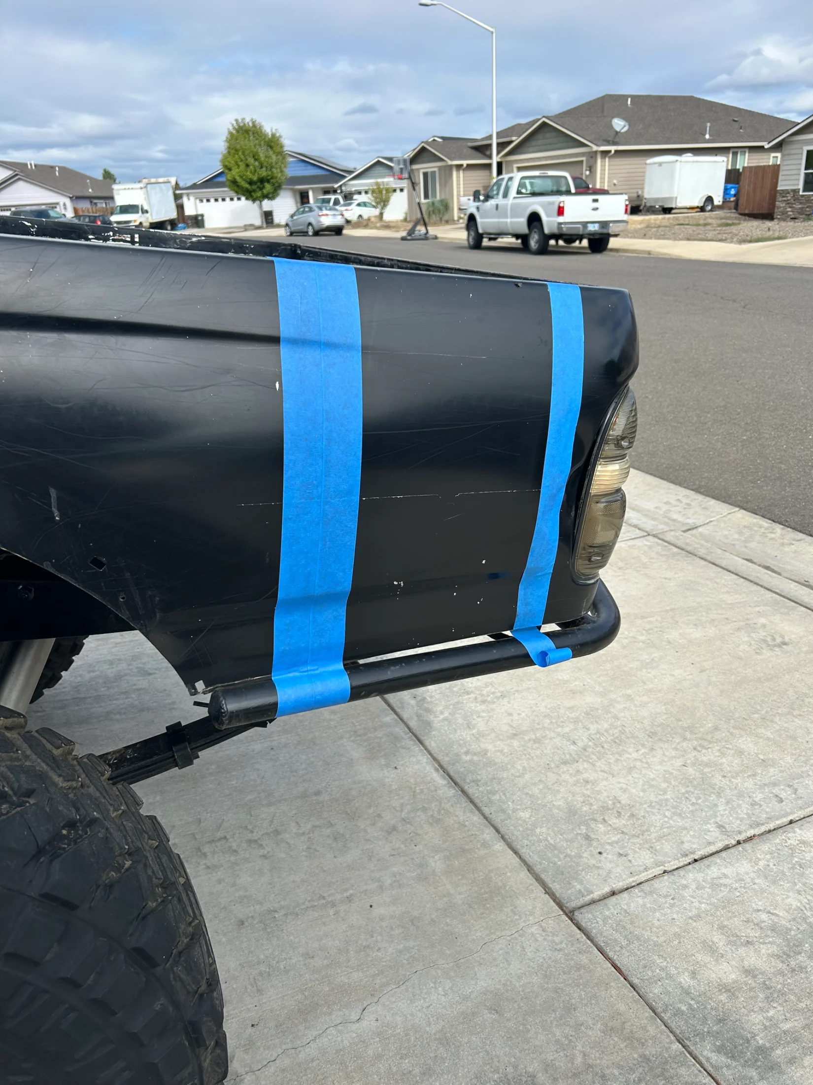

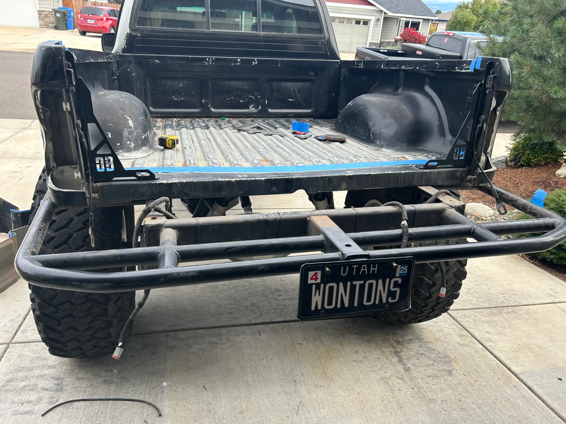

The double cab. And take my time and make it really nice . . I then started making it mine . First thing was I cut 12 inches out of the bed

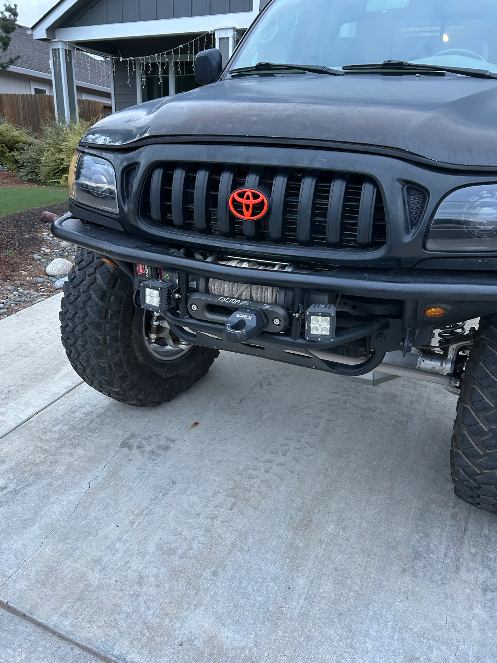

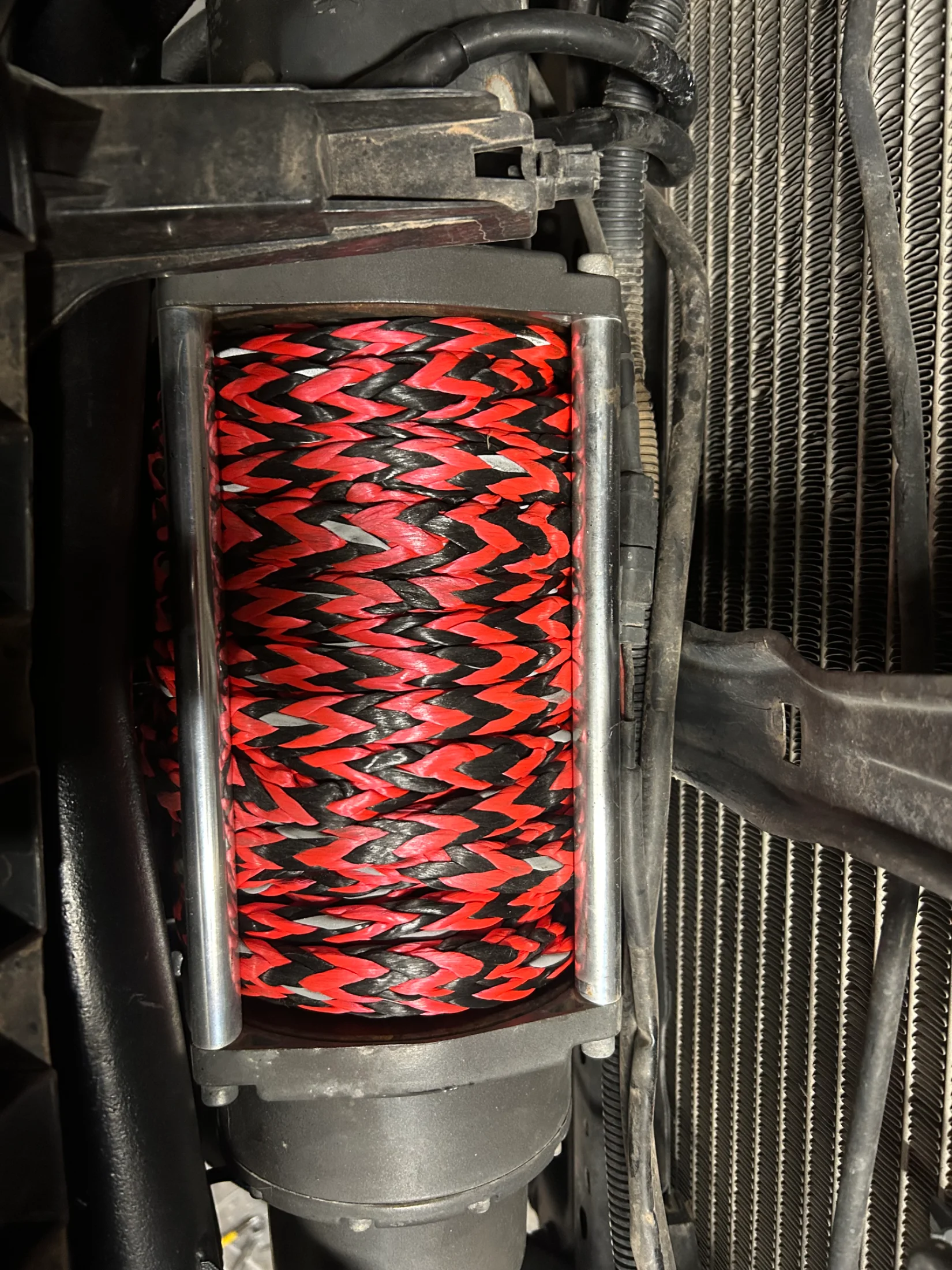

I was going to pull the Warn winch off and give it away. But I figured I would see what was going on first . I could jump
It and it would work so I ordered a new contactor. After installing that still nothing. Then I found 1 of the contacts that the winch control
Plugs into was missing 🤷‍♂️ I fixed that and everything works fine . I could stomach a warn winch but I could not live with the badlands fairlead 🤮. So I got a factor 55 And a new winch line .

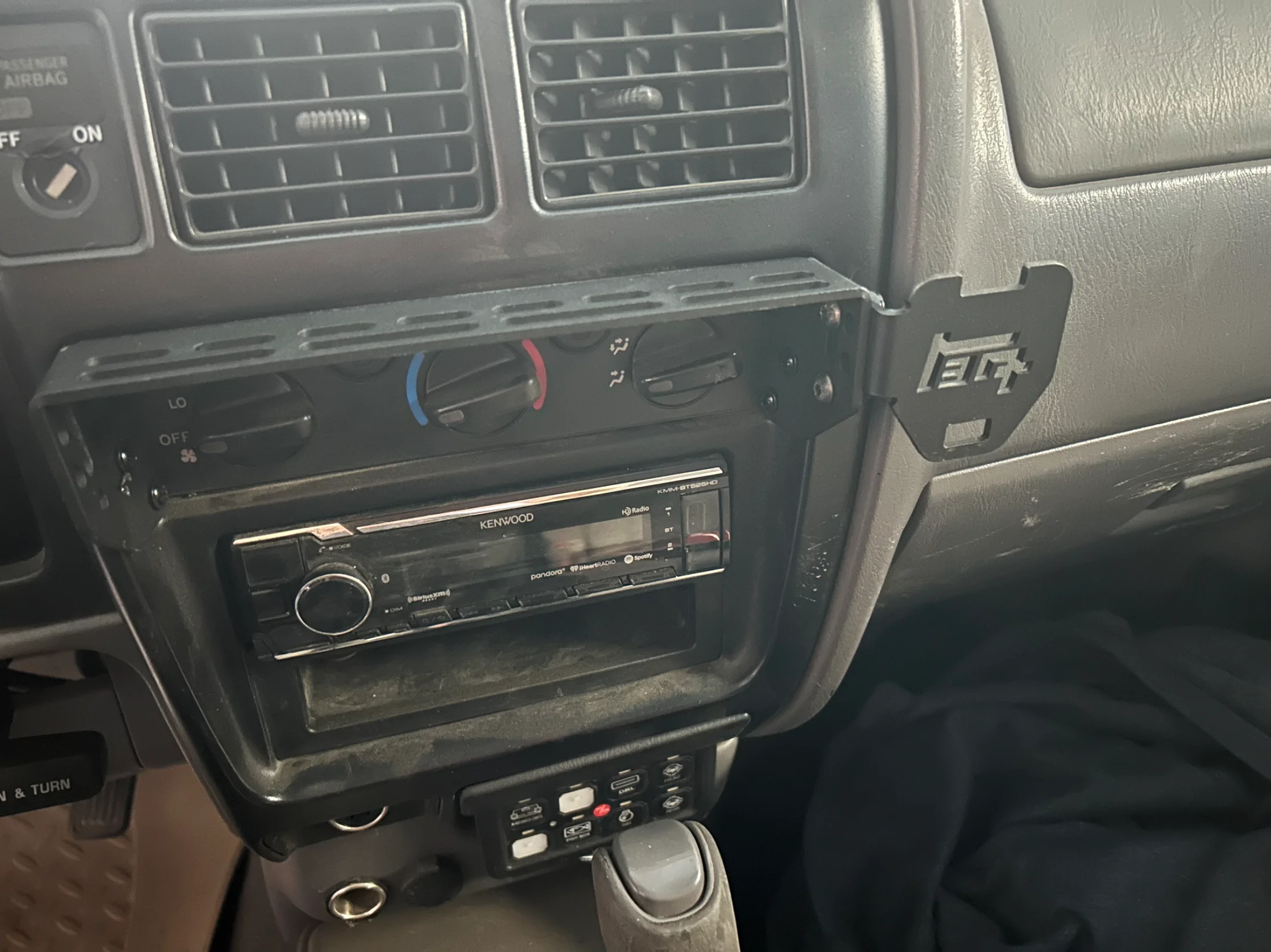

I had ordered these TEQ mounts. For the double cab but figured why not since I will be using this for now

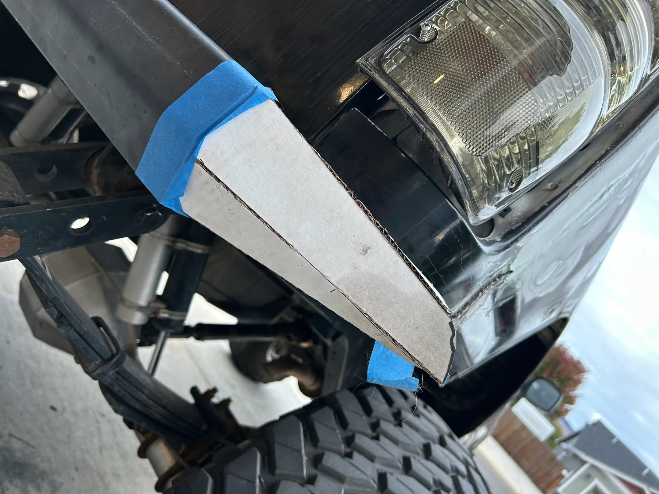

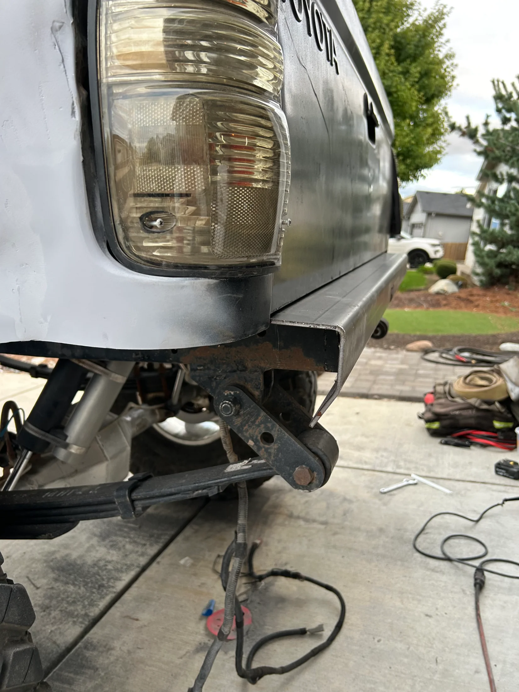

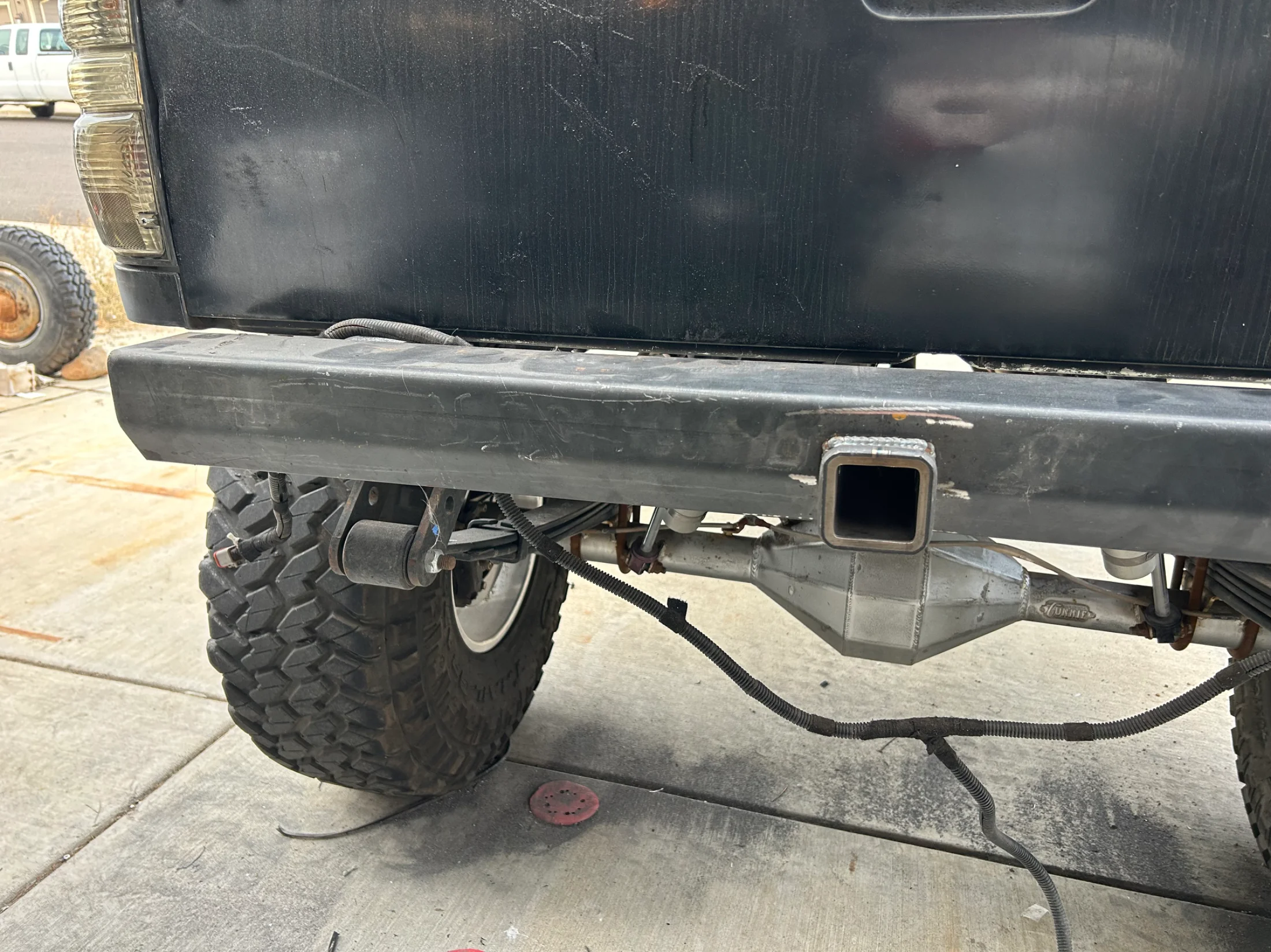

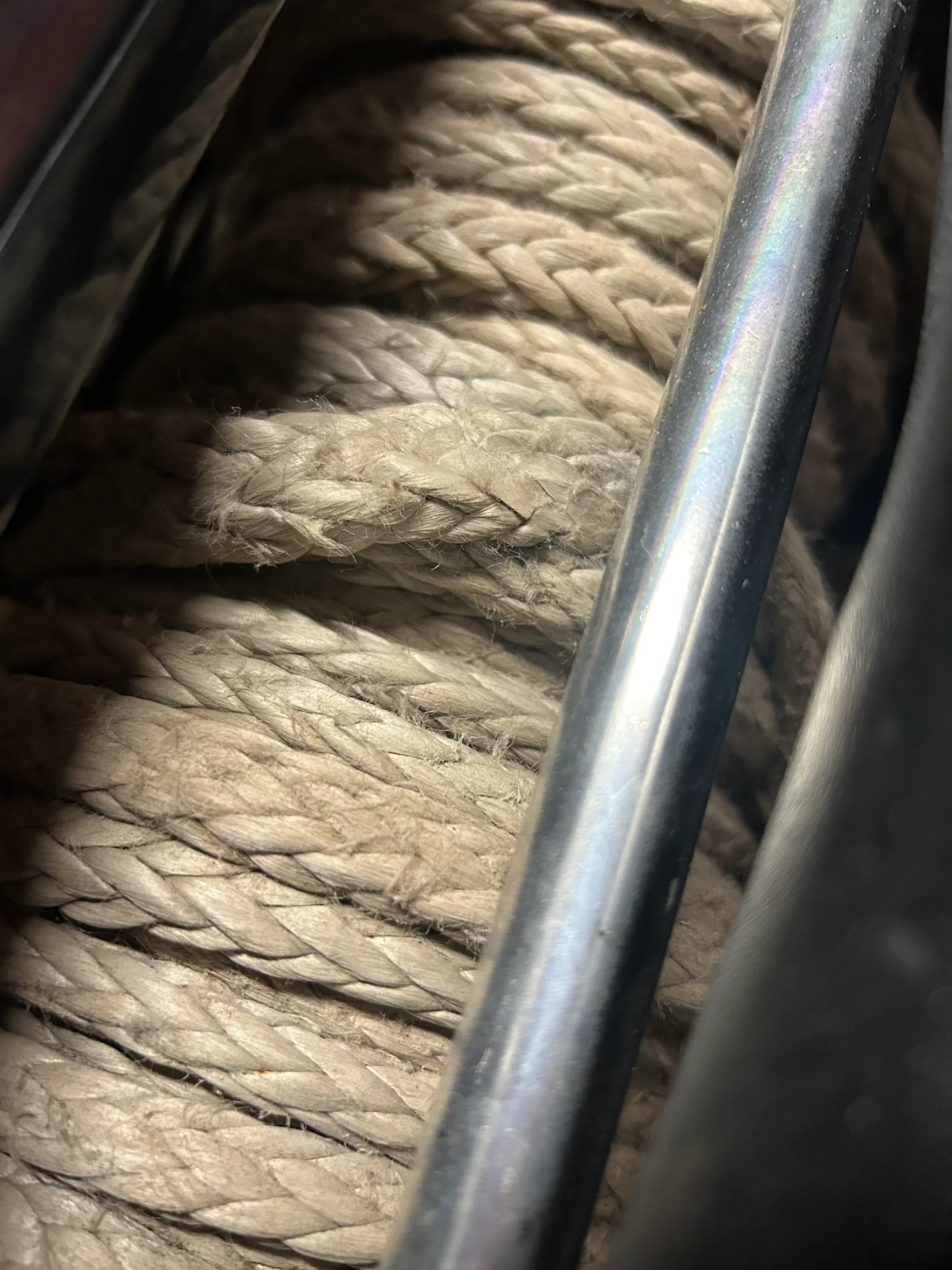

Oh I also started getting making a new rear bumper. I had started on this a while ago. For the FJ but never finished it
Kinda the look I am going for . Just a few ideas
I also added the Air up Kit to the ARB compressor and i ordered a new Pan hard bar that is longer , When i have that in hand i will cut off the old mount and install the new mount . I think i will get some new PRP seats
