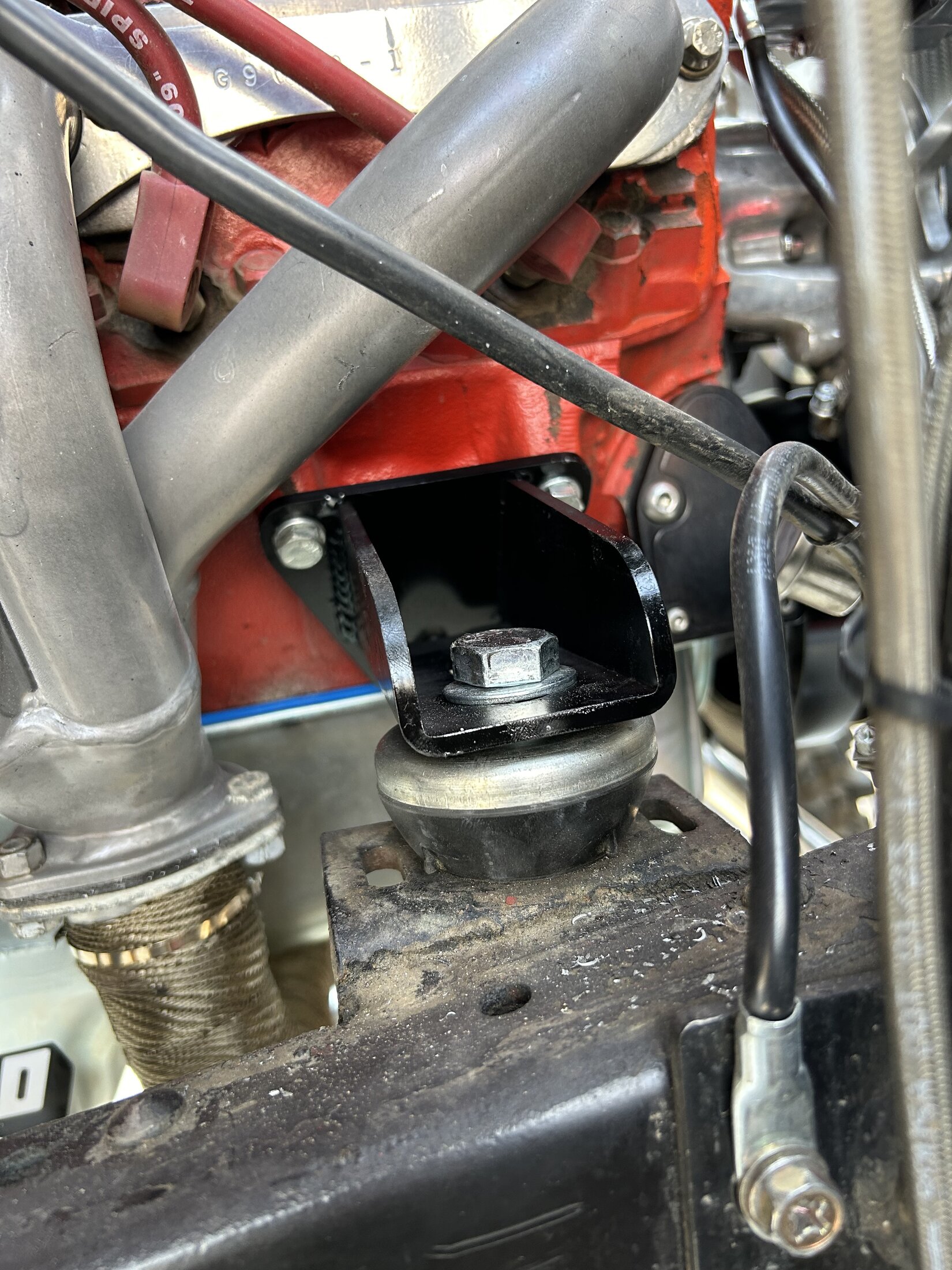

So my 40 had a clunk when I would put it in reverse. It’s been this way for over a year. And I have never been able to find it . Today I figured it was time to change out the motor mounts to the ones that I originally bought . ( I honestly do not remember why I didn’t put them in to begin with 🤔. Anyways I found my clunk . They looked fine and it’s been fine . Glad I am fixing this kinda stuff in my garage
