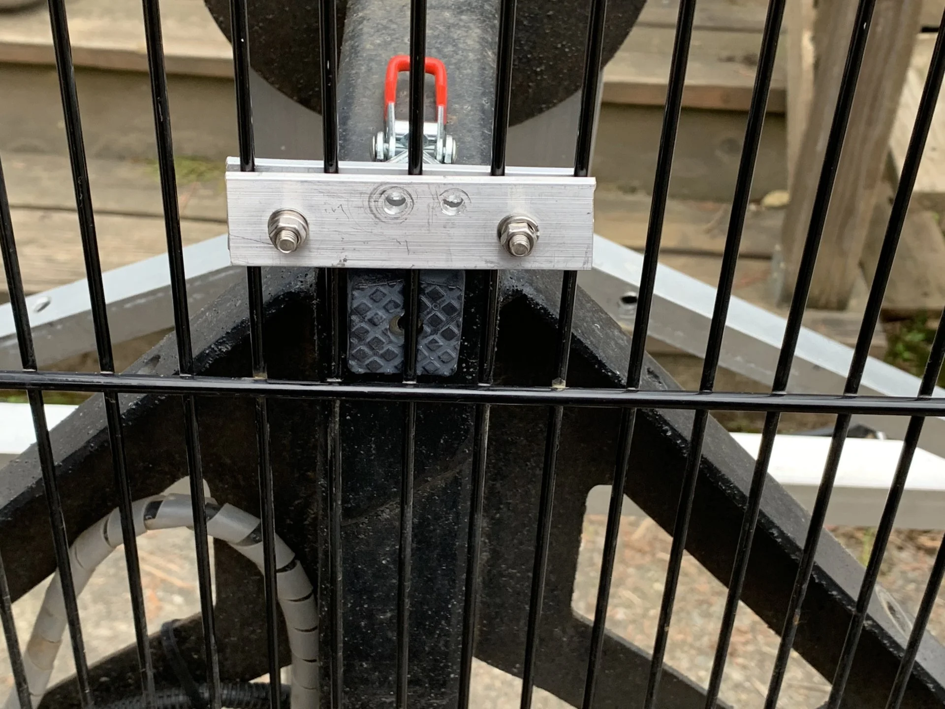

Worked up a v2 of the swingout table. Same table. New rope hinge on a 3/8” stainless rod that is in a couple of 3/8” bearings and fixed latch. Still working on the supports, right now have a string on one end and a random piece of Al angle on the other.
Right now the latch is in the center. If I like it I’ll rotate 90 and recess it thru the grid. Or it may be fine like it is.

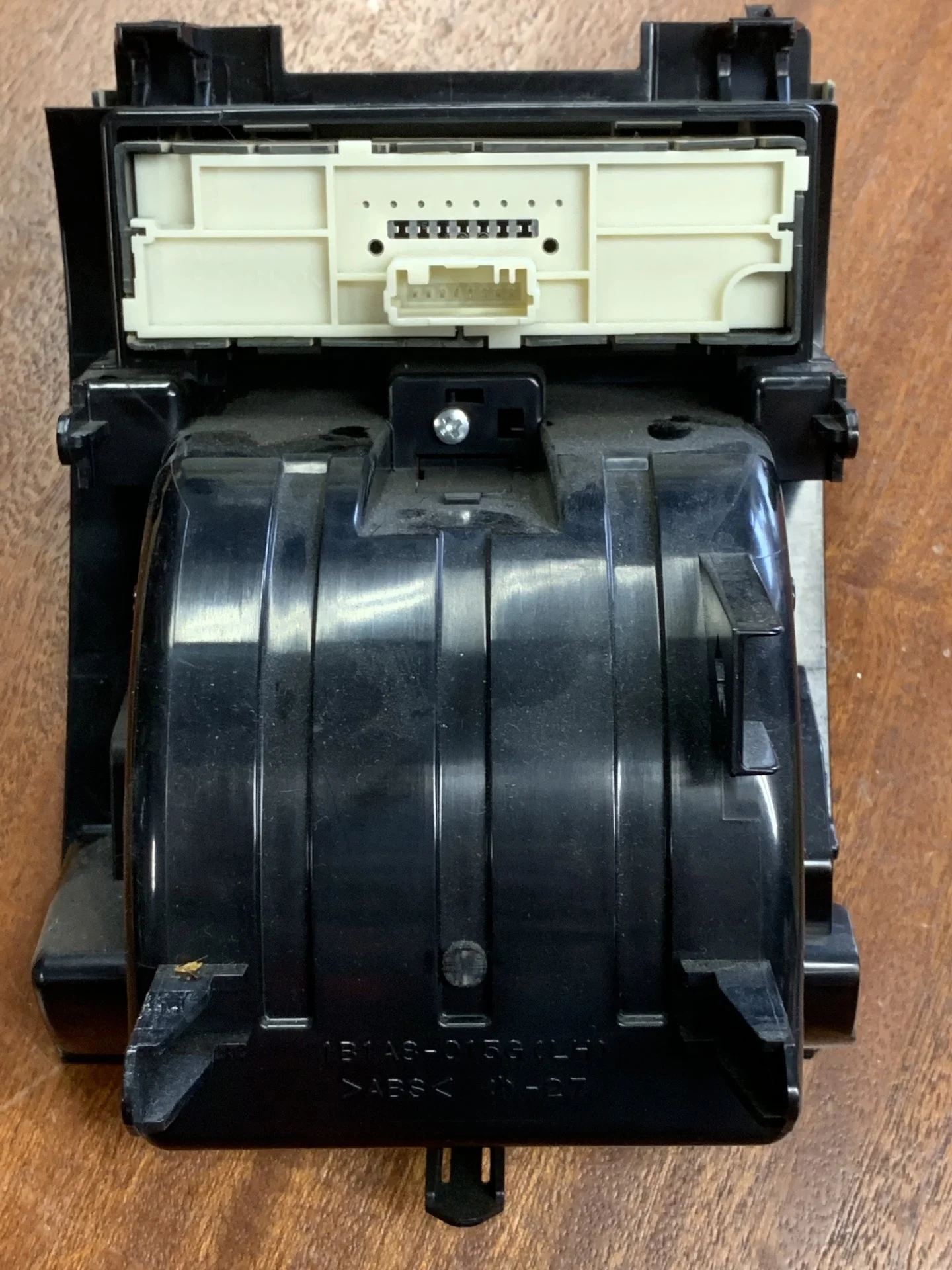

Pulled the cubby.
End piece of dash
Mirror assembly
Lower black footwell cover
Main lower assembly (Two 10mm bolts) loosened
Push down on two black pin clips at top of cubby, then pull out and down.

My plan is to glue the switch panel into the inside of the cubby, and have the color key plastic fit around the switches closely.
The other option is to have the switch panel mount to the outside of the cubby, but the switches are a bit proud of the panel, and it won’t look flush.
Drawer is deep enough for switches and their quick connector,
Another option would be to trim down the mount a bit and put it in the top of the cubby. That seems a lot more difficult to support.
A third option would be to print a new cavity plate, could fit 10 switches easy if you have the tools and time.
I think one could fit two sets of three if the packed them in, totally doable!

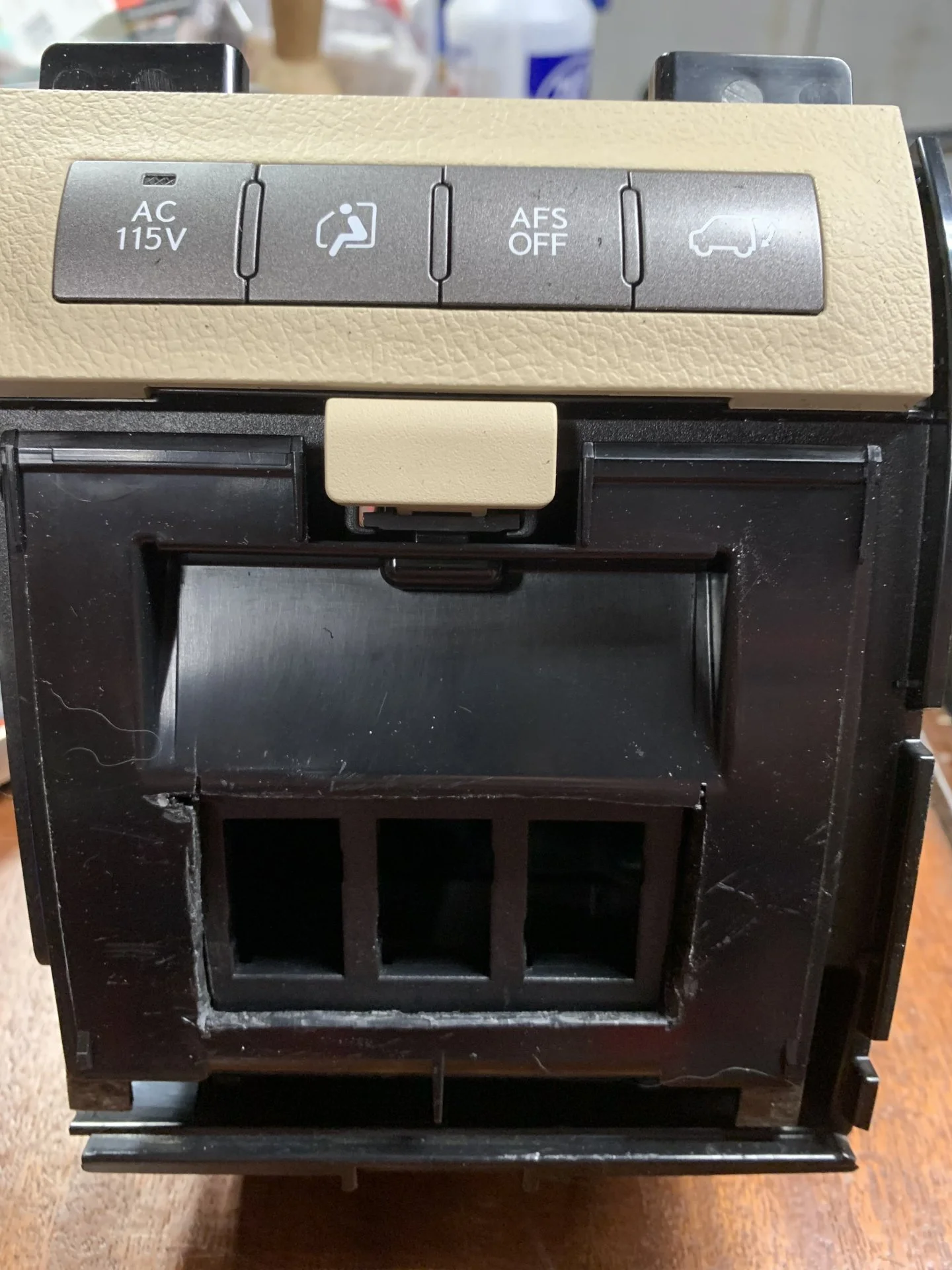

Replace the cover and mark out the min cut on the inner door.
I used an oscillating tool for this. You cut the entire width of the inner cubby.
Fit the switch mount to the cubby inside. The walls taper slightly.
Cut just inside the existing screw holes.
Much whittling and filing to get to fit.
Test fit a bunch of times.
Epoxy it in when satisfied.
Discover that the switch plate + cubby door + cosmetic cover is about 10mm.
The switch projection is about 10mm from the base plate.
This is awesome- the switches can be flush!
