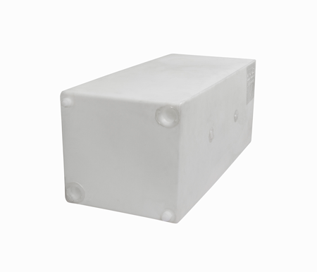

Browsed a few marine tank sites. I need to go take some measurements. I’d like to keep it above the rail, so a slight wedge shape three to five inches by 40 by maybe 15? All guesses. I think I’d rather have water for potable use and get a collapsible bucket and pump for the shower. The trouble is I have kids that will need spraying off pretty much every weekend, but we’ll only need 8 gallons potable once a month, probably will do both, $200 to spray off feet and sand and seawater should get a lot of utility.

will keep looking at underneath tanks too. Let me know if you find any @1world1love
Will do. I have talked to these guys and they have a few options that would work.
