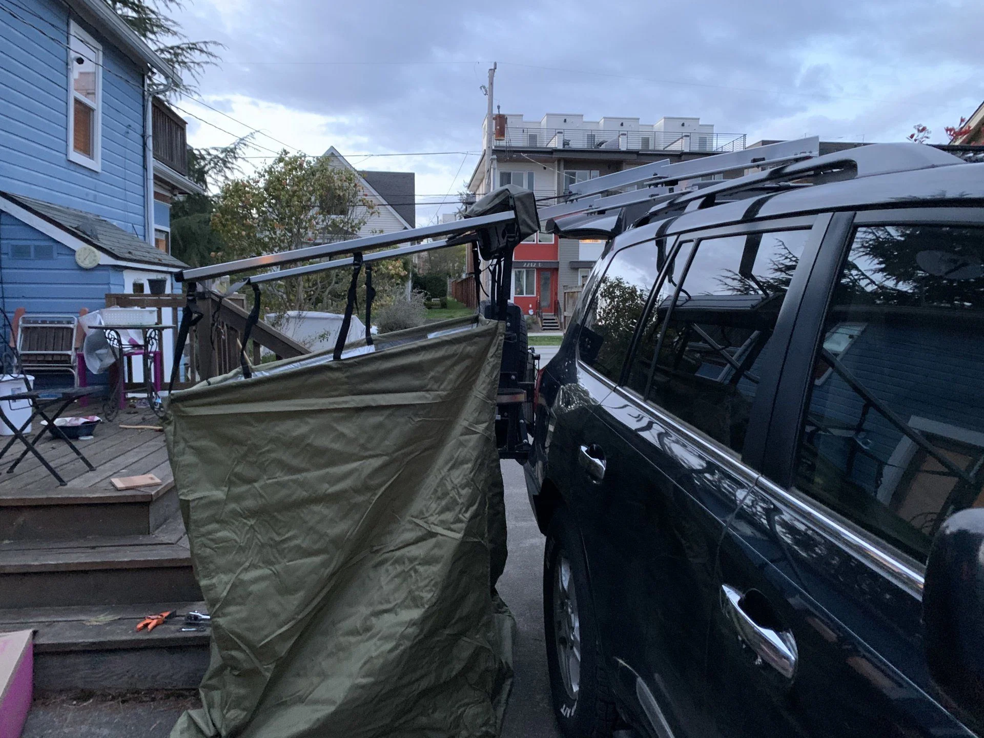

I’ve been working on some extendable rotating brackets for the new en-suite.
The idea is to extend out about 13” from the rack rail to clear the fenders and sliders, and rotate back so that the rear door can be opened.
I have the stock tlc rack.
Used aluminum angle and little 8mm bearings.
The concept seems good, but v1 execution is lacking! :rofl:
I need to find a way to ‘hook’ the end of the rail pivot so it can’t tip down. As soon as it does, the whole assembly, which is actually quite stiff, is tilted. I do have some rollerblade bearings, so may try one of those at the tail, it has a lot more face surface.
Otherwise the goals on clearance are met, and the en-suite seems pretty cool.
Tried a en-suite bracket with the Rollerblade bearings. better , but will still need some sort of positive lock at the rail.
guess I’ll just mount it up fixed for the nonce.

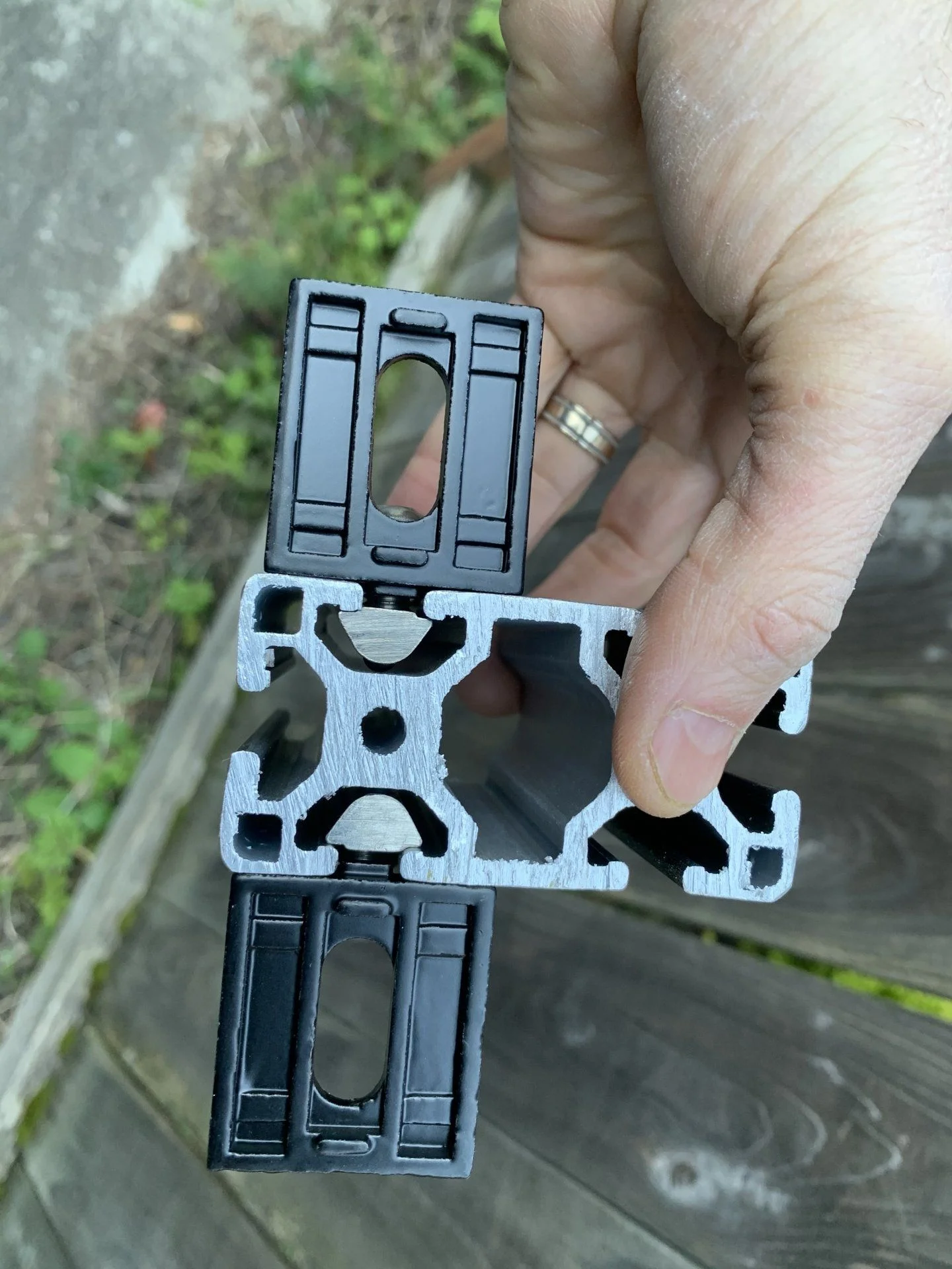

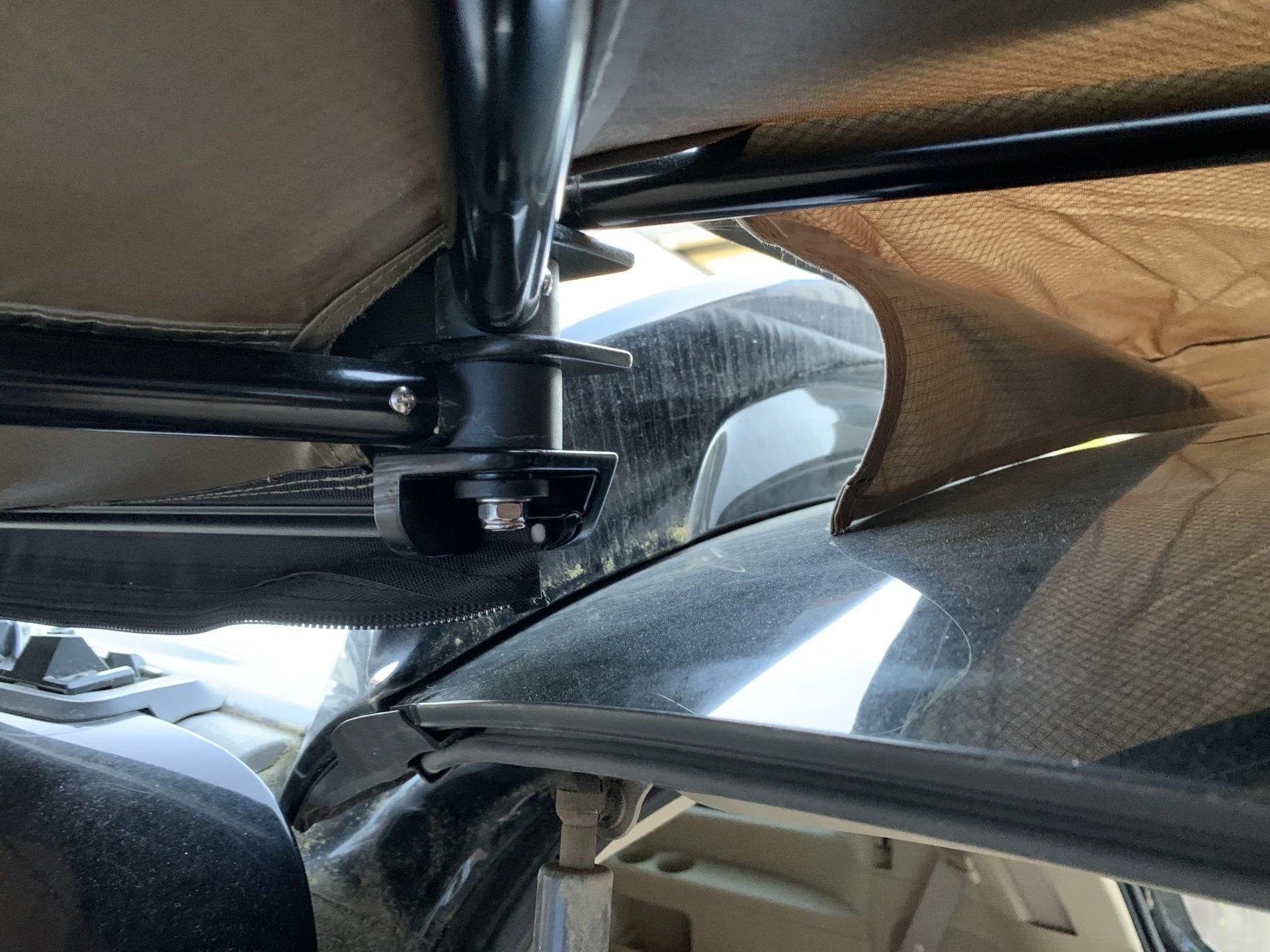

Finally all the parts for the tall 4080 brackets for the awning arrived.
It was drill murder to increase one of the holes on the stock rhino bracket from 6mm to 8mm. Killed my used and then a new 5/16 and 11/32 and a step drill too. Rhino invested in the real steel. Anyhow have to wait overnight for the paint to dry, but put the 4080 brackets on.

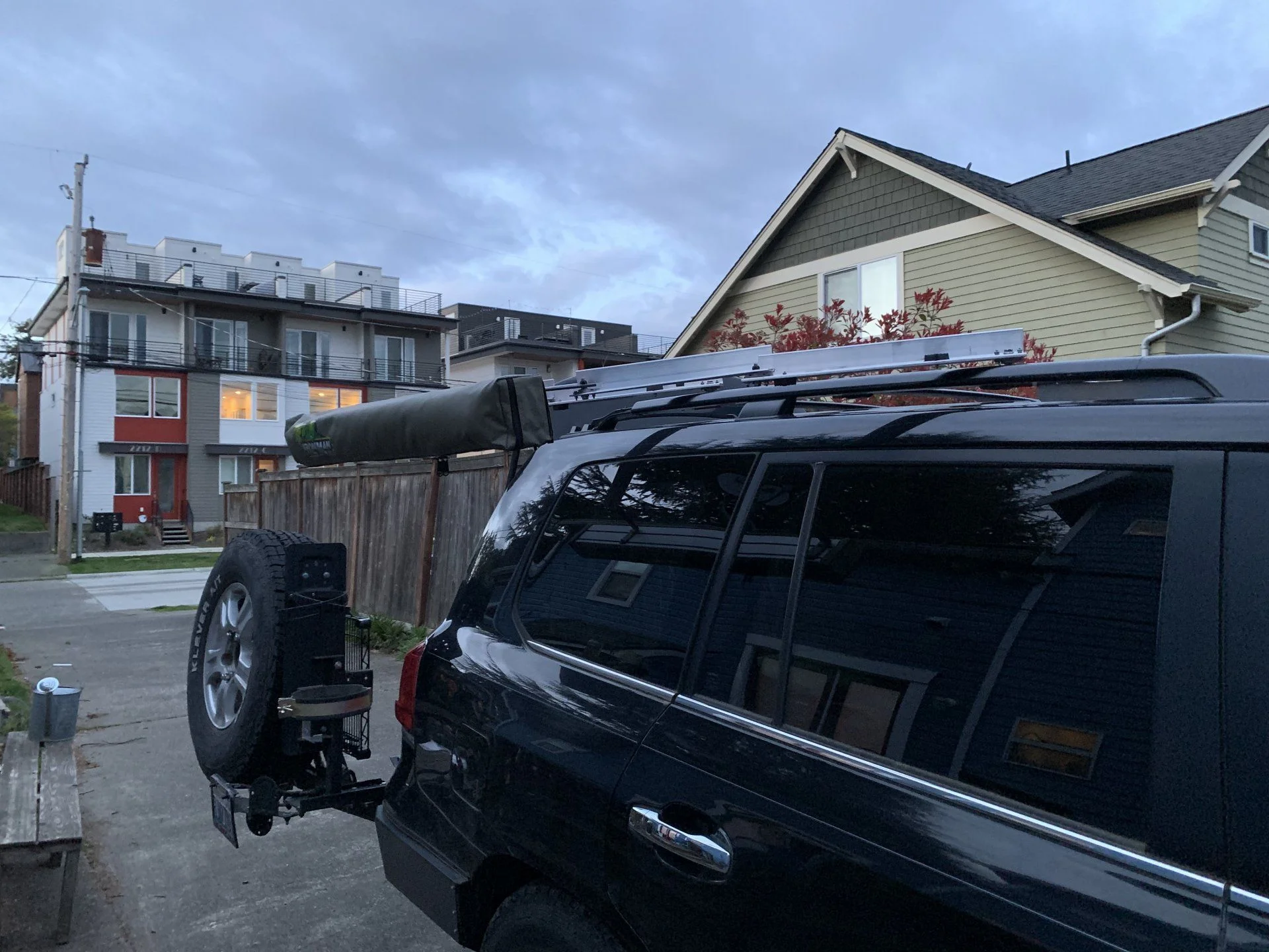

Rhino rack batwing happily back on the rig. Was able to adjust it an inch further back with the new height, and now it clears the spoiler on the hatch when deployed.
Perfect.
This bracket set was about $50 in parts, most of that in the foot of 4080. I have enough 4080 and bolts etc to make another pair.
Put the en-suite back on. The stock brackets are just ok. Will probably look to replace them with some angle aluminum soon. It does work but snuggles up to the side of the rig pretty good

The rhino supports are stacked, so the last support is also the highest one, so only 40 mm of lift was required. 60mm one could clear with the awning a bit more forward. I moved it back 20mm from the previous position, this put it over the door arc where the door was at a slightly lower point. That, combined with the 40mm height did the trick. It just kisses the spoiler now.
