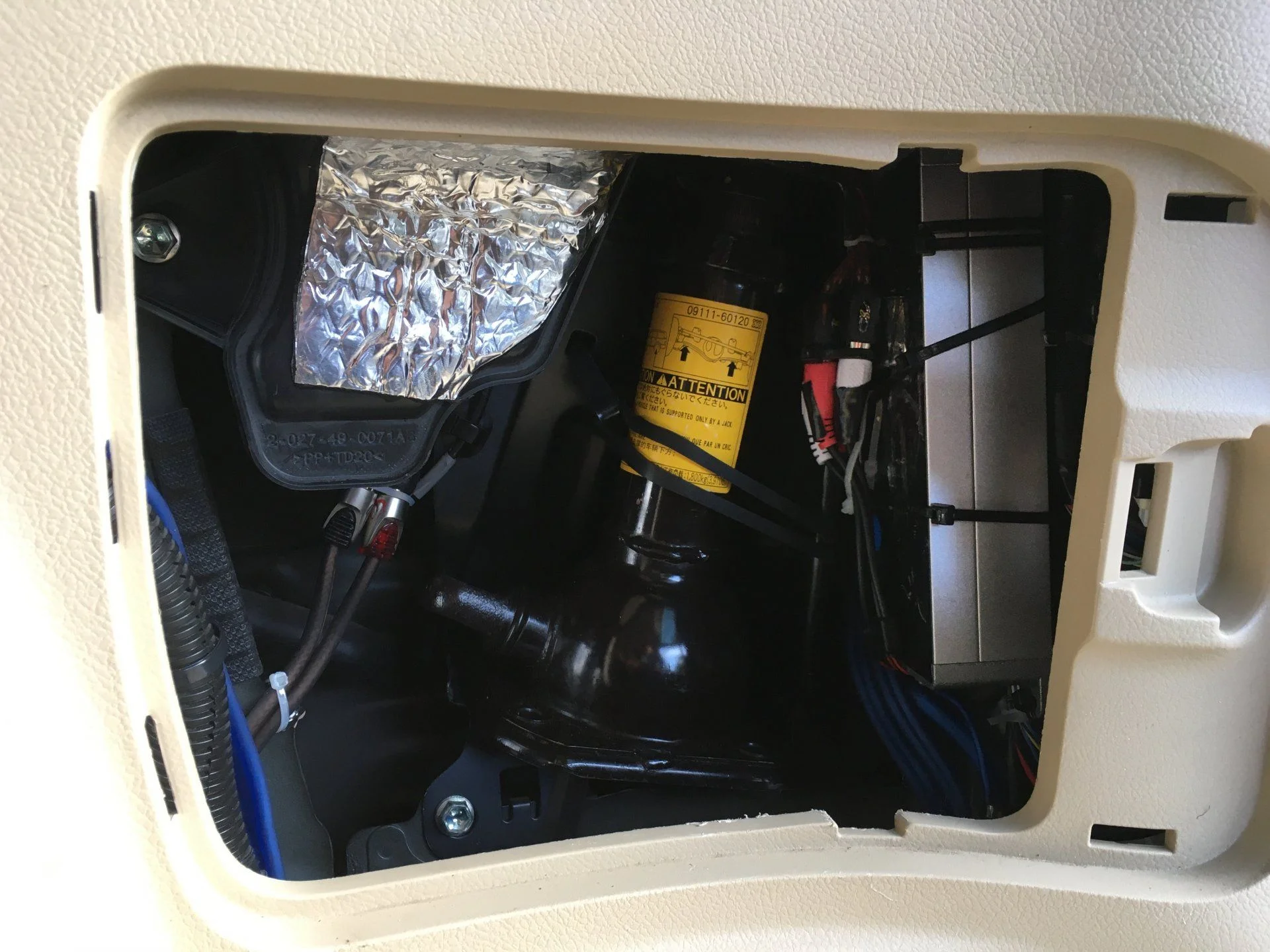

Working through the subwoofer update part two. Goal of this is to have a micro amp back at the sub. Also doing some little things along the way to build a better Install and sound.

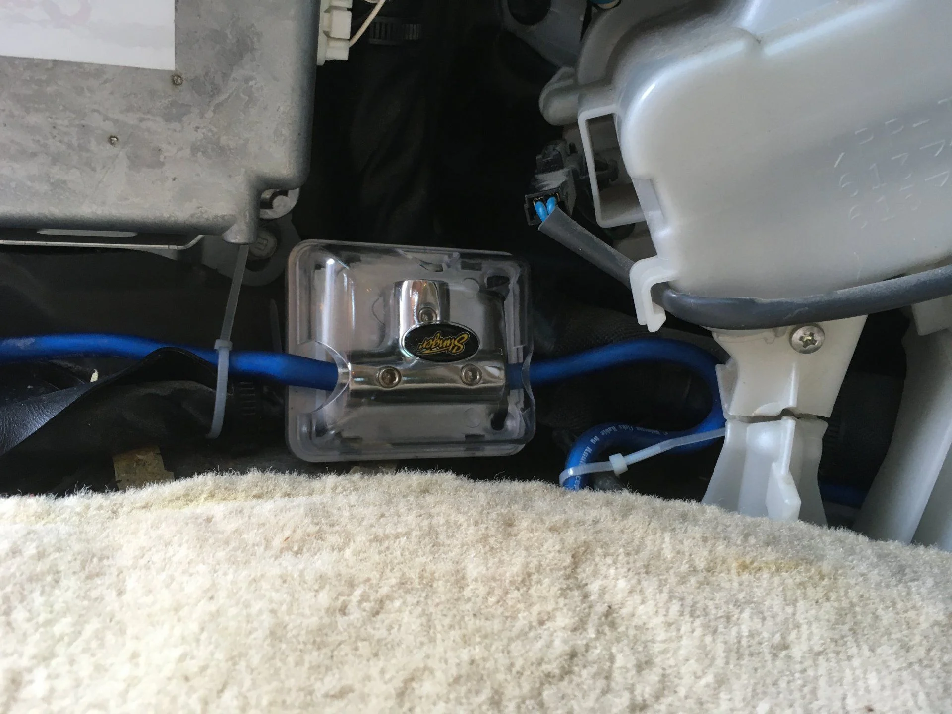

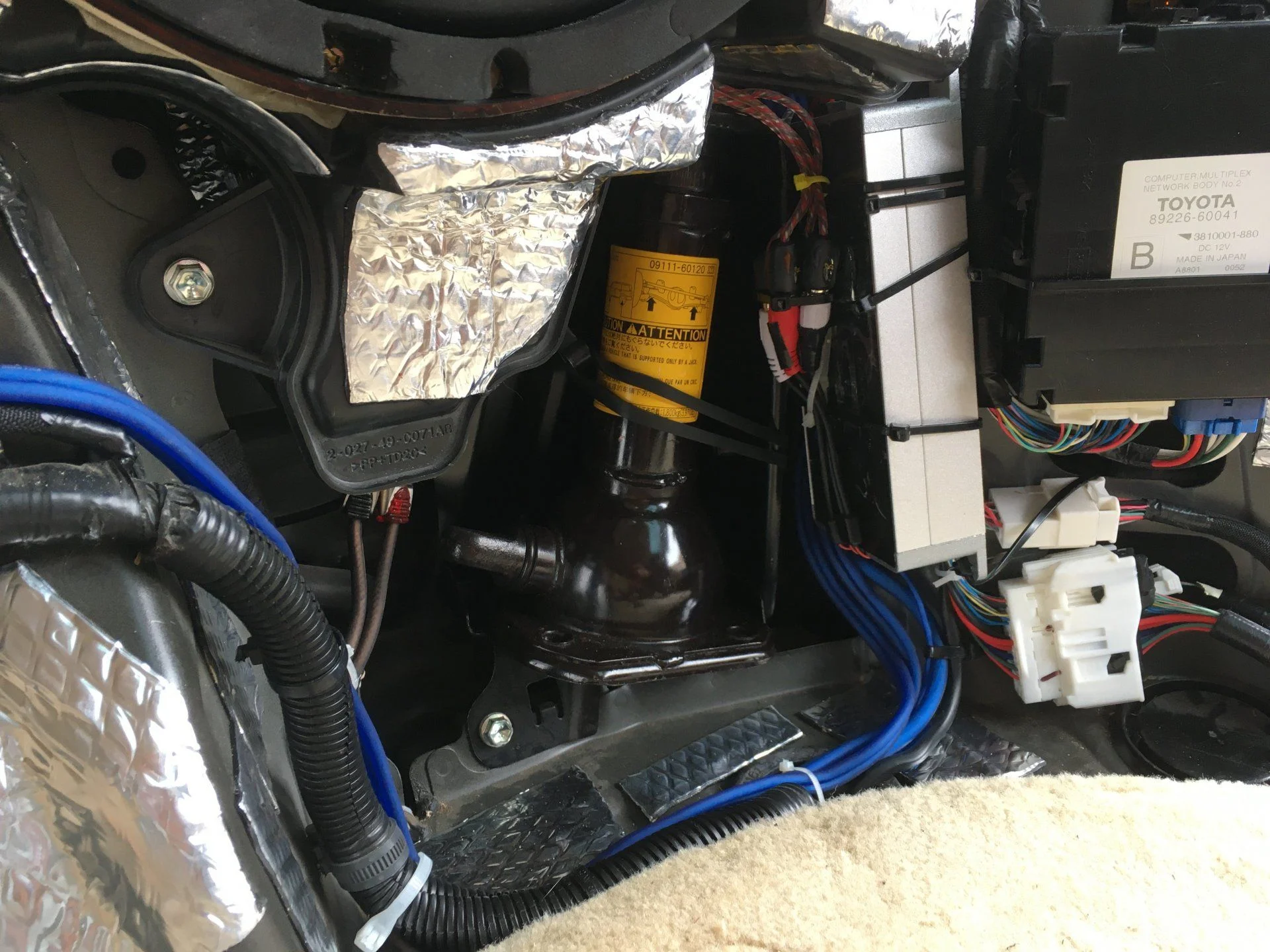

Left a connector in the corner to come back to for accessories.

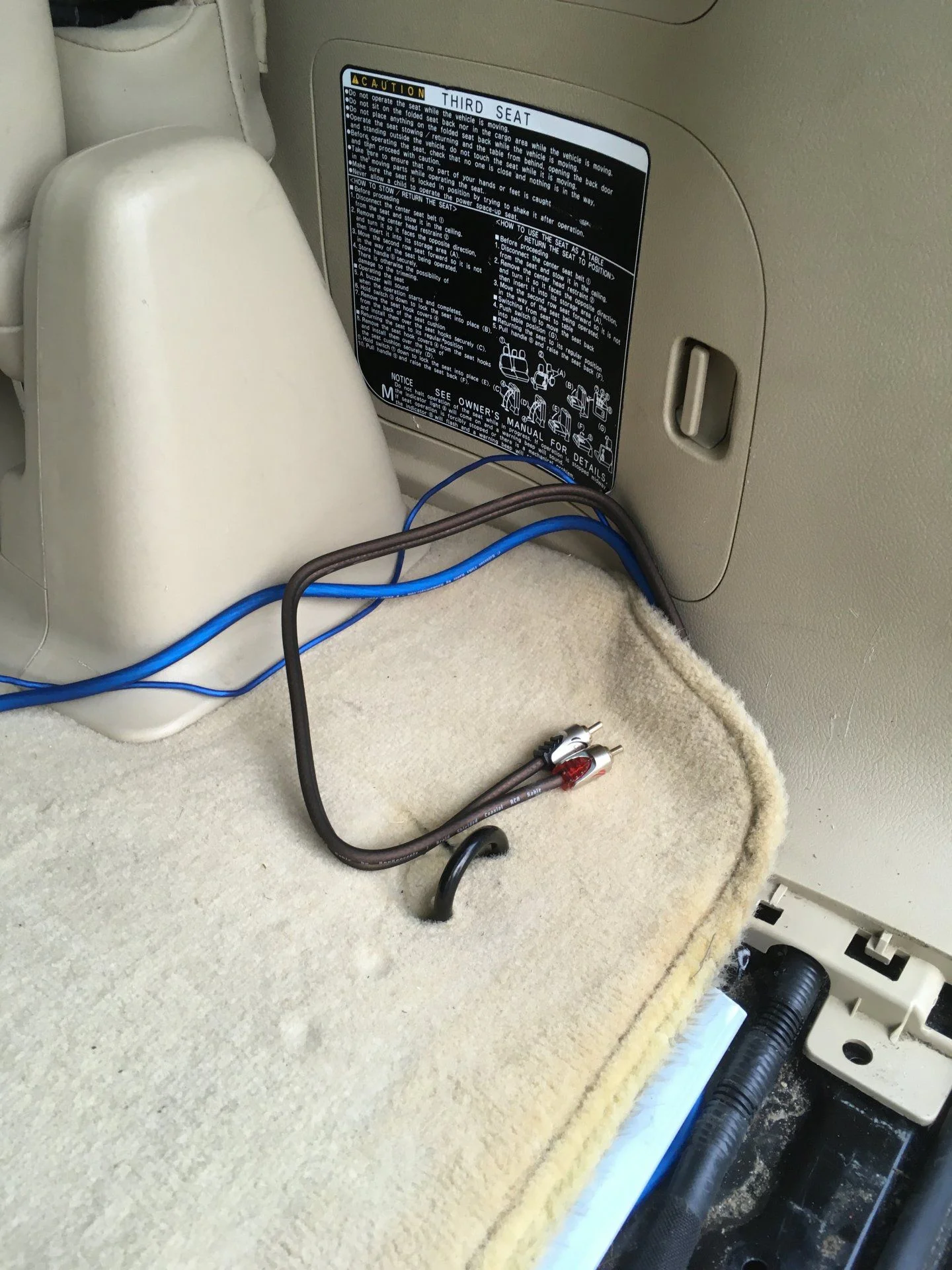

ran wires back to right rear. Acc, rcas, 12v.

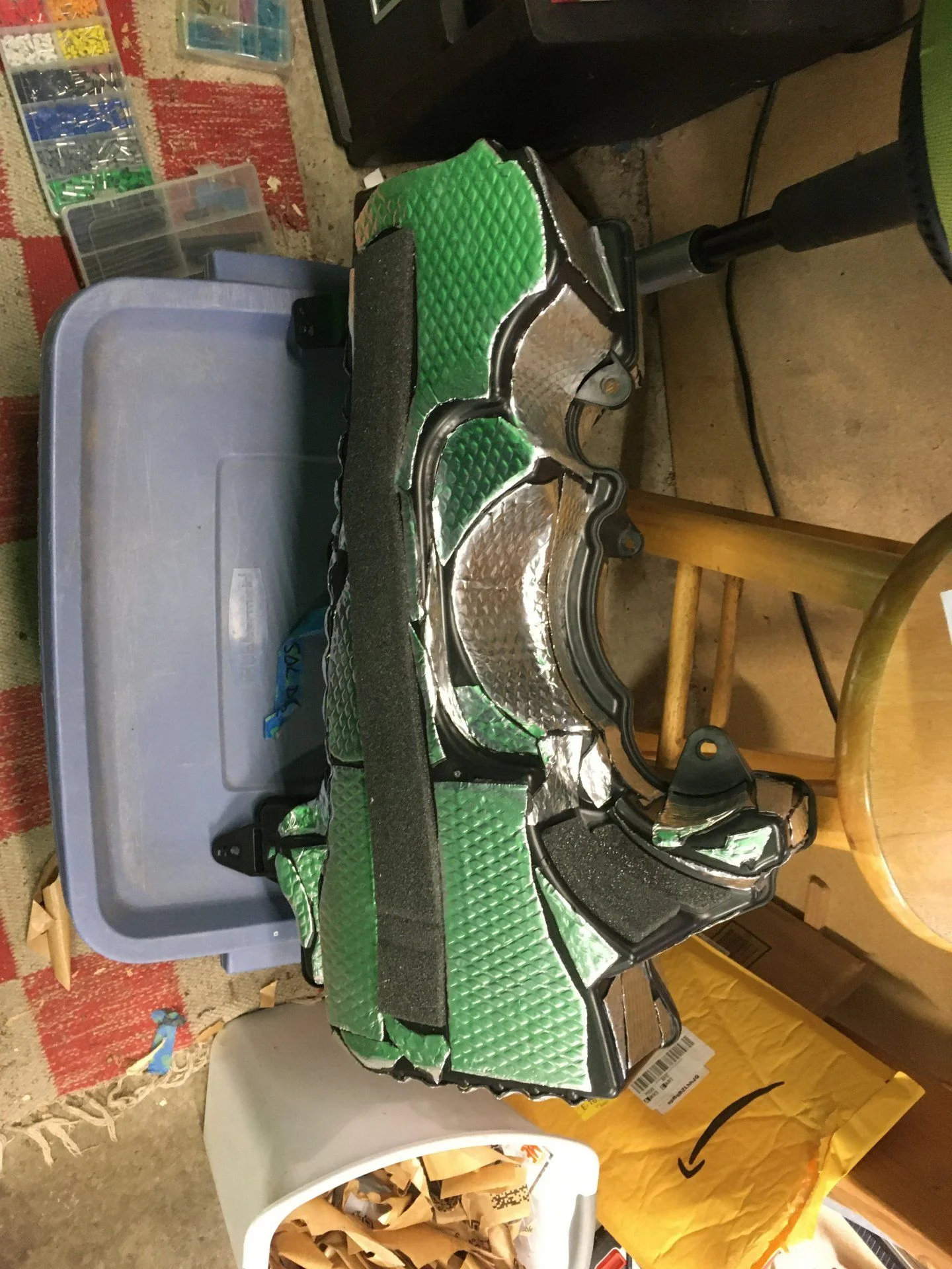

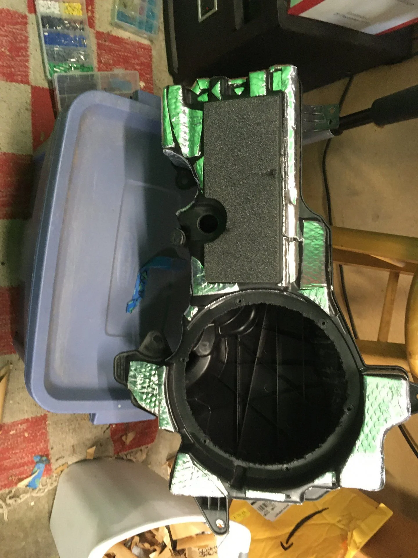

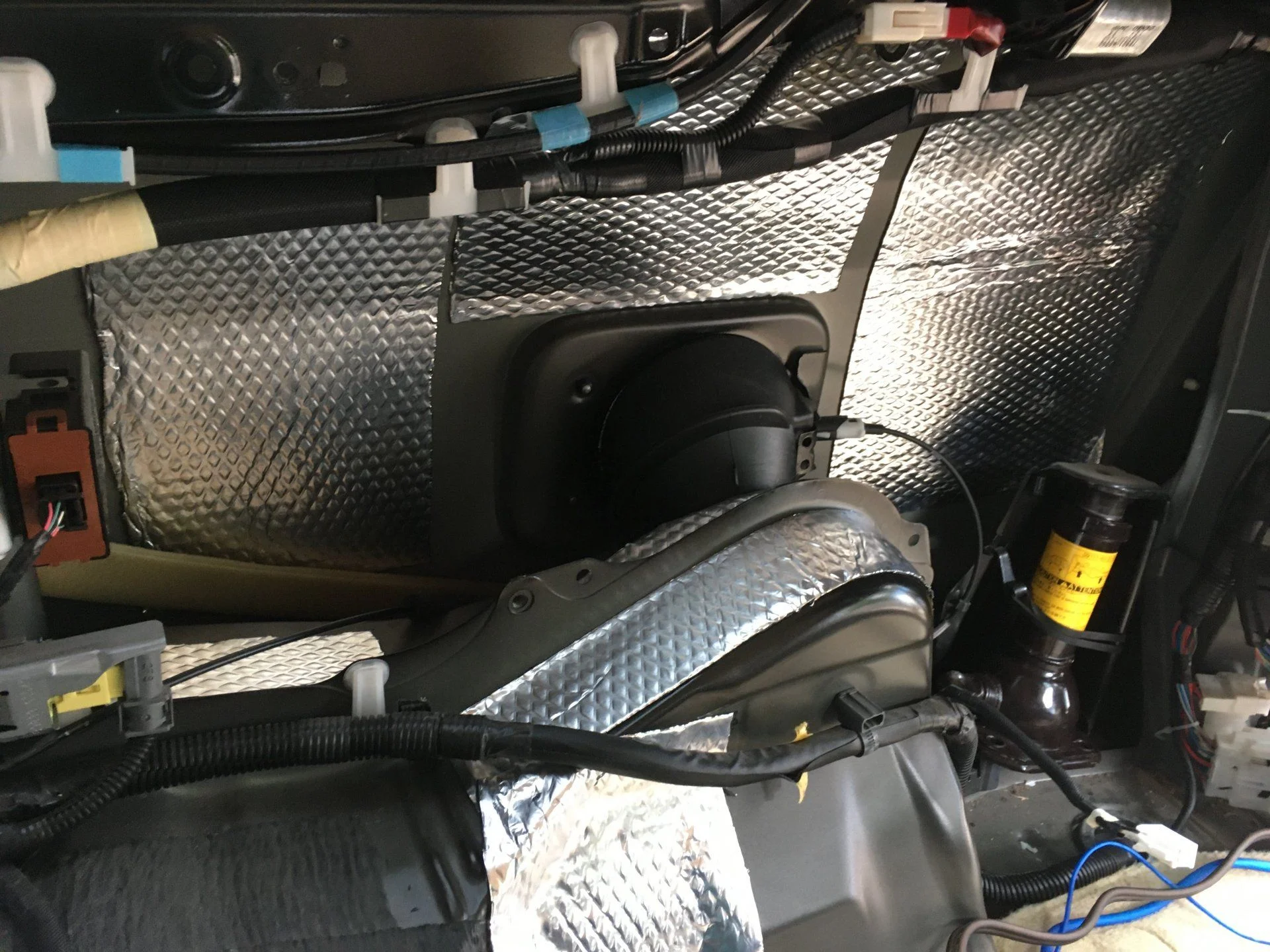

Then pulled the right panel and put 5 feet of damping on the sub box.
put 2 feet on inside of the sheet metal, and 1 foot on the plastic quarter itself.
no pics, but i reused the speaker plug to the enclosure, drilled the hole larger, and sealed both sides with sugru.

i had on the agenda to redo the sub spacer, but it actually looked pretty good after taking it off, so I bedded it in butyl and put it back on.
waiting on a new rca y for the dsp side and will put it all back together.

A lot of stuff in the install was straightforward, just like any sub install. I put the sub amp next to the jack. I reused the sub box grommet by drilling it out and then Sugru on both sides to reseal. Built a spacer to replace the jank spacer from V1 out of a spare bookshelf. That solved a resonance/rattle in the box and also got the box to sound 'dead', which is ideal.

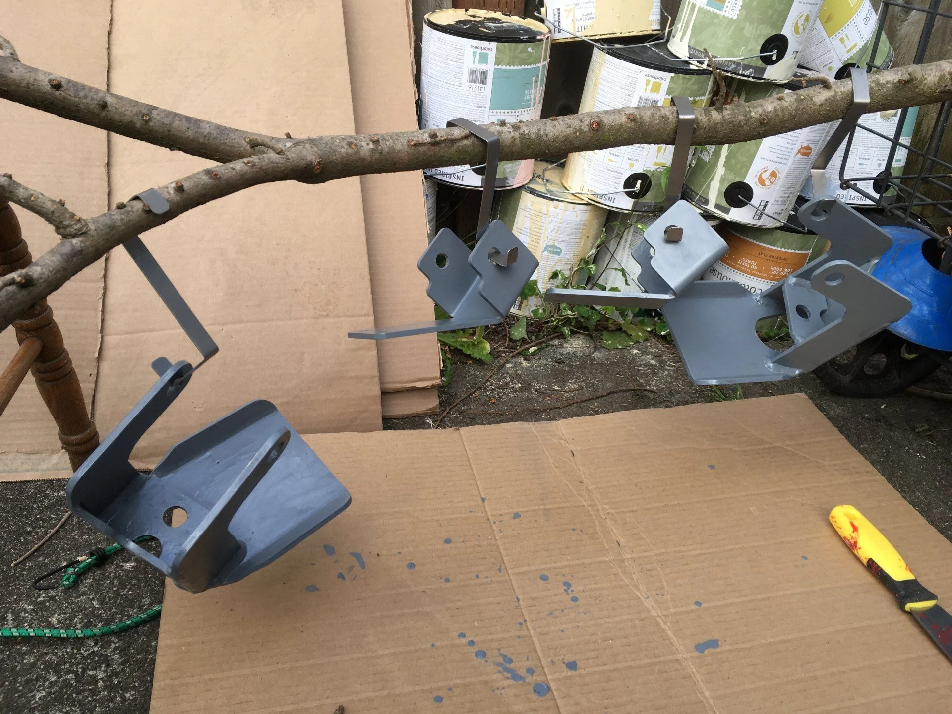

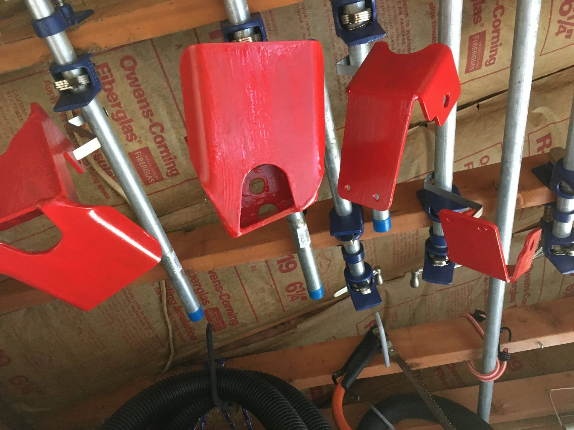

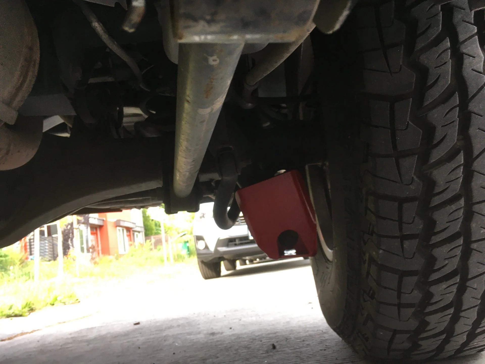

Sanded cleaned and primered the shock and rlca skids. Hope to get color weather willing tomorrow. More international harvester red I think
The redening continues. Two coats down, one to go.

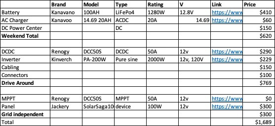

However china direct will get you a battery (100AH) or 1280WH for $400. So $0.30 WH. Then you have to roll your own electronics, which takes space and time. What you get back is built-in and much more capacity for everything. 20A ACDC charge instead of 6A. 50A MPPT instead of 20A, 50A DCDC instead of 10A, 100AH instead of 15 AH, 2000W DCAC instead of 600W.
I'm trying to figure out if I need or will need that flexibility and capacity.
