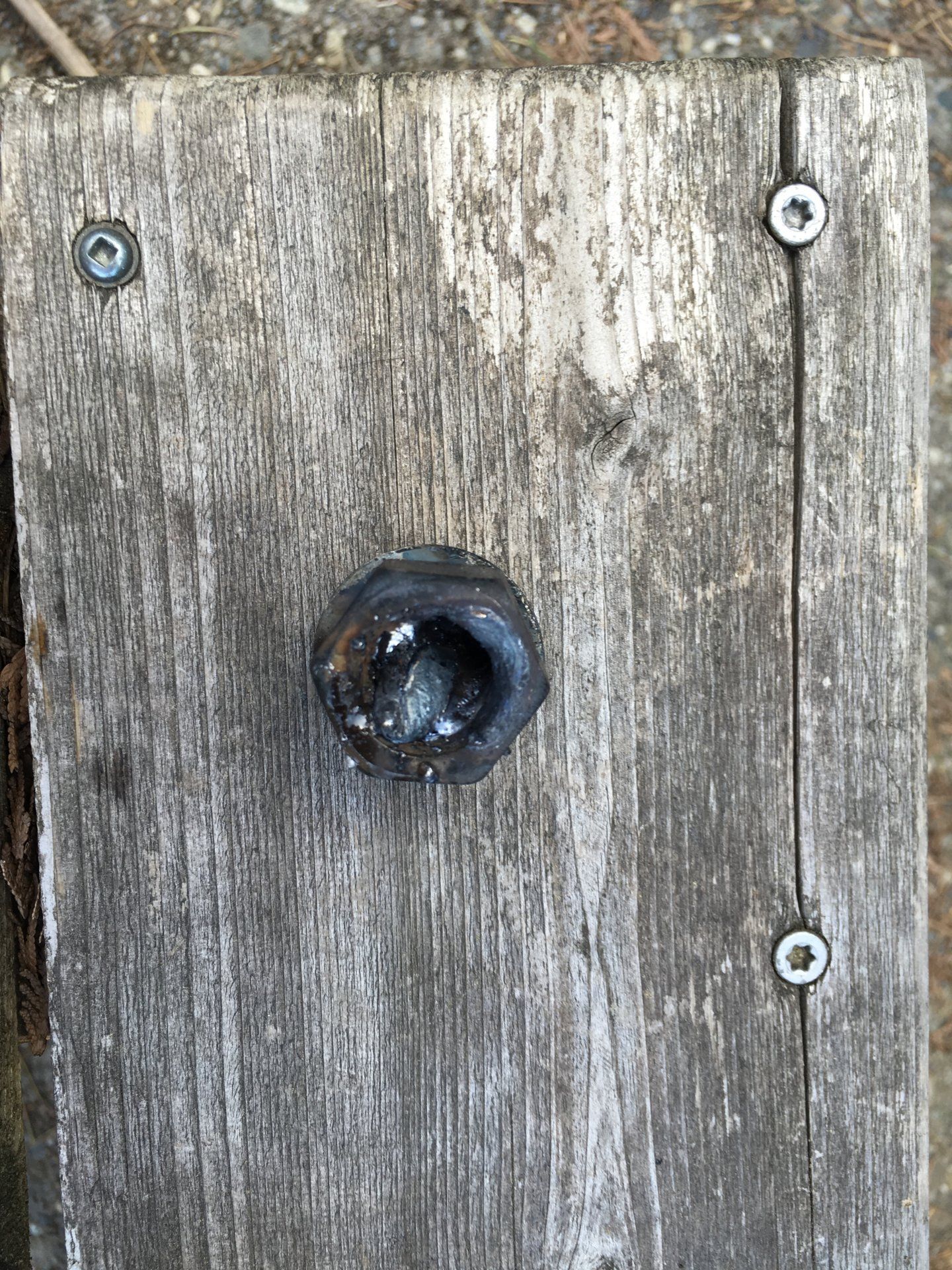

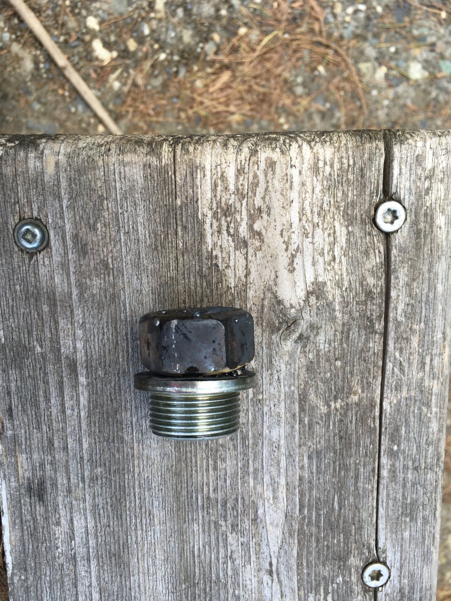

Changed out the rear diff fluid no problem. My shiny new Lexus nut head front drain plug is stuck. I'm not sure if it got overtorqued at the shop, or if it's just fate.
I tried a few things, and managed to round it off with a six sided torque socket and a shiny new air impact. I guess the way around it is to weld on a large nut (like a 3/4") and between heat and a larger socket try it again and hope.
Good news is once it's off I won't have to change diff fluid for 30k miles.

Welded up an m18 nut on the front diff drain. Super easy to fill the nut with slag and spin it off. The magnet was still good inside so I reused the plug with the 18mm on it. It think that will fix the problem.

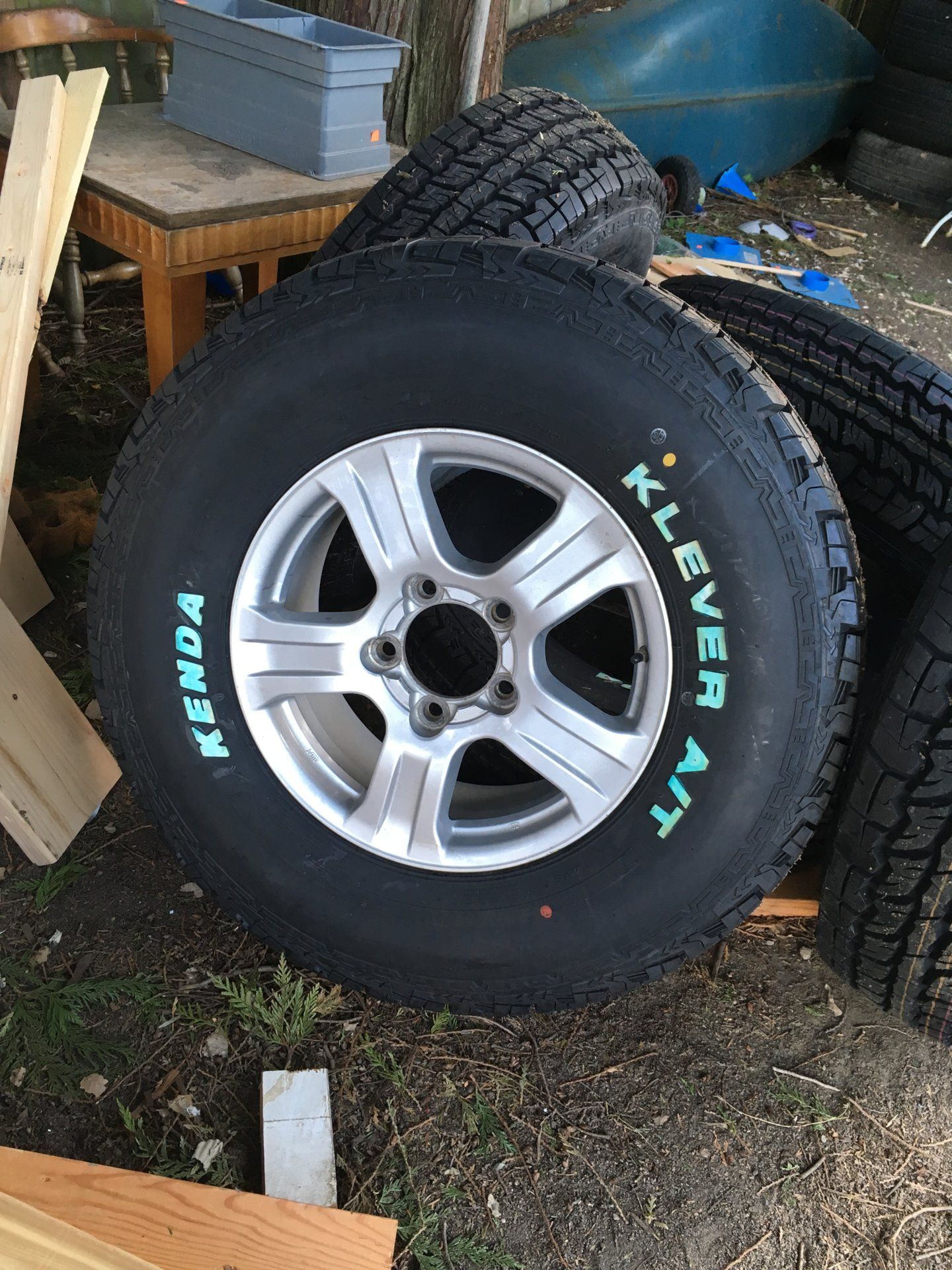

Mounted four tires today with pep boys help.
They measure 35 and a tiny bit by 10 3/4 at the bulge. The tread block is 8 3/4.
They should be easy to clearance with that narrow tread block and I hope to get them test fit tonight.
Two took 2 oz and two took 10oz.
I’m going to break the bead on the heavy ones and put in balance beads. Tire shop said they were stiff and that made it hard to balance due to hard spots. That this would go away in a few weeks of use. I think beads is easier than multiple trips to the tire store.
