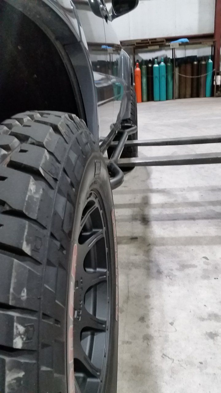

A sneAK peak of my sliders in the works ... Kevin and Matt over at Southern Style Speed did a great job copying what I drew on paper ... i think they are a lil diff than anything iv seen so far ...and when the other is build I'll be finishing the fabrication ...mounting this to 2x2 square tubing , mounting structure, and plating the steps with dimple grip inserts
Of any slider really.

All of the Sliders I have seen are made for non kdss equipped rigs. I would really like to see a set that was also offered for kdss equipped rigs, without having to modify them.
I think he means the KDSS models have hoses ect.. attached to the frame where the sliders would mount on a non KDSS model
Oh i got ya ...sorry excuse my ignorance Parish ... I was having a hard time connecting why the two effected each other ... im pretty sure mine came with kdss ... i guess we'll see if i have any issues
Adventure Driven's GX has OPOR sliders. They cut / welded the middle bracket on the driver's side to make them fit. Passenger side is fine.
I agree, it'd be nice to have ones that bolt on with no modification, but it's not a huge deal to make them work. :)

If you have KDSS, there is a huge KDSS pump mounted under the driver side that interferes with the slider mount legs. People have cut and moved that one mount in the way in order to get it to mount. Since you are building sliders one off from scratch, that won't be a problem for you. Slider design looks good, I dig the dual kickout style!
