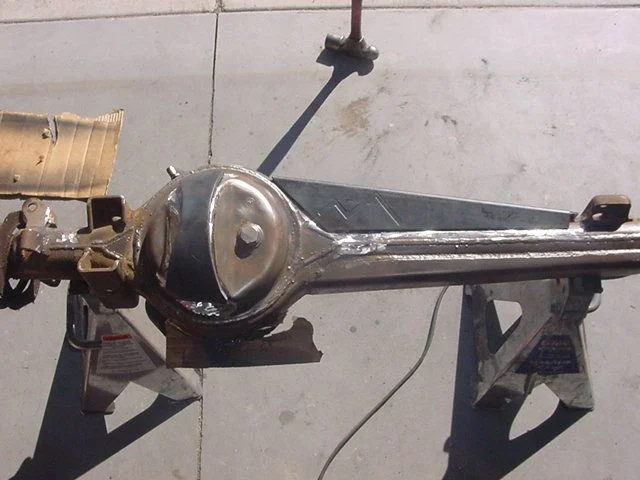

Axle Top Gusset, And Diff Cover Protector, Then Welded, Steering Ams Painted (kinda Hard To See.
attachment.php
Who did you buy the top gusset from?
Looks pretty sweet, how did it work?
