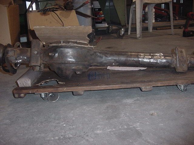

Pulled Front Axle, And Took It All A Part For Rebuild. Sorry No Pictures, Camera Died. But I'll Have Some Up Tomorrow.

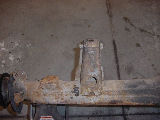

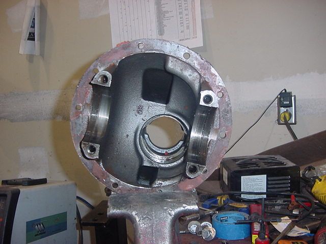

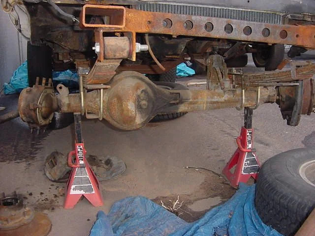

finished taking apart front axle, tore apart 3rd member, took off disc brakes, welded nuckle studs, cut off the traction bar, steering stabilizer bracket, and tortion bar brackets.

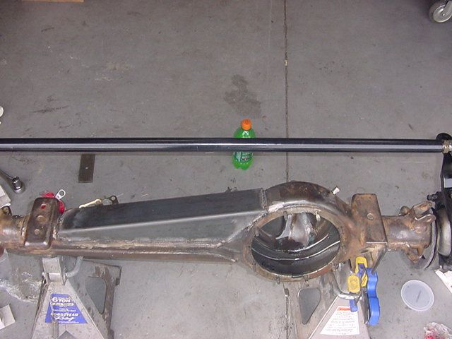

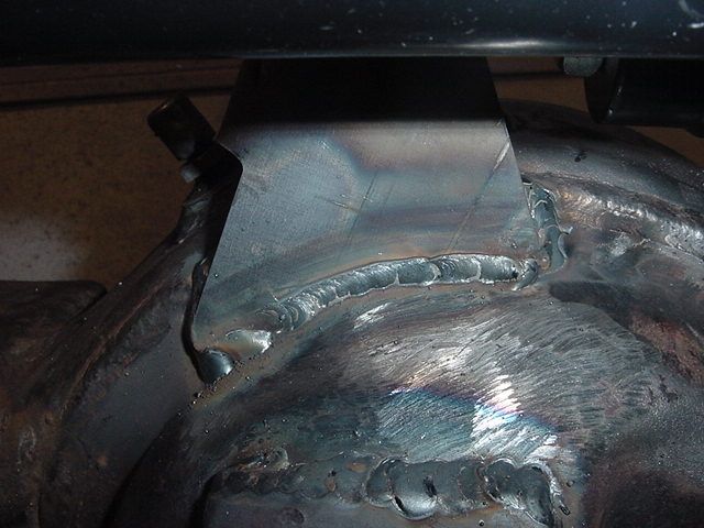

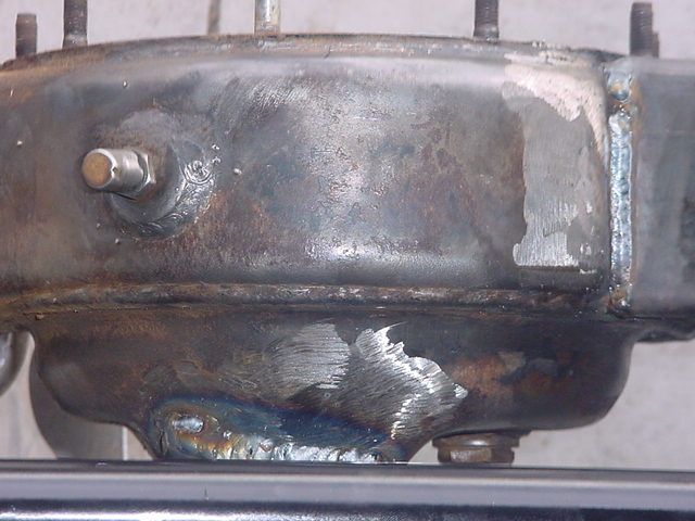

Are you gonna upgrade that housing to the 83/84 level of bracing? I would. Cheap and easy when the axle's not installed.
Do You Meen The Gusset On The Bottom? If So...
It Is An 85 Housing (You Can See It In The Picture Below), And I Am Also Putting A Gusset On The Top Too.
