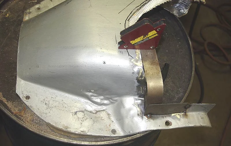

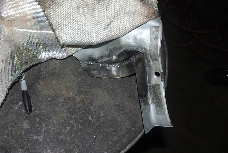

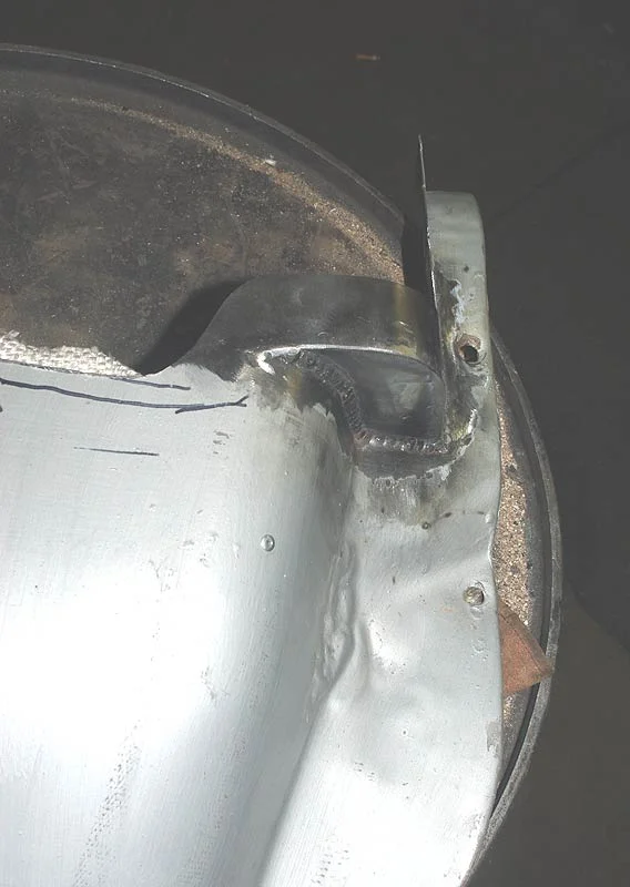

That FJ-60 cover is a pretty slick idea. Looks good, I think if you cut the rearward portion of the factory transfer opening out, the bump out in it would weld back on pretty easily behind the FJ-60 transfer opening and provide the sealing area there.
You want a good seal at this area, it is amazing the heat and sound that will come in if you have any holes, even under a carpet mat. The ability to nicely use the FJ60 boots will be very nice, they are good boots compared to the factory FJ40 setup.
when I got the truck, I installed fiberglass matting under the tranny cover to shield against heat - some of it can be re-used; I may have to look into installing some more before I do the interior insulation and carpet work

I don't see the problem with sealing it up - between a rubber gasket strip, hardware store foam and Eastman black guey putty that can be used to stuff the area, it's all gonna be under the sound proofing mat and carpet in the end anyway :D
No gona to cut it!:hillbilly:

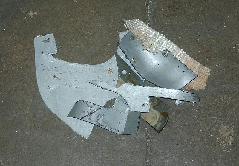

Did some more choppin.
Stuck some stuff on.
Discard pile.

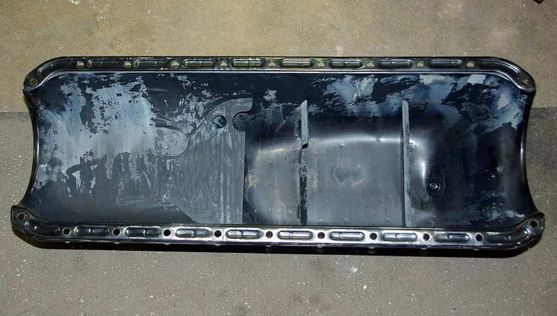

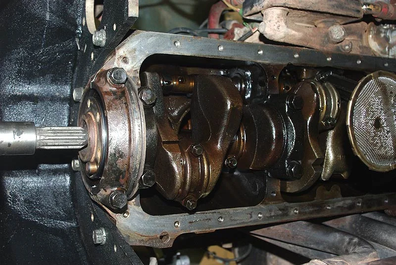

The rear of the motor has always been a leaky mess, so, making an attempt at stemming the tide. Pulled the pan, tossed it in the cleaner.
Pulled the rear main cap and sealed it.
Used Fel Pro snap-ups to install the pan and gasket. They were from a previous job, likely 5/18" but stripped in nicely!:hillbilly: They worked very well, with this size of pan, 6 would have been better, but was much better than nothing.
These: http://www.autozone.com/autozone/ac...n-SnapUps/_/N-26pm?itemIdentifier=155049_0_0_
They thread into the bolt holes, snap the pan gasket over, line it up, snap the pan on, start the other bolts, then replace the snap-ups with bolts and tighten all of them. Worked slick, much less fight.
How much cleaner will you get the pan? Will you paint the outside of the pan? I have mine off and it was gross on the outside. inside is just thin black that simple green is not making a dent in. What did yu use to clean the inside with?

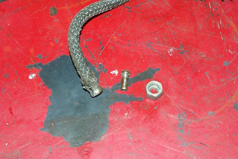

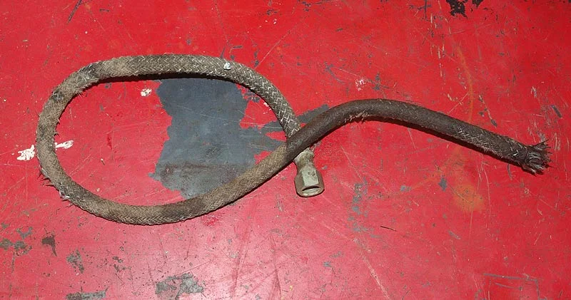

The fuel line looked a bit sketchy/crunchy. Cut the ferrule with a cut wheel, worked it off of the fitting. Installed new line with an Amflo #7325 brass ferrule. Should be ready to go for another 40yrs.
W O W :D
Have a BE heated spray wash cabinet, so stuck it in there for a couple of hours, came out looking like in the pic, makes the deal relatively painless!:hillbilly: After that, wiped the gasket surface and residue from the inside with lacquer thinner, blew it off and installed.
I'm not a simple green fan, prefer engine cleaner (the stuff from wally world works) and/or Costco degreaser. If it won't fit in the cabinet, a pressure washer is the tool of choice, if needed coin op car wash.
This rig isn't a show car, is likely to get wheeled, like as often as possible, so is likely to get dirty! The paint was in good condition, didn't do the paint, polish, wax thing.:o
