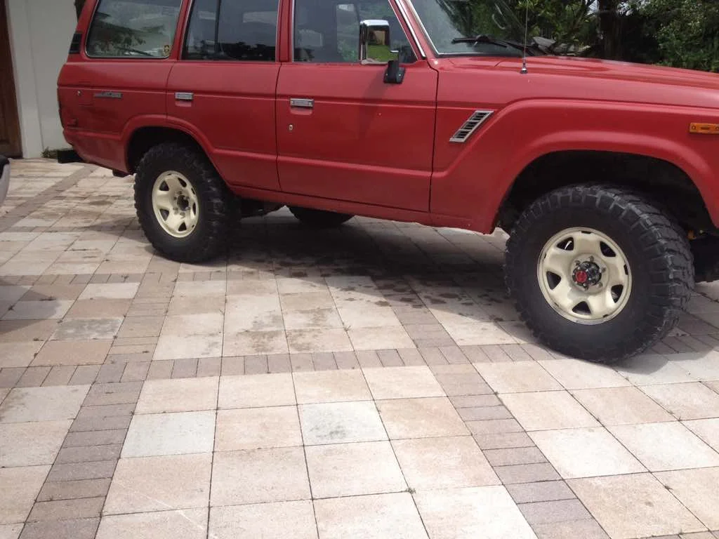

This thread has been quiet for awhile. Does anyone have some shots of an Ironman lift with the B load front and rear (range A thru D increasing as you go). I have no need for heavy load capacity. Thinking of this on my FJ62 (Freeborn Red) and then either 31 or 33 tires. Probably stay with stock wheels and will try to polish them up real well. Thanks.

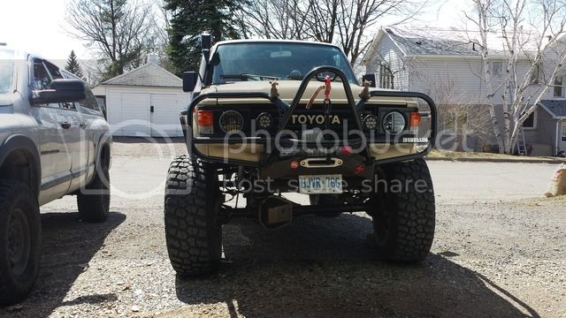

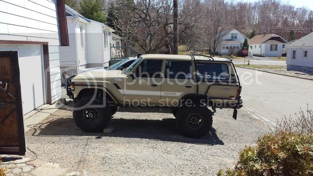

[URL=http://s818.photobucket.com/user/charlesk11charles/media/Mobile%20Uploads/20150430_143604_zpsercyl7g4.jpg.html][/URL]Soa with shackle reversal up front using stock length shackles and stock leaf packs. Rear has ome "stock height" leaf packs and anti inversion shackles. Both f/r wheel wells are trimmed and rear axle moved roughly an inch back. 40x14.5x17 km2s on champion 5"bs beadlock rims. D60 front axle 14 bolt rear.
[URL=http://s818.photobucket.com/user/charlesk11charles/media/Mobile%20Uploads/20150430_150744_zpstq0mbuy5.jpg.html][/URL]
[URL=http://s818.photobucket.com/user/charlesk11charles/media/Mobile%20Uploads/20150430_143621_zps6xujhewa.jpg.html][/URL]
