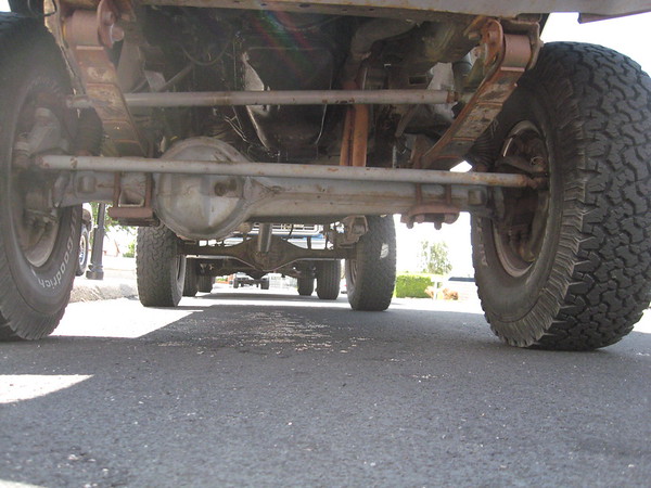

When I built my own mid-steer (cross-over drag-link above the springs, but left the tie-rod in the stock location) I used a flat pitman arm and still managed to put a small crease in the oil pan. The only pic that I have of the system, those are std OME front springs:
AH, I must have misunderstood you when I was reading an older thread. I had seen some of the older high steer arms that looked like yours ntsqd. But I did get my high steer kit ordered. It's Trail Gears only because I want to upgrade to Marlin's 25mm pin arms and didn't want to waste a set of All-Pros. I did go with the flat pitman arm as well.

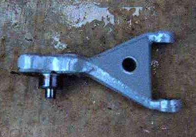

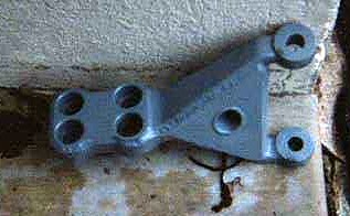

That arm was originally built before high steer flat arms were available. It is the old school method of of welding two OE steering arms together, that I then plated and gusseted. I actually did it in art class (they had better TIG machines that the MFG labs did!) and got credit for an abstract sculpture assignment called "Steering Part". :) Scans of old pics right after building it:
