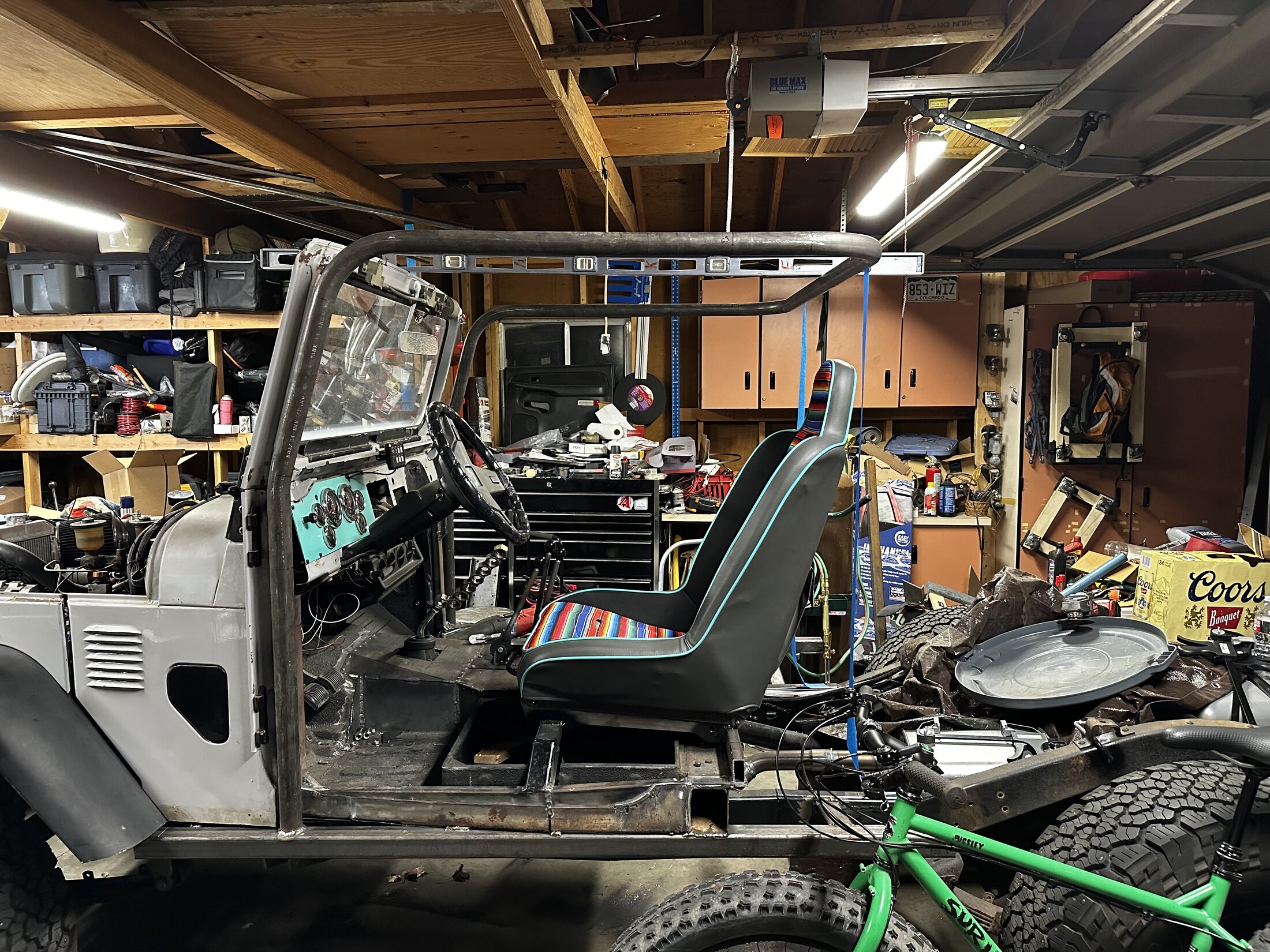

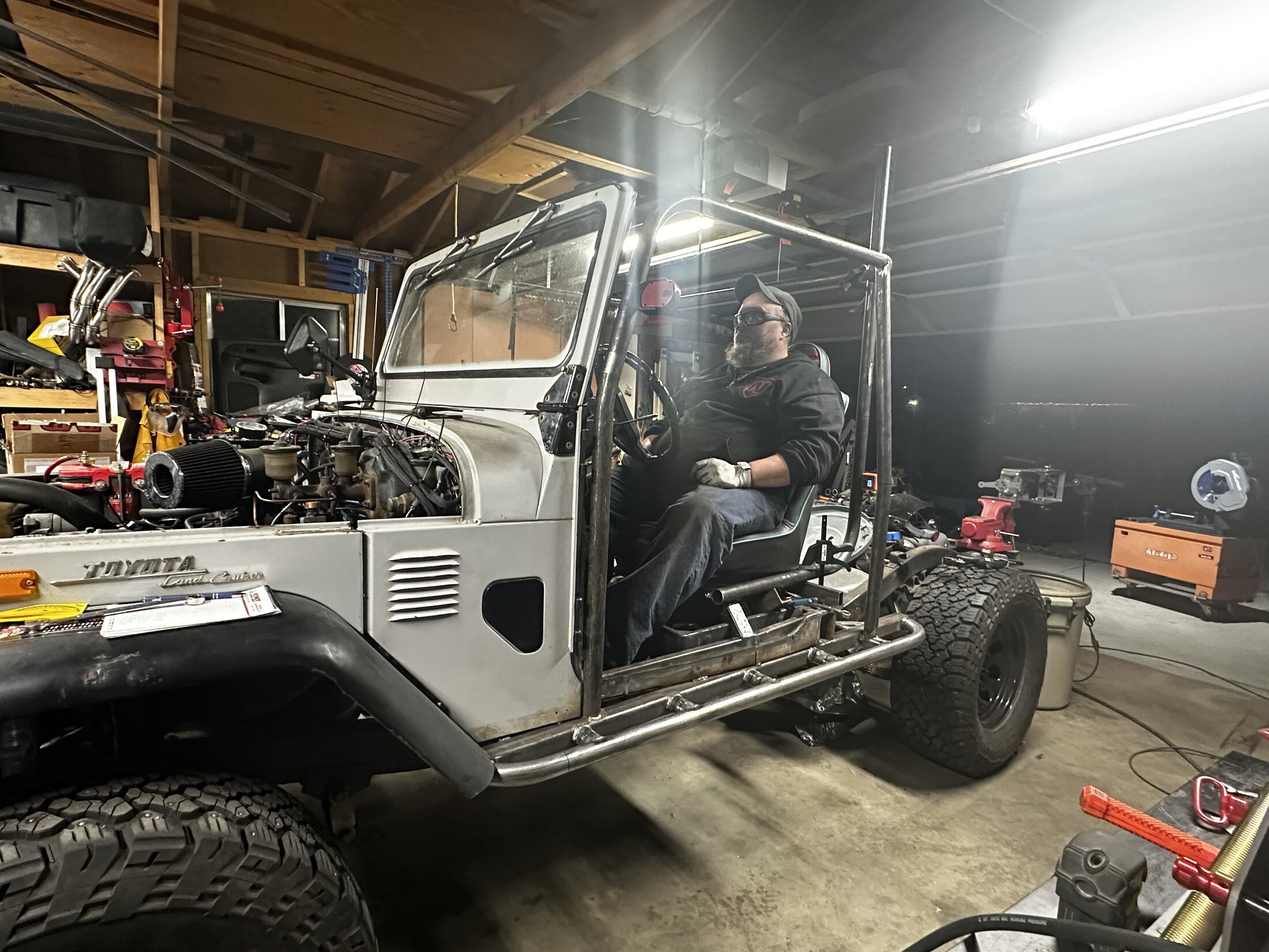

Got the slider bases and A pillar contraption welded together. This part is on for good now. I’ve got 2 l gas holding it all together to the frame currently. The end result will have multiple more at various angles to triangulate, as well as the lowers being done for boat side skids.
Today I got the B pillar plan mostly figured out and started making the sliders to be able to attach it. Should have a lot more progress tomorrow with the current direction.

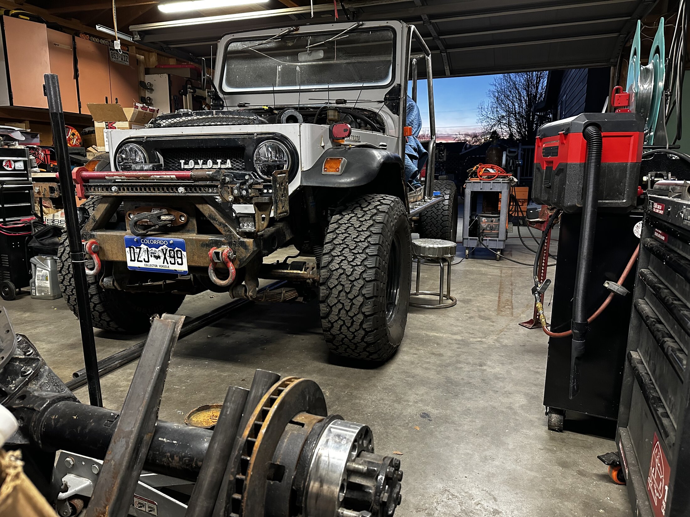

Typical to this build, started the day with a clear vision. That slowly adapted as the pieces went together. But, the B pillar main bars are on, just need to finalize the passenger slider. The end of tonight, I got the rear of cab design flowing, and should be pretty sweet once done. Not sure I’ll get much done on it tomorrow before I go to work for the night, but the next 4 day off will have a good amount of progress for sure. I’ll need to run for gas and wire on the first day, once one runs out. Probably right away!!!

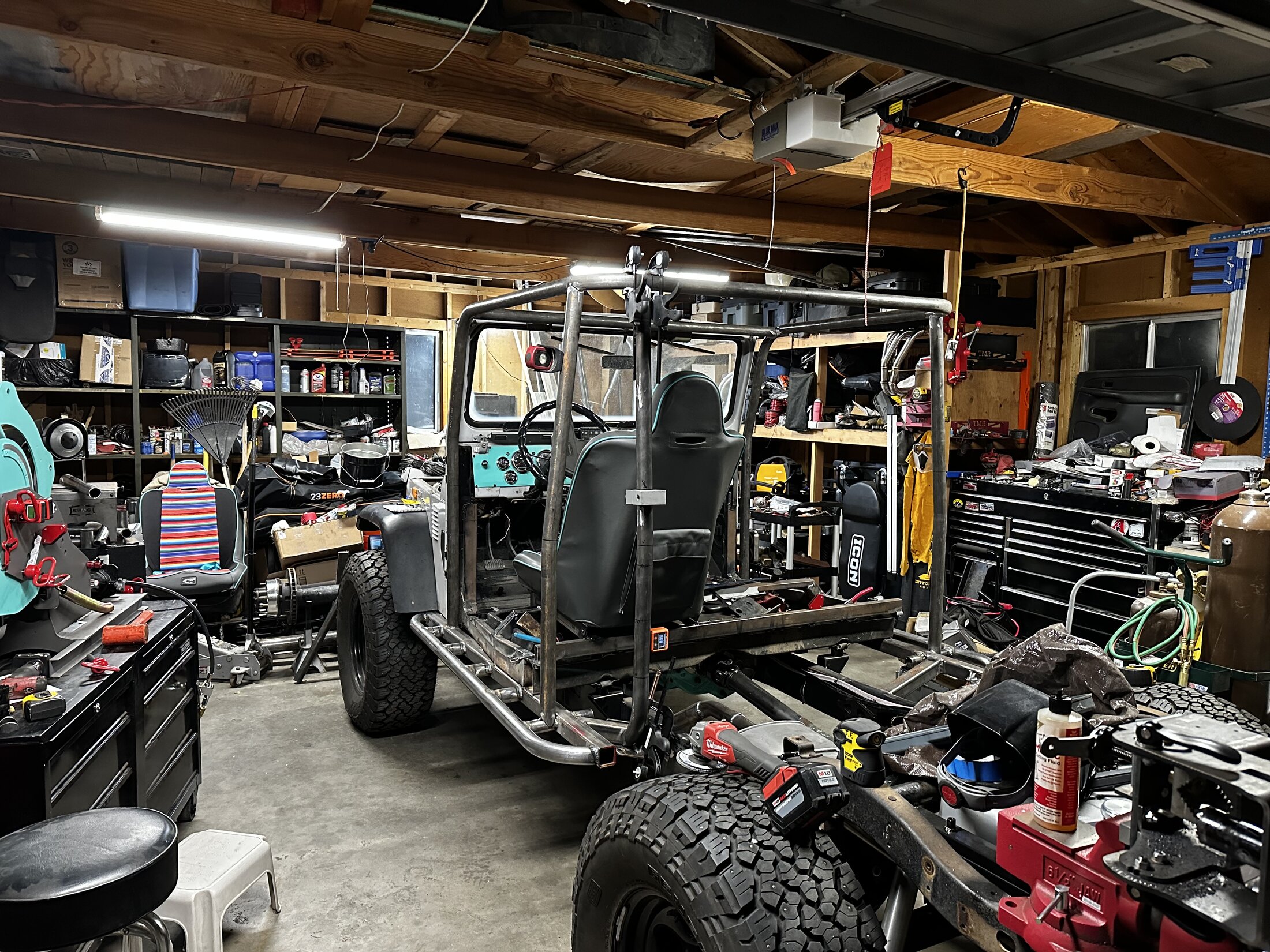

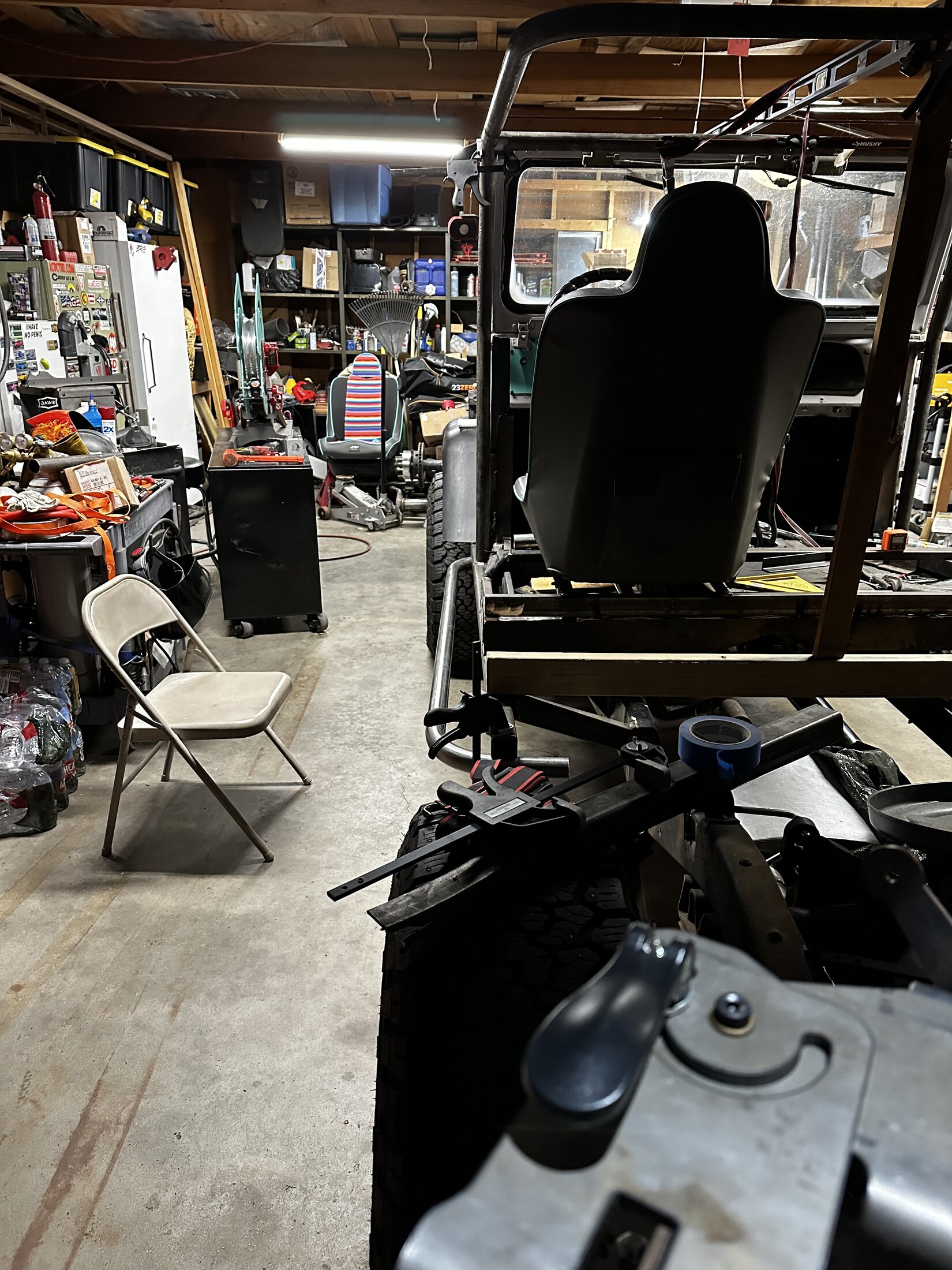

Well, the cage is progressing. The roof X bars are on. Everything that’s in, is full welded. It’s been an arduous process making decisions on where to place stuff based on safety, as well as esthetic’s. Safety always first, but all of this is the body, so I want it to look good. The odd 2 pillar wrap around corner really throws you for a loop in this aspect! But I also need to stop building an Ultra4 cage! It’s recreational Joe!

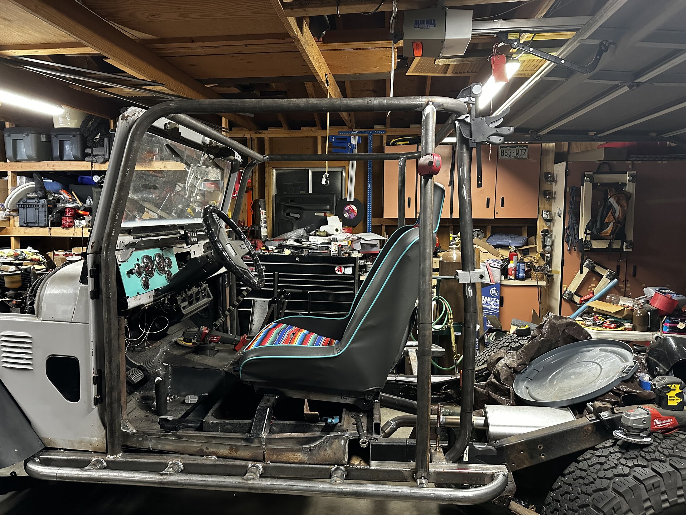

Well. I’m a liar. Haha. I decided to do the a pillar door hinge tie in points. This was especially necessary, cause it turns out the right side firewall/a pillar structure was sagging and leaning forward. These use the cage to keep the factory a pillars upright. Not going to claim correctly, as the further I get into this rig, the worse the crooked seems to span. I have a feeling this thing was in a bad wreck.
Anyhow, it’s sad how slow this stuff goes. The tie ins started with me press bending some flat stock I had, but I wasn’t happy with the look. So I switched to some 4”x.25” angle. It’s not as sleek as the bent flat seemed to look in my head, but it works.
