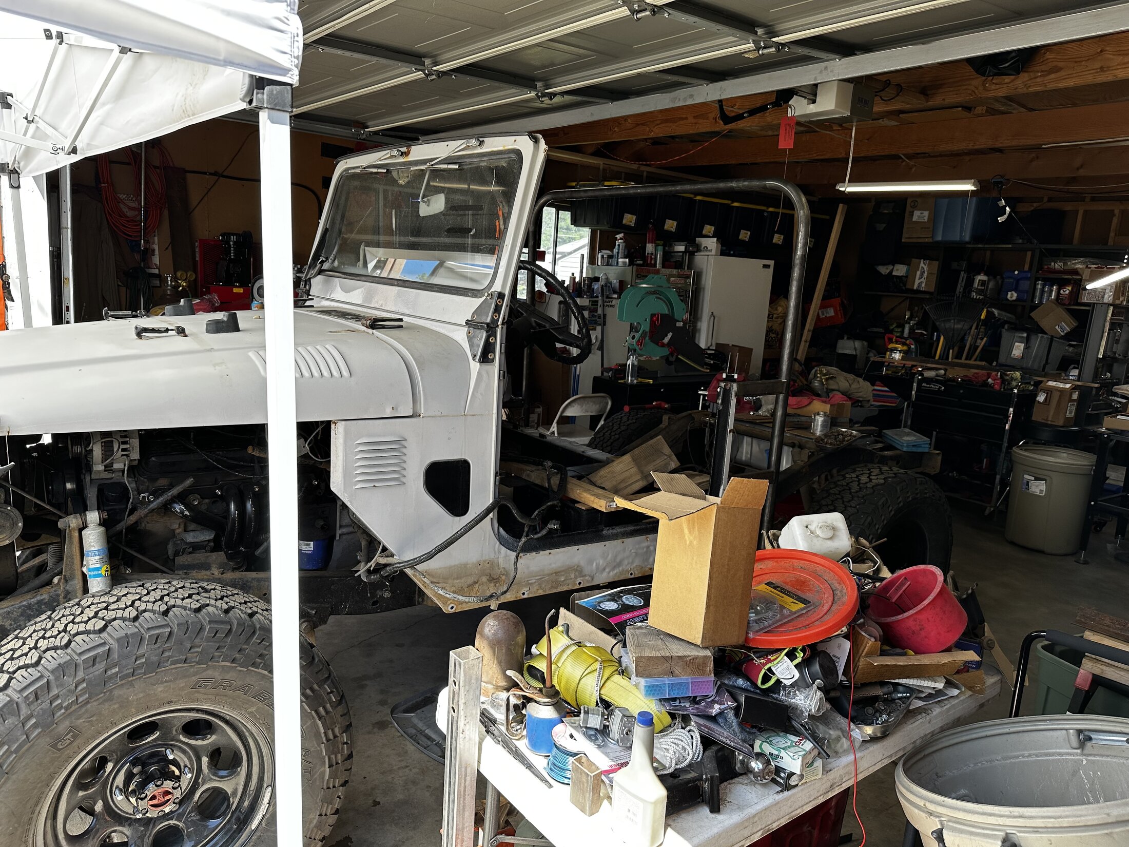

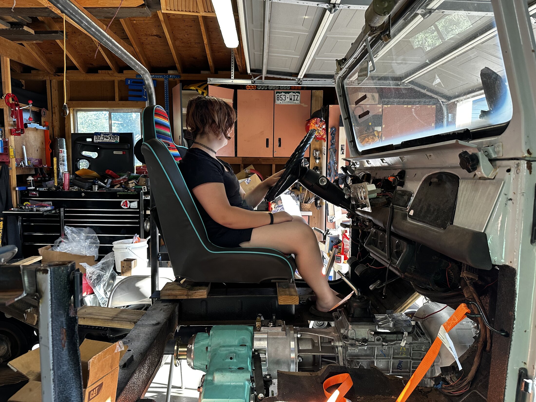

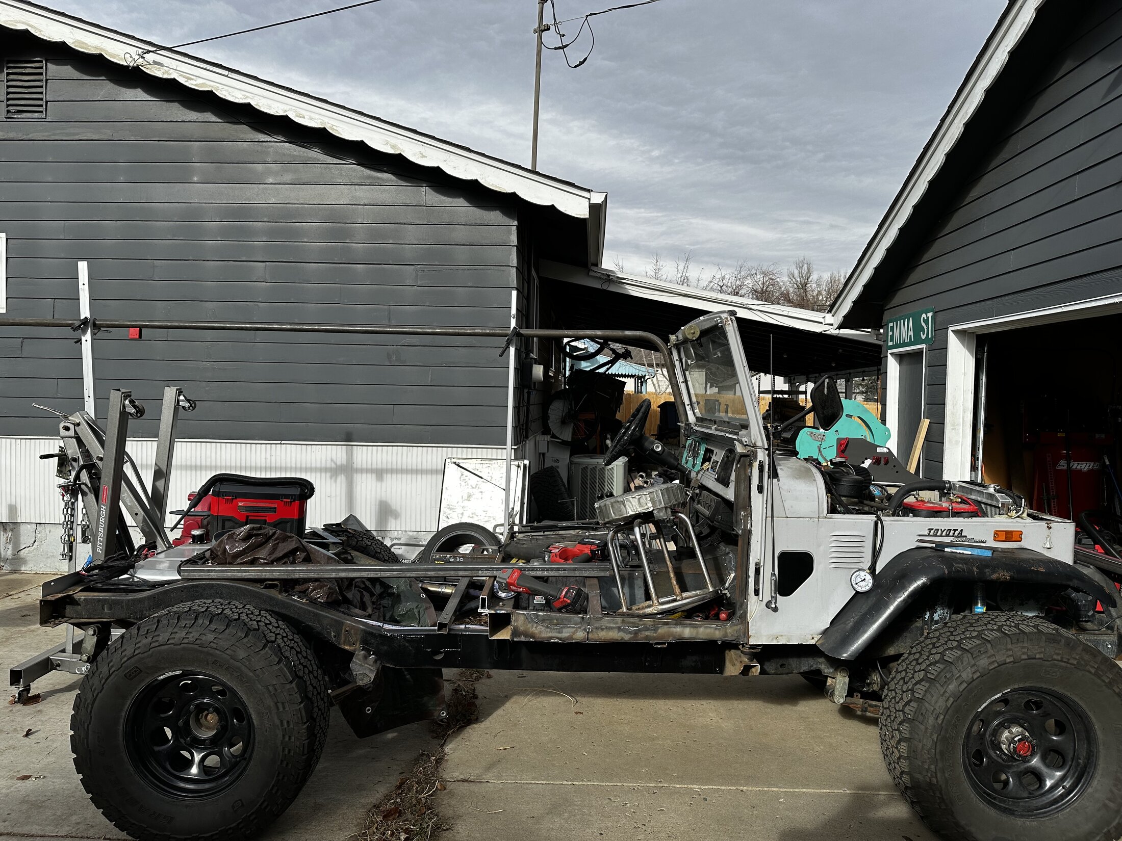

And a little test fit with the little boss lady. It is half hers after all. She is big enough to drive it now, so that will happen this autumn.
Wow. Exhausted!

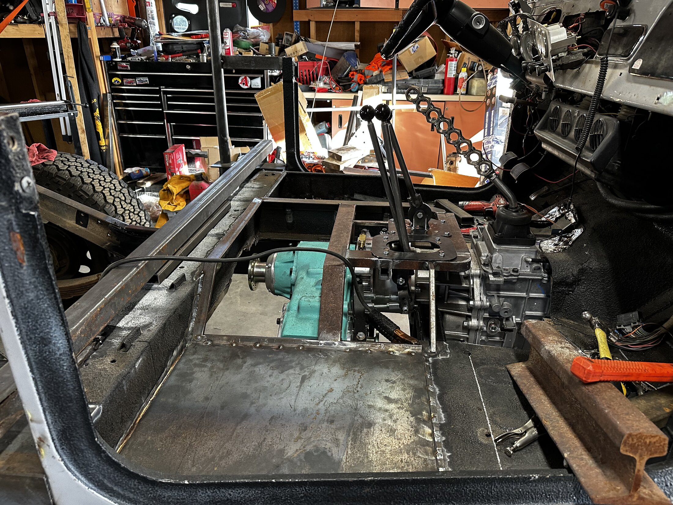

I am now left with 2 full days to get this turd drivable for the trip to Ouray. It’s likely going to be incomplete everywhere. The cage will be welded enough to not vibrate off. The floor will be incomplete. The rear cab sheet metal won’t be done.
So. Much. To. Do.

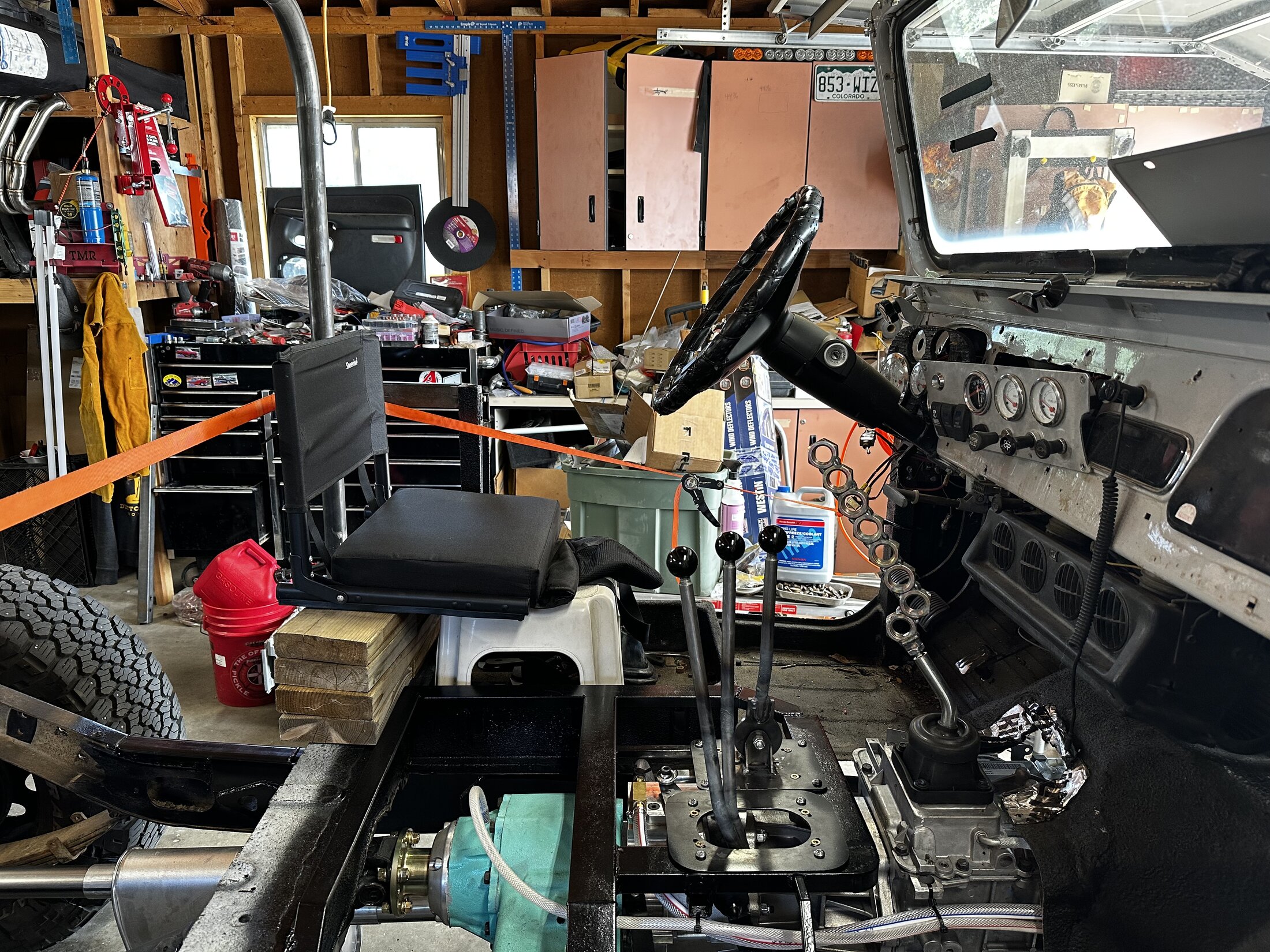

Some updates. I got it running a few days ago, and took it for a test drive today. “Test drive”. No seats or belts or….. it was a short drive to verify I have a drivable rig.
Still to do:
-drill flanges for front driveshaft and install
-reassemble dash stuff
-build drivers a pillar for cage. Add dash and windshield bars. Weld what’s there.
-sheet floor
-build seat mounts and seat belt mounts.
-complete rear of cab
-eleventybillion other things.

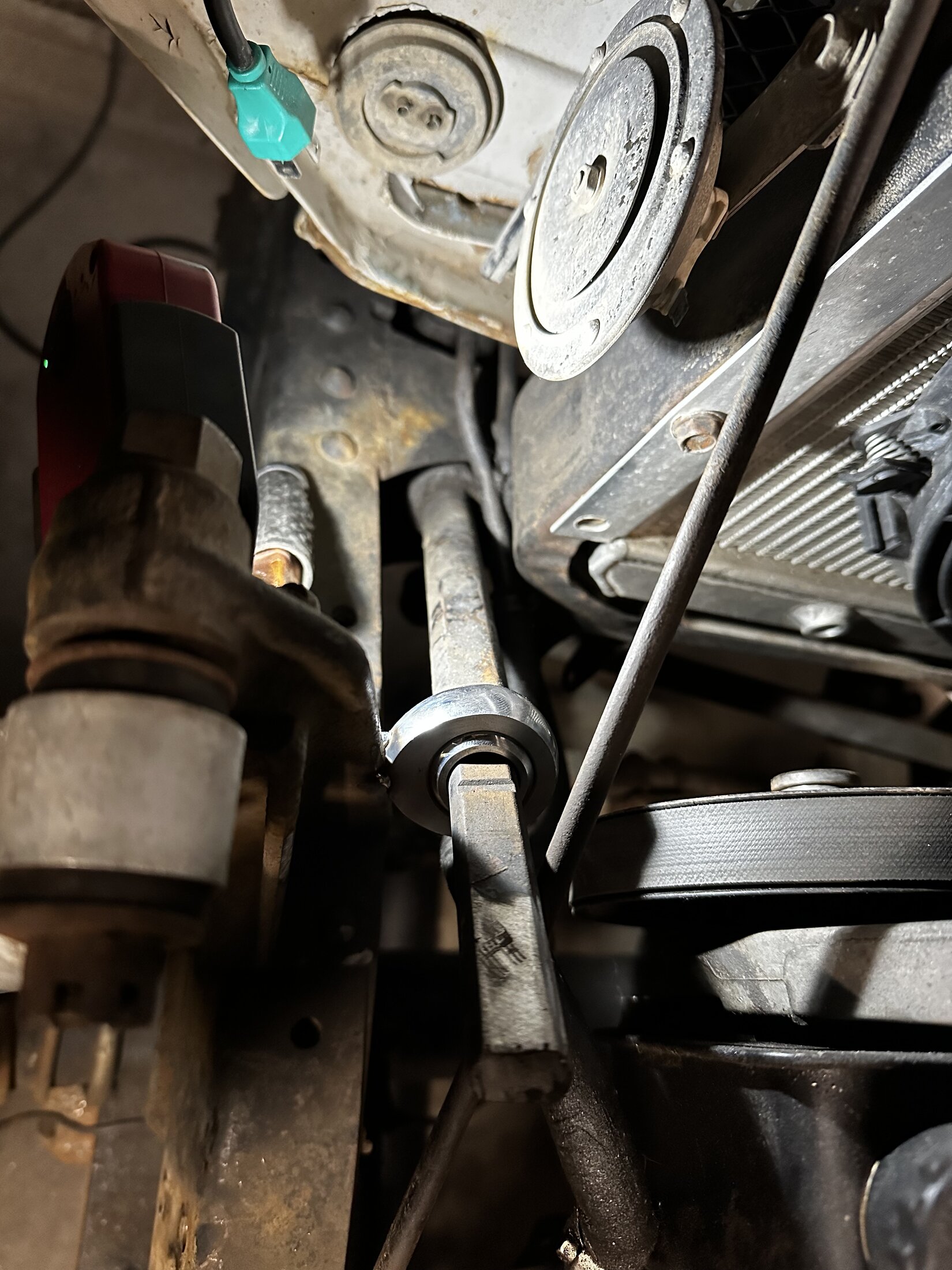

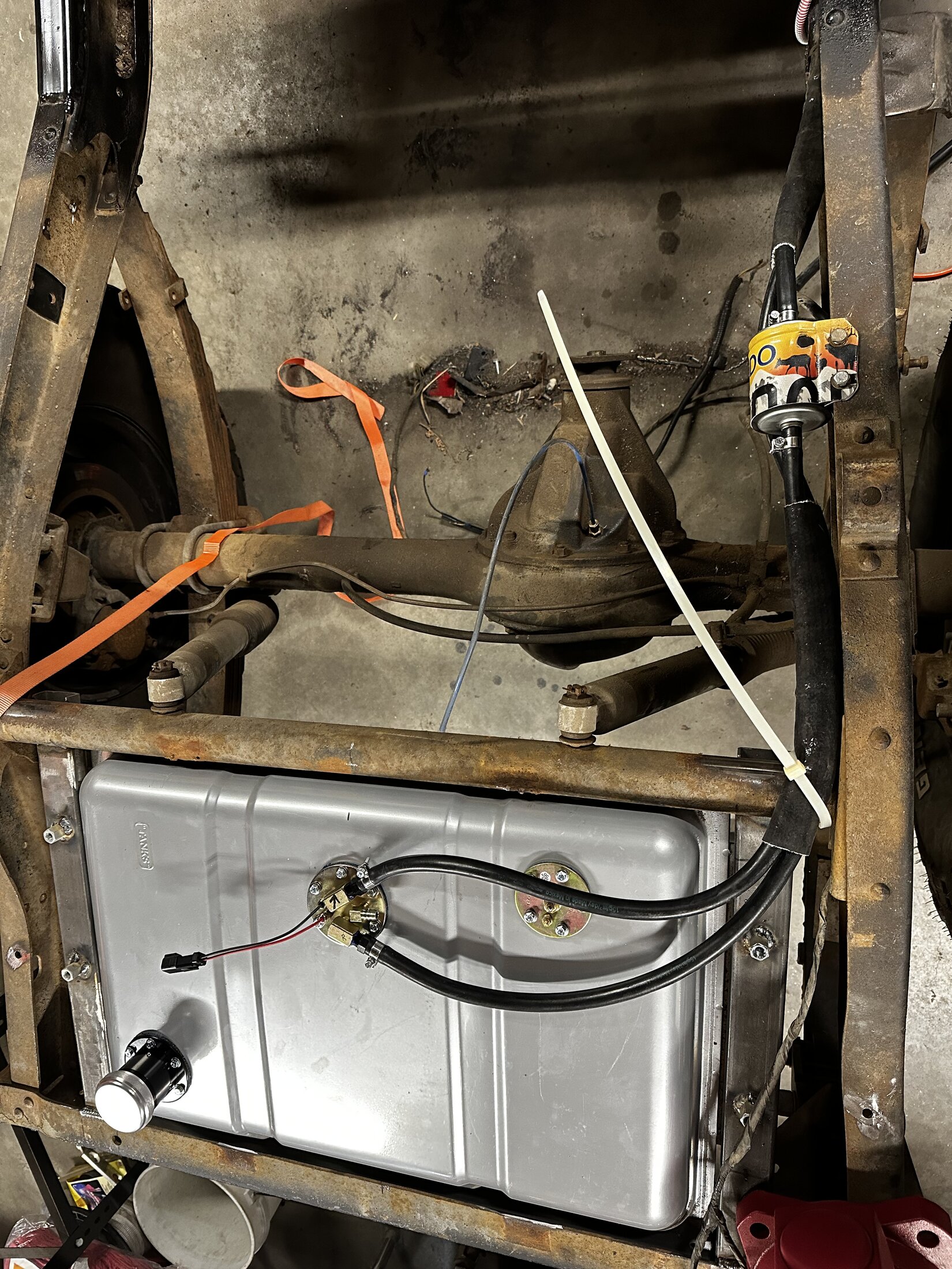

When you get a moment, can you post a few pictures of your driveline angles? I’m curious what you are working with
Apparently these are the only ones I have. And the one is oriented badly. Sorry.
If memory serves, it’s about 7-8” offset to the passenger side, and something like 8-10” down. The first pic is the first attempt, with a standard style shaft. Second pic is the double Carson that’s currently on, that I turned the pinion up for.

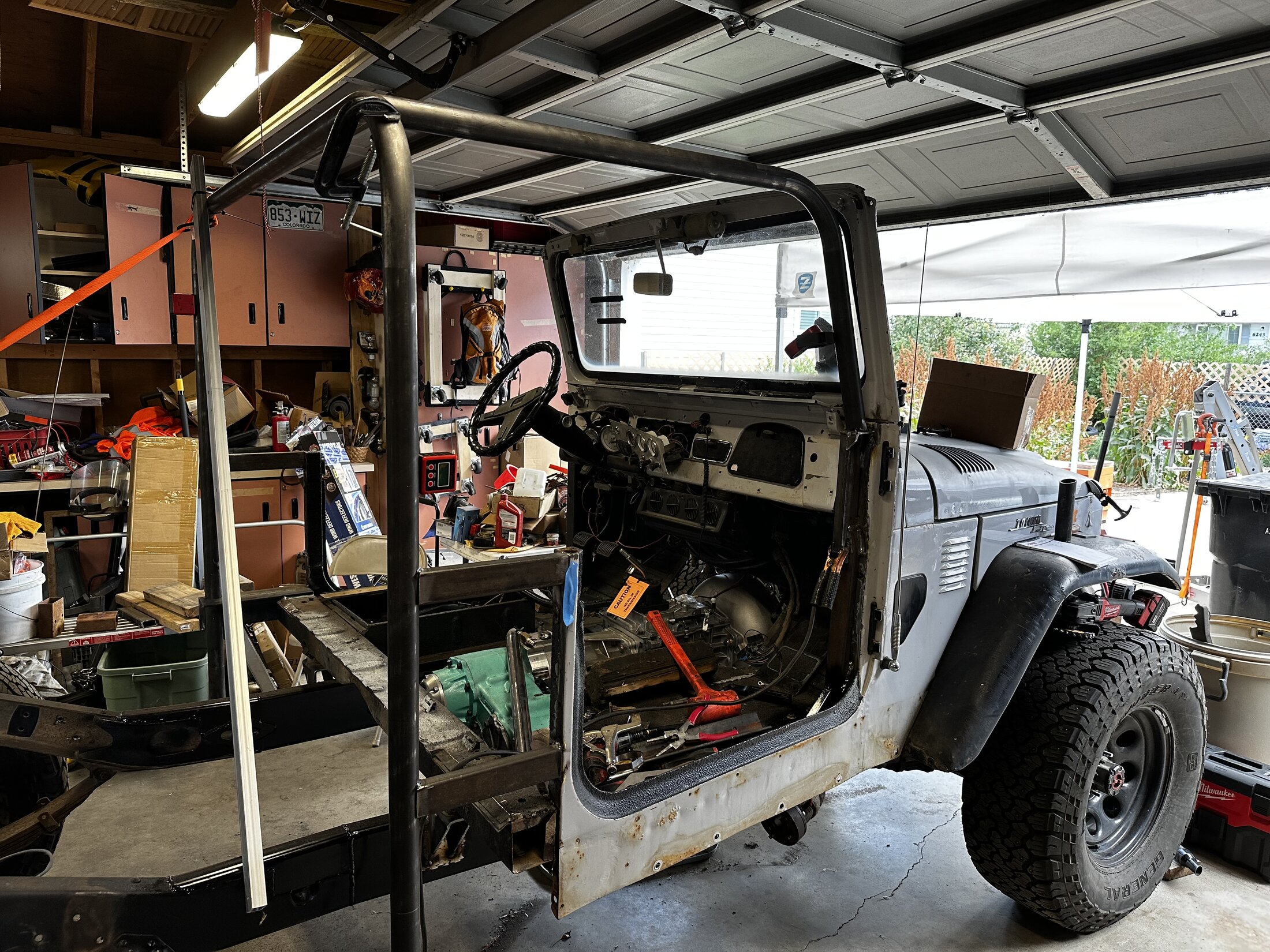

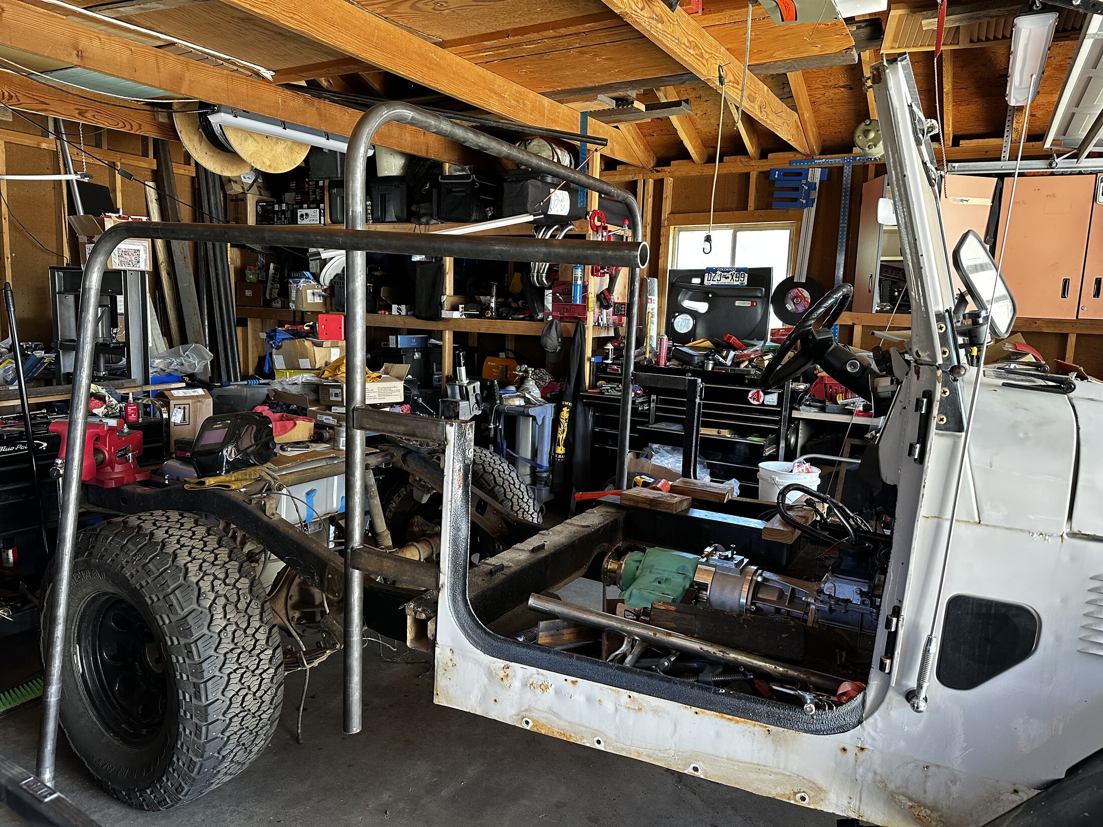

In the never ending battle of do it right the first time, I have changed the overall plan on this about eleventybillion times. I have settled on truck with a “bed”. I had the past 7 days off, and with the amazing weather, was able to changes the entire cage design/direction, YET AGAIN!

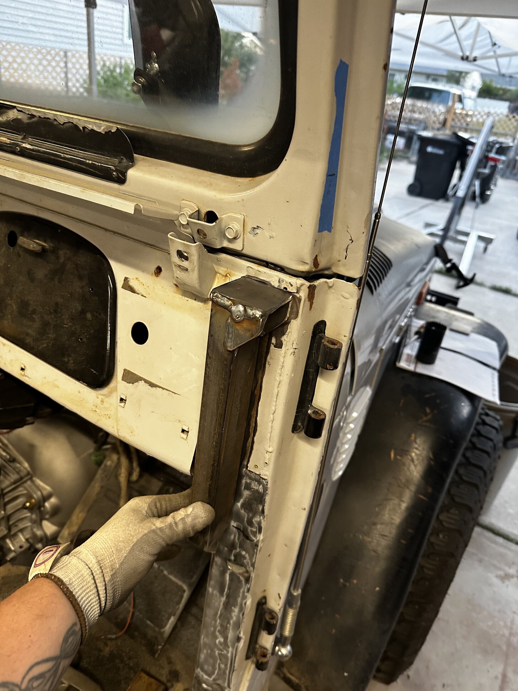

So I cut a bunch more Land Cruiser off. The cage will now be the door frame at all points. This is a great thing, as I want the door opening longer to avoid elbow pain. Getting the A pillar roof halo bent in one shot, and 99% correct was satisfying. Quite difficult.

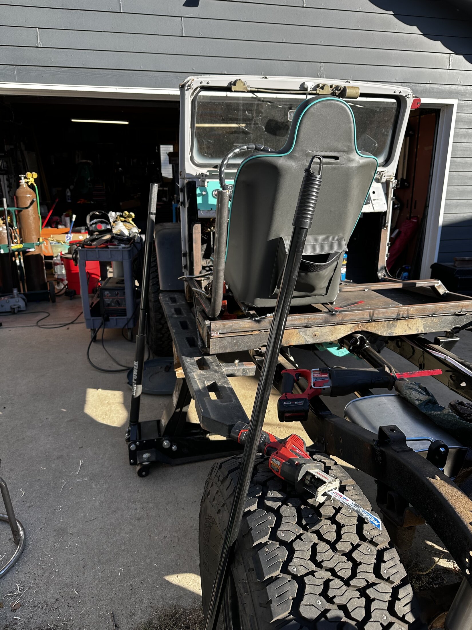

Got the slider bases and A pillar contraption welded together. This part is on for good now. I’ve got 2 legs holding it all together to the frame currently. The end result will have multiple more at various angles to triangulate, as well as the lowers being done for boat side skids.
Today I got the B pillar plan mostly figured out and started making the sliders to be able to attach it. Should have a lot more progress tomorrow with the current direction.
