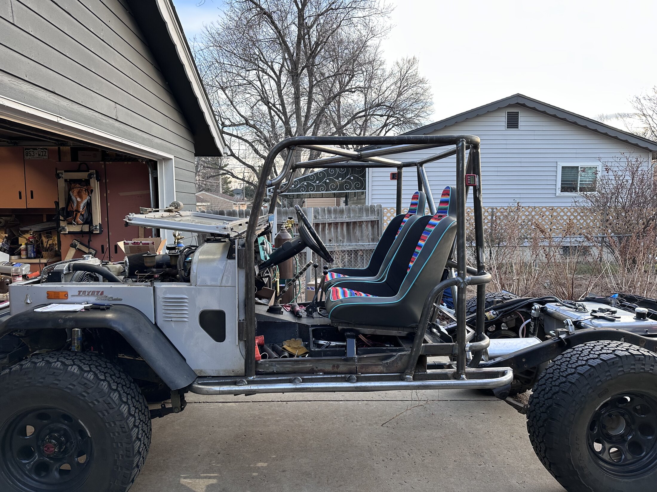

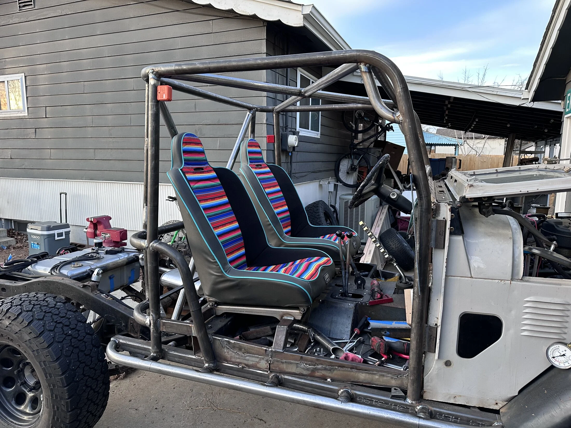

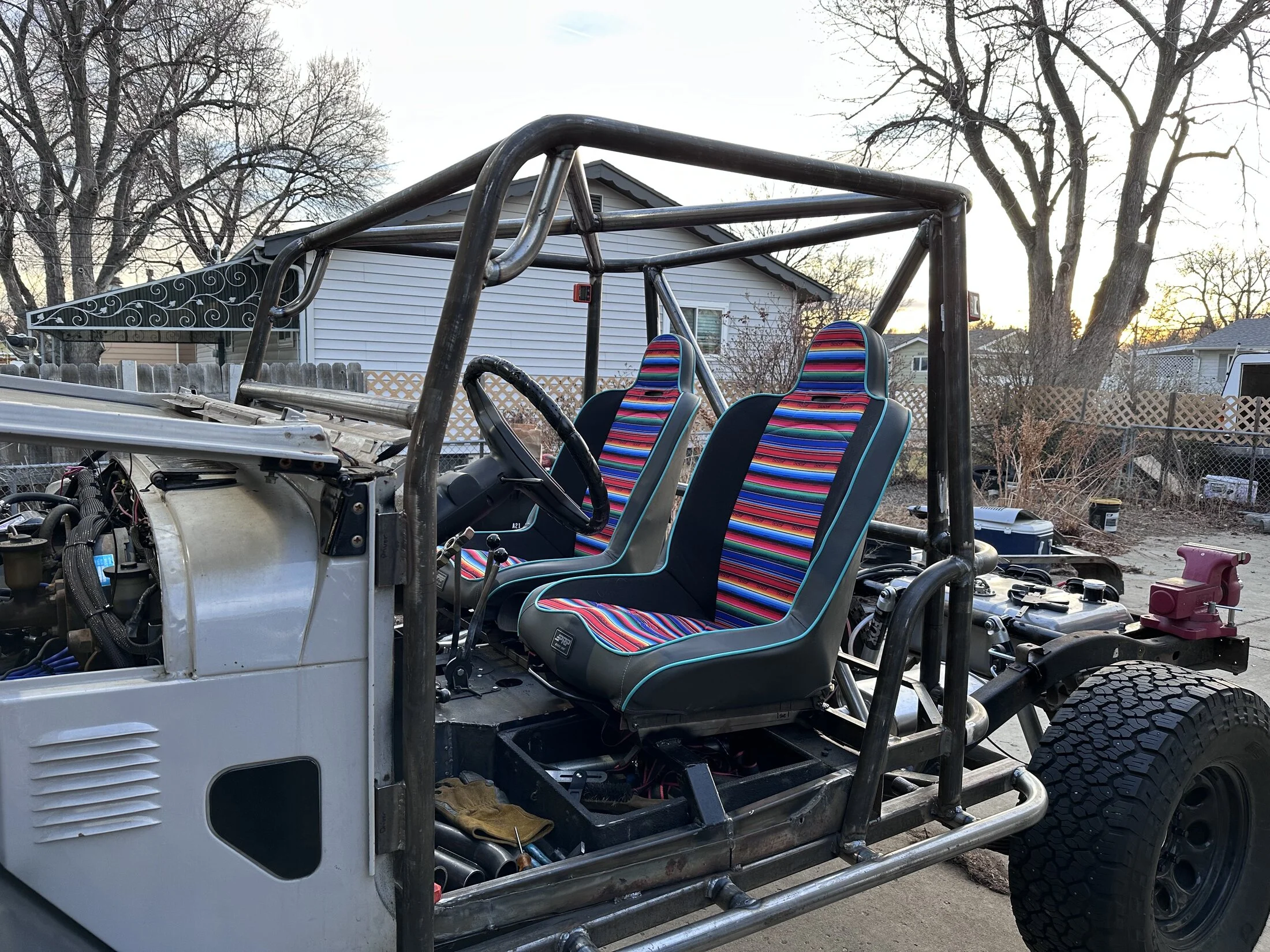

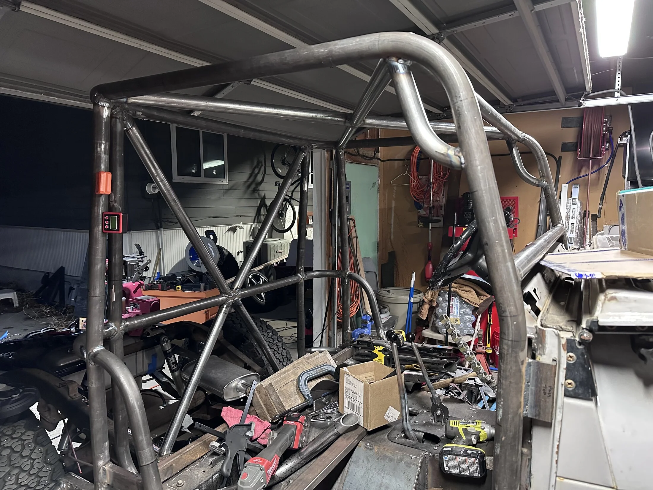

What is you plan for sheet metal? Are you going to enclose some of the cage or leave it open?
The lower portion of the cage, about where the normal top of tub is, will be sheeted somehow. Not certain if I’m doing weld in permanent, or removable. The top will get some aluminum permanent removable. Hopefully a street sign of some kind. Upper section and above half doors will be permanent open. Though, I have considered adding expanded metal or some Raingler netting for road debris. That decision will be made when the bed section is done.
As far as staying warm, I’m 300 pounds, and don’t really get all that cold. Though I’m less resistant as I once was, at 42 and having had my medical issue a couple years ago.

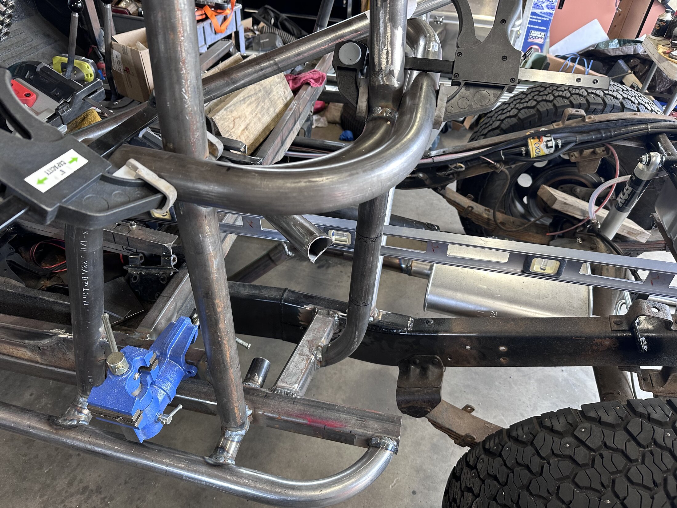

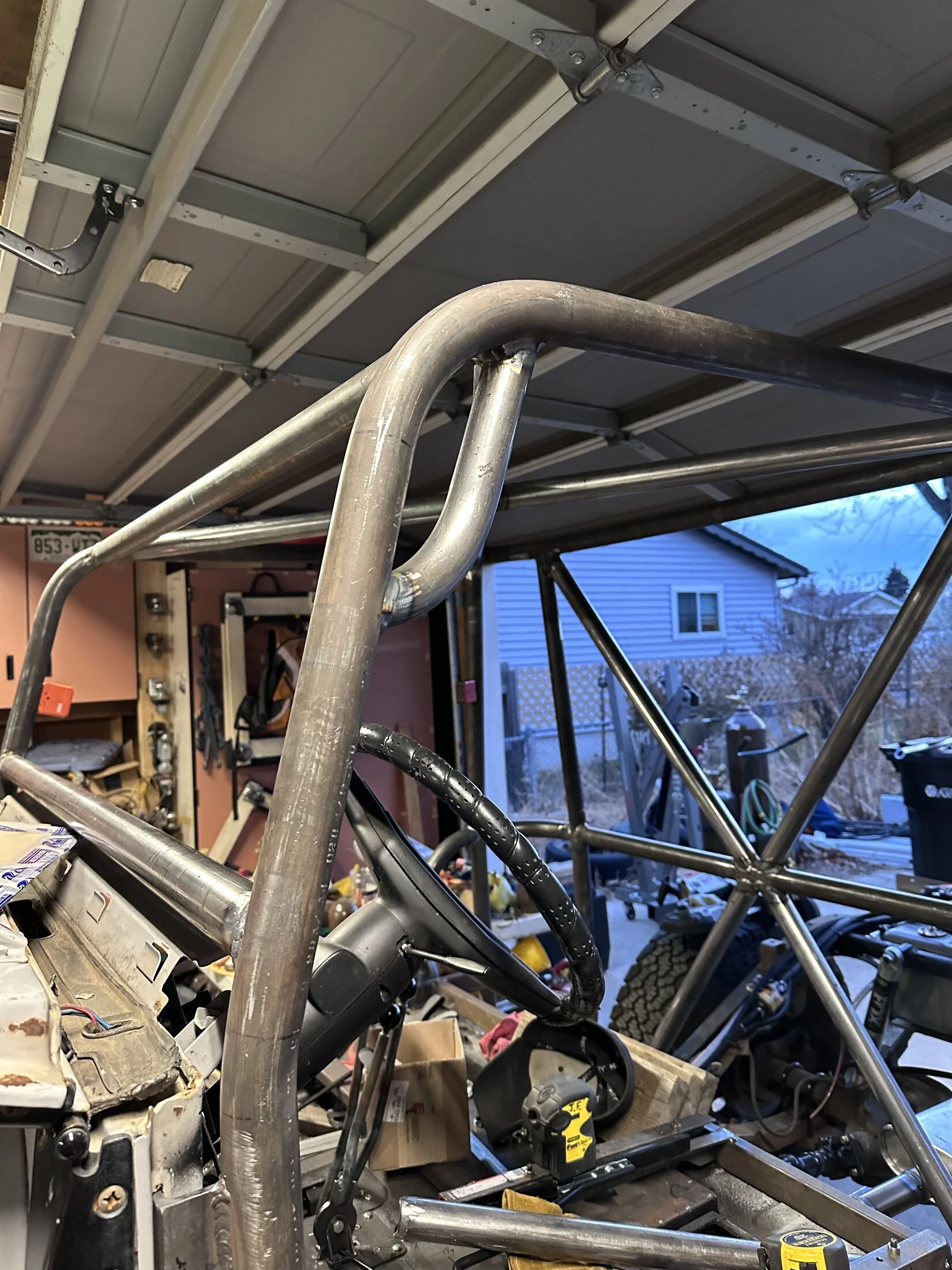

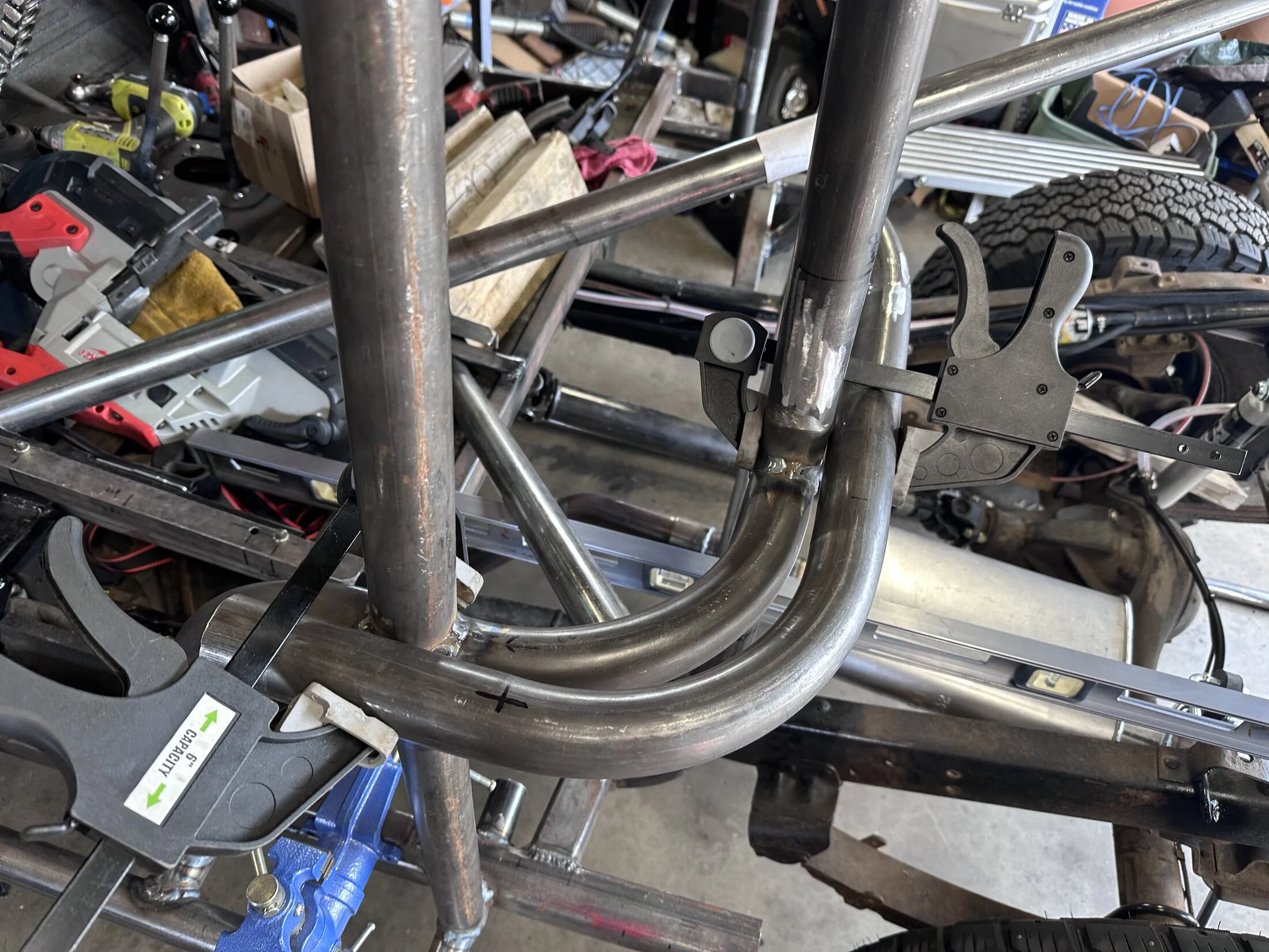

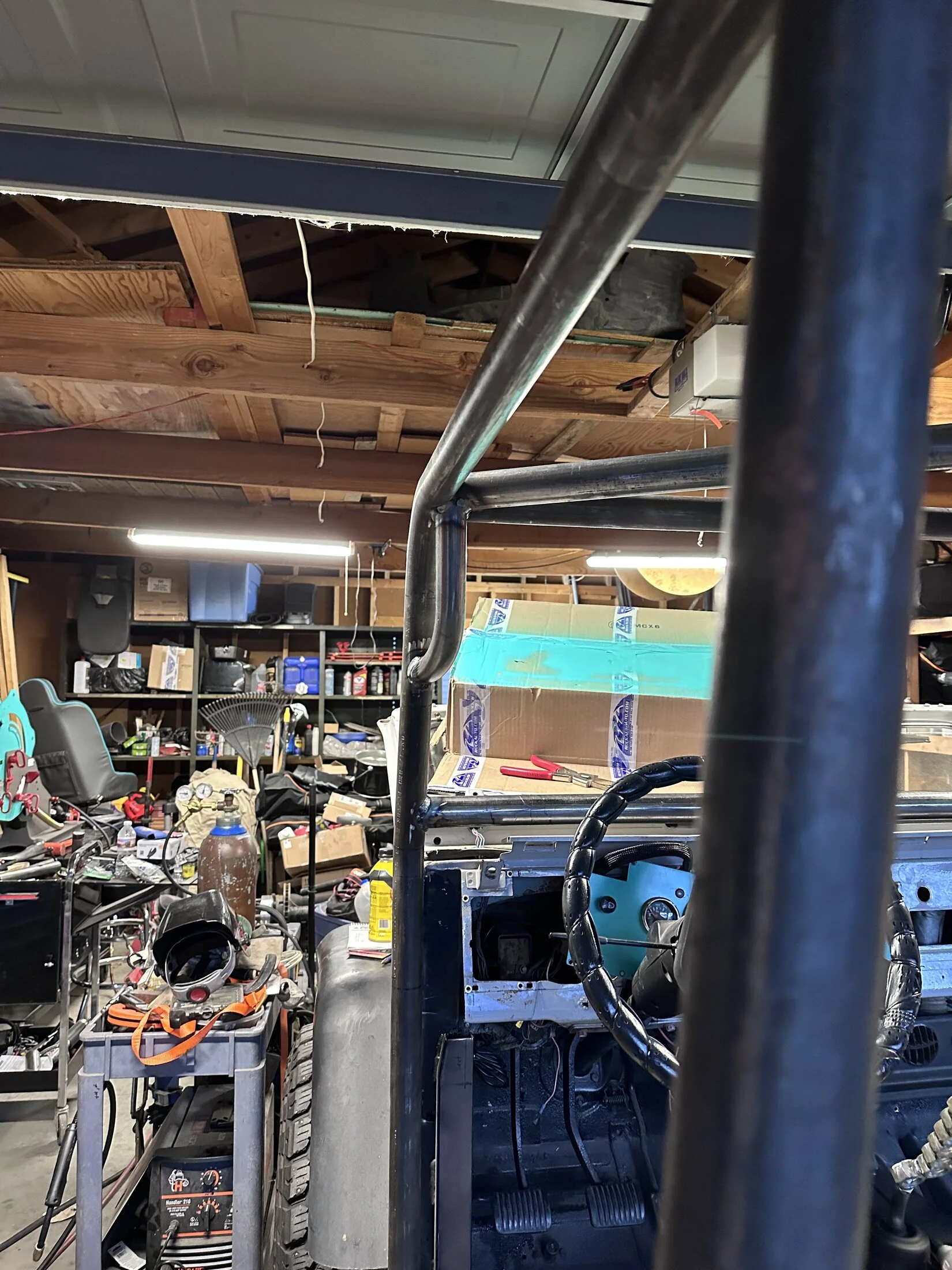

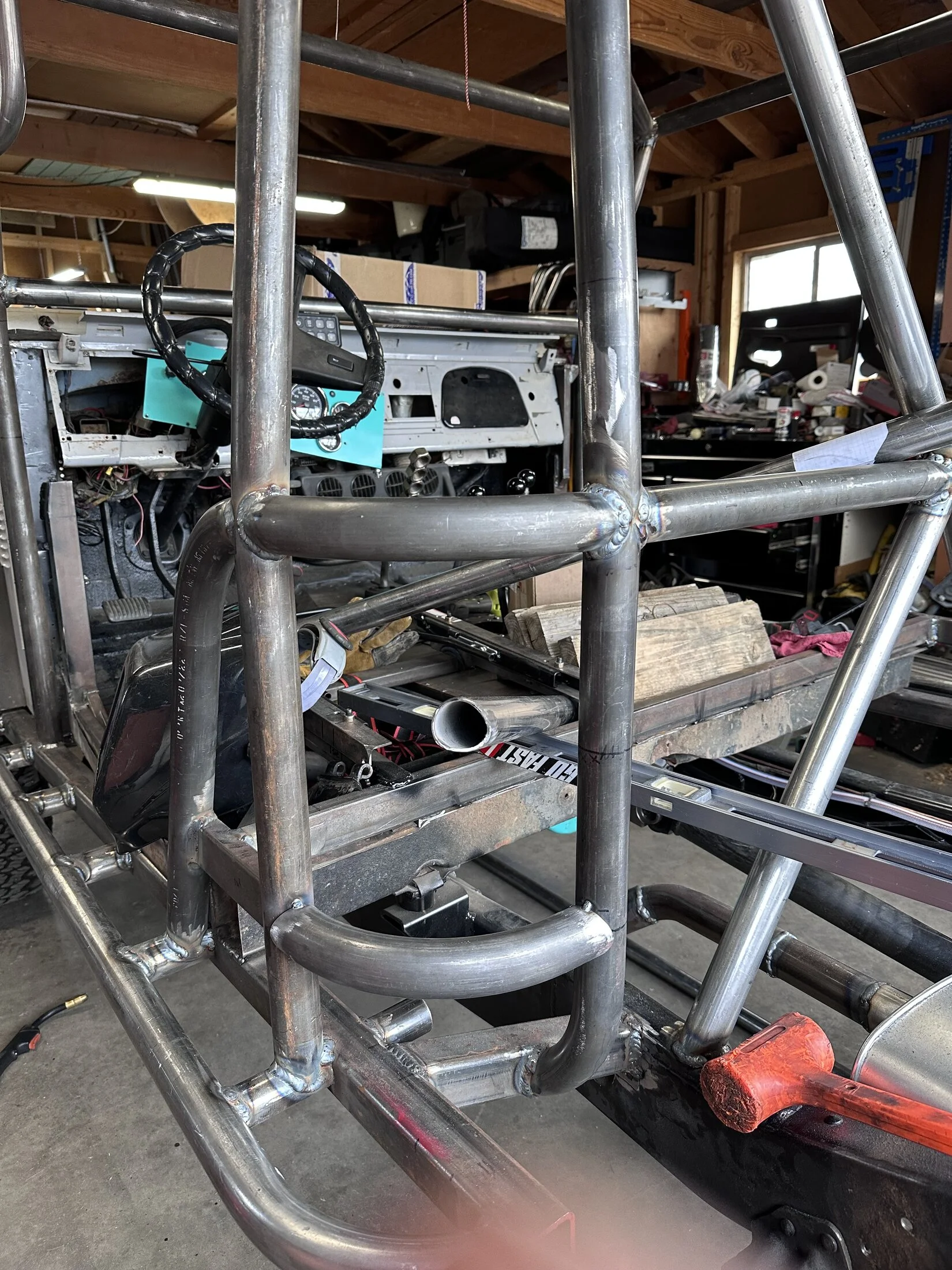

Knocked out the grab handle gussets. They oppose the bent tube, and weld to all 3 tubes in the node.

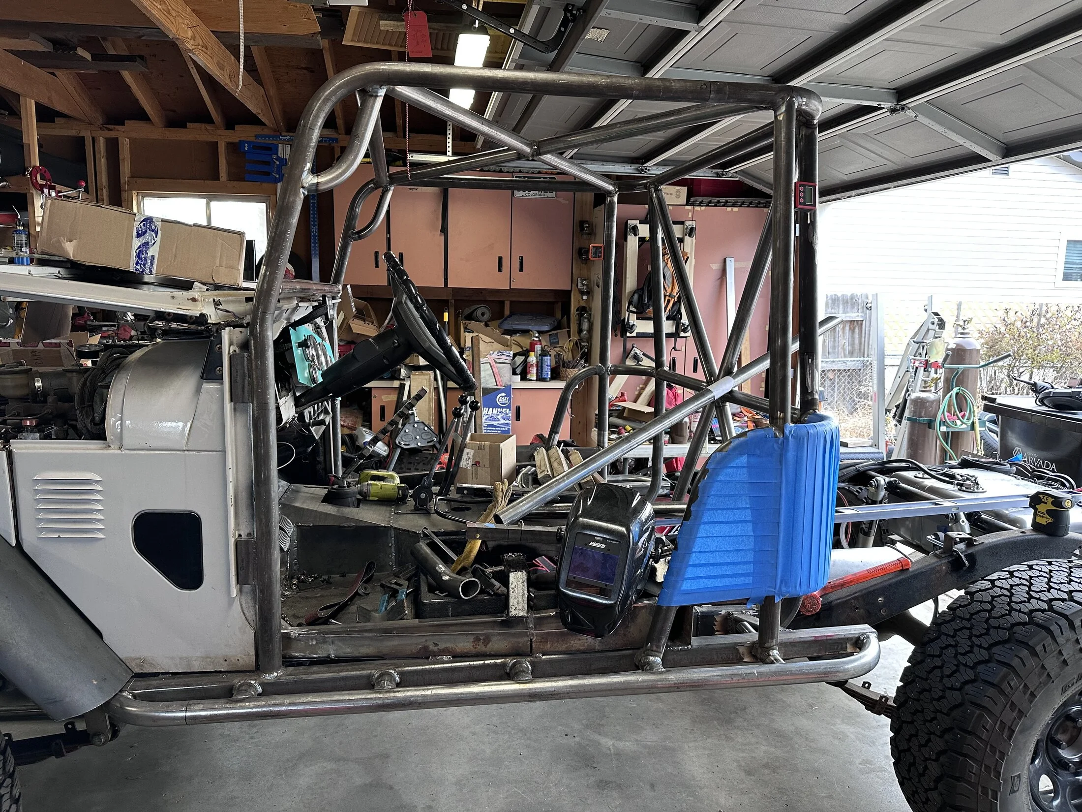

I can’t believe I’m typing this, but I might cut the frame in half again! ****.

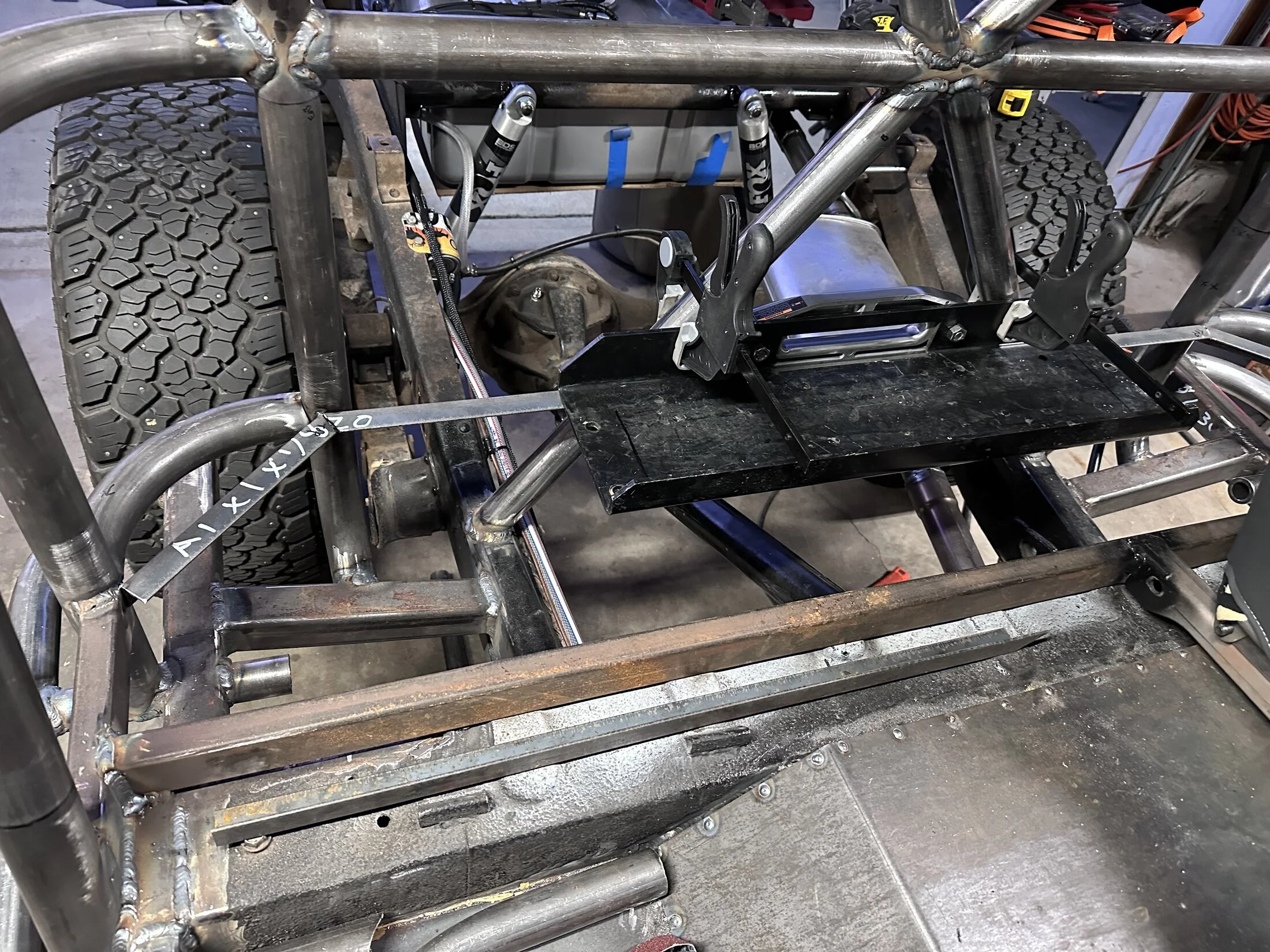

So current dilemma is the rear winch is being mounted in the cab so I can reach the handle. Also allows to run as a rear winch or suck down. Also adds trailer tie down options. Hell, I could use it to save Timmy from the well!
But…. This current mounting point is just above the fuel tank in it currently position, with me lowering it 1”. So it will clear. And run just under my “bed” design I have in mind.
Or….. I cut the frame rails off, delete the rear as it is completely, move the tank to behind the cab, but low as possible, and run the winch to just above my driveshaft high point.
Then fab up new rear rails based on the 4 link it’s inevitably getting.
Damn it.
Damn it.
We have a disease.
False alarm! Should have kept measuring! Hahaha. Carry on with your Chic-fil-A free day.
I love it when a plan comes together!
Thanx Fellas. It’s an arduous process changing as you see things. I really should cut and back half. But, I want to use it this year dang it.

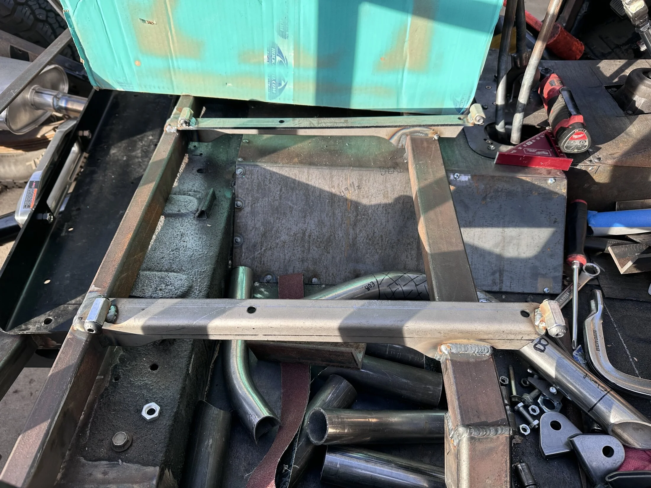

Anyway. I got the in cab rear floor supports figured to locate the winch mount. The helps dictate the rear of cab sheet metal. Also the rear floor shape. I have an idea of how the winch plate mounting will go. But that’s for another set of days off.

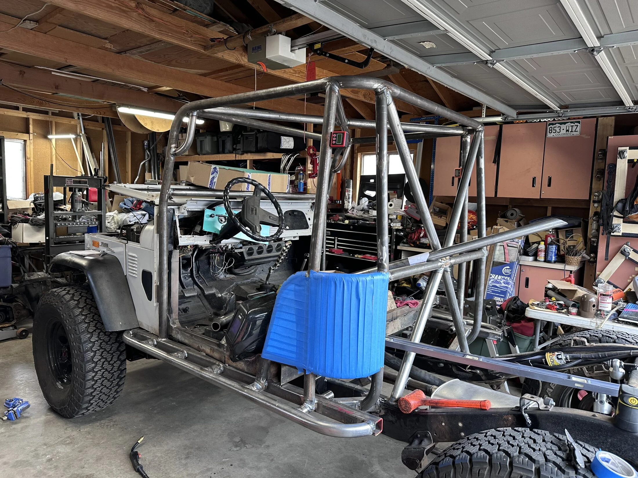

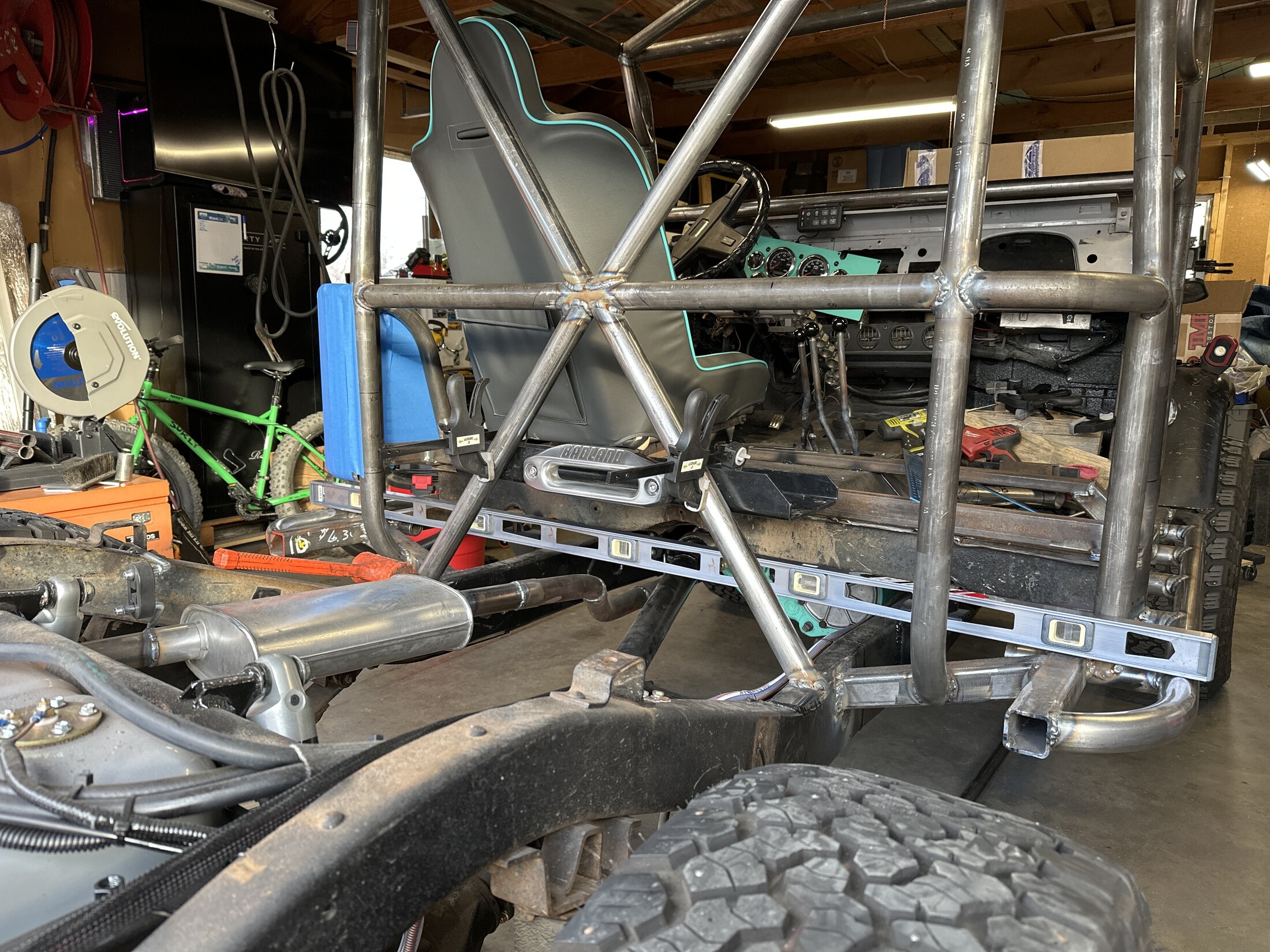

I also ended the day with putting in the passenger seat mounts, to match the driver side. Still not certain if this seat will slide, or just pivot. Forgot to take a pic though.

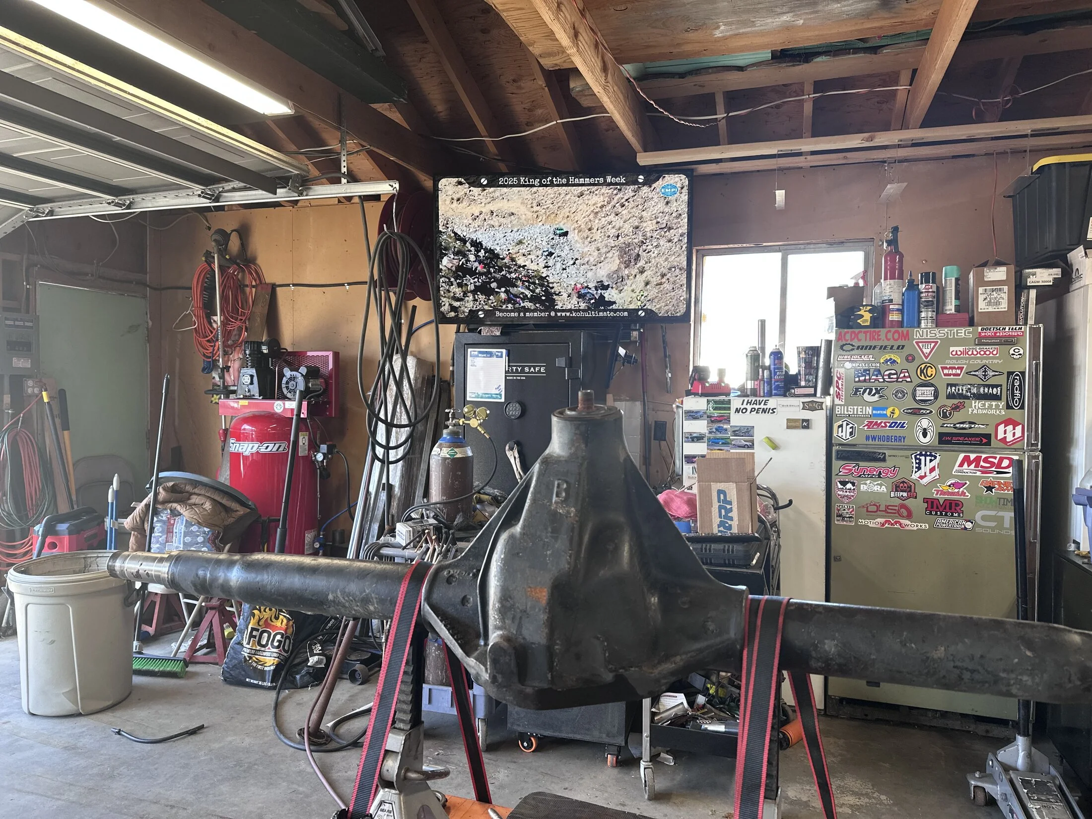

Got out to the garage today to watch the KOH Everyman challenge and tear down my rusty $200 Dana 70. Turns out it is a 76/77 F350, 1 piece open diff, 4.10, 35 spline, dual rear wheel. Assuming it still has the original hubs on it, they come in at 64-5/8” WMS. This thing was almost completely seized, and still is at the side and spider gears. But to my shock, the wheel bearings are fine. Win. It’ll be getting new gears and different, so I’m in real good shape there.
Doing some soul searching, mainly that of wanting to use it this year, I’ve decided to remain leaf springs for the time being. Perches, u bolts, spring plates, and brake caliper brackets were ordered today with the KOH 15% off sale at Ruffstuff specialties. As well as hub and shaft flange seals from rockauto. Also found a great deal on a D70 master regear kit with KOYO bearings. $175 shipped. I’ll just need gears, the diff, a yoke, and calipers to be done with the rear axle.
