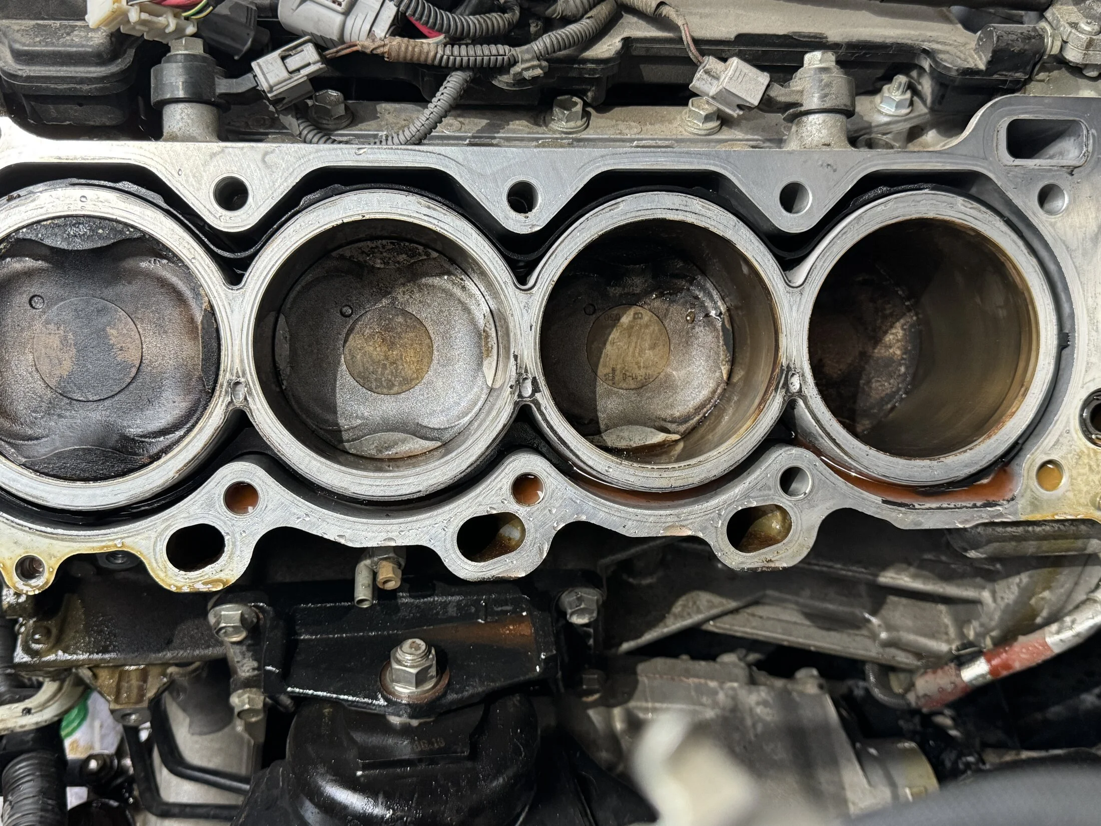

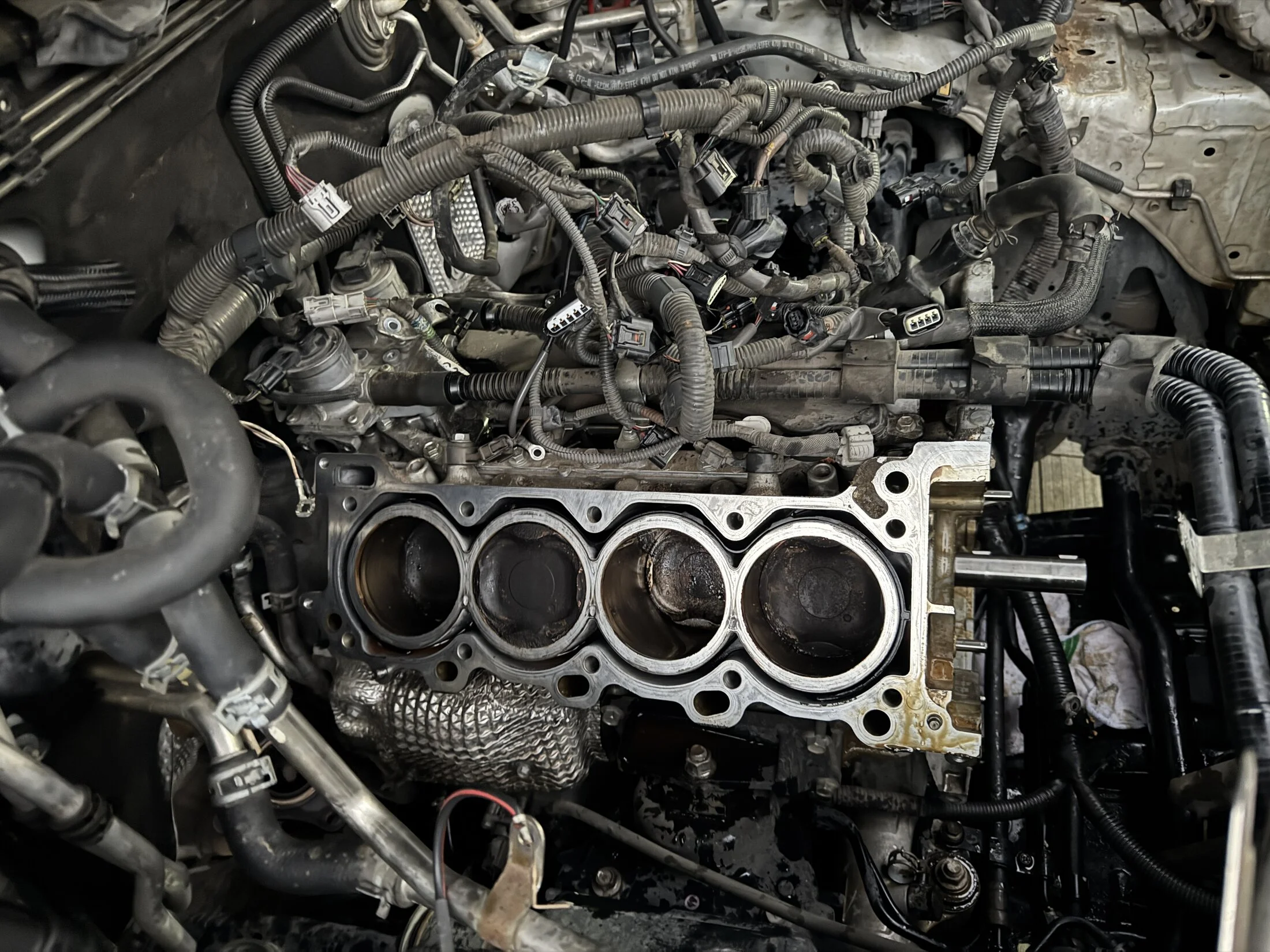

This is a 2014 Land Cruiser with 220k miles. I see 4 cylinders with coolant steam-cleaning the pistons and it has never been over heated. The coolant passage between each cylinder seems to be the cause for each clean piston, so I would concur with TCCN in my opinion (For what it's worth).
Yikes! Did you check if the head and/or block warped? Could you post a picture of the failed head gasket - although based on your description I assume it would just demonstrate the same failure pattern at the coolant passages closest to the cylinders.
Anyways sorry if this is your truck. Not something anyone wants to have happen to just a 10 year old Toyota, let alone a "Land Cruiser".
I actually bought this cruiser knowing it had a bad HG. I don't know the maintenance records before I had it, but he was chasing a misfire code for a long time. My guess is the maintenance has been ongoing during his ownership from what I can see and from working on cruisers for a career. When I got it I did a standard combustion leak test, and there was exhaust gases in the radiator.
I didn't take pics of the HG yesterday, but it has the same failure point as TCCN talked about. The coolant port running between each cylinder appears to be where it was exchanging. It will be interesting to see how many HG failures I will see, but to be honest this is the first 200 we've seen with a blown HG. Most of the time we are just doing PM on the 3UR, or installing super chargers ;-)
