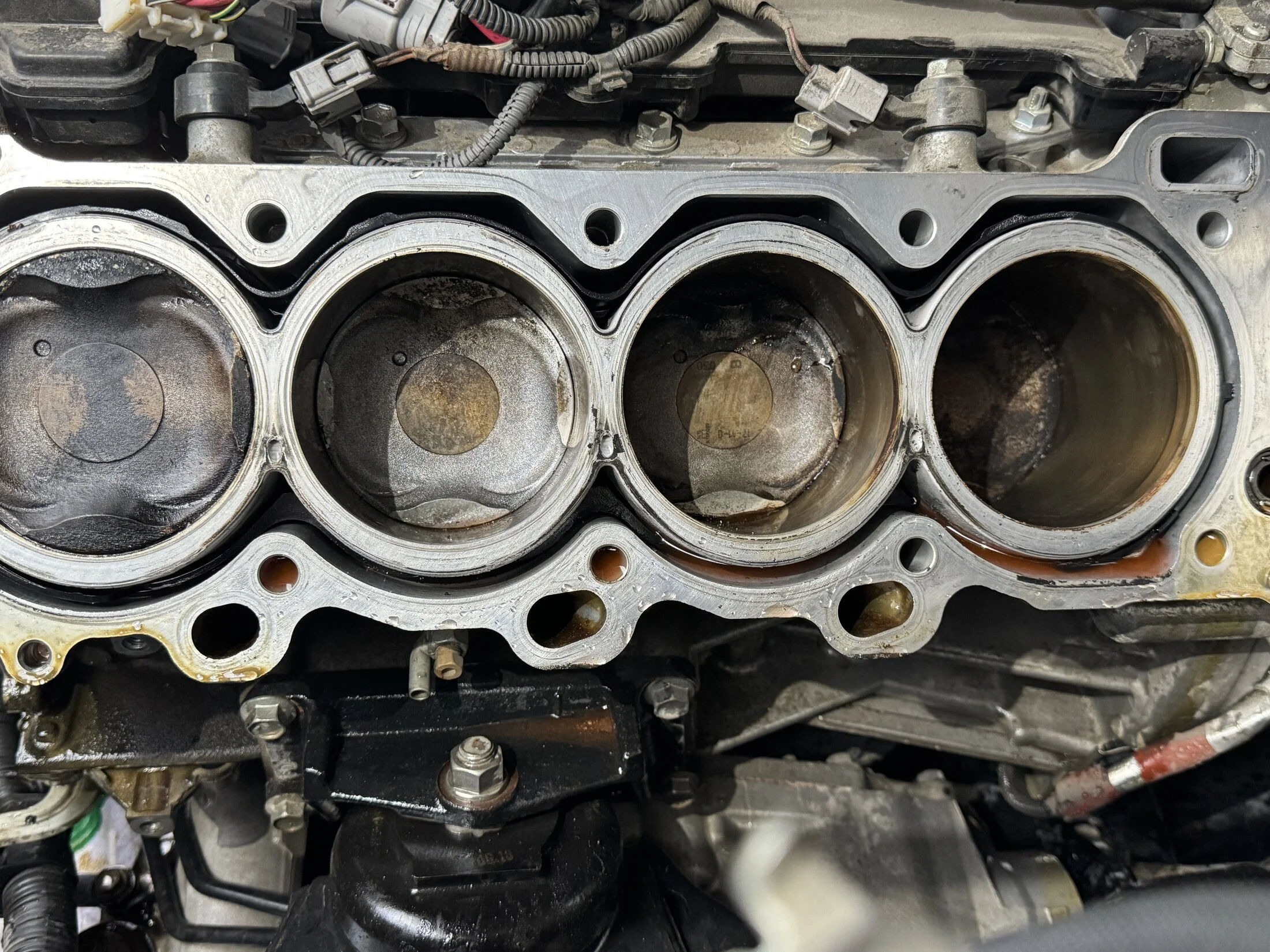

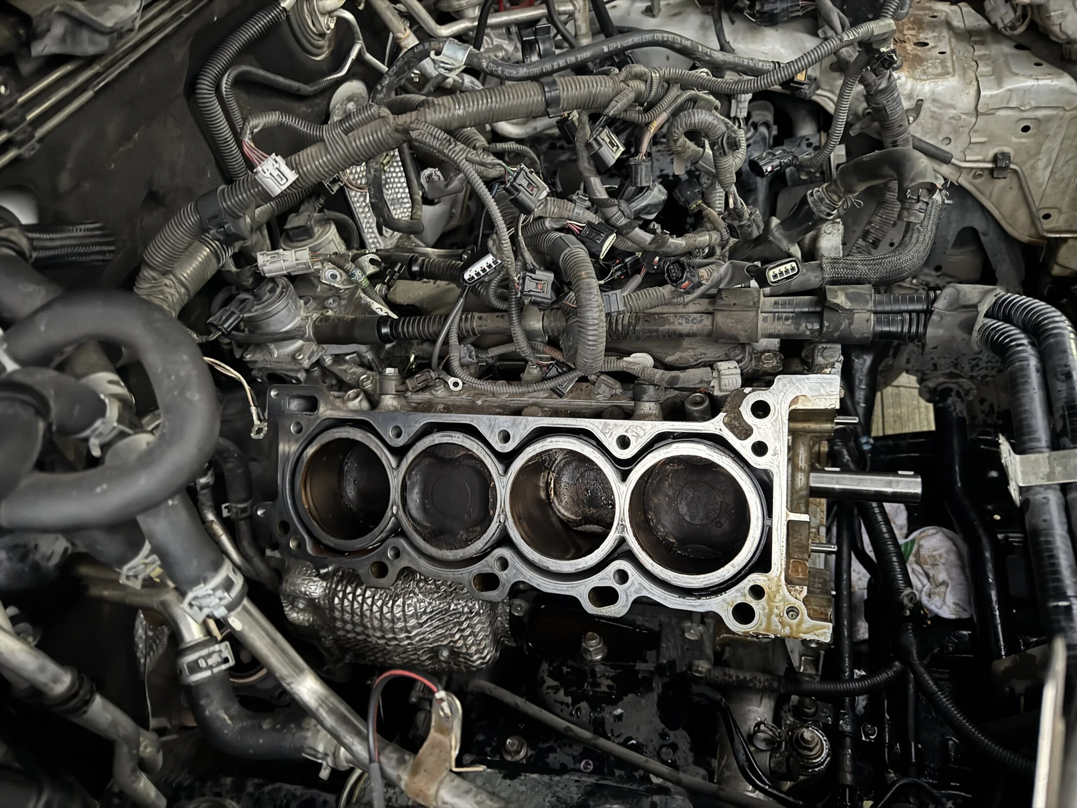

I actually bought this cruiser knowing it had a bad HG. I don't know the maintenance records before I had it, but he was chasing a misfire code for a long time. My guess is the maintenance has been ongoing during his ownership from what I can see and from working on cruisers for a career. When I got it I did a standard combustion leak test, and there was exhaust gases in the radiator.
I didn't take pics of the HG yesterday, but it has the same failure point as TCCN talked about. The coolant port running between each cylinder appears to be where it was exchanging. It will be interesting to see how many HG failures I will see, but to be honest this is the first 200 we've seen with a blown HG. Most of the time we are just doing PM on the 3UR, or installing super chargers ;-)
I would concur with TCCN in my opinion

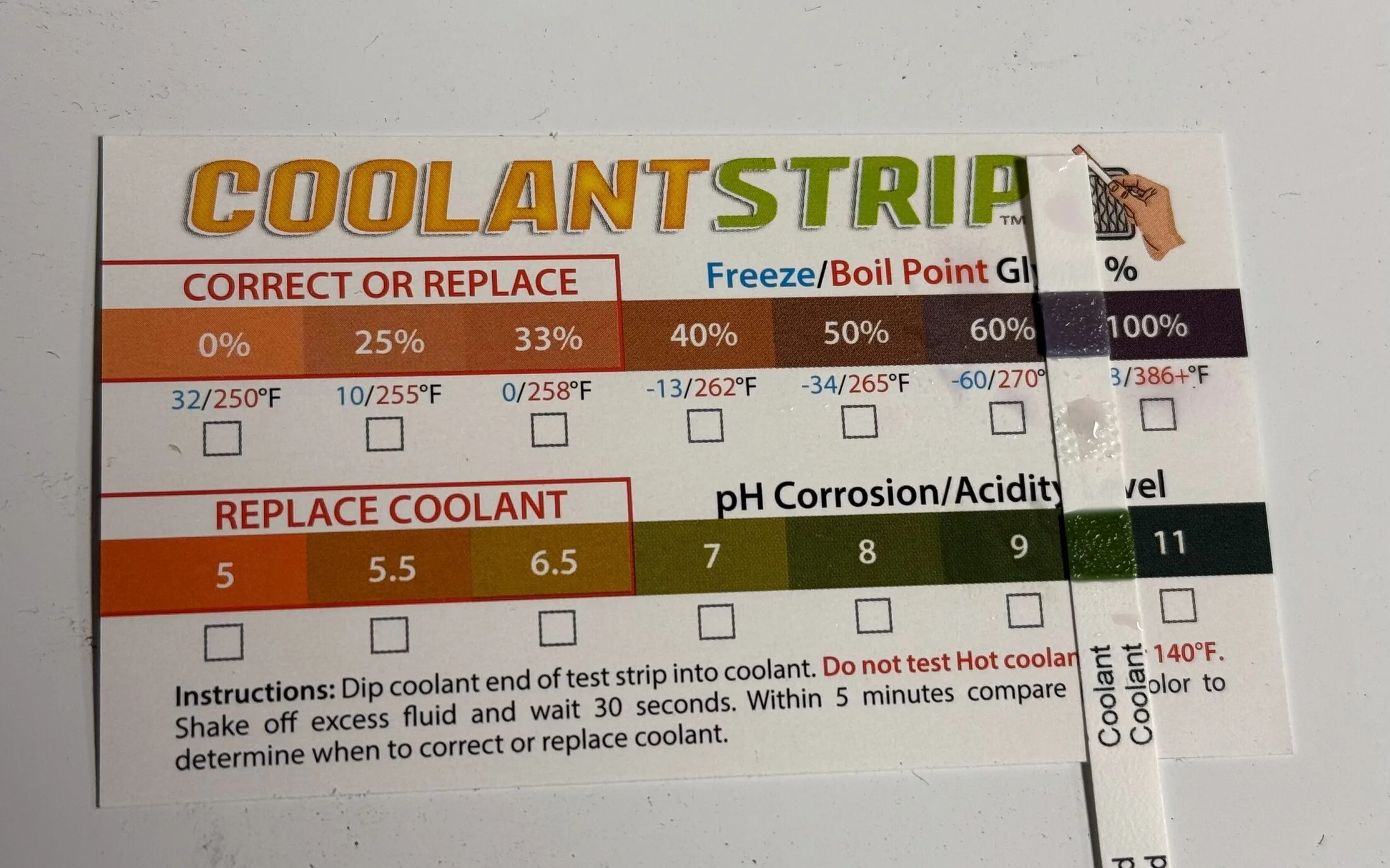

Hate myself for reviving this but data is data:

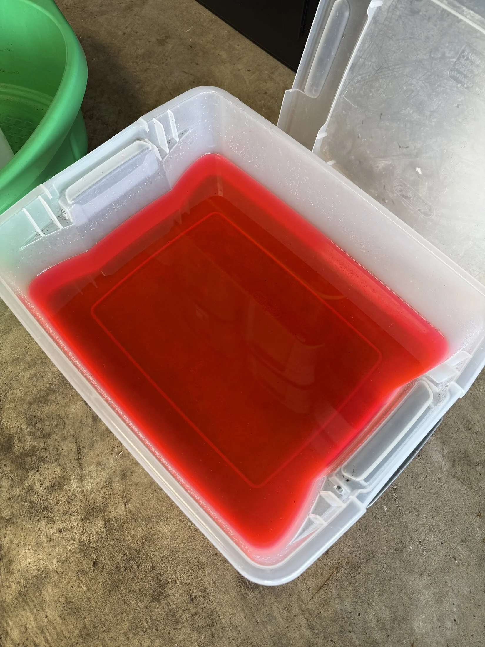

2017 LC. Changed coolant this weekend at 107,432 mi. I bought a year ago at ~98k and only have a handful of service records so I do not know if it has been changed before. Here are the "test" results and old coolant condition
