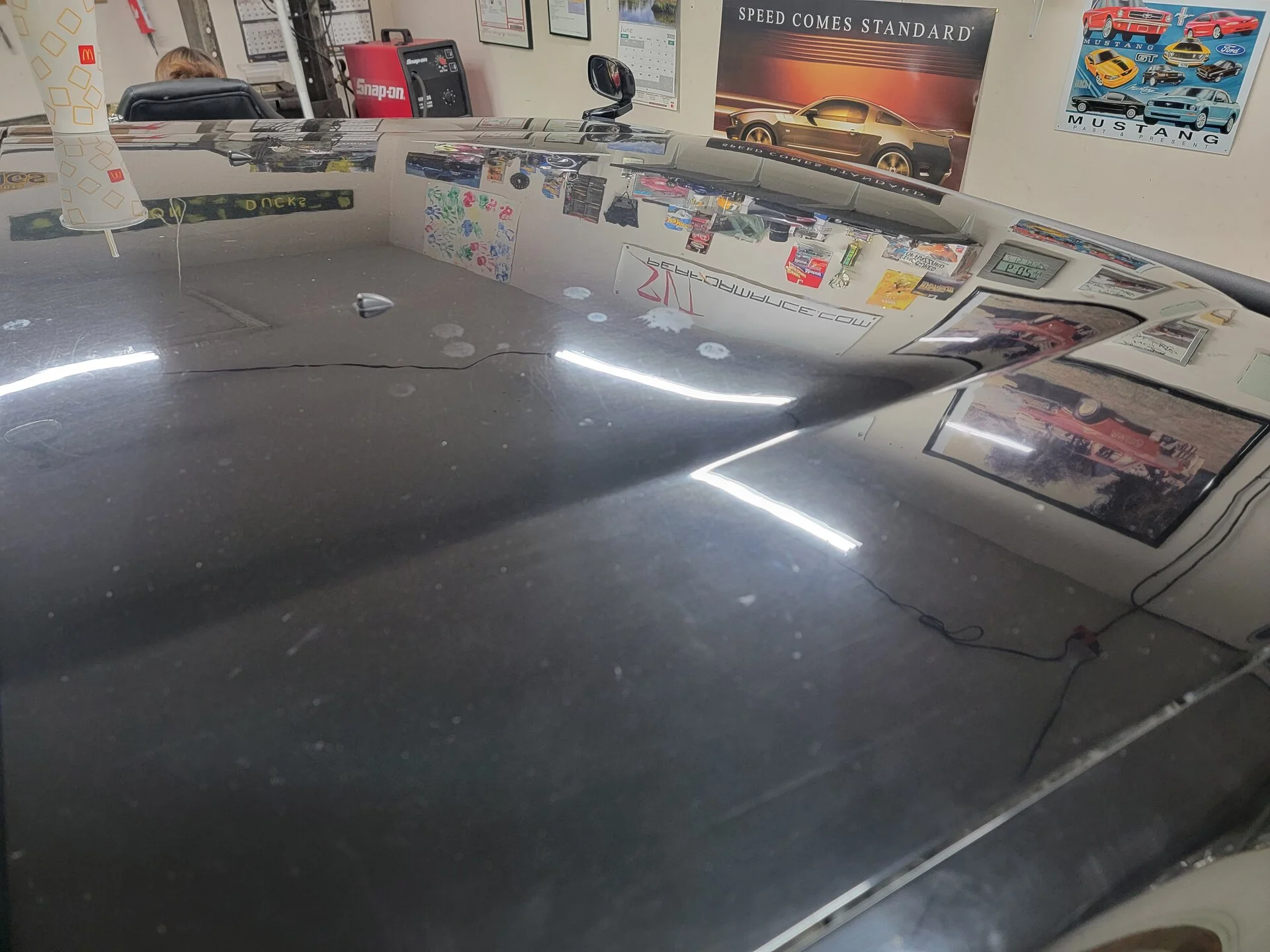

I also pulled out the da and buffed the ole girl.

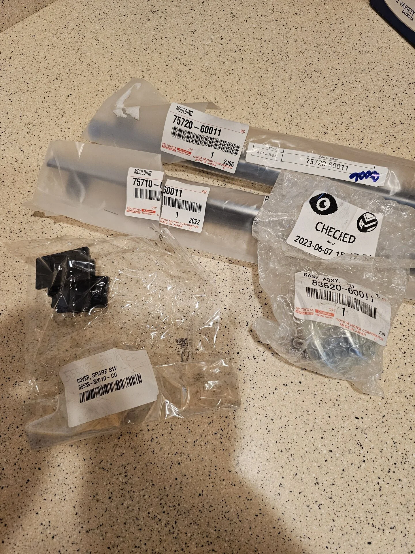

Few parts showed up from partsouq.
New oil pressure switch. Couple of switch blanks and the last two belt mouldings for the doors.

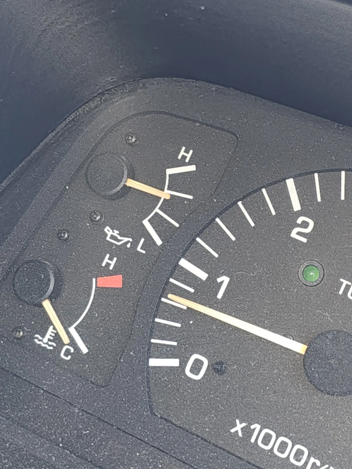

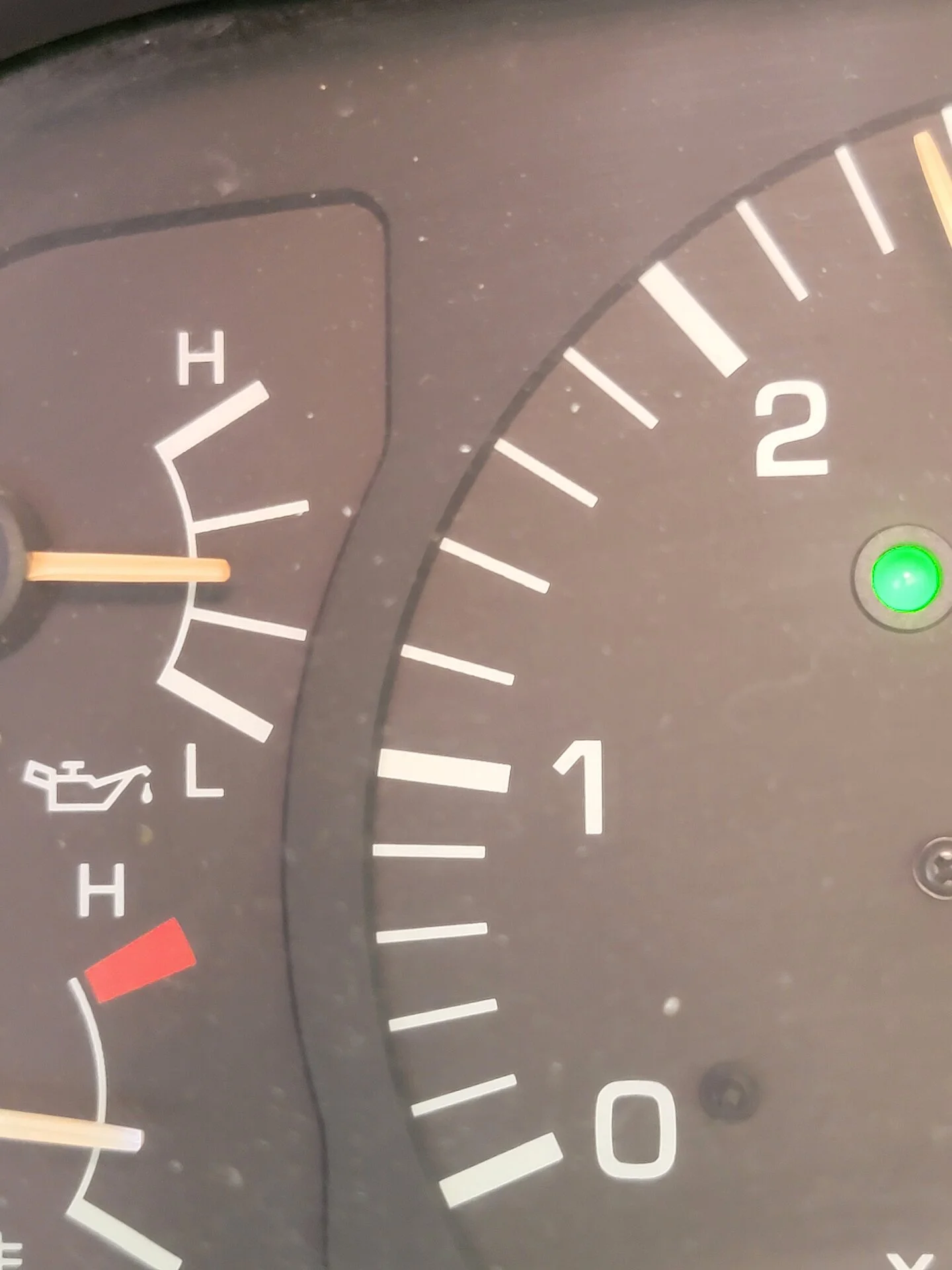

Comparison of the oil pressure gauge
I need to drive it to show the difference in warm temps.
But this is cold now.
These are warm idle and driving with my foot in it a bit

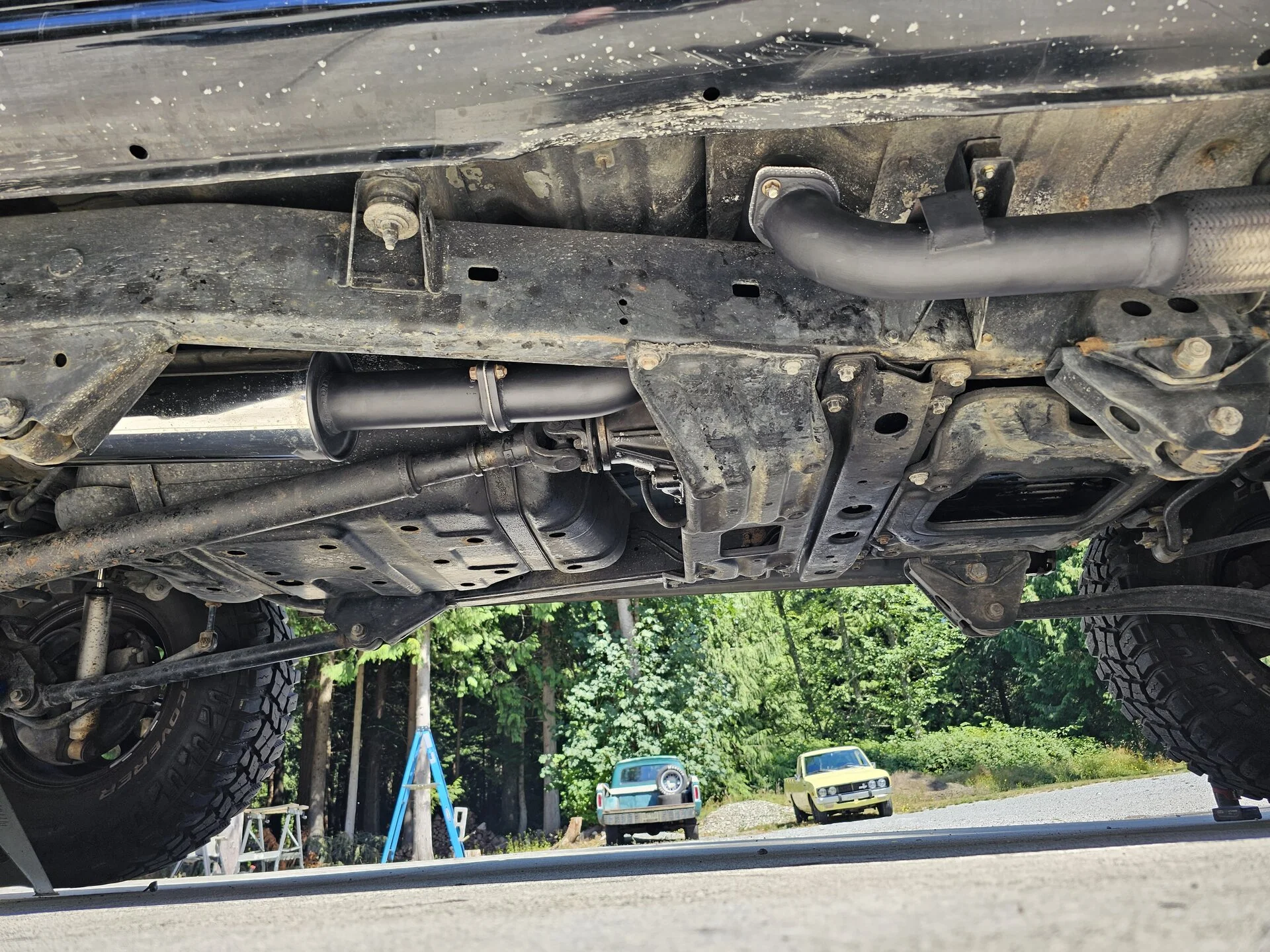

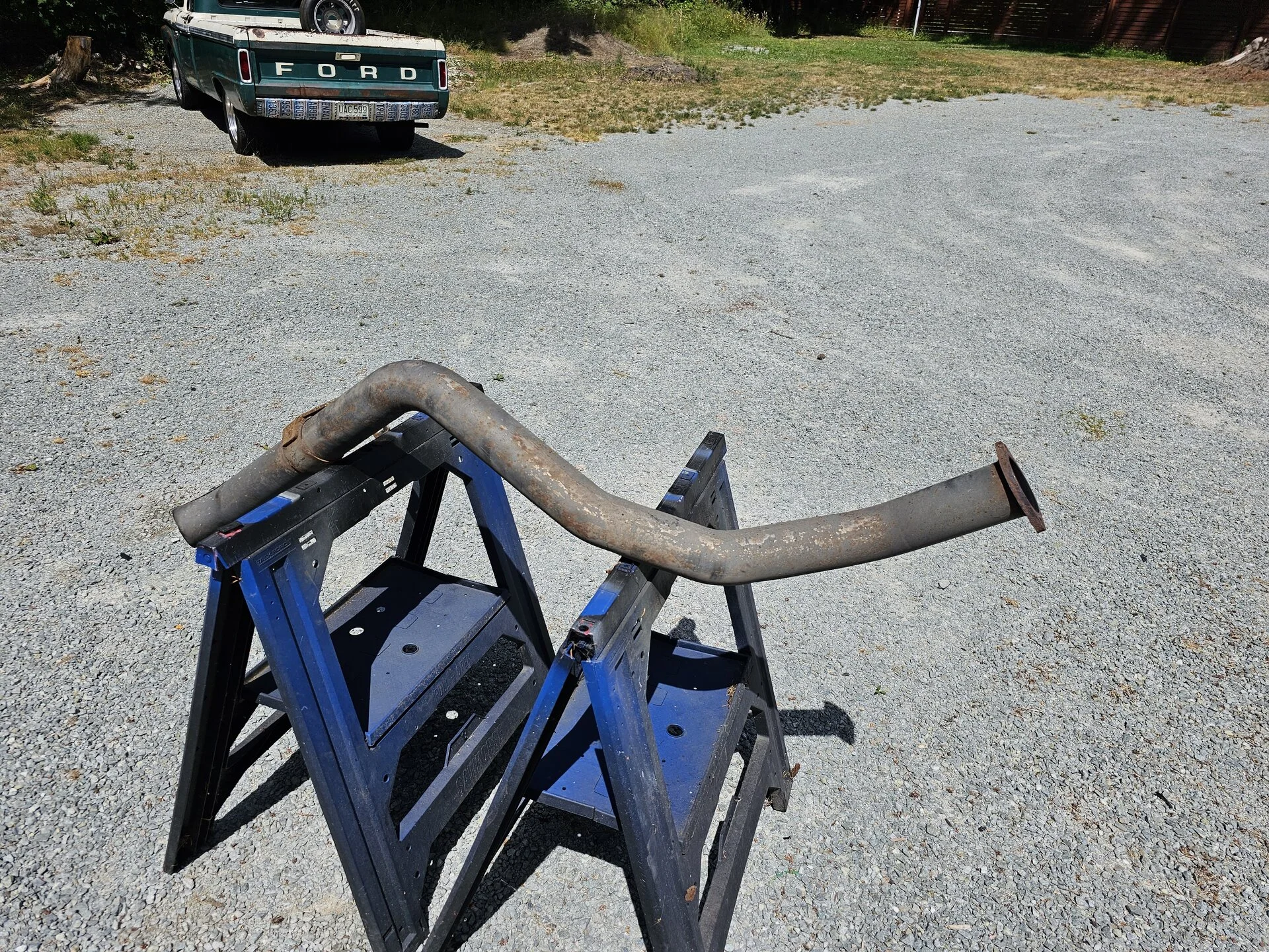

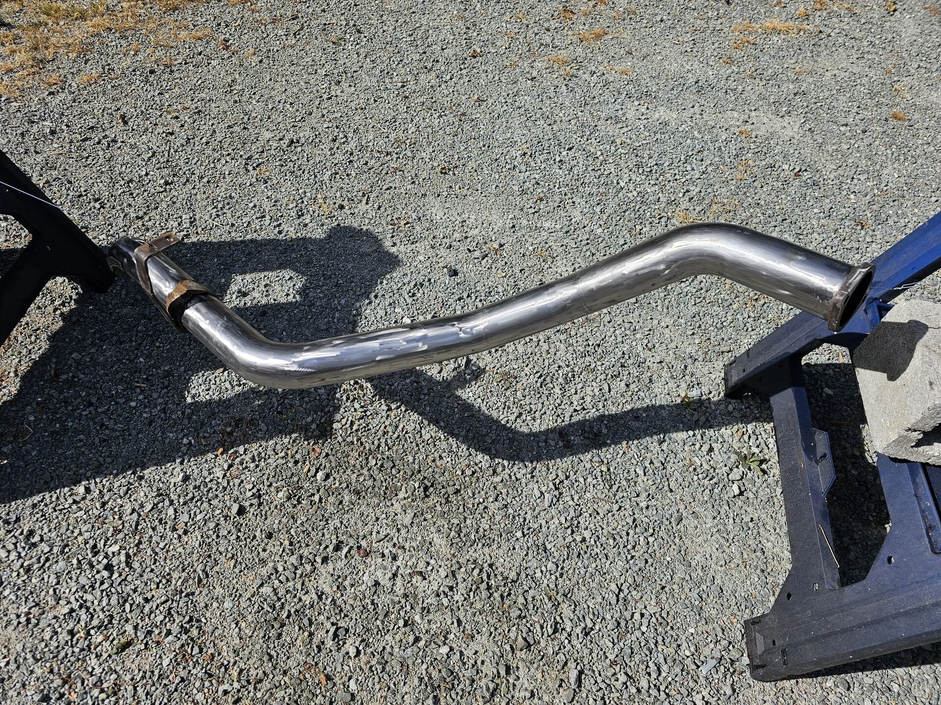

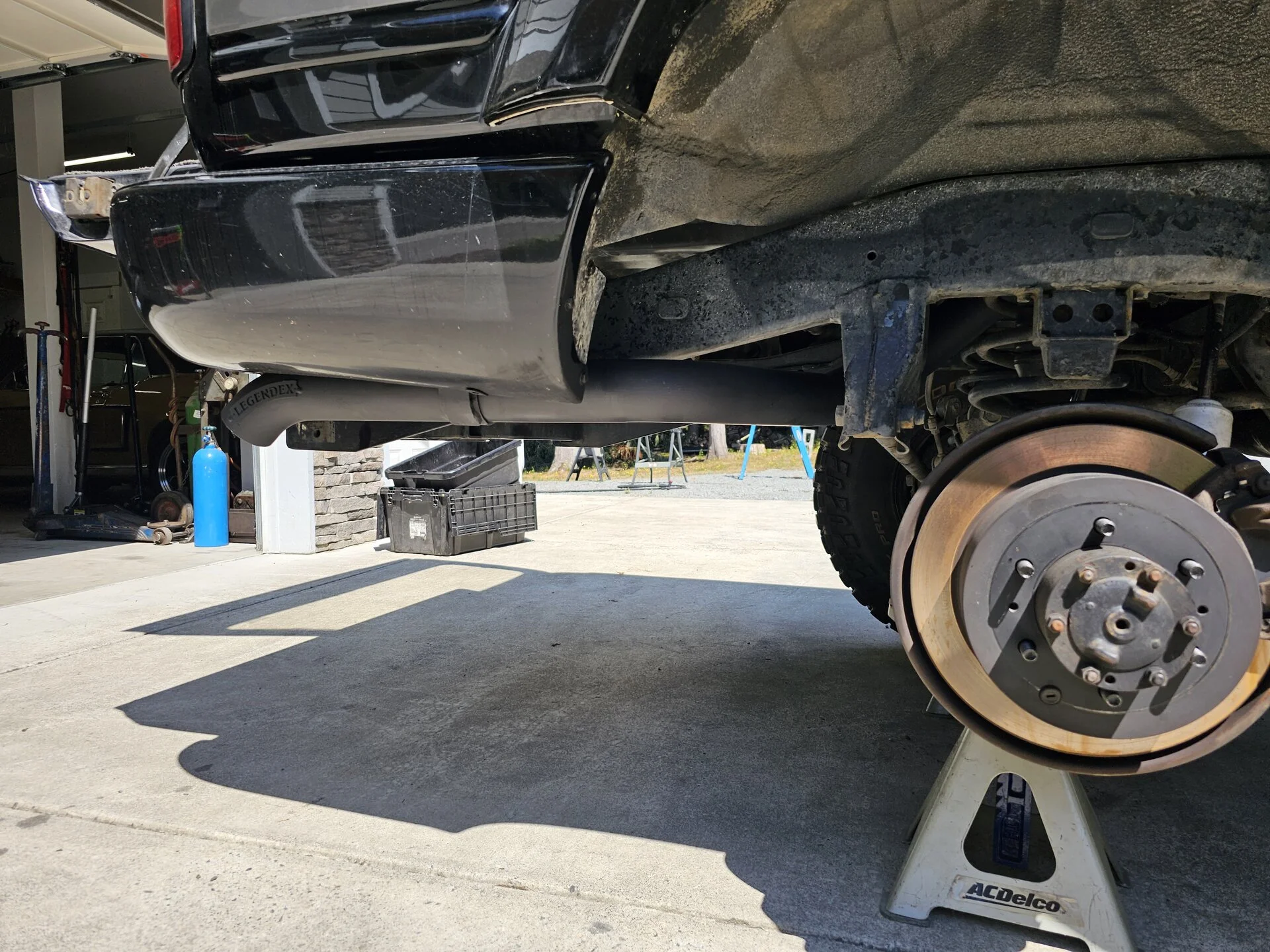

Finally decided to pull the exhaust off and strip it and paint it
I got bored and started it without the muffler on. I might need to get their berserker pipe.
That sounds amazing. And that's shocking how quickly that rusted up like that
It's not a very good paint that they used. It comes off way to easy
3" downpipe?
I made a 4" down pipe for my hdj81, and with full exhaust, no muffler it was embarrassing to drive! Loud AF
I cringed every morning starting it at 5 am to drive through a quiet neighbourhood to go to work for the few weeks if took me to order and fit a muffler
No it's a 3" downpipe

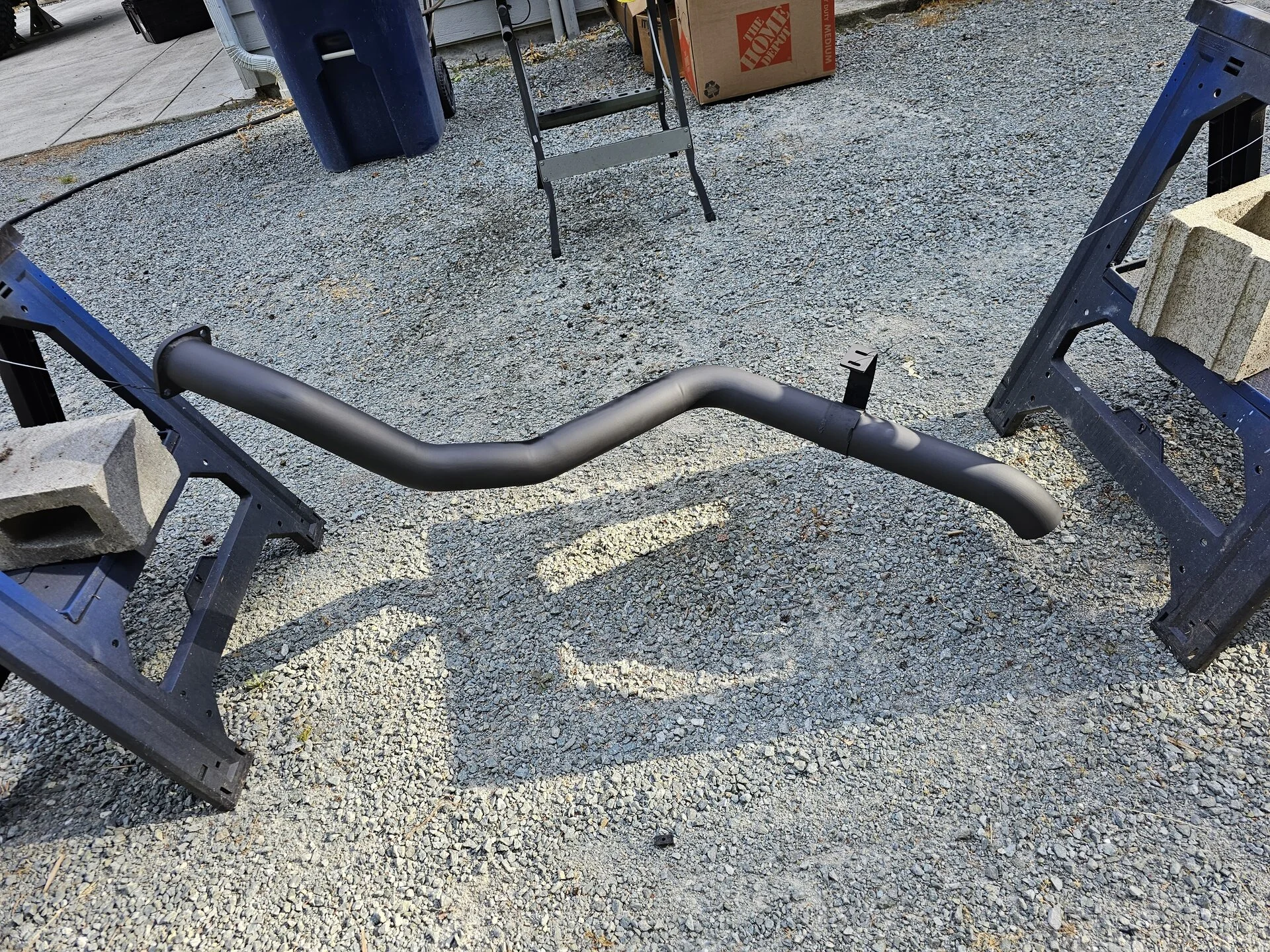

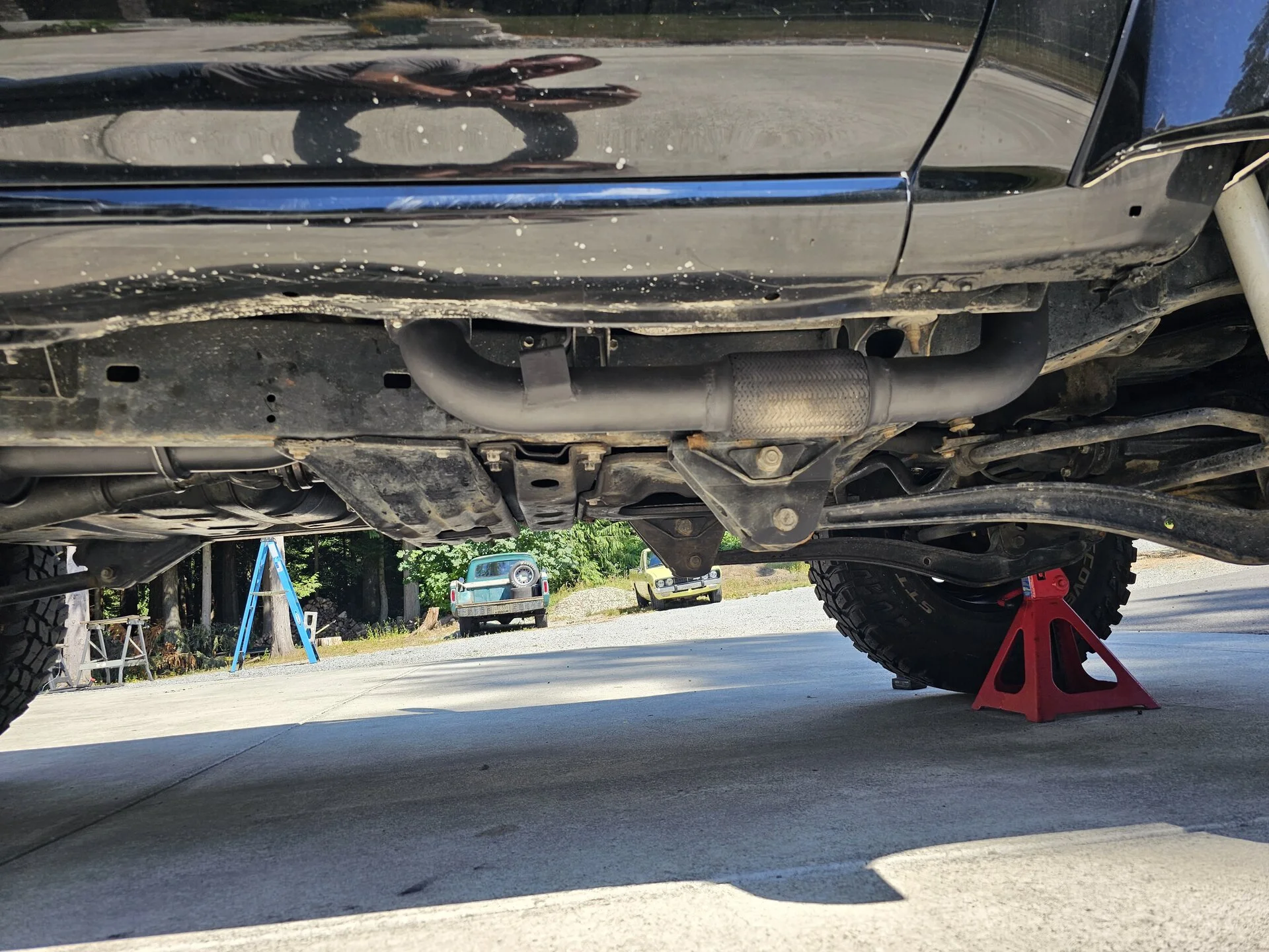

My lazy ass finally finished it.
The gf wants to go to the mountains this weekend and I'm taking it to Oregon the 4th so I ran out of lazy time.
The paint recommendeds 3 heat cycles. 10 min idle. 20 min cool. 20 min idle. 20 min cool. 30 min drive, cool to ambient.
I've finished 2 of the three. I'll do the third on my way to work.

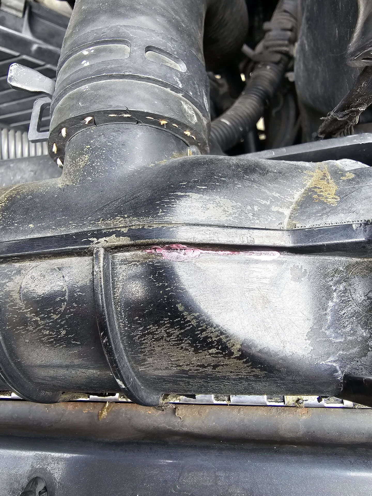

Came home this morning to a small 2" puddle under the front end. Crawled under and looked up and saw coolant.
I followed the leak up to the water pump.
I also noticed a small amount in the radiator on what looks like a pinhole leak.
So I ordered a new radiator.
Part #16400-17020. @OGBeno had posted this in other hd threads. It's a manual radiator so no trans cooler. But as I've already bypassed my radiator in favor of a large external, it's a match made in heaven.
