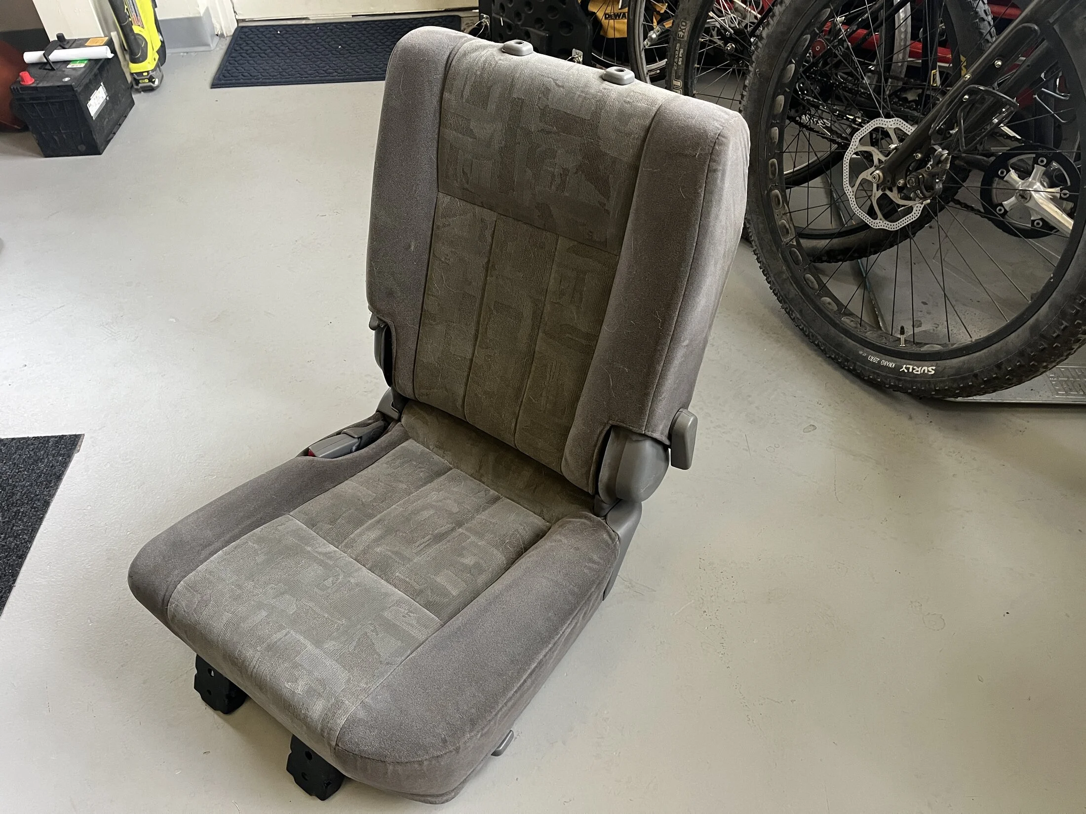

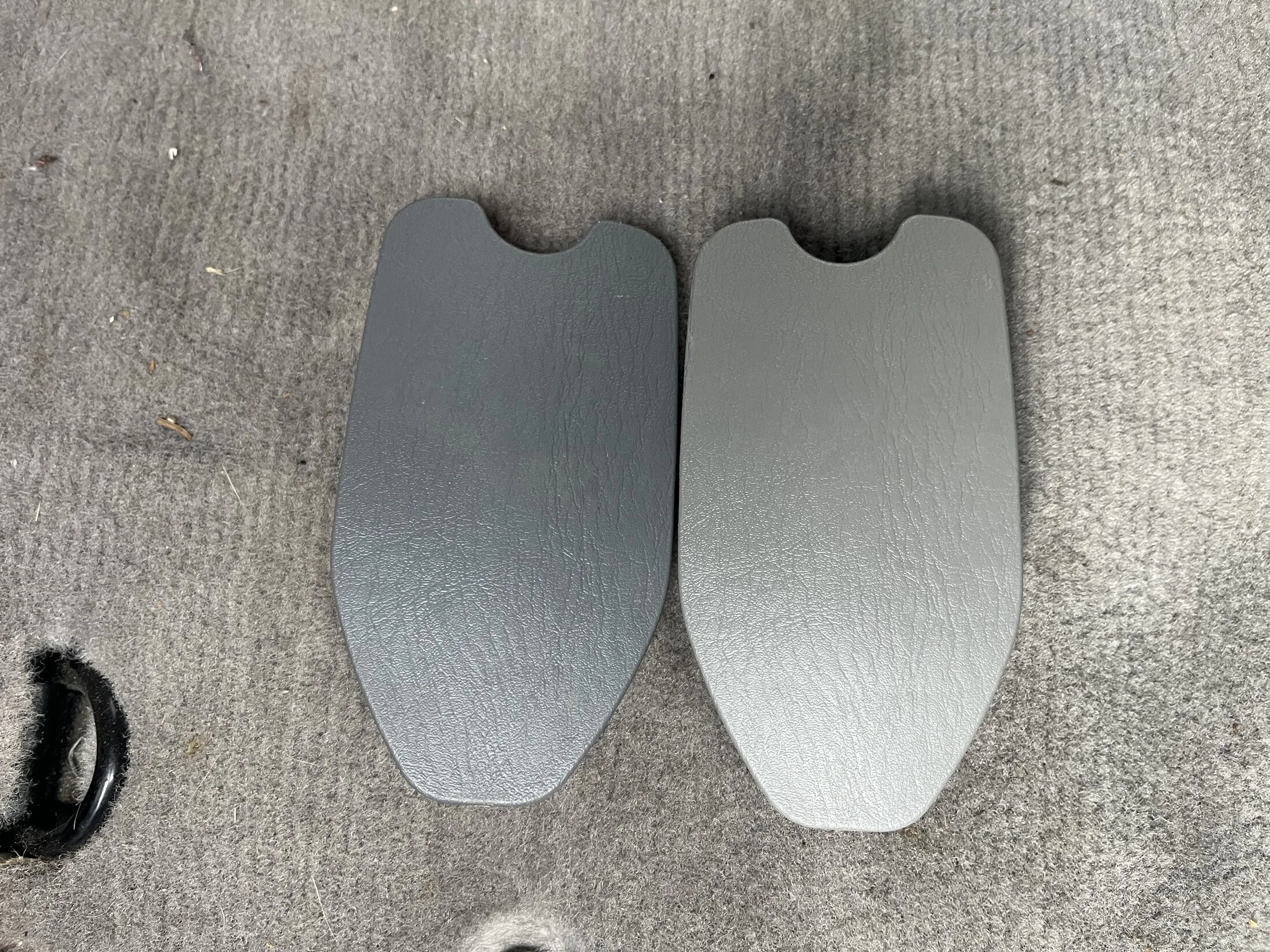

I'm using the grey one. They're both cloth but I'll be swapping over my leather. Some plastic got cracked in transport but I can use most of the plastics from my original 60% seat, which is good because I learned there is at least two shades of grey Toyota used. The cloth seat used more of a blue/grey compared to the light grey in my '07 LC. No idea which year/model these came out of originally. Plenty of english dog hair at no extra charge.

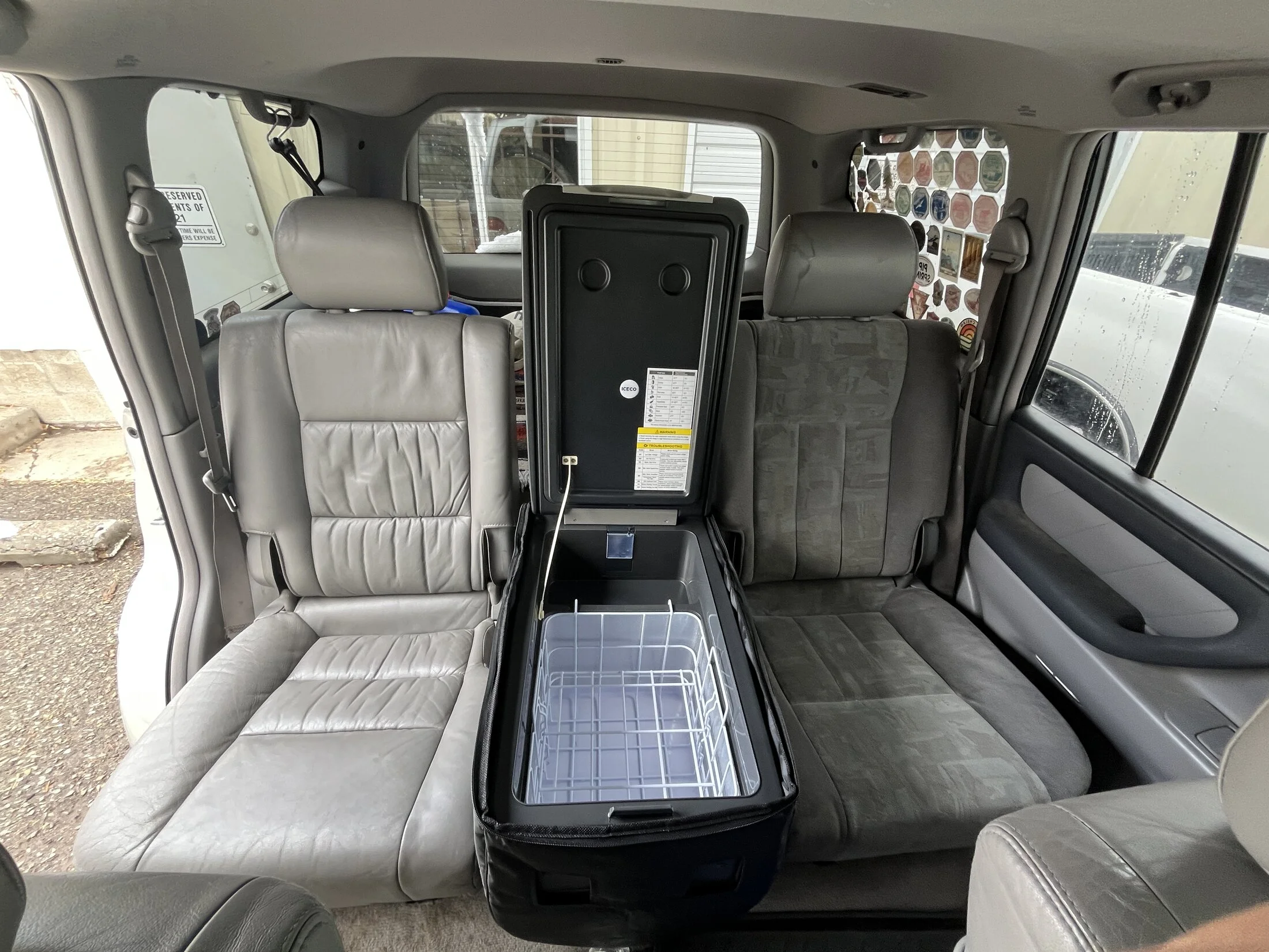

First trial fit as soon as I got home yesterday to make sure the fridge I chose (ICECO JP30) would actually fit in the middle. And it will. Hoo-rah!

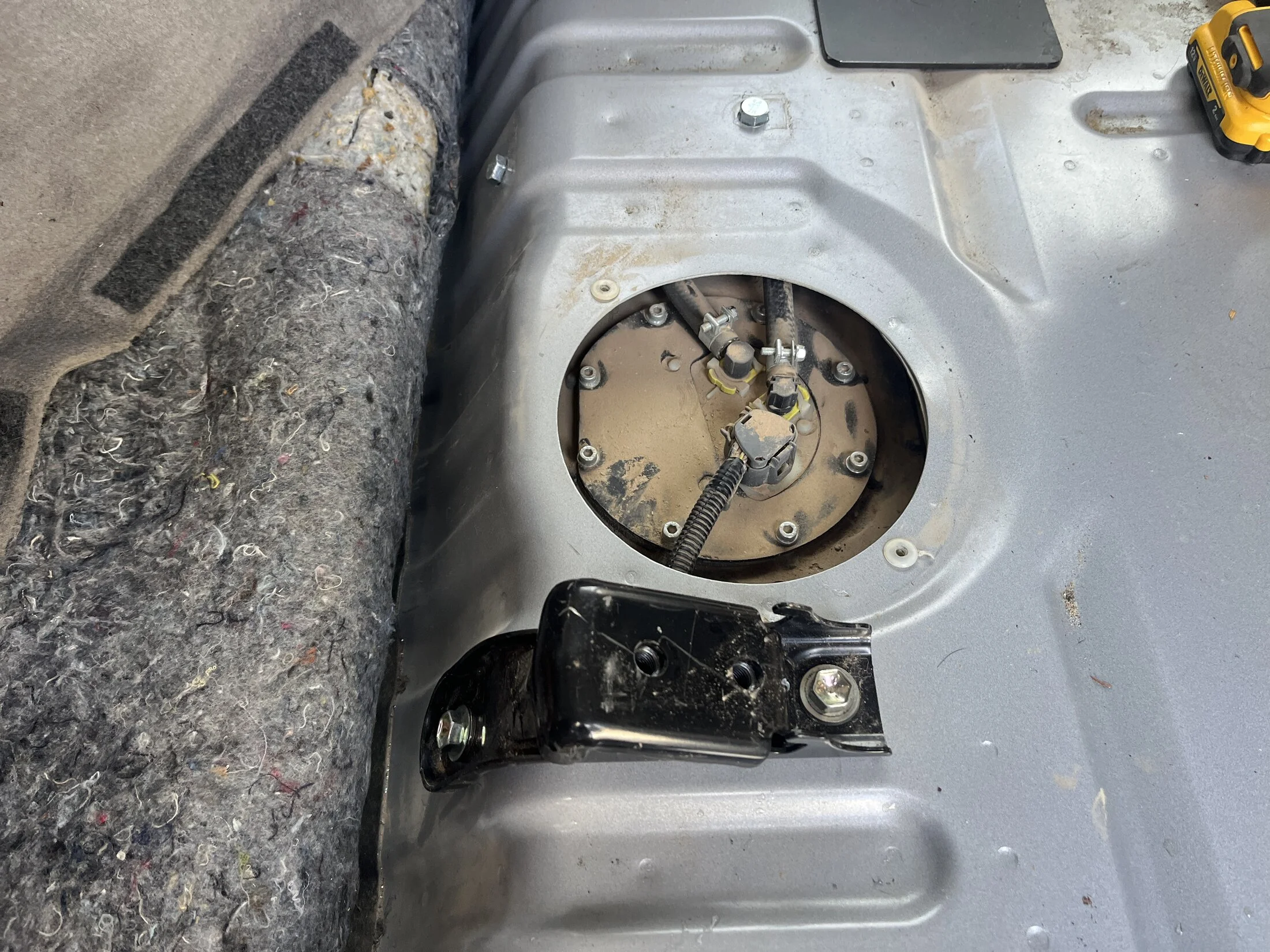

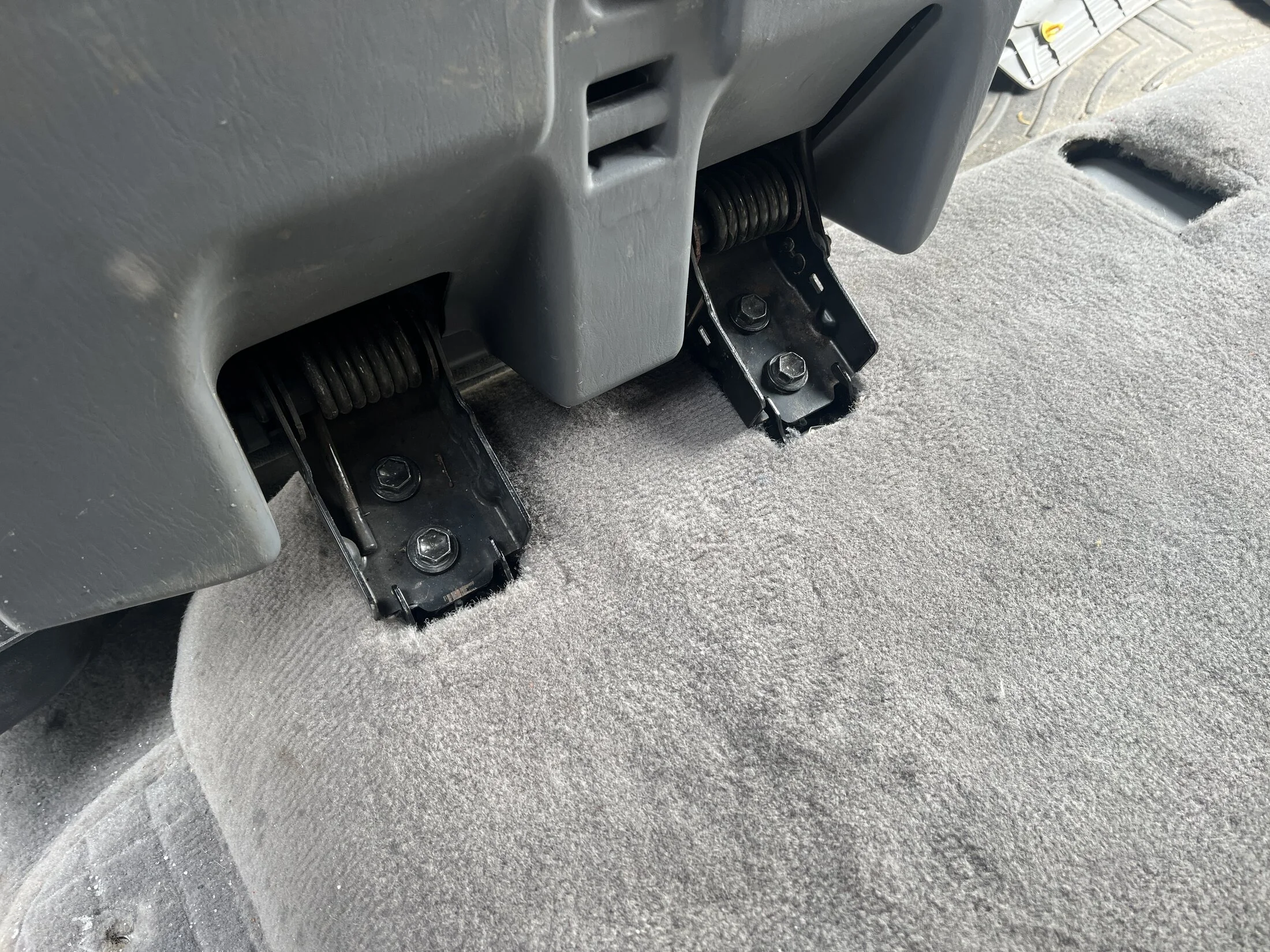

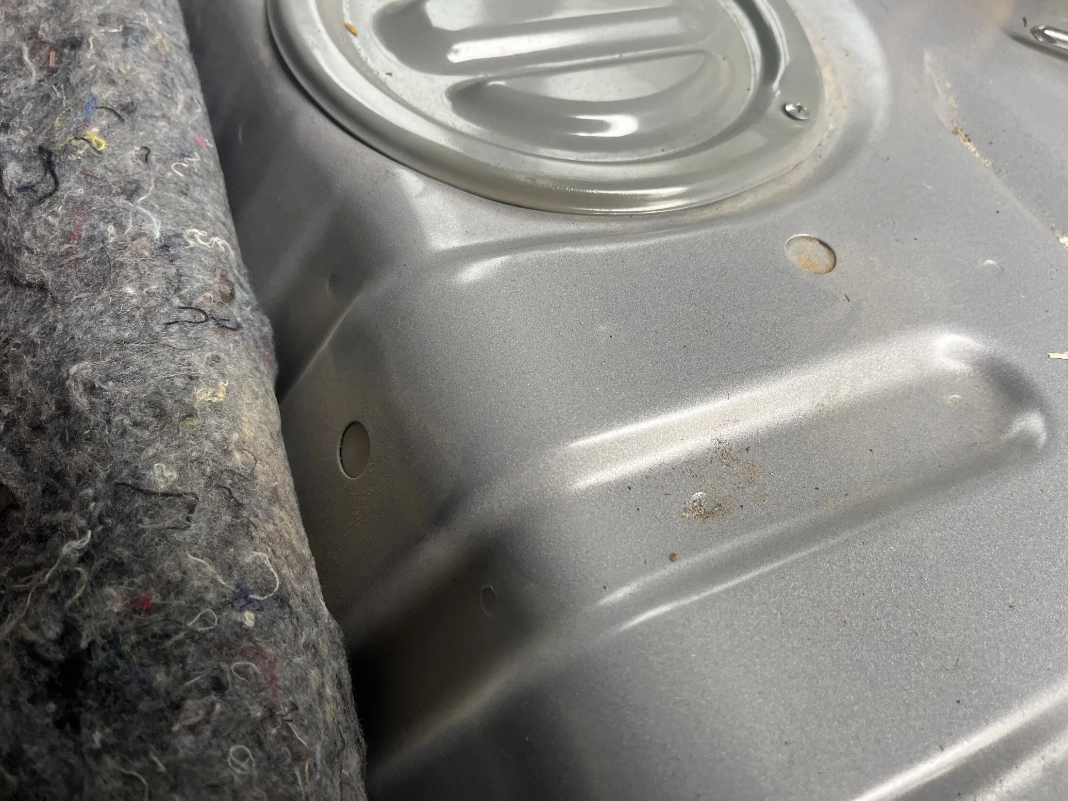

Today I figured out how to bolt it up. The black bracket in the upper left of the photo needs to be moved towards the outside. So first, take out both seats and pull the carpet forward. The 60% seat is HEAVY.

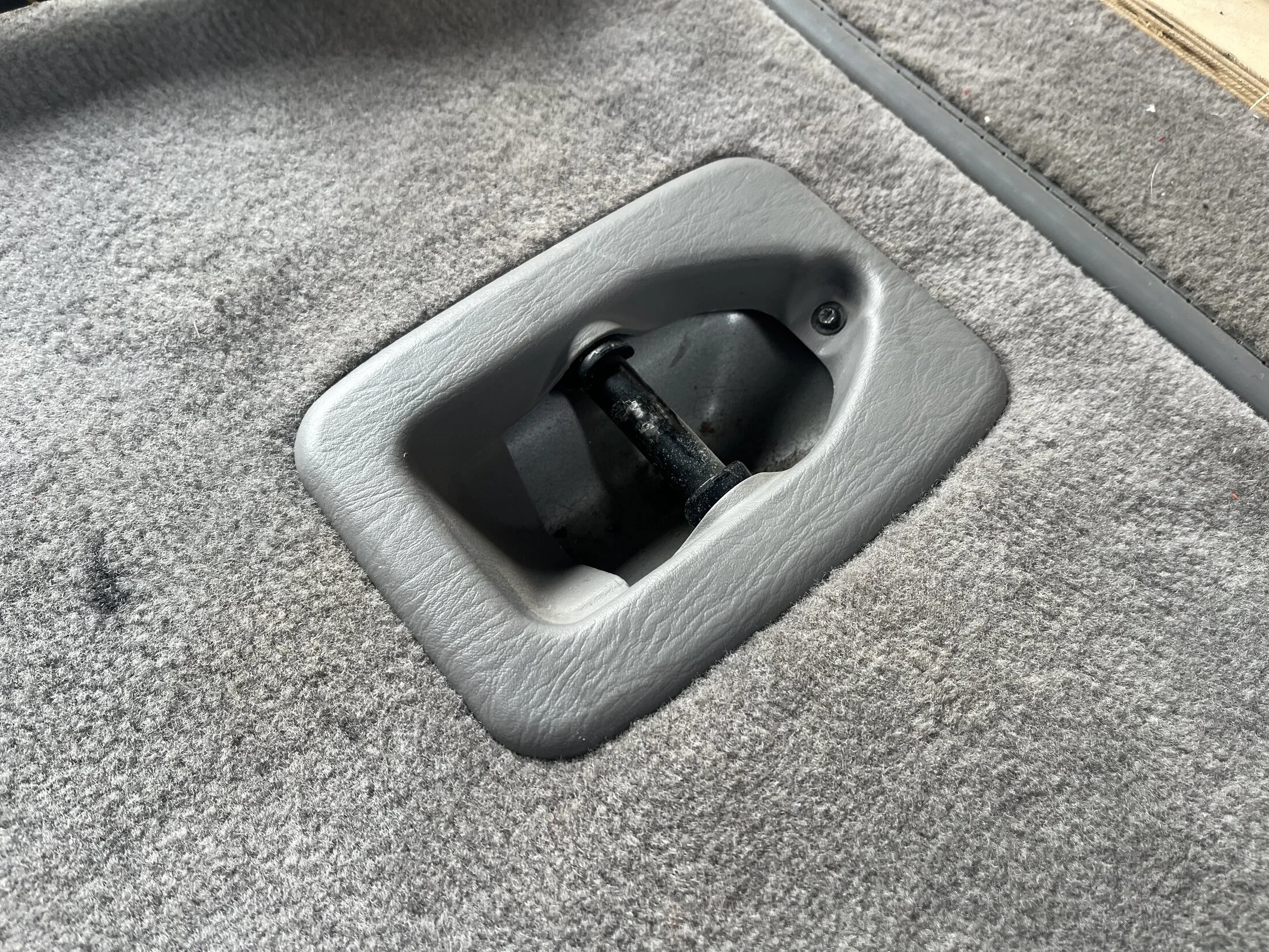

You'll see by these two "holes" that Toyota planned for it. Unfortunately they don't have welded nuts underneath. I drilled them out and was just able to reach my hand through the fuel sender access hole and bolt the bracket down with some flanged 10x1.25 nuts underneath. I picked up a pair of short 10x1.25 bolts to close up the holes that are no longer used.

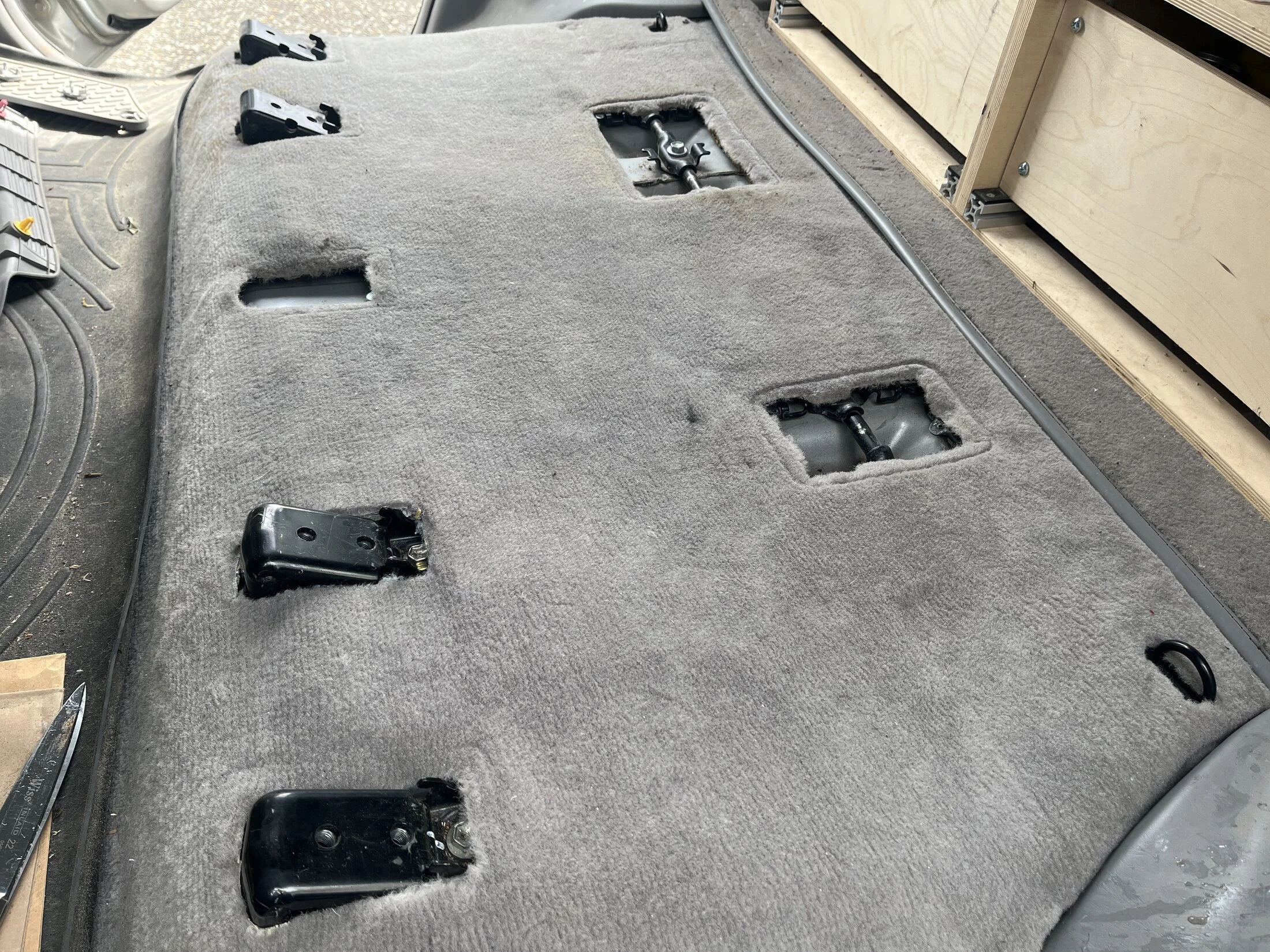

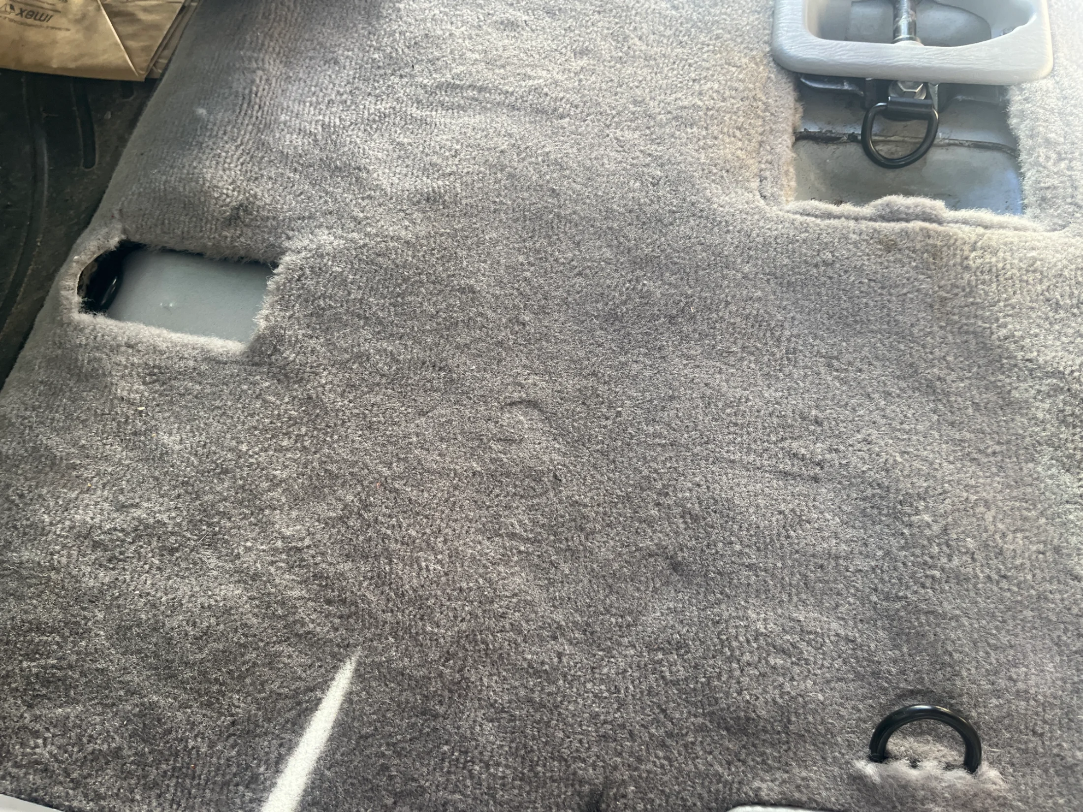

Next, trim the carpet. Just look at what the factory did and mimic that. Go slowly.

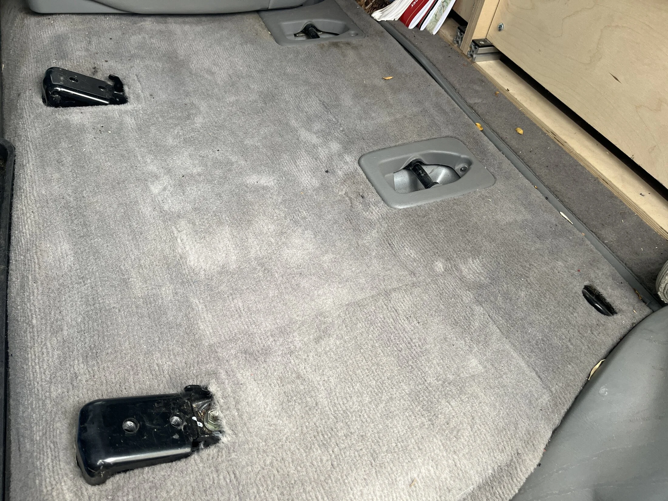

Lay the carpet back down
Put all the fittings back in place. I'm looking for one of these single latches and plastic covers if anyone has one kicking around. I'm planning on using some the old seat mounting locations to solidly mount the new fridge.

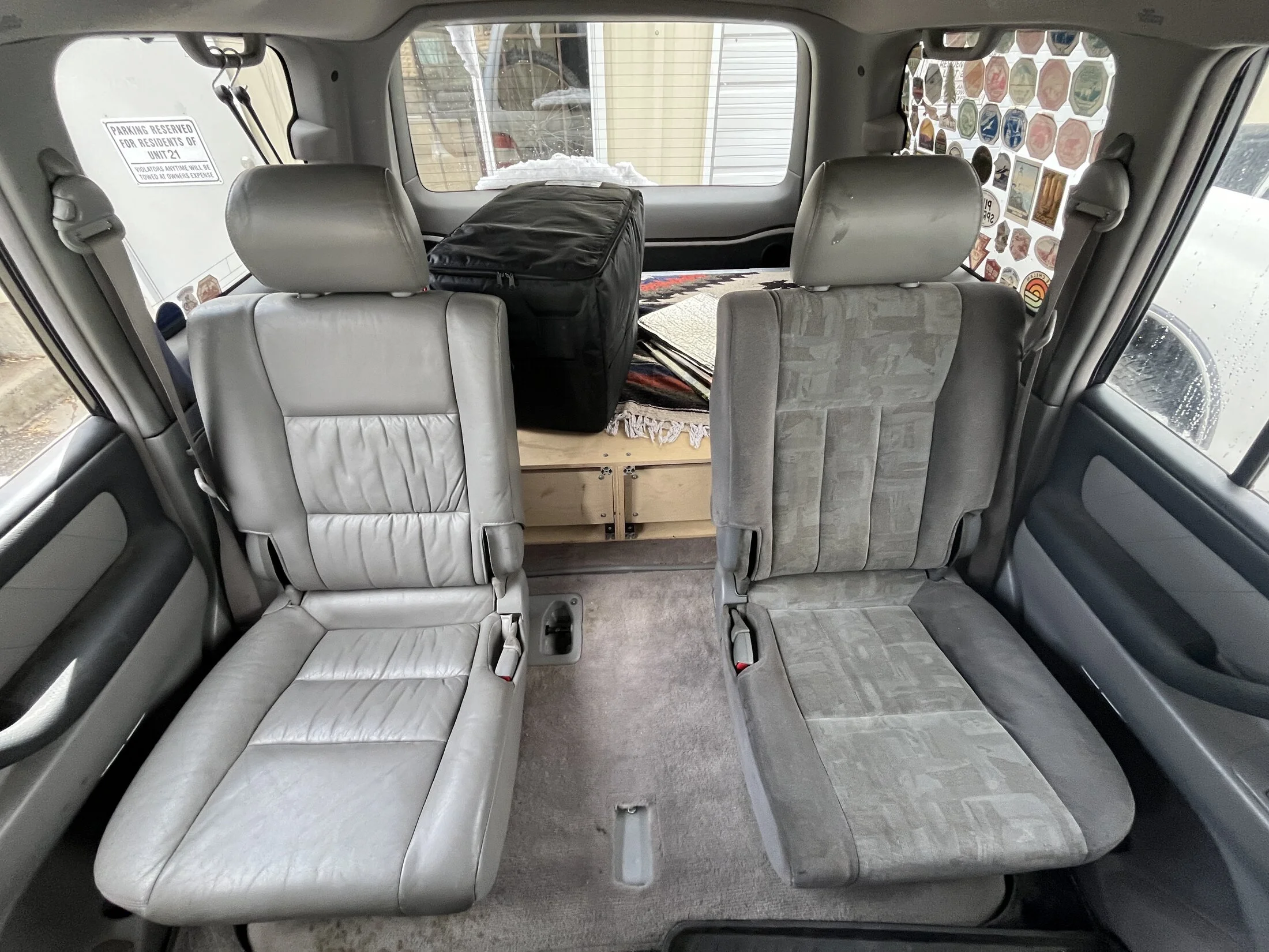

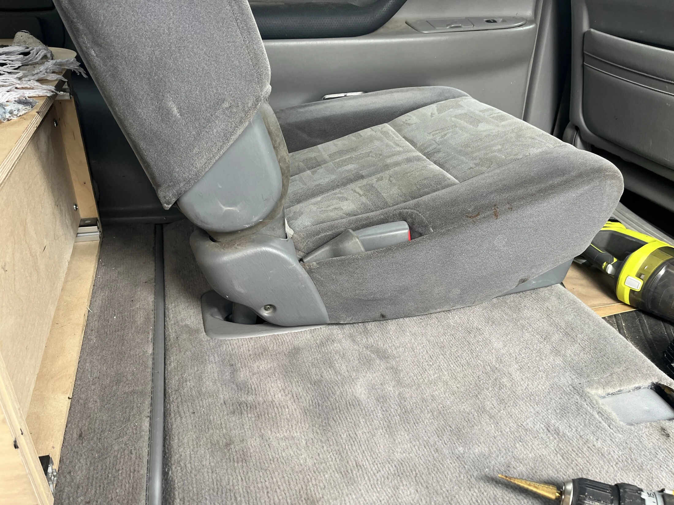

The new 40% seat bolted straight up
It latches, first try!

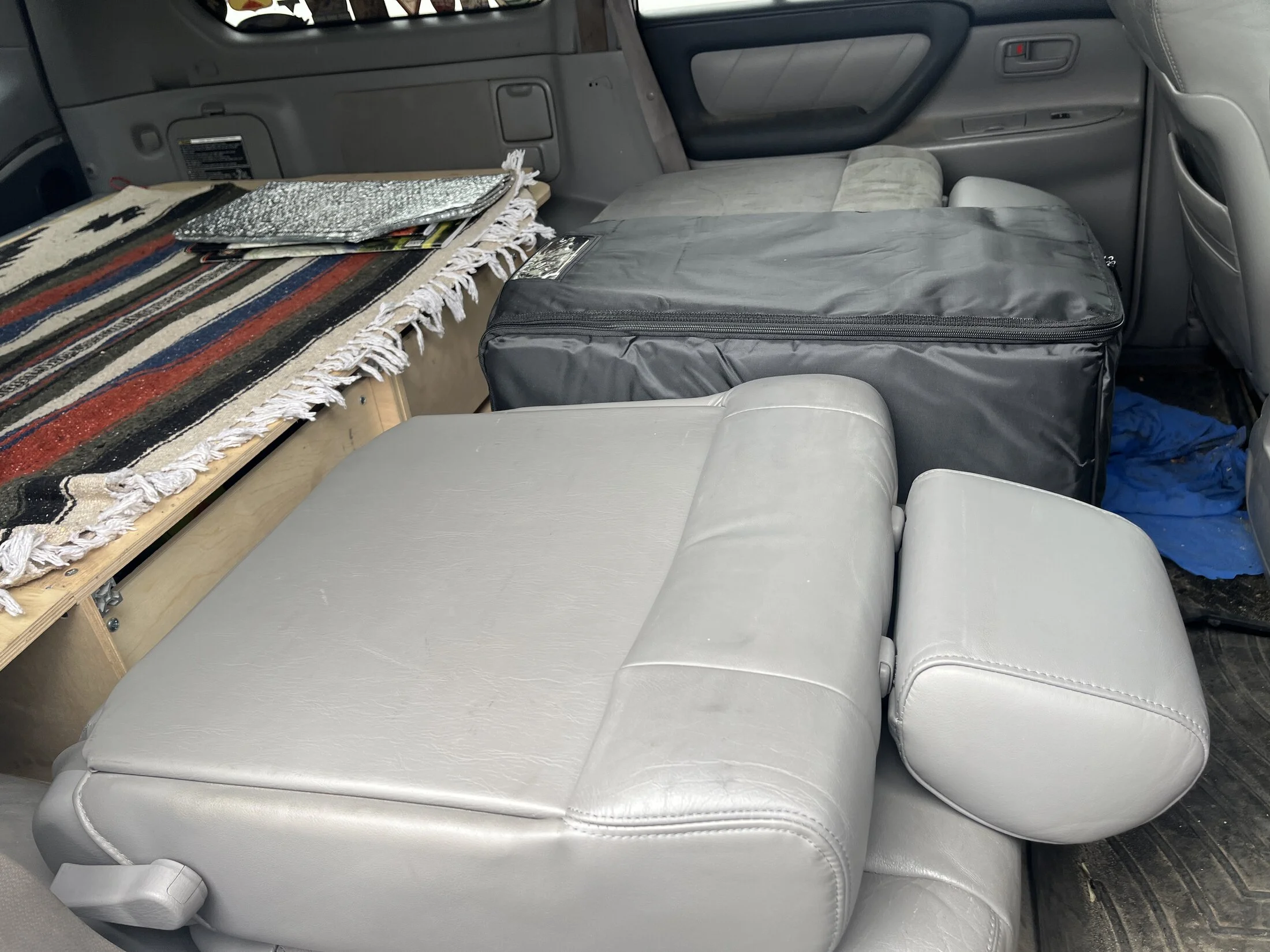

So much room for activities! Edited to include the width between the seats is roughly 14.5"
Money shot!
Roughly the same height as the seats folded flat

The 40% seat weighs 39lbs. The 60% seat weighs a shocking 86lbs. The fridge weighs 36lbs. So I'm actually losing 11lbs and gaining a fridge at the same time.

Thanks! It's about 14.5" wide, you might be able to push it to 15". Length is dependent on your layout (drawers or 3rd row) and how far you're willing to go forward.

I'm liking the new view through the second row.
Once the seat and fridge are sorted out the next goal will be to integrate water storage under the right drawer wing so the deck will be completely open.
I was eyeing the leather cover on the 60% seat today, I think with some well thought out surgery I won't have to buy any new leather...

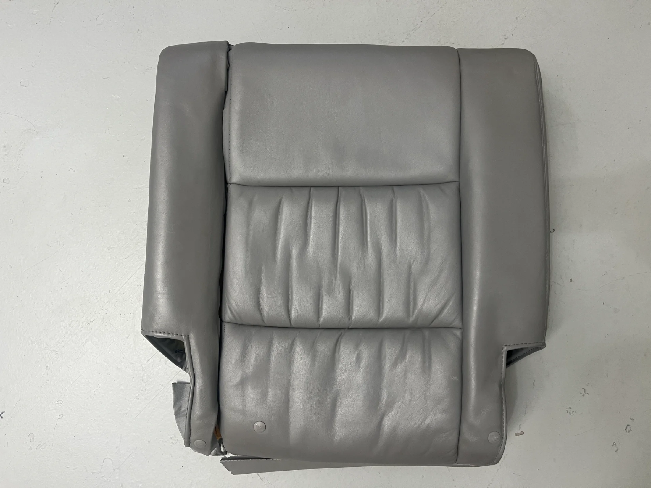

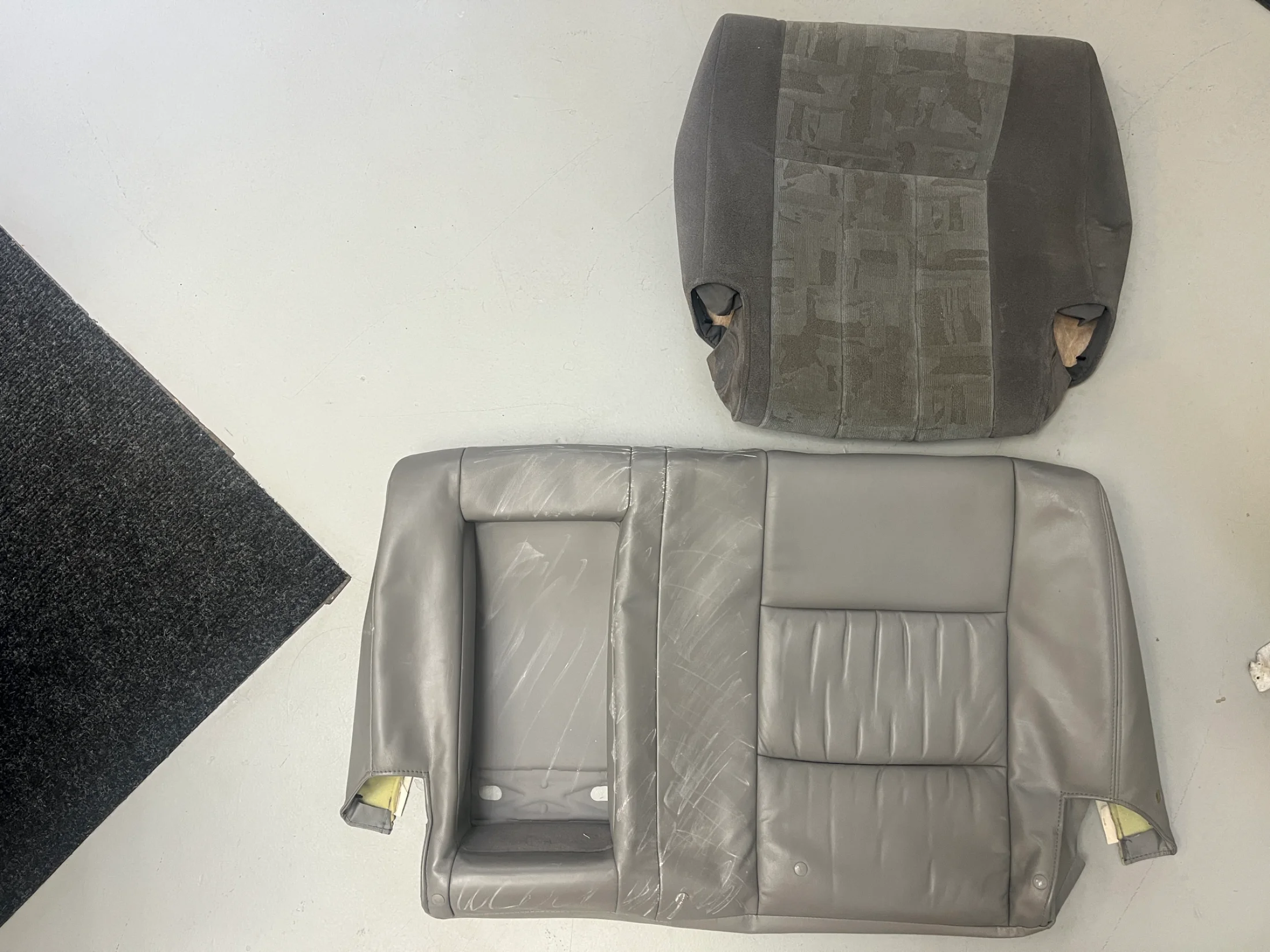

I finally got around to swapping my original leather upholstery over to the RHD 40 seat. In a former life I did automotive upholstery so it wasn’t terribly difficult. I did all of the dismantling/reverse engineering, I had a local upholstery shop sew them back together and I reassembled. So if you do happen to come across a seat like this now you know that your existing upholstery can be transferred over if needed.

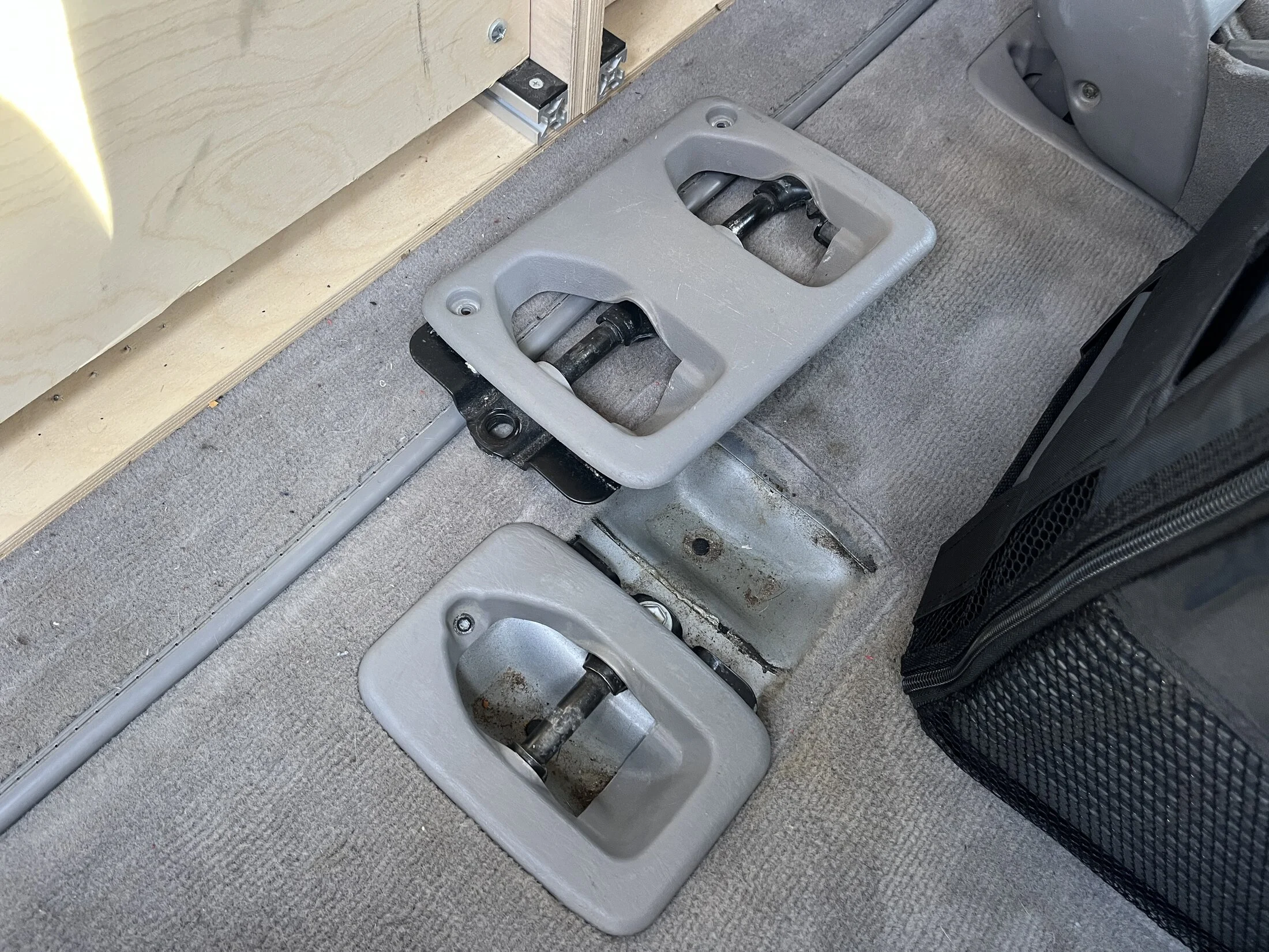

I bought some D rings off amazon that are similar to the originals Toyota used but these have a 10mm hole size to utilize the original seat mounting hardware. I mounted two D rings above the seat latches in the rear and a third in the front where the lower mount for the center bracket was originally located. I put a couple slits in the carpet to allow the D rings to poke through.
