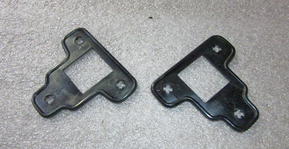

Hey GA Architect, I noticed in one of your posts showing a side pic of your 40 that the mirrors has what appeared to be a black gasket surrounding the mount. My '77 has a hard plastic spacer about 1/16' thick behind my mirrors that are the exact same shape as the mount and do not extend past the mirror base. These are factory original. Did you source an after market gasket?

Heli - The black gaskets (packing) behind my mirror arm bases are OEM units, 87911-90300. > $4.90 ea. - Click Here <

Thanks for the info on the mirror gaskets.
