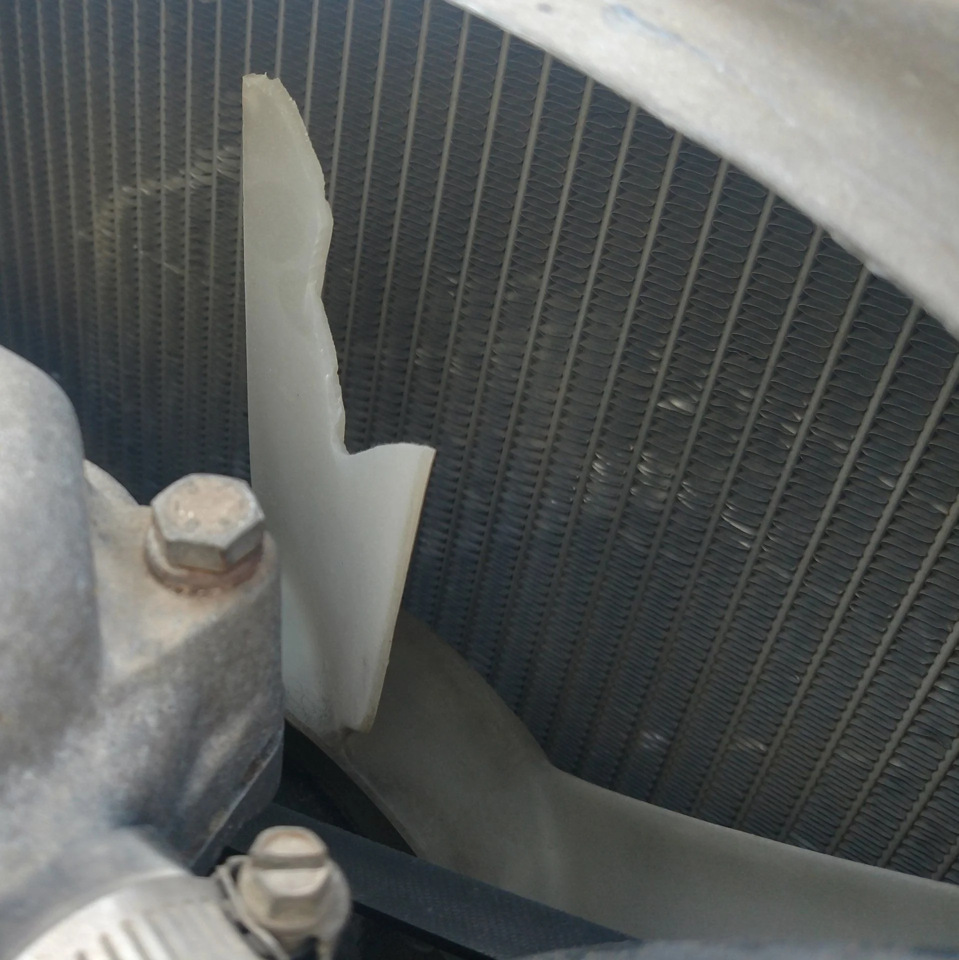

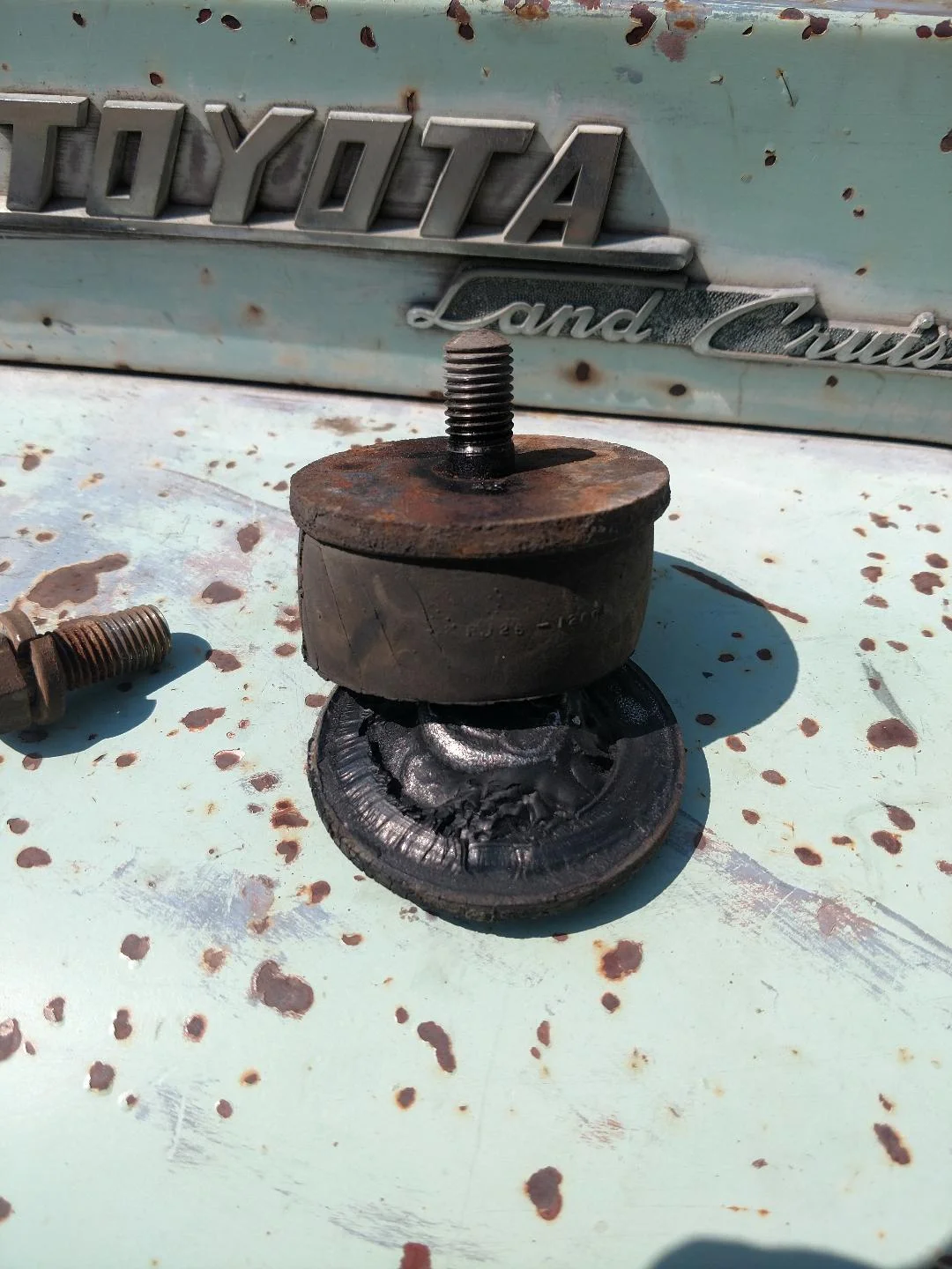

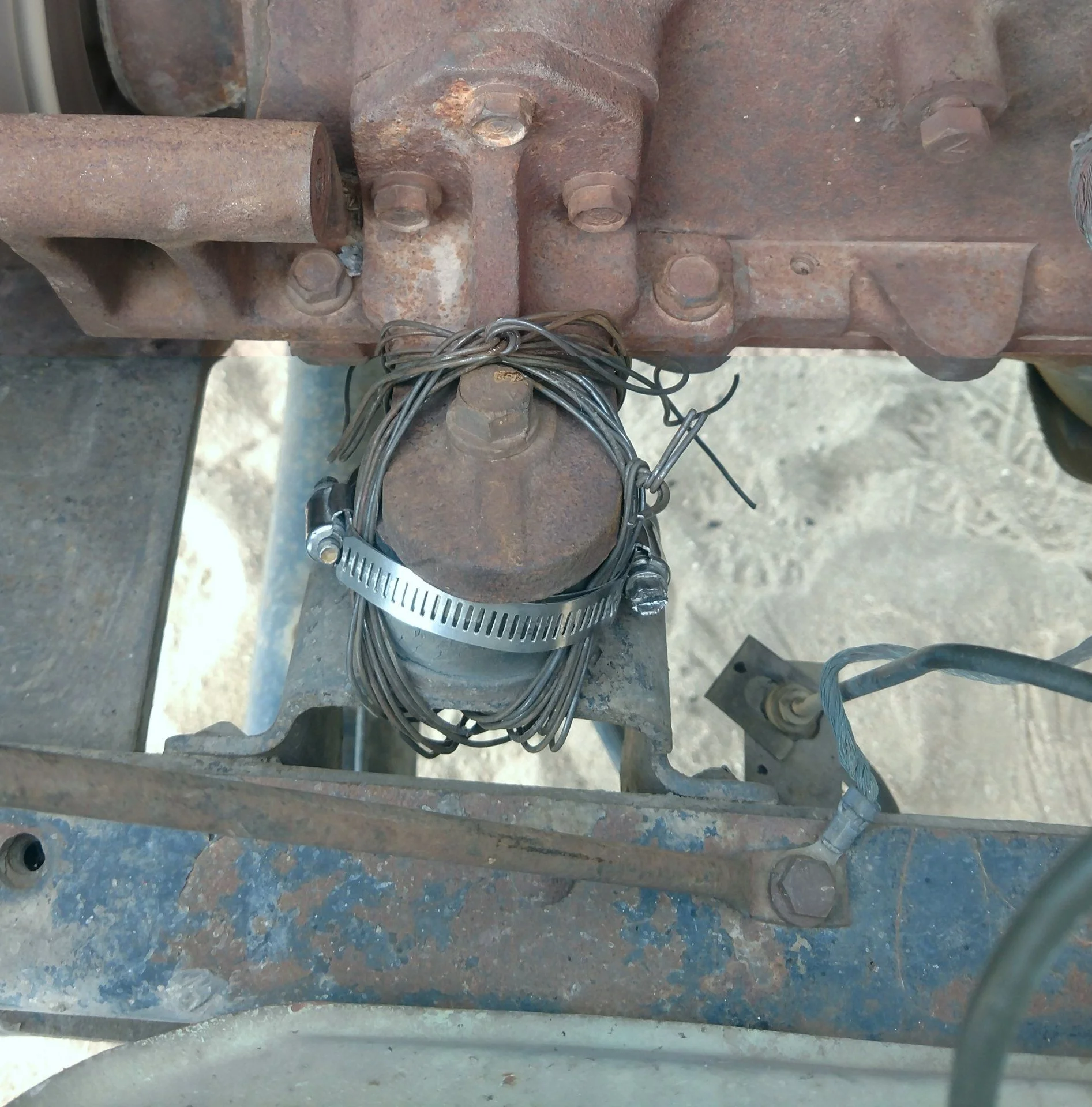

Oh I forgot while doing some running at some killer speeds LOL drivers side motor mount broke shifted the engine and took out 3 of the 6 blades on the fan. we limped back to camp and did some trail repairs my buddy Bob @brooksfj60 came out with a stock fan blade the next day to keep us going

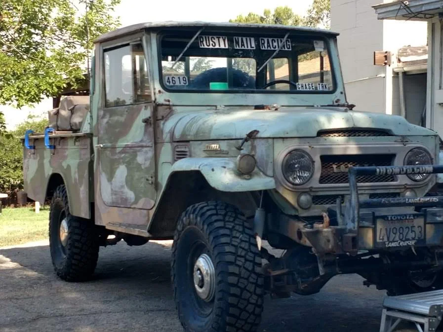

Well the NORRA 500 was cancelled in order to move the NORRA 1000 to October because of everything that's going on in the World. That being said I am Happy to Announce We will be preparing our 1967 FJ45 Rusty Nail Chase truck for the NORRA 1000 Safari class run. I want to Thank Justin Reece for allowing us the Honor to run 4619 on the 45. We have had a ton of support and sponsorships coming in. We are focused on keeping this in the tradition of Rusty Nail racing. Have Fun and make some memories Guess were going to have to get some new stickers LOL

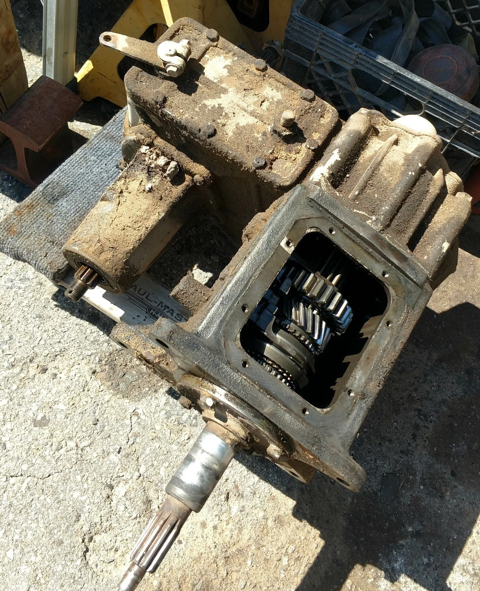

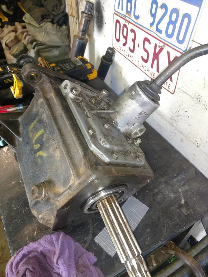

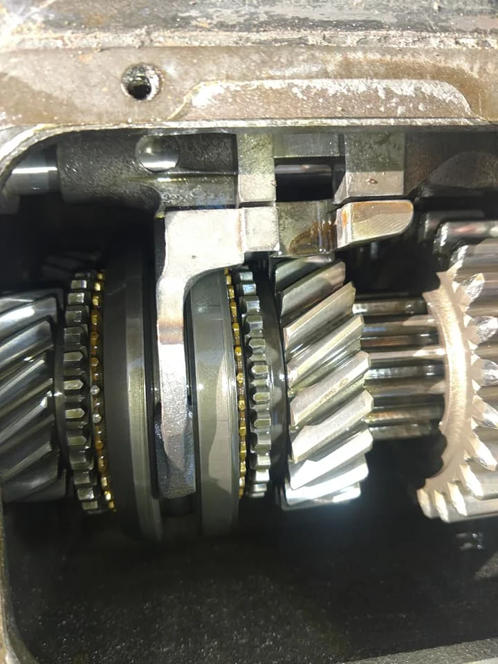

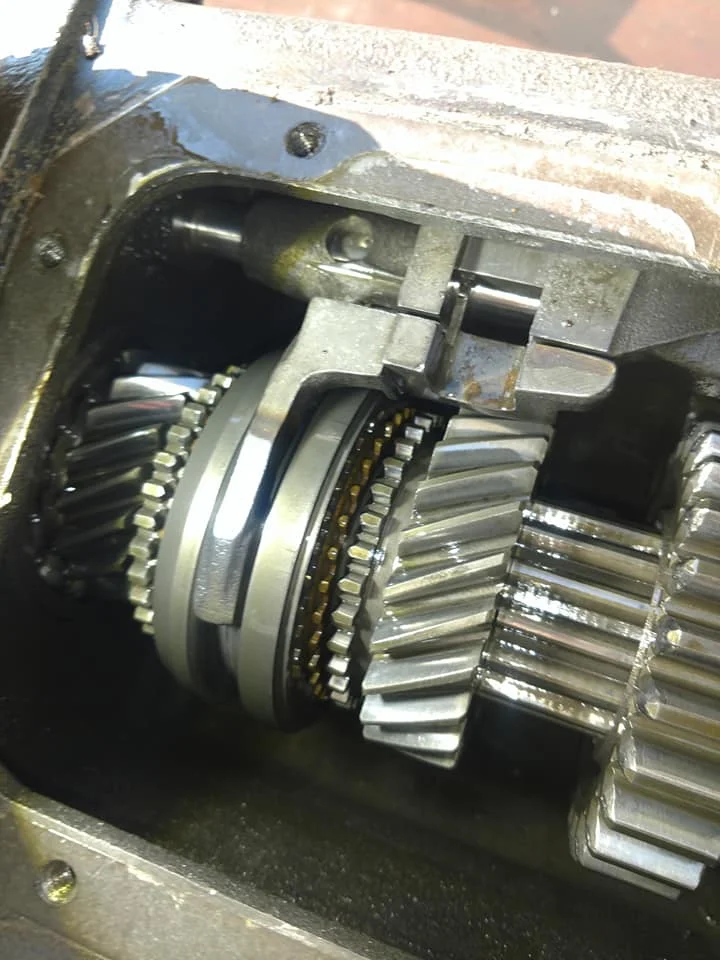

With everything going on in the World I am taking this time to start prepping a few things for the 45. I got this trans and T case combo from @BenjaminCA I started yesterday cleaning and checking everything out. I am really impressed all the gears look Great no chips or cracks. The trans in the 45 now has really taking a beating over the years and this is going to be perfect. I will be contacting @orangefj45 at Valley Hybrids for new gaskets and seals soon. The whole truck is going to be getting a complete going over from the motor to a new late model front disk brake axle upgrade, springs and hangers. As we progress I will post up more pictures and those helping to make this happen. Its going to be a long process.

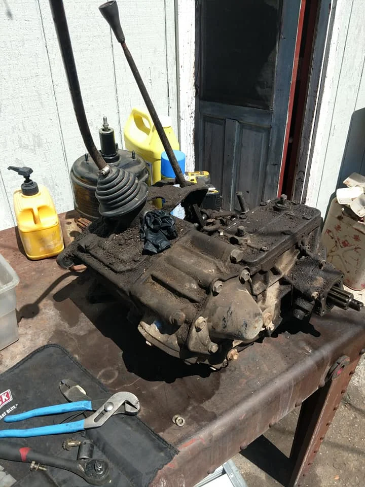

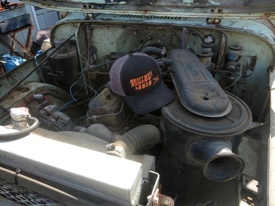

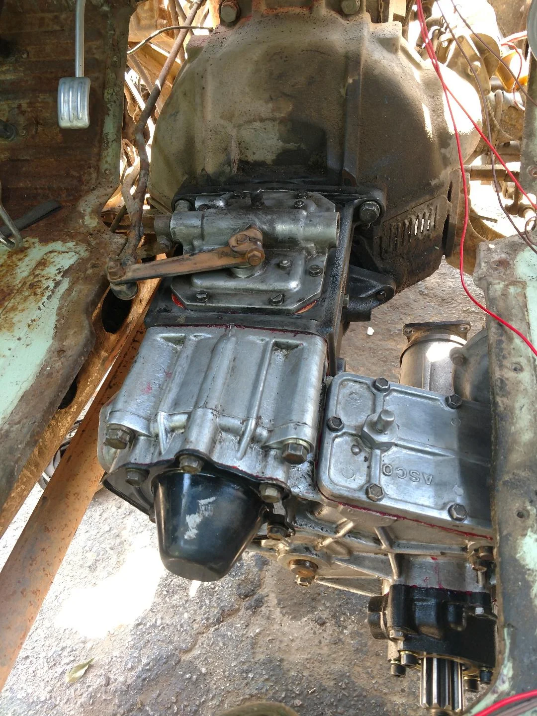

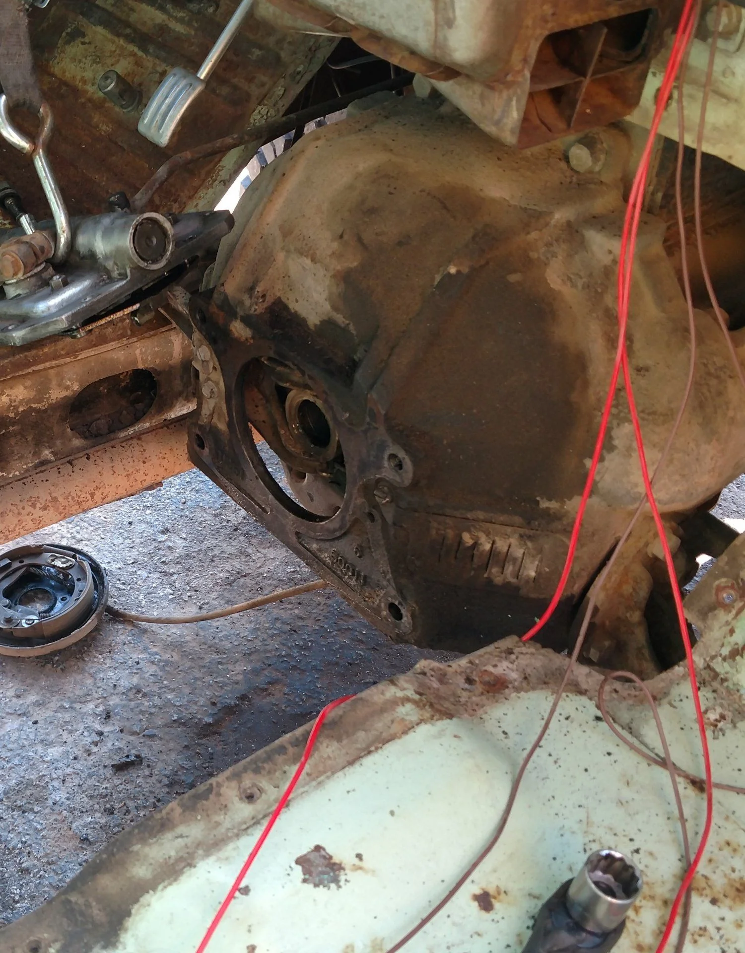

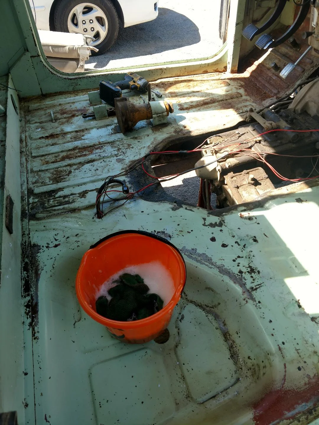

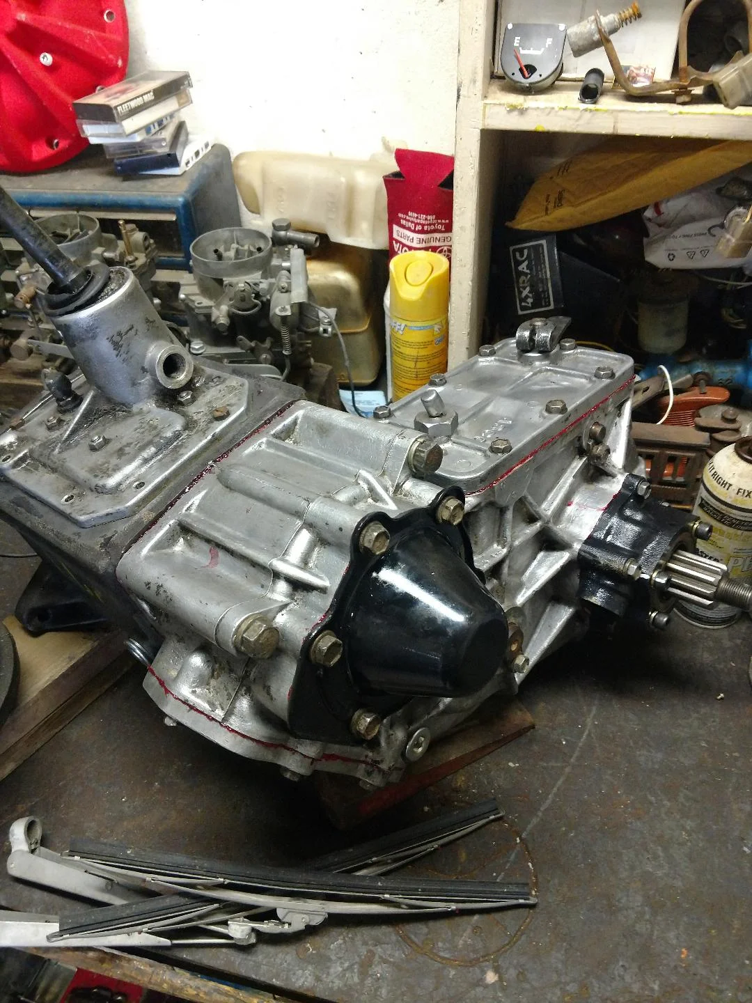

Time for some updates. Finished up the Trans and T case since I was off for a few weeks. Big shout to Valley Hybrids for sending down the gasket and seal kits. A couple of Before and after pictures. Also I want to start Thanking our Sponsors for helping out with parts and support. Dave at 4 Plus sent us a U bolt flip kit after we install the new springs. I dont want to get to far ahead for the build so as I get things rebuilt and installed we will point out those helping out. I pulled the intake/exhaust and started cleaning up the engine, Also pulled the seats and trans hump.

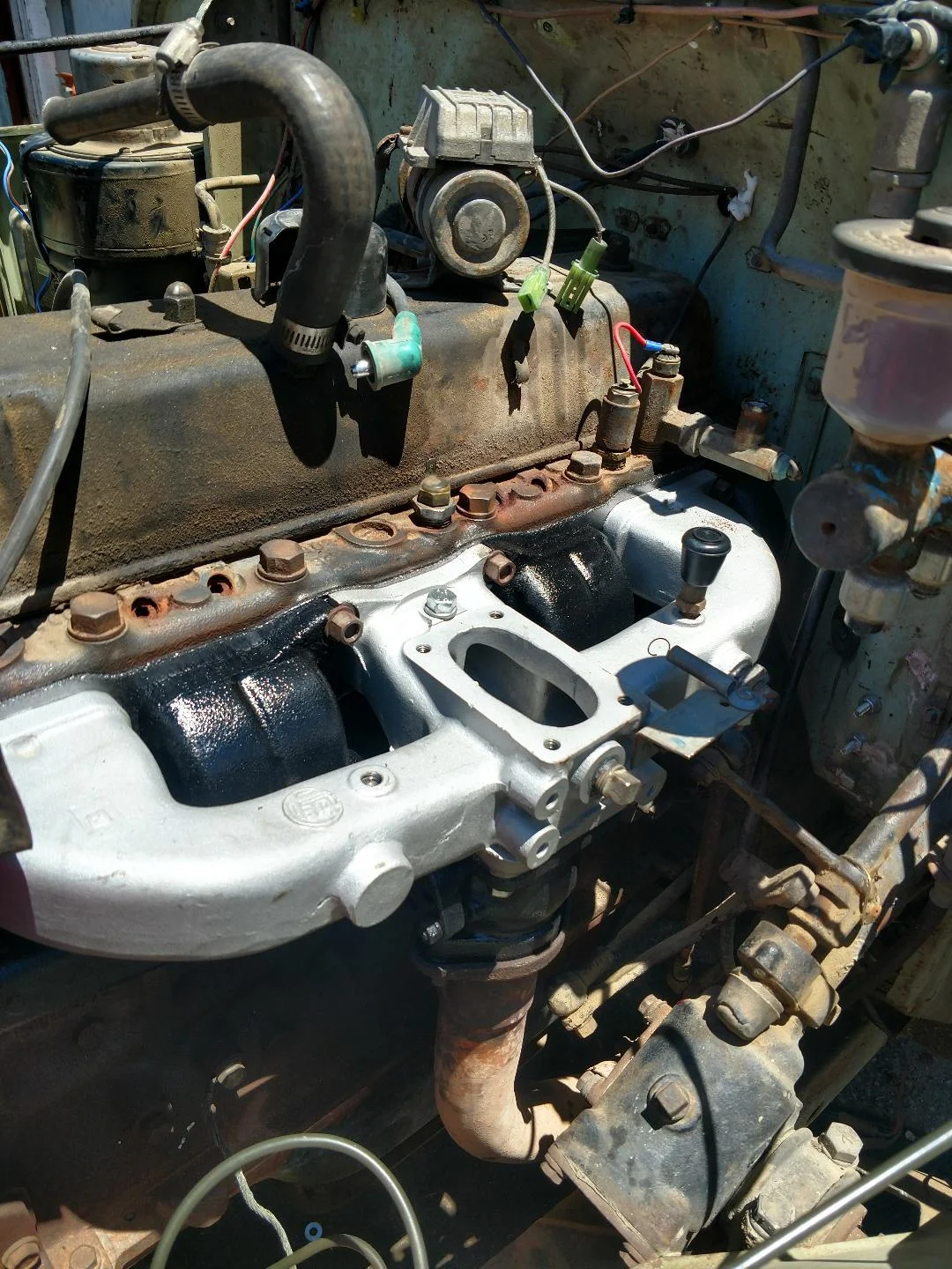

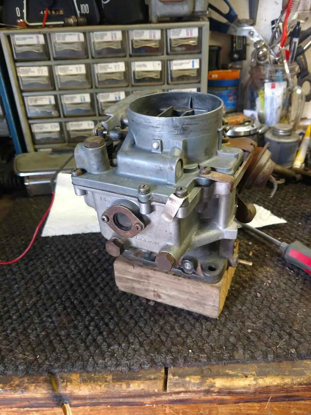

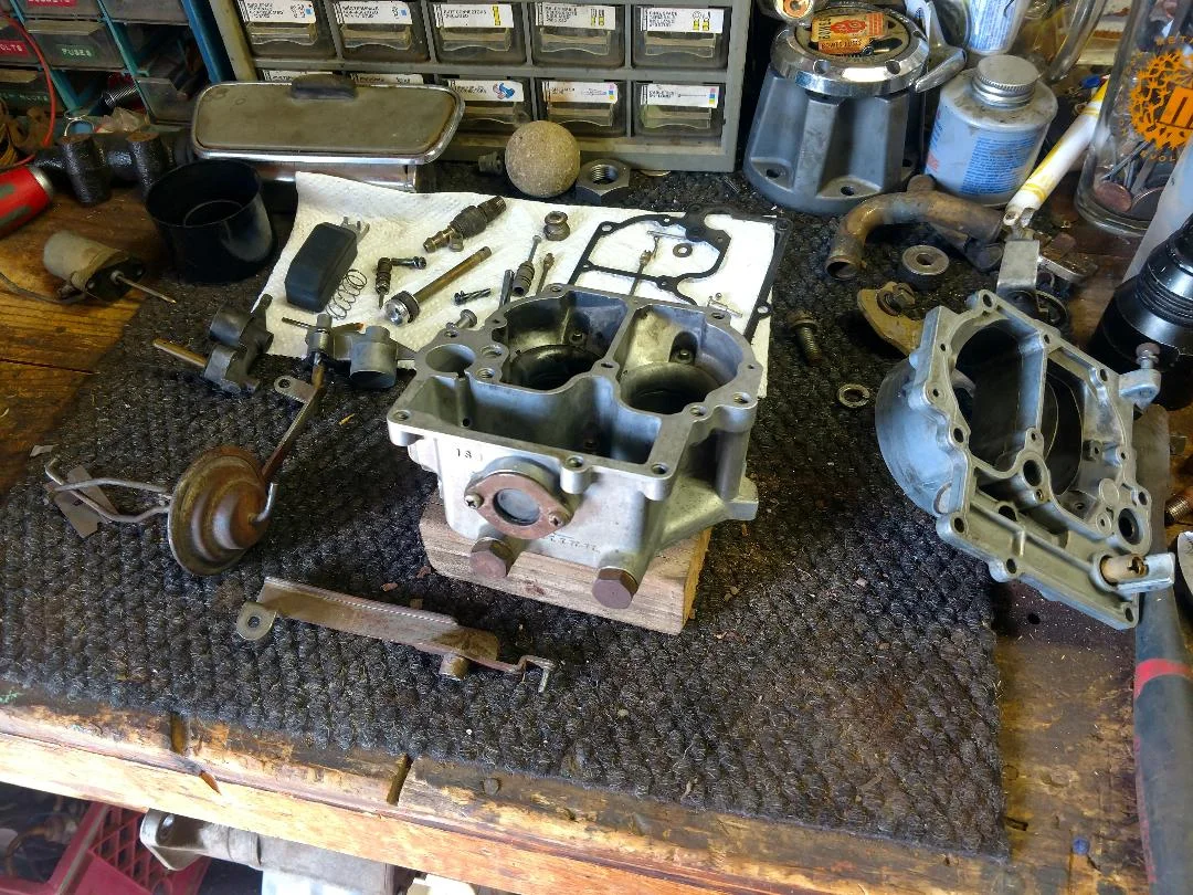

We have had a nice couple of weeks and things are coming together. Cleaned up the intake and exhaust before reinstalling. Finished up the carb rebuild and working on cleaning up the wiring and engine compartment. Justin got the SKY's Off Road springs down to me last week. Right now I am focused on getting the motor, trans and T case dialed in then we can start working on the suspension.
Trans and T case were installed Saturday, Thanks Dan GL. also got our new motor mounts installed Thanks to Cruiser Brothers. Finished up getting the e brake and rear driveshaft installed today. Still a lot of items on the list but its coming along
