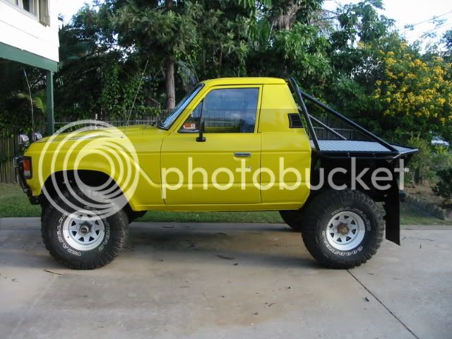

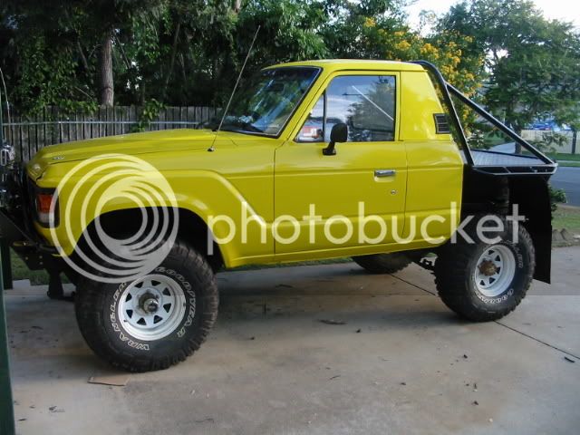

Either do I...thats why I chopped it off ;) :)
Pretty sick Loomis! I saw it in your avatar and wanted to see a big pic of it. You read my mind! Someday when/if I wad up my ass end, it may see a bob-job! :cool:
That is some impressive work Loomis!
Very nice!

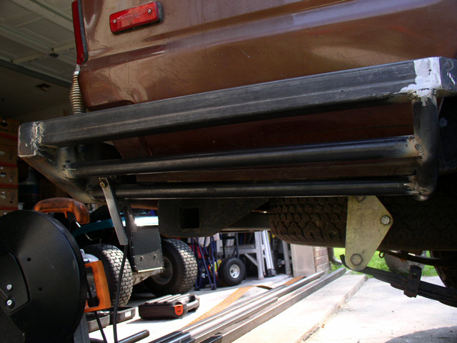

i passed on adding a trailer hitch, thinking it hung down too low. sounds like it is a cheap way to go until i can afford a big-bucks custom bumper. may i will get tapped at a stop light someday and add some coolness on the fix-up.

I added a big bumper with wings to drag across the rocks
but I still hit the hitch way more
the other I just chopped the shiat outa :lol:

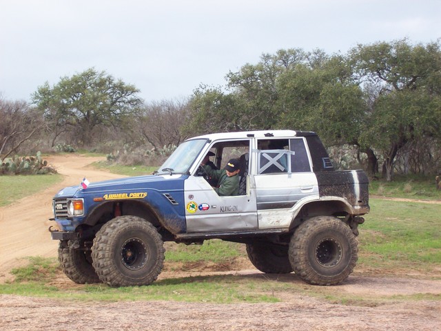

and patches will be on color soon ... its a 85 82 87 70 84 65 FJ 59.5 thankyou :grinpimp: and I like her too .... going to add a nother cruiser to here nexted month when I swap doors and chop it :cheers:
but if you make patches 1 color then it wouldnt be patches anymore...
