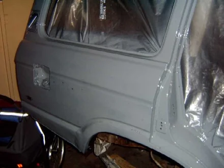

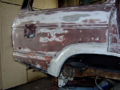

SO I bobbed the quarters too. But on an angle.....
I also welded in a new lip around the opening. After wards I used a slight amount of POR-15 filler and made it smooth.

brownbear - I like your design. Do you have a thread started or more pics? I'm doing the same here very shortly but was trying to decide how to protect the quarter panels, tie into my back bumper and not use some big hoops. Please keep us updated with your progress.
