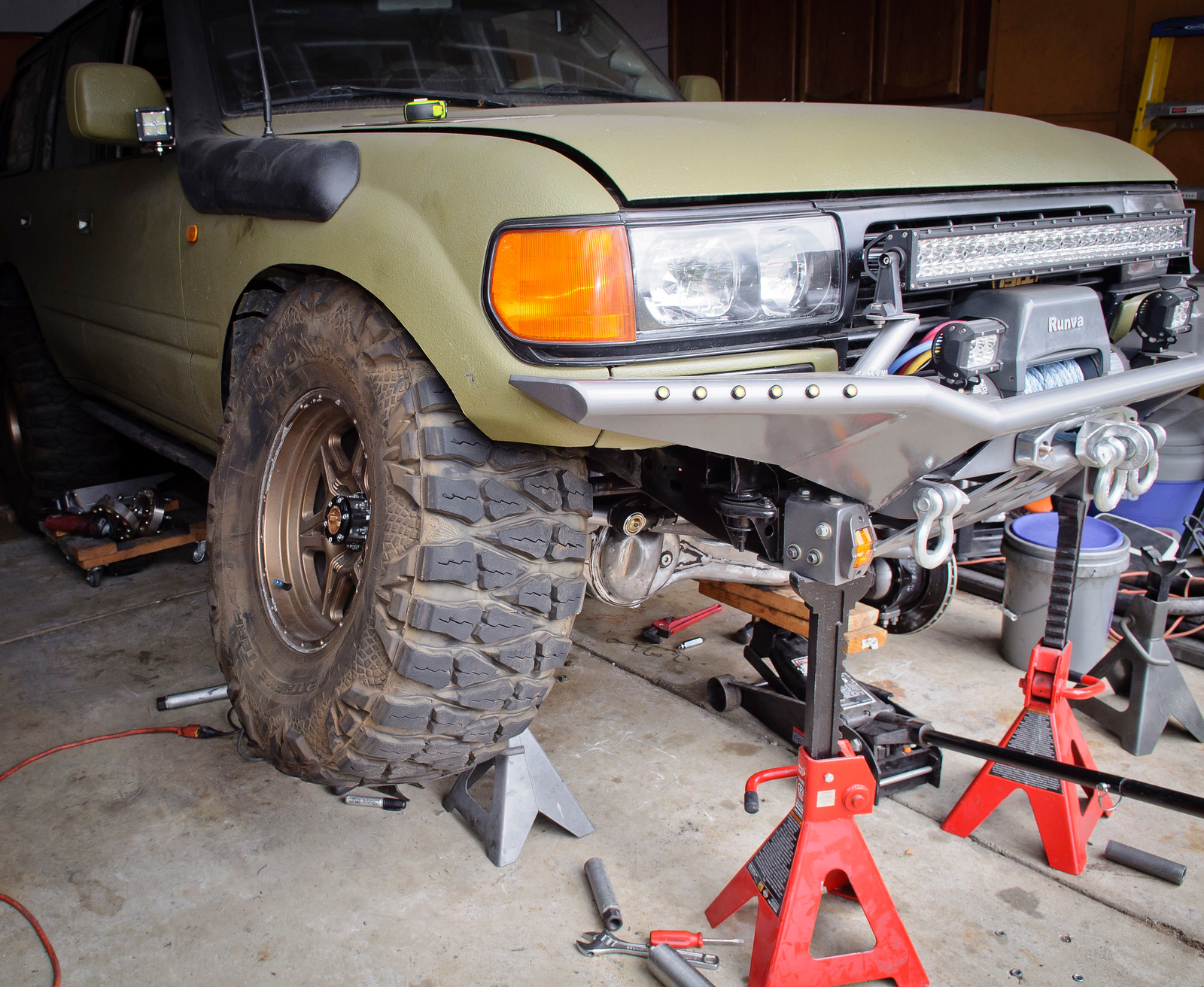

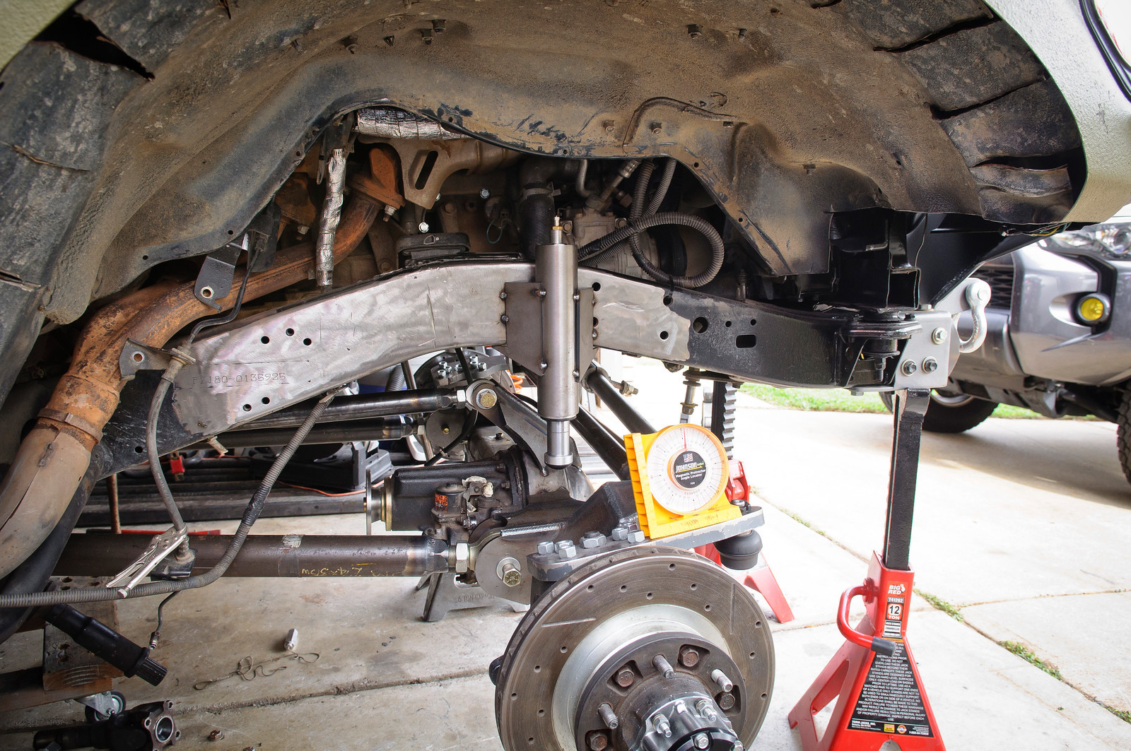

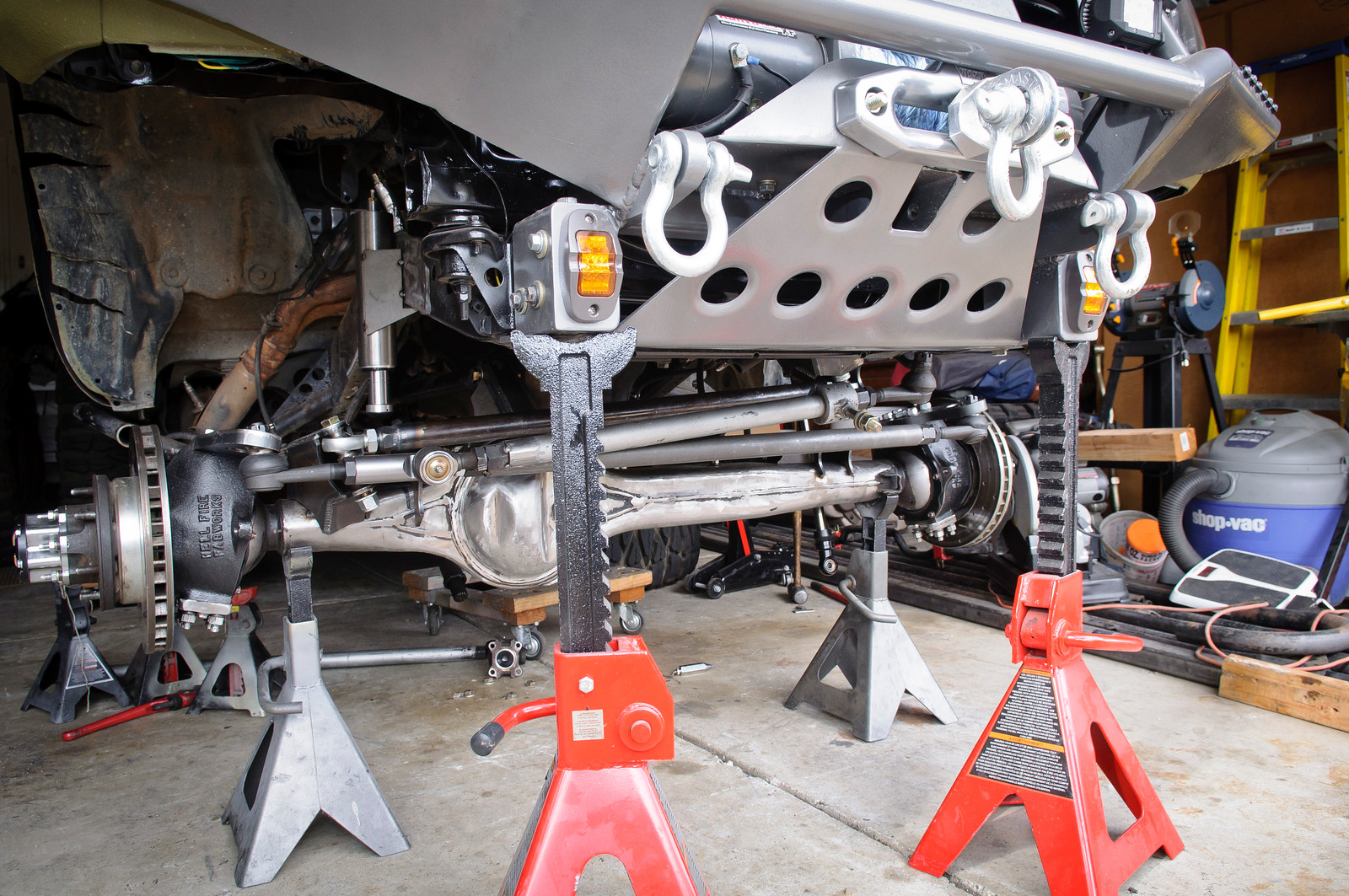

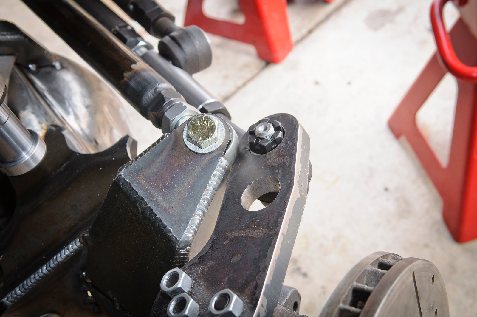

So I finally have everything tacked in place except for the shocks. Still need a bit more measuring before I decide where those are going. There were a few little things that were preventing from going any further. One was the passenger side control arm mount. As mentioned, the bolt would interfere with the e locker motor as Brian only had a non-locked 80 for mock up. In fact, it's just that tiny little hump that sticks out. Otherwise it probably would have been fine. Brian was a great help as usual and quickly sent me a machined & threaded insert to replace the nut. All I had to do was drill out the hole a bit bigger and weld it in place.
And finally I could tack the bracket in and move forward. Note the long bolt that still needs to be trimmed down.

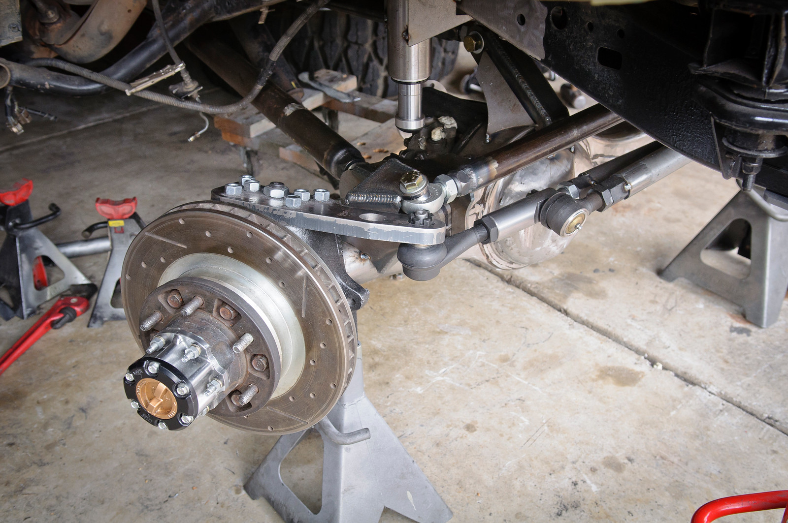

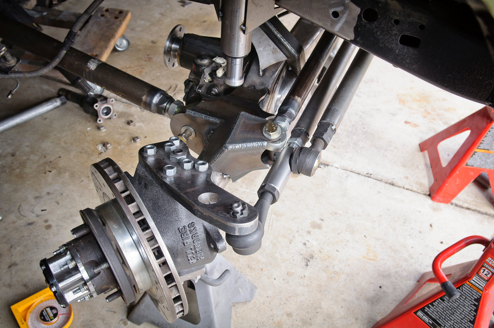

The next set of snags was with the steering. I wanted to reuse my y-link steering so I asked Billy for 1-ton inserts to go in his Hellfires. Well the inserts were too big for my GM 1-tons. What gives? But the taper seemed to work fine on my draglink TRE which is slightly deeper than a GM 1-ton. Not wanting to wait any longer I took a drive out to PartsMike in Auburn and picked up some their deeper taper draglink TREs (ES2027).

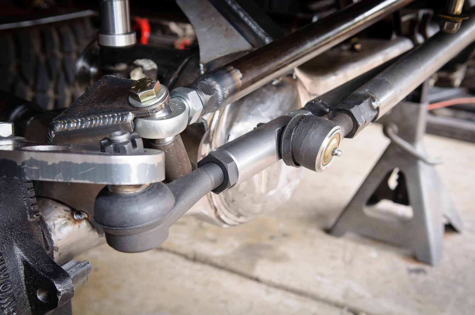

But this meant I would lose my y-link TRE, leaving me nowhere to put the draglink. And due to clearance issues, I believe a y-link is going to be the best option with the 4WU kit. Luckily RuffStuff just made a y-link adapter, big machined piece of chromoly that adapts to any TRE you want. This gives you more options. And luckily they're only a short drive away from PartsMike.
Here's RuffStuff's y-link adapter.
The beefier ES2027 tie rods with the taper to match Billy's inserts
Steering all connected. Because the new tie rods and y-link adapter are much longer than the single y-link TRE I had before, I had to shorten the overall tie rod by using new weld-in bungs.

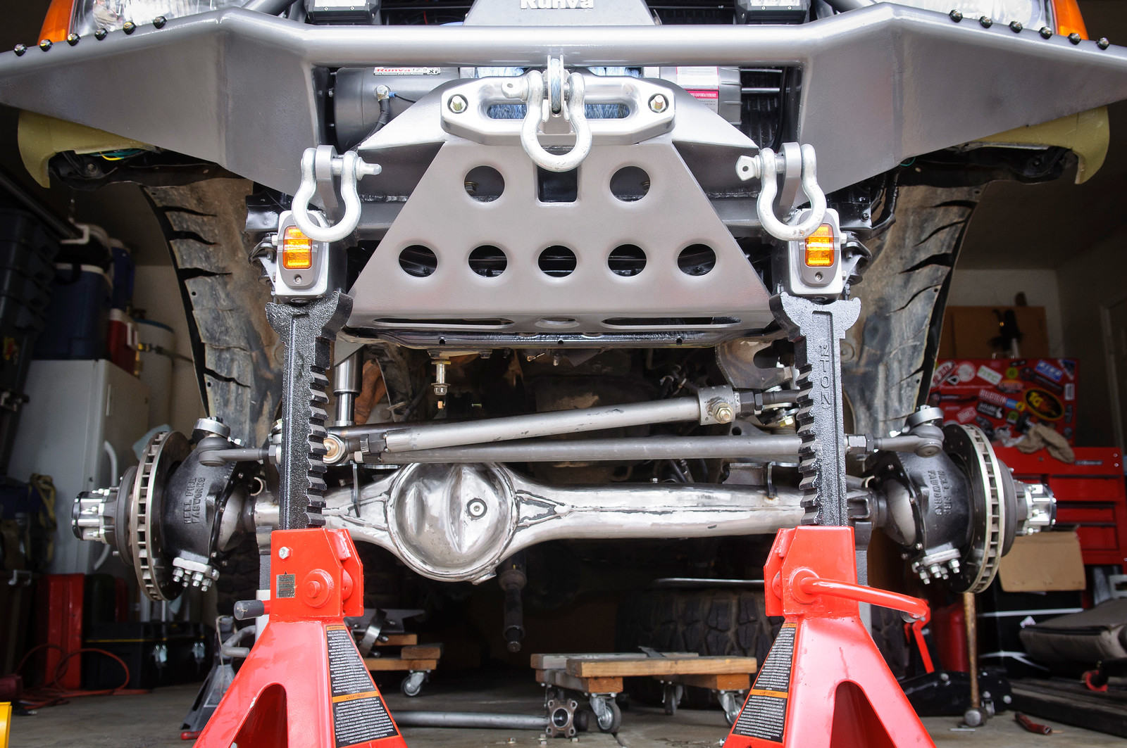

Full turn
About as far as you can turn the wheel to the left before the Hellfire arm touches the panhard's heim joint

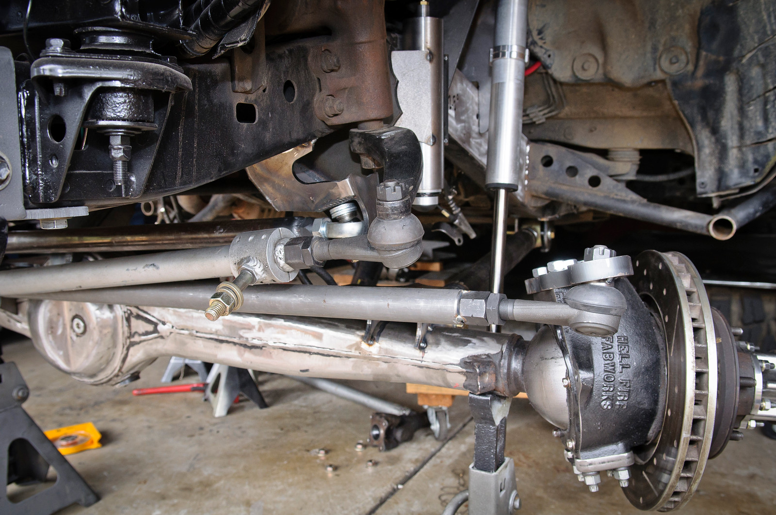

After that was done I started cycling and flexing and checking for clearances. I was surprised to find how much up travel is limited on the driver's side because the tie rod hits the pitman arm. You have a lot more up travel on the passenger side. Are there any flat pitman arms for these trucks?
I then set the bump stops. Just tacked in place in case I did screwed something up.

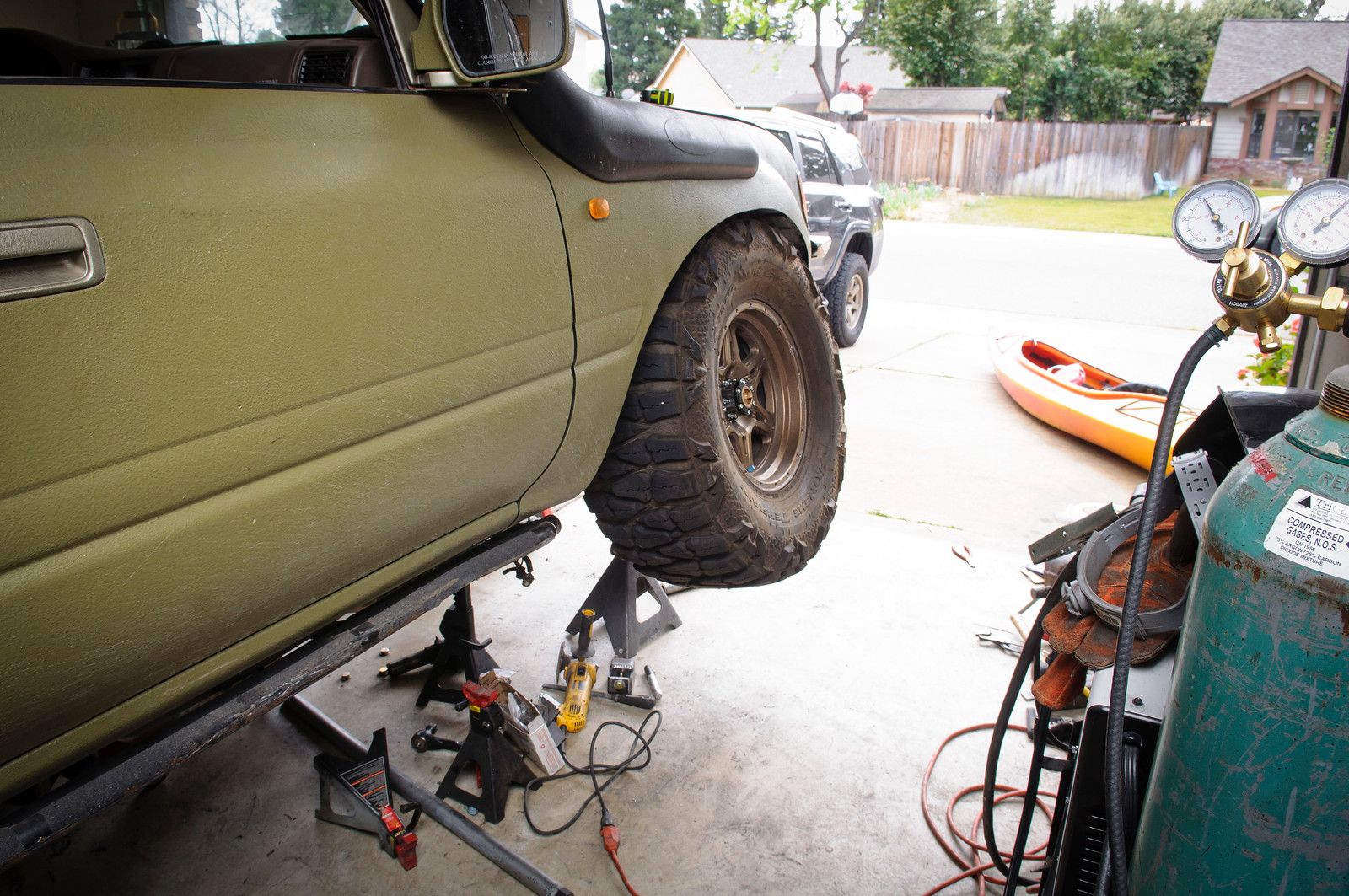

And started playing around a bit with a tire mounted

This is true. Folks should keep in mind I cut a 3" arc from the outer fender and notched the inner fender to match. You probably wouldn't be able to stuff a 37" tire like I did in that picture on factory sheet metal.
