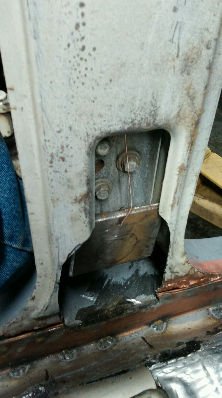

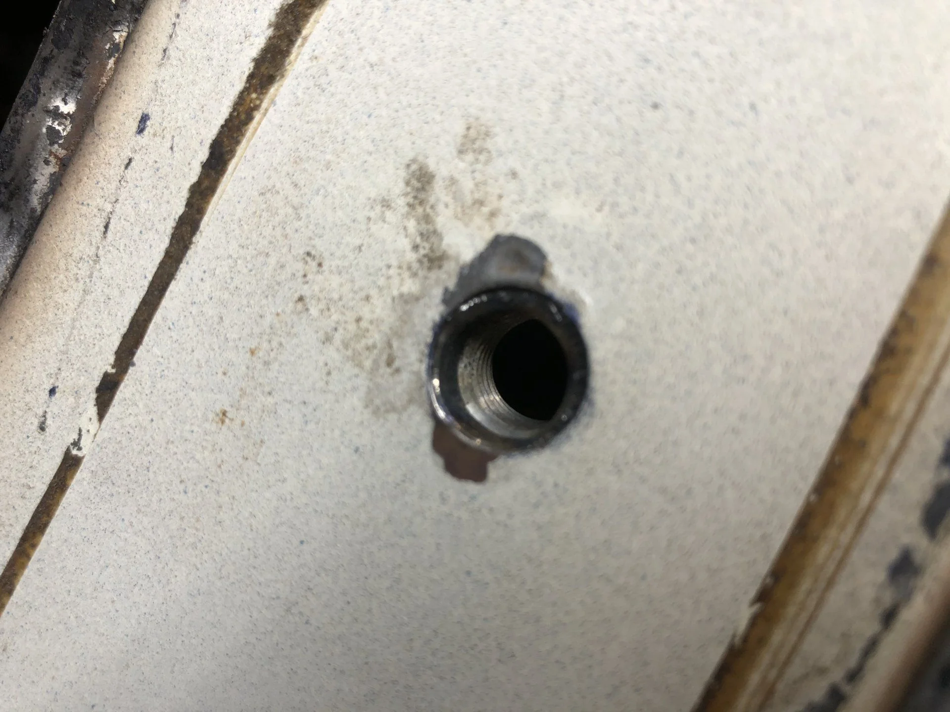

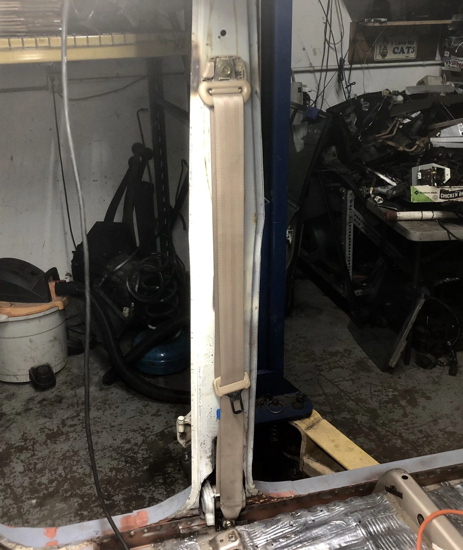

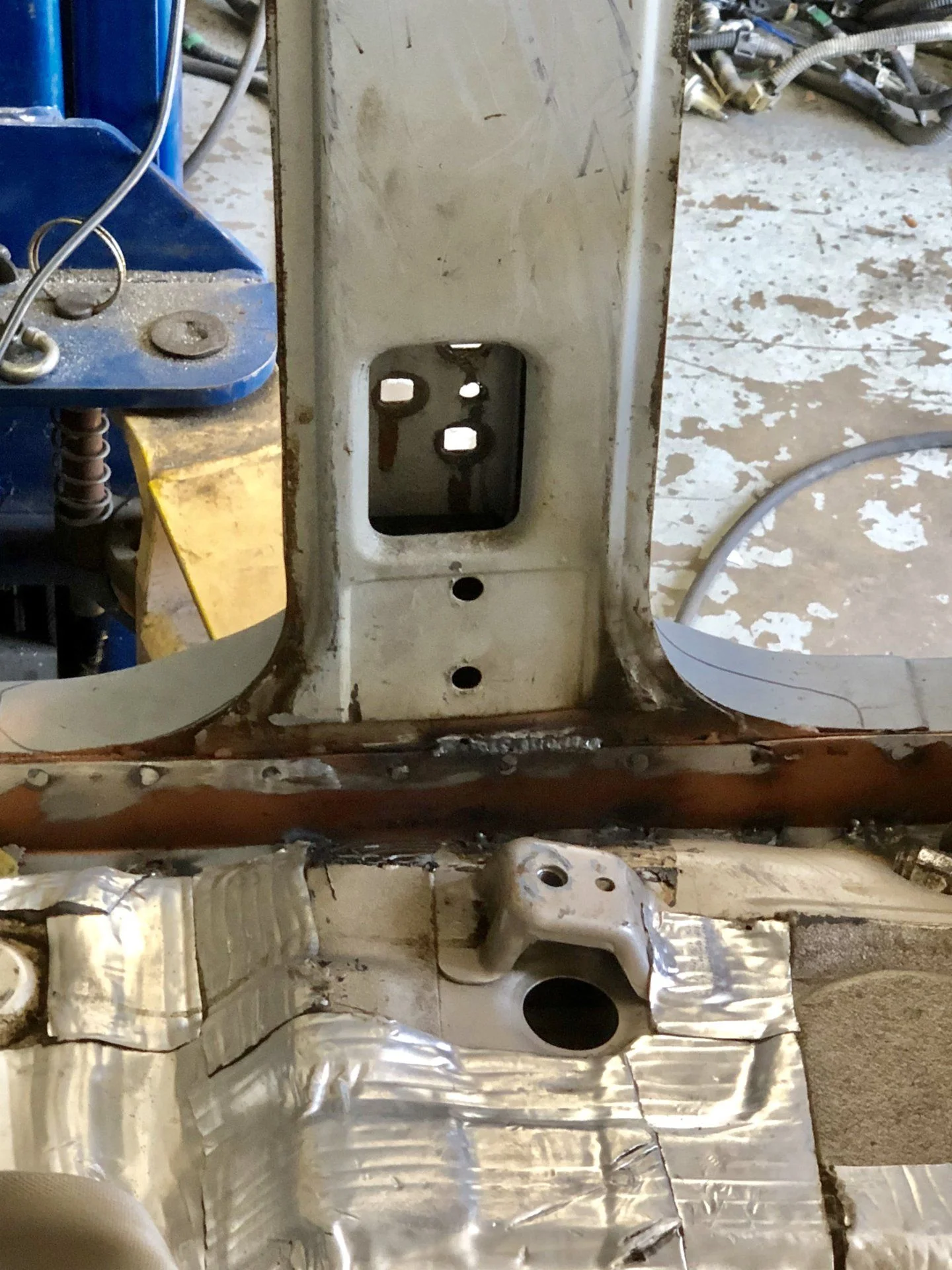

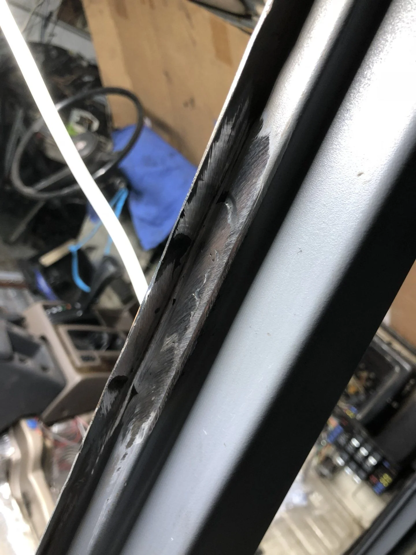

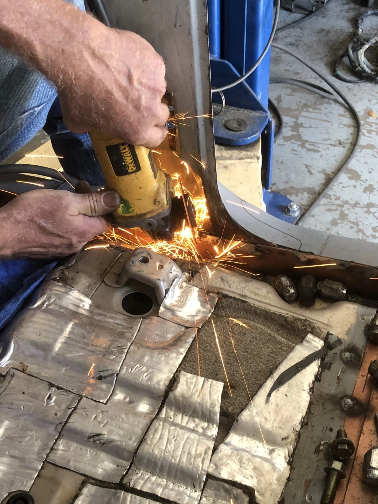

Frank is installing reinforcents in the b pillar that will allow me to use the 100 series front seat belts. The 80 series seats have the same receiver.
The 55 has a hole in the b pillar right where the top of the 100 seat belt needs to be mounted. Unfortunately there are no threads behind it. Well there weren’t til Frank showed up.
