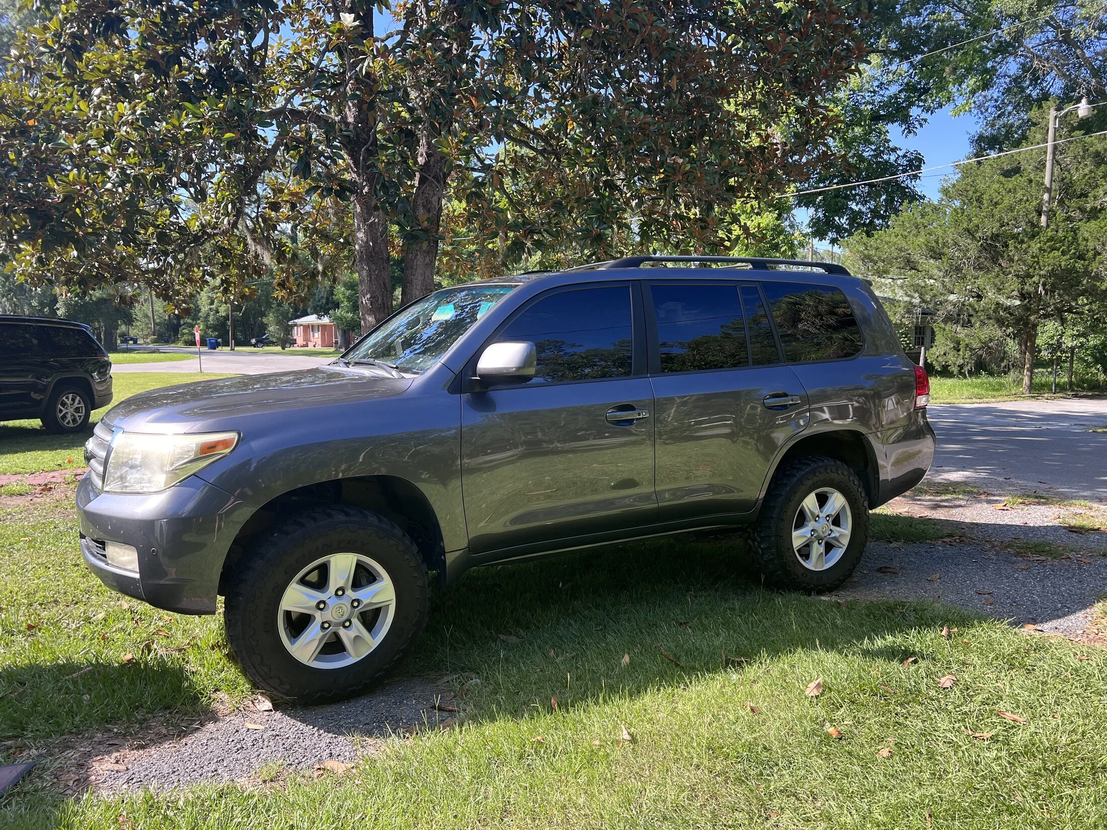

Im a lover of both platforms and with kid about to turn 16 I knew there was gonna have to be a new cruisers in the family. After weighing all the pros and cons of an 80, 100, and a 200 we came home today with high milage early 200. A very clean rust free 2008 with 280 miles on the clock. We were able to pick it up for what alot of late model 100s go for. At less than 20K in the end it was a no brainier.
Having wheeled and built all 3 platforms I felt like this was the best route to take. The 200 being more durable and safer than the 100 and much more modern and comfortable than the 80 sealed the deal.
So I guess I can't say the 100 is the LC to buy especially if talking late model 100s vs early 200s. I would haver been happy with either but I look forward to experiencing him learning to wrench, wheel, and become part of the community in this rig. Fun times ahead :steer:
