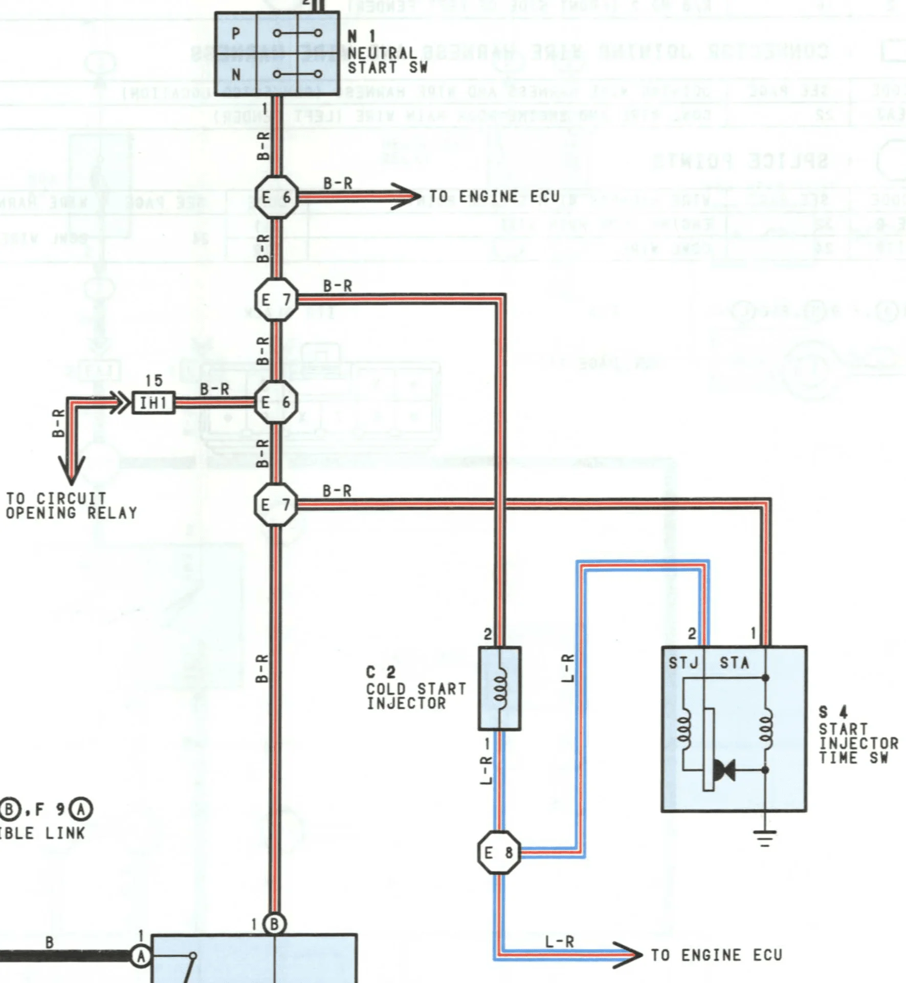

Finally had some time to go over the FSM schematics. So you connected the Fp and +B terminals. That connects your ignition power +B to the fuel pump Fp. Connecting those two terminals in your diagnostic port bypasses the EFI Main Relay and the Circuit Opening Relay. This allows fuel to flow. My guess is it allows fuel to flow to the injectors but not to the Cold Start Injector unless the cold start injector time switch tells it to. If the switch says yes, then the injector coil energizes. Theoretically you could apply 12V directly to the correct wire and bypass the switch.

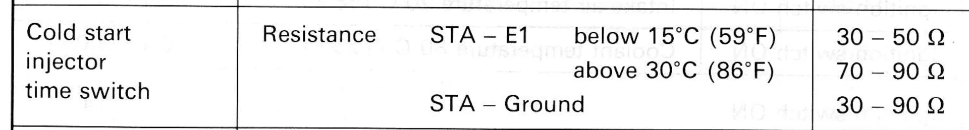

Testing the cold start injector time switch on the t-stat housing:

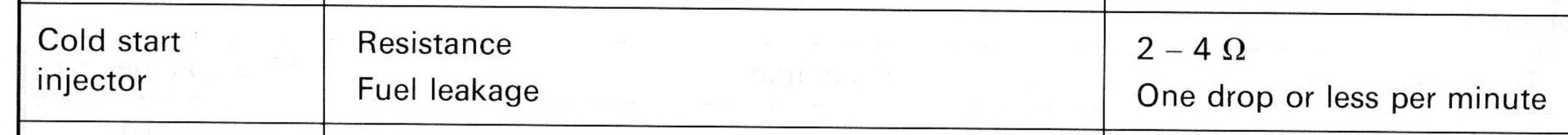

cold start injector resistance check:
