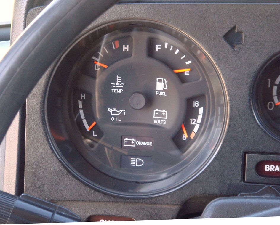

Thanks for the link to this thread on the sticky - I'm reading through because my temp and fuel gauges have begun to spike fairly predictably while climbing long hills. While climbing, the temp and fuel gauge levels gradually increase, then suddenly spike right about the time I'm reaching the top of the hill. It's disconcerting to say the least. Driving up a hill, the accelerator pedal feels like a squishy hair-trigger that will make those gauges pop when pushed too hard. I can't remember any time that the gauges have spiked randomly - it's always been on a hill. During a recent long drive in upper 90F temps this happened more often than I've previously experienced.
Is it possible that a certain engine temperature range would trigger crazy gauge spikes? Have others had the experience that harder driving situations (that could realistically cause an overheated engine) are associated with gauge spikes?
I don't want to ignore actual cooling system issues and blame crazy gauges. I guess I'm worried that maybe I'm not worried enough (if that makes sense)!
I apologize for bumping an old thread, but figured this would be appropriate here. I had the engine temp. gauge problem (randomly spiking) and it looked like my fuel gauge was incorrect too (its appears stuck at 1/2 full). I pulled the fuel gauge and cleaned it with emory cloth as outlined above. After putting the gauge back in and driving the 60 around, the temp gauge now doesn't work at all. The temp gauge never moved from "C" and the fuel gauge stayed at 1/2. Any suggestions on where to go from here? I can't seem to locate a new fuel gauge without spending $75 for a used one. Are there any shops that I could send my current gauges in for repair? I'm really trying to keep the stock look of the truck, therefore aftermarket gauges aren't an option at this point. Thanks!

yes take the cluster/dash out(its super easy) and then the fuel guage out. On the back of the fuel guage you will see a little points contact, clean it with some emory cloth(or something like that) To be honest I got mine so it happened less often(it will get worse and worse) but decided I didnt want to have to worry about it for anohter 100K+ so I bought a new guage.

I know this is a super old thread but this problem began occurring for me the other day in my 60. I took apart my fuel gauge today, is this the contact point you are referencing to? I went ahead and rubbed some emery cloth between the two but wanted to make sure I have the correct location. Multiple threads explaining this but I haven’t been able to find pics. Thank you in advance!
Yes, those are the contact points. Sometimes cleaning them up will improve the Temperature accuracy, but in my experience, it doesn't work very well. You're really much better off installing a quality aftermarket Temp gauge. Electrical is way easier than a mechanical and will be way more accurate than the stock gauge.
