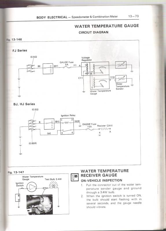

Pic of Fuel Gauge and Voltage Regulator (stabilizer) on right side. Large black cylinder with two wires out the top is a capacitor. Stabilized voltage is fed to the Temperature gauge. If the volt reg is bad, you get the spiky or inaccurate temp readings. What VT has done is essentially cut the old-style mechanical voltage stabilizer out of the circuit and inserted a modern solid-state one.
In lower pic, Red is fuel gauge out to Green, temp gauge regulated voltage pos.

(as a note: if that screw next to the contacts is turned IN, voltage is increased. If turned OUT, voltage is decreased). FSM says voltage should oscillate between 2 and 7 volts.

The fuel and temp gauge run off a strange little voltage regulator built into th gauge. It looks like a tiny little contact and magnetic switch. I think the way it works is it opens and closes quickly, and the 12 volt is dropped to about 6 volt. This little doodad goes bad, and gives full 12 volt to thse two gauges which make them spike. I was able to rewire my fuel and temp using a 6volt transducer (is that the right word) about the size of a piece of gum.
