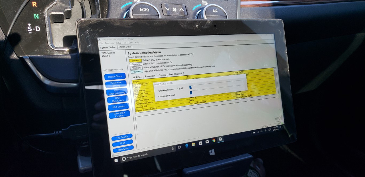

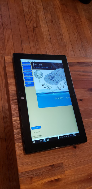

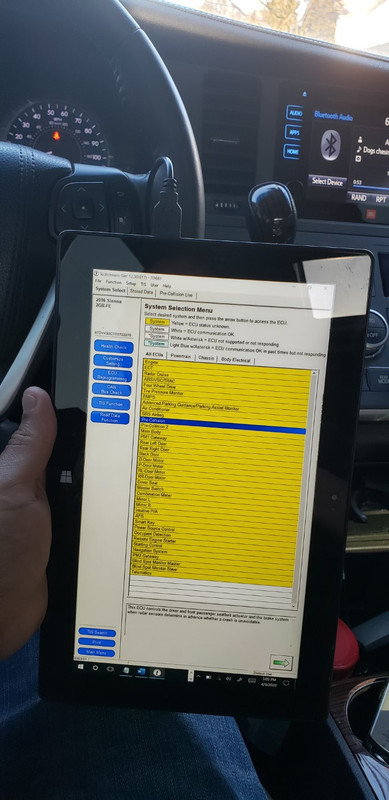

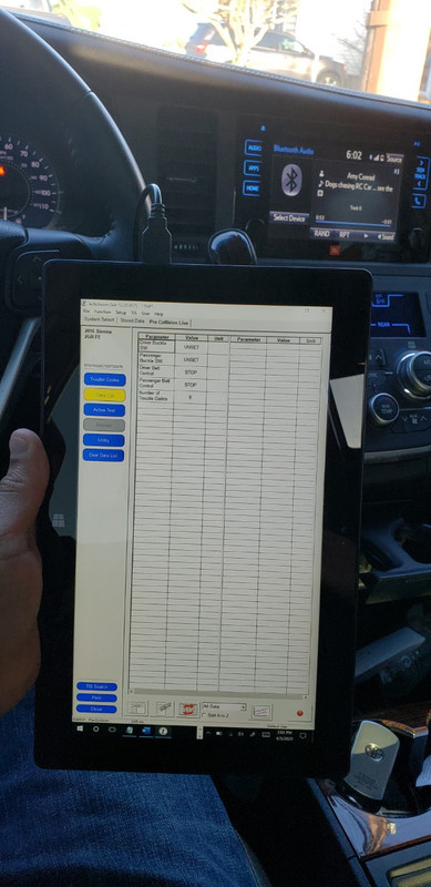

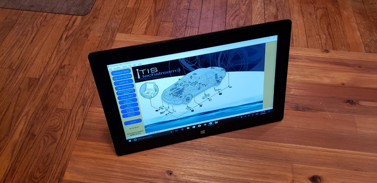

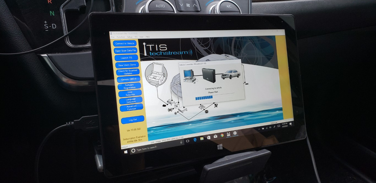

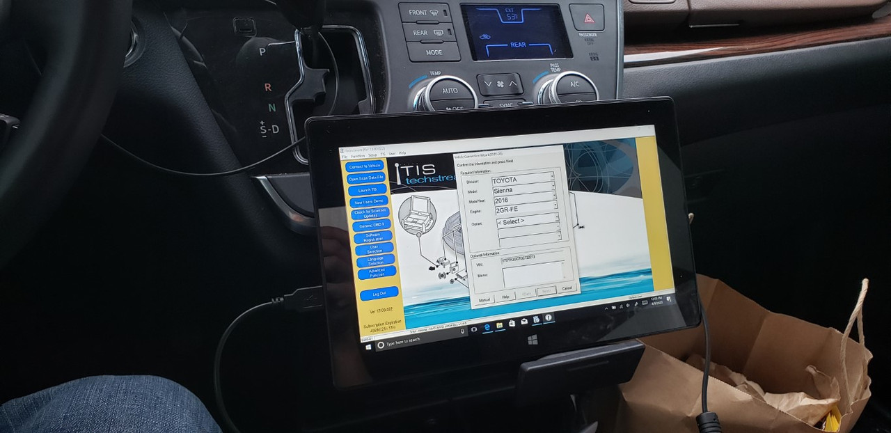

Ok, I went ahead with the SP and it's working MUCH faster than my old XP notebook :)
Booting up is instant and I love the fact that I can rotate and use it full screen :cool:
Only caveat to others that may come across this is that there is a CHROMEBOOK version of the Surface (and other 2-in-1 tablets) that this WILL NOT run on. You do need a Windows OS (or other OS if you plan to run it via the VB). Other than that, the tablet/2-in-1 is actually pretty optimal.
