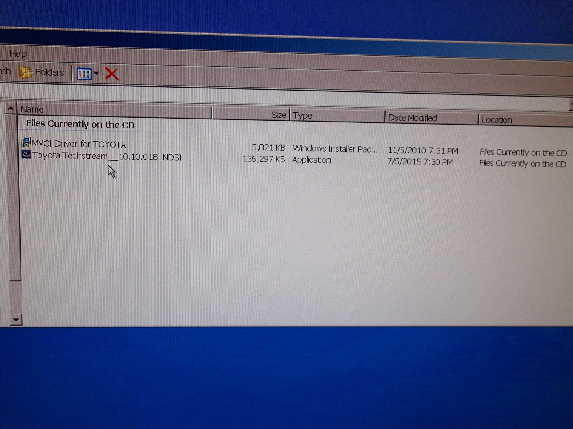

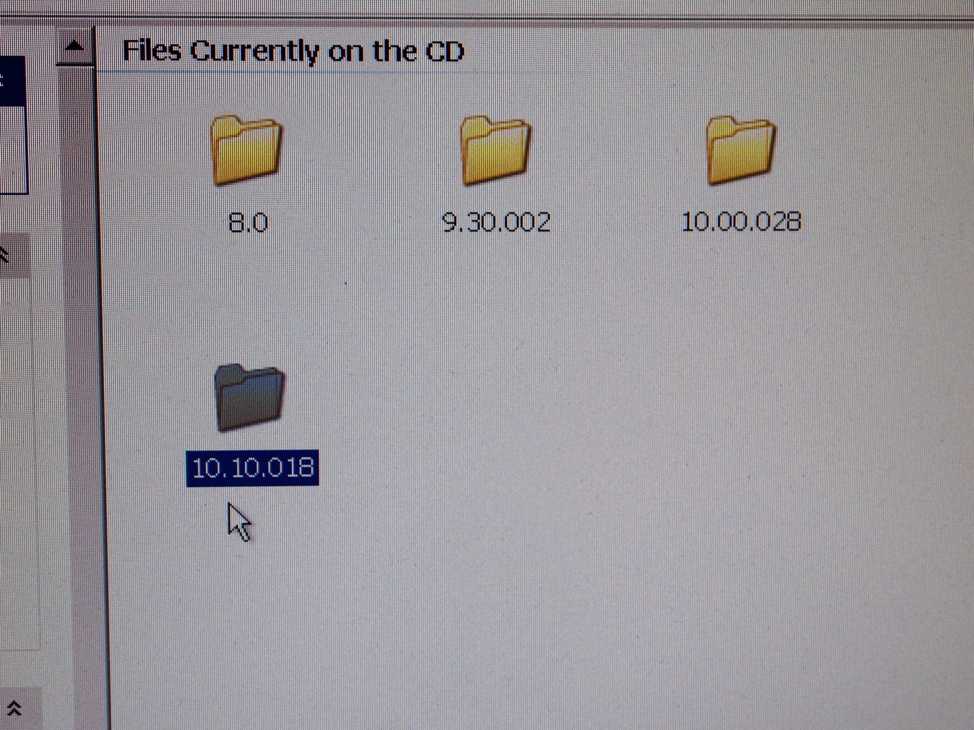

BTW:
I did try and install the high number application. But it froze my CPU and I had to hard boot out, then start over. Seem I had this installed before but I'm not really sure, as I've gone in and out messing with this so many times.
Any idea why this wouldn't install and does it offer more features I may need or want?

I did not change anything or install anything else. Other than the GTS_10.00.028_NDSI, MVCI Driver for Toyota and checked to see that "=1 was =0".
