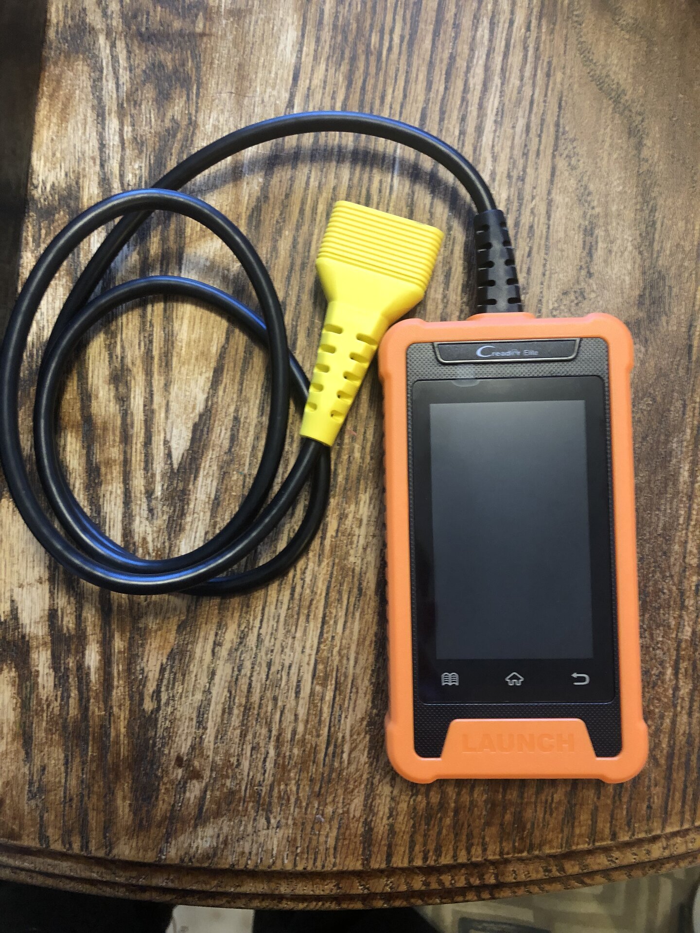

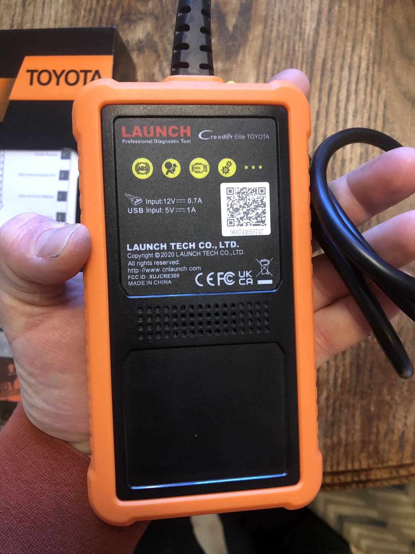

Well it showed up today, looks like one would expect, good packaging, instructions etc. After updating it seems to work as advertised. I have not messed with it much other than checking my alcohol density setting and clearing a fault code. Also hooked it up on my friend's Subaru and global OBD2 worked fine. For me having an updated scan tool that will reset the flex fuel alcohol density makes it worth it for me. I was also able to reset the transmission fluid degradation values as I just changed my fluid.

Interesting. I don't see this on the Launch website, so a counterfeit or private label version. Looks like a copy of the Millennum X.
