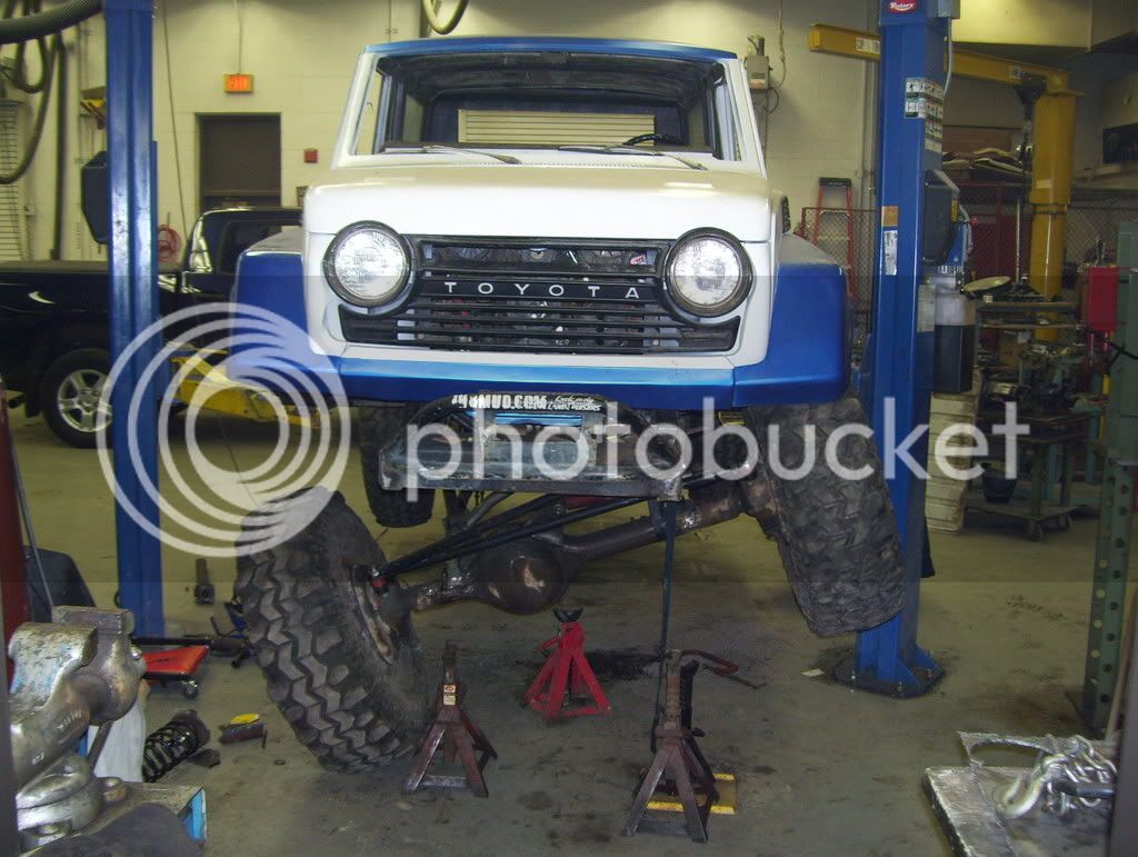

Looks like the 3 link flexes OK. Everything looks like it will clear everything else as the axle moves.
The front clip is just sitting there. It still needs to be bolted down. I didn't know if I was going to take it back off for anything.

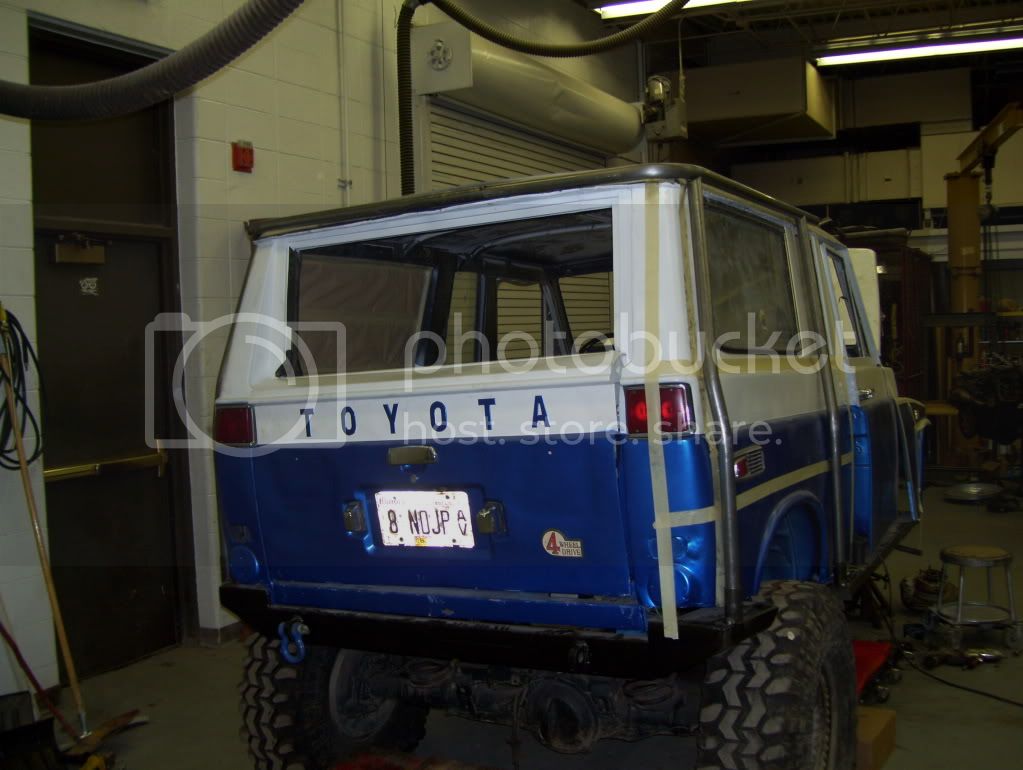

Finally a bit more progress. 4rnr and BAMF_CT2004 came over to give a hand with the cage while I was working on putting the front axle innards in. They laid it out with masking tape first, then started bending tube.
The bases on the sliders and bumpers were to make the cage removable, but I don't think it's gonna work. They were very helpful in getting things lined up, getting the bends right and marking the notches.
Lots of standing around looking at it and brainstorming. We completely re-did the front after we had cleaned up for the day.
I'm thinking pretty seriously about mounting the winch under the passenger's knees.
I have to say the D pillar tubes are pretty sexy.
Thats going to be a sexy cage, its coming along well.
That winch has to go under the pass knees! It just makes too much sense!
Looks killer. Just from what I have experienced with removable exo's is that once you wack it pretty hard stuff doesn't want to line back up. Some of the removable cages end up being permanent from being a little bent. Just a thought, could save you some work...
yeah it wont be removeable. We may stop at the a-pillars/cowl bar and remove it for finish welding. The put it back on and build the nose.
I think the cage would look killer pained to match the body. Plus it will be functional. This cage will be TIGHT!!! and its going to scuff the paint on the body a bit. If the cage is the same color you can paint the entire area, with out worrying about masking.
