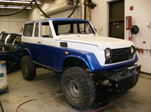

Kinda has that hod rod coupe look to it
Thanks. Cutting off stuff on the front frame rails. Gotta cut off the axle side link brackets because I changed rod ends. got a good start on an AA style triple stick. Got the driver side vent mounted.

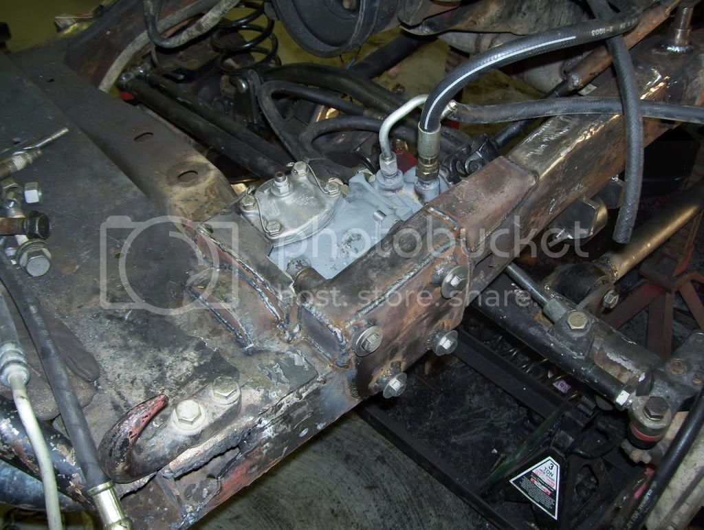

Saturday I worked on mounting the p/s gear and finding a new way to run the panhard since it was clear there would be interference issues with the ram.
Today I got the steering done for the most part and got one of the lower control arms all the way built. I also built one set of the frame side control arm mounts. I built one of the upper spring buckets too, but realized the axle had to be 100% located to get it just right and put weight on it.

Looking good Todd! You should be done with yours before I'm done with mine! Where did you get the high pressure side hose for your Saginaw? I could use one!

The high pressure hose is stock off of something on the old system. It would be different for a 40 that has the box located in front of the cross member. I would guess that there would be a part number on the 40 forum somewhere.
That Howe setup on the new pig uses -AN fittings. It came with the 45LV and was overkill for a road going beast.

Thought that ram and pump looked familiar...
