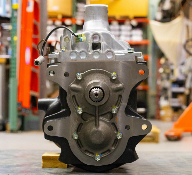

First, there are many great posts on this subject here on Mud but they are in dozens of different threads. I wanted to share some of our internal reference docs and information we use to assist customers and build H55F/BF1 Split T-Case transmissions and transmission/t-case combos.
(33030-60450 / Cruiser Outfitters Part# TR60450 Shown)
There are 20+ different iterations of the H55F (EPC: 33030), many are minor changes, the most prevalent differences being associated with the Input Shaft (EPC: 33311) and Front Bearing Retainer (EPC: 33131). Input shafts are matched to the front bearing retainer by the bearing, seal and length. Fortunately these changes are easily identified both externally and internally.

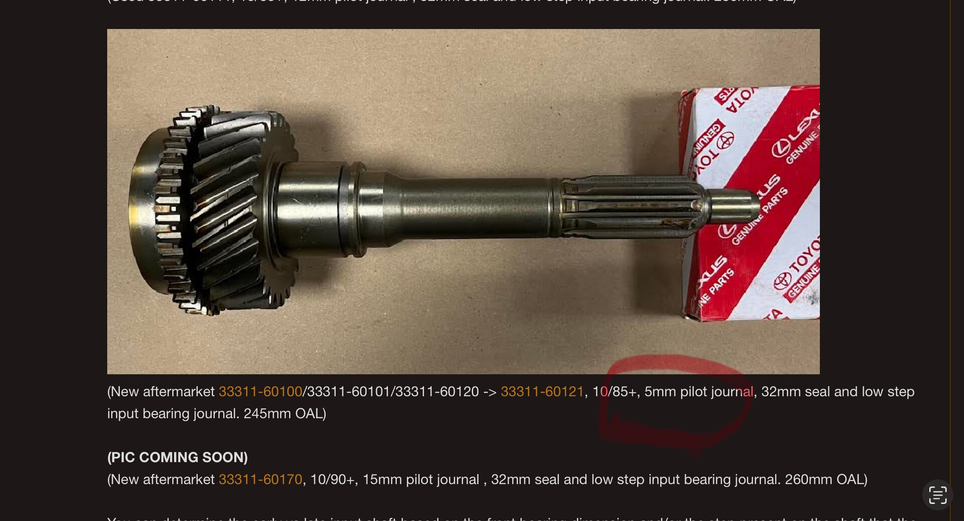

The H55F has (10) different input shaft variants for use behind the B, F, H, & HD/HZ family motors. Those (10) supersede to (5) different total variations. B early & late, F/H early & late, and 1HD/1HZ. All of these shafts have a 26-tooth count on the gear itself. The shaft splines are available in a 10 (~27.7mm OD) or 21 (27.8mm OD) as well as 3 different overall all shaft lengths (measured when loose from transmission), 245mm, 260mm, and 280mm.
The major difference is the internals and they correspond to those early (10/1982-9/1985) and late (10/1985+) versions of each transmission.
Note: there is only (5) because there was never an early (10/82-9/85) version of the 1HZ 21 spline variant with the medium length shaft.
(New OEM 33311-60070 (Supersedes to 33311-60090),10/1982-9/1985, 15mm pilot journal, 28.5mm seal and high step input bearing journal. 245mm OAL)
(Used OEM 33311-60080, 10/1982-9/1985,12mm pilot journal, 28.5mm seal and high step input bearing journal. 280mm OAL)
(New Aftermarket 33311-60090, 10/1982-9/1985, 15mm pilot journal, 28.5mm seal and high step input bearing journal. 245mm OAL)
(New aftermarket 33311-60110, 10/85+, 12mm pilot journal, 32mm seal and low step input bearing journal. 280mm OAL)
(Used 33311-60111, 10/85+, 12mm pilot journal , 32mm seal and low step input bearing journal. 280mm OAL)
(New aftermarket 33311-60100/33311-60101/33311-60120 -> 33311-60121, 10/85+, 15mm pilot journal, 32mm seal and low step input bearing journal. 245mm OAL)
(New aftermarket 33311-60170, 10/90+, 15mm pilot journal, 32mm seal and low step input bearing journal. 260mm OAL)
You can determine the early vs late input shaft based on the front bearing dimension and/or the step present on the shaft that the bearing sits against. The taller step corresponds to a narrower input bearing (90365-40002), the short step corresponds to a wide bearing (90363-40035/90363-40037)

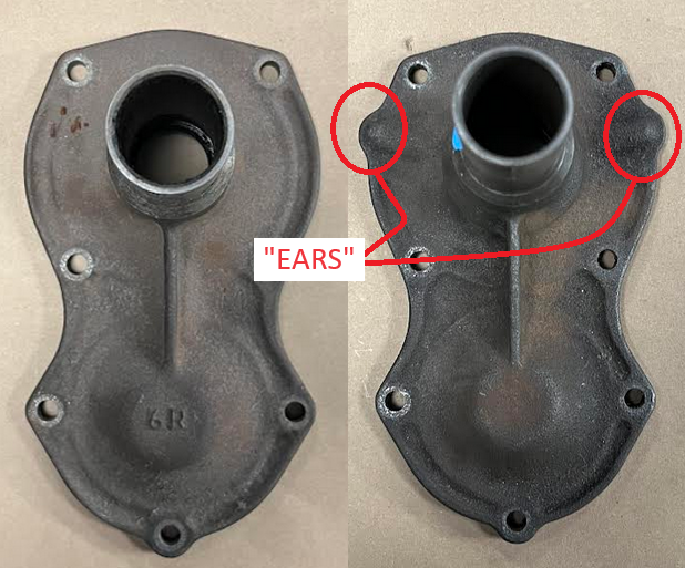

Bearing Retainer Identification:
Likewise, there are (4) different front bearing retainers utilized for the different models. Early & Late as well as "short" and "long". The early and late can be identified by the ears on the upper front face. Those ears correspond to oiling ports on the back for the retainer and transmission itself.
(Early (left) without "Ears" and the late style (right) with the pronounced "ears")
Early B/2B/3B/13BT short 21 spline retainer is 33131-60030
Late B/2B/3B/13BT short 21 spline retainer is 33131-60050
Early F/2F/3F/1HZ short 10/21 spline retainer is 33131-60020
Late F/2F/3F/1HZ short 10/21 spline retainer is 33131-60040

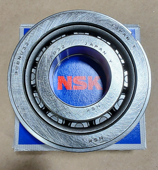

Early, 10/82-9/85 (90365-40002 - "Narrow")
(90365-40002: OD: 89.90mm ID: 39.95mm H/W: 22.85mm - Koyo# RCT40 Nachi# 40TRBC0727SB or NSK# 308NU32 - Cruiser Outfitters part# TCB40002

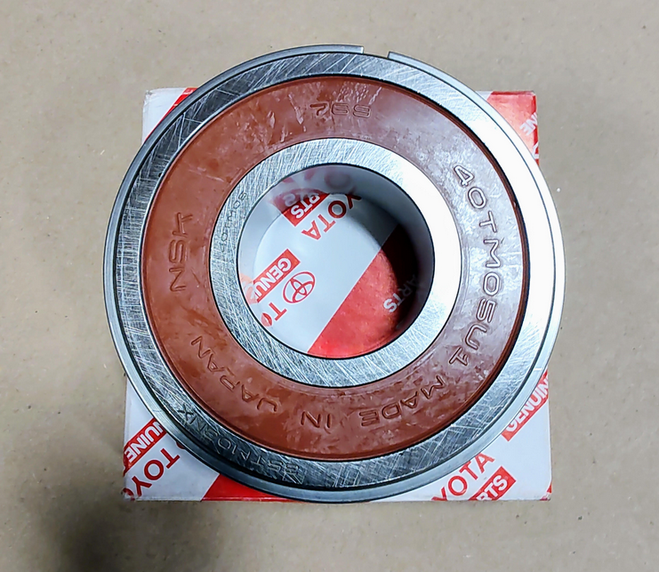

Late, 10/85+ (90363-40035/90363-40037 - "Wide")
(90363-40035/90363-40037: OD: 91.90mm ID: 39.95mm H/W: 25.4mm - NSK 40TM05U1/35TM03NZ - Cruiser Outfitters part# TCB40035)
NOTE: The OD changes (which can also be measured on the back of the bearing retainer), the height changes (that corresponds to the wide and narrow bearing journals on the input bearing.

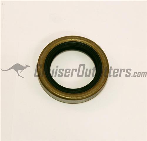

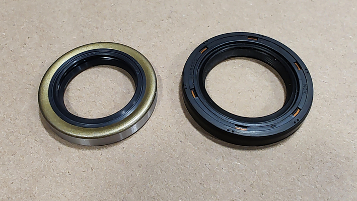

Input Seal Identification & Dimensions:
(Early 90311-28004 on left, later 90311-32013 on right)
Early, 10/82-9/85 (90311-28004) - Cruiser Outfitters Part# TR28004
(OD: 43mm, ID: 28.5mm, H: 6.5mm - NOK AD1623E)
Late, 10/85+ (90311-32013) - Cruiser Outfitters Part# TR32013
(OD: 48mm, ID: 32mm, H: 6.85mm - NOK AH1893G)

F/2F/3F/H/2H/12HT 85+ version:
(F/2F/3F/H/2H/12HT 85+ version Shown Above)

Likewise, there are (4) different bearing retainers utilized for the different models. Early & Late as well as "short" and "long". The early and late can be identified by the ears on the upper front face. Those ears correspond to oiling ports on the back for the retainer and transmission itself.

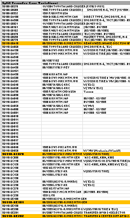

The transfer case is on the output shaft, not covered by this article. For the most part are split t-case variants (I've identified 63 different ones and I'm sure I'll find more) :D
