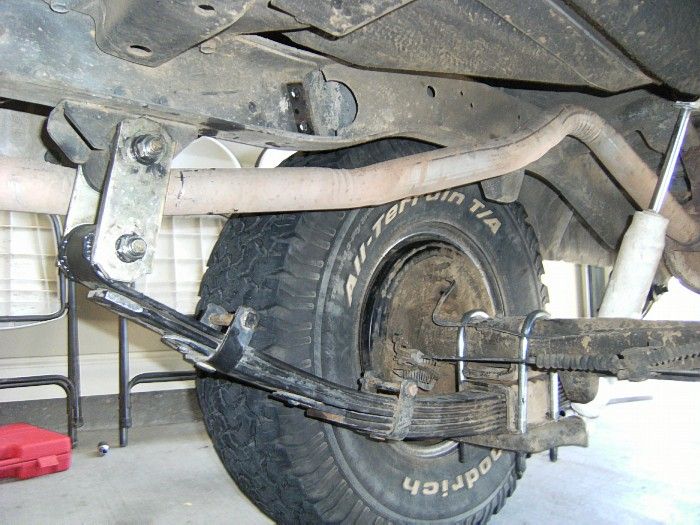

First back on
Just finished up. Anyone want to install some springs, give me a call. I think I'm an expert now. This looks right. I put the old back on but swapped them to the opposite side to see what would happen. Look pretty good.
That looks like where I'd want them. It looks more relaxed than they were before. :hhmm:

since sept. you have had the first set of springs...
did you have any problems with the the shackle inverting on you?
or was that one time after instalation the only time.
from that last pic i think your shackle angle looks really good.
they are about where mine are in the rear with some settled 4 inch lift springs.
i will still send those anti inversion shackles your way if you think you need them.
you are becoming quite the LC mechanic.....
awesome work!
It inverted on me on the Cruiser trailer from Alabama (SCC). Other than that I think that is it.
The rear driver had more angle to it after the first install. When I flipped them today, they both had the same good angle that you see today. I showed Tom all the pics and he's going to go back over everything tomorrow and get back to me. He's also working on the "hop" issue I have right now on bumpy streets. I'm going to take more to send to him tomorrow.
