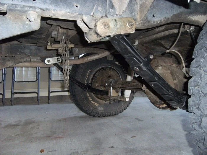

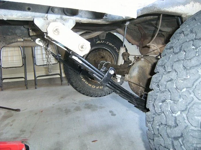

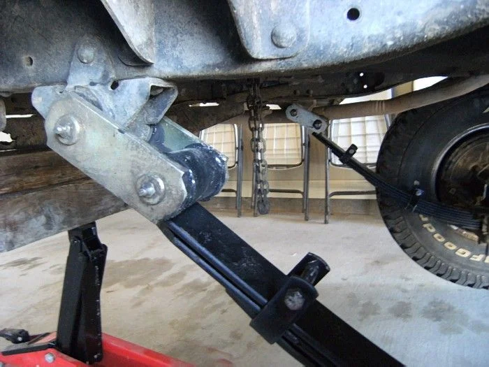

Here are some pics. Looks like my u-bolts are angled.
yup tooooo short.
hey when you had the other springs on the truck i can remember the shackle sitting basically straight up and down.
the optimal angle would be a angled a little away from the axle, towards the rear of the truck.
that is how the last shackle inverted when we had installed the suspension.
i will give ya call when i get back to give ya the anti inversion shackles i am not using.

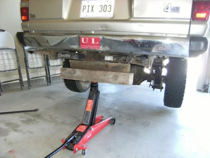

Put some blocks on top of the jack and jack up the rear end under your hitch right in the center to allow your suspension to droop then take a big crowbar and try to pry the shackle back. You may need a second person on the other side and do it at the same time. Then you can see if there is any improvement in the shackle angle when the weight of the truck is on them hopefully roll the shackle to the rear when you let it down easily. If no and it flip back to where it is now take pics for Tom and put the other set back on. It appeared that as you rhode on that set they did get better.
Just tell me you have the rig chocked.... well

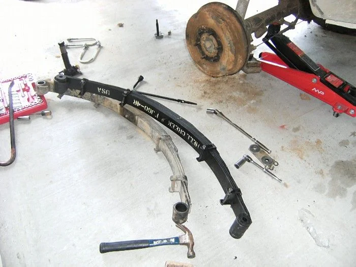

Considering my next option at the moment. If I put the old ones on, will I have to take the whole thing off again to put the anti inversions on tomorrow or can I just lift and secure the axle and then just unbolt the shackle and replace?
I've already sent Tom three emails with pics attached of the progress.
we can just put the shackles on without having to change out the springs.
pretty simple procedure.
