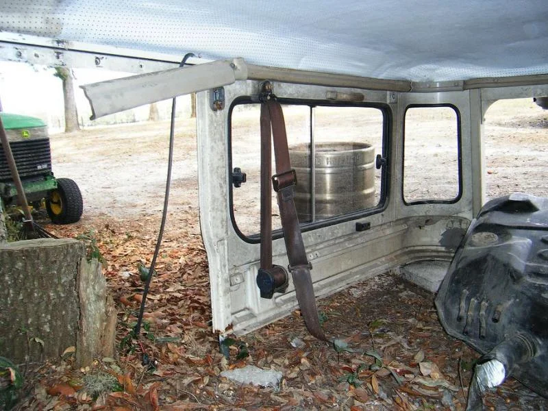

what I need is the inside tracking/ felt rubber on the inside track of my side hardtop sliding windows which is specific to LX models from AUS only

roberto, how did this story ended,
in my bj44V i have the exact same sliding window as the BJ42, also toasted felt window running weatherstripping, did you find a good solution? i know this is a topic more people would be interested in...
thanks in advance, folkert
Australia might be a place where they still might sit on some shelve.. japan is a no go... emailed already a few japanese companies specialized in Toyota JDM parts, and all said, no longer available....
maybe we should set up a "group" buy so we can let it fabricate for a reasonable price... guess enough BJ42, 44 and 46 owners would love to get those...
i have a really fresh example here off one side, seems to be replaced just a few years ago with an OEM one... so thats a good, non dried-out example for duplication...
if more than 10 (?) people show interest, i will go after it...
might be a good idea that someone with a BJ42 can measure its window, to be sure its the same..
most important is the inside measurements of the metal frame where the rubber has to fit into, since the mold will be as long as you like, so overall dimensions is not that important..

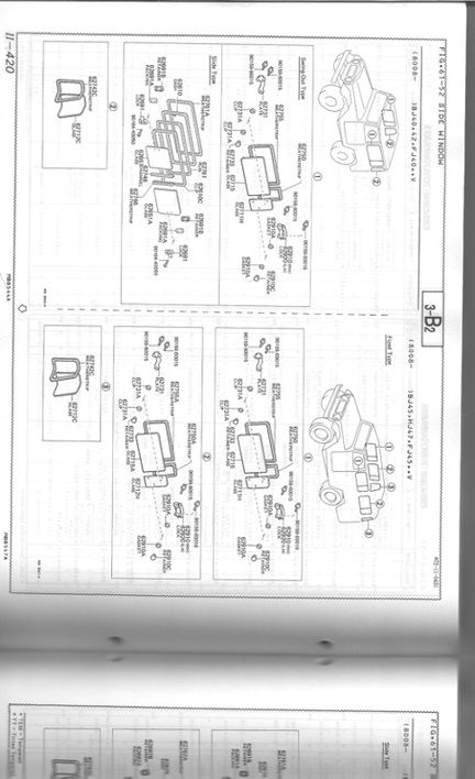

see pic for the weatherstripping we are looking for...
