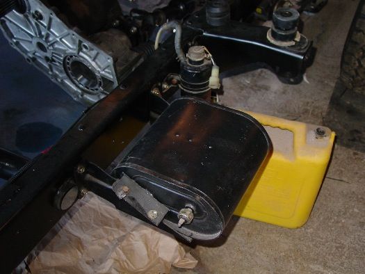

Here's a pic of the fuel tank protector (nicely painted). So I just have to find a way to hold the tank in position while giving me access to re-mount it with the protector plate. Or more likely, I have to disconnect the fuel lines and filler hose and drop the tank and start over. If the glass is half full, I'm the guy telling myself it'll be easier the second time around.... I'm not that guy, the glass is completely empty!
I used the transmission jack the first time, but the one strap is definately harder. I used a longer bolt and three shims. We'll see if I can get it on right today without having to disconnect any of the hoses.
As maybe you can see, I finally got the fuel tank protector plate on with the tank. It wasn't too difficult after all. I didn't have to remove all the hoses and clamps, I just removed one strap off completely and the other one off just partially. Then I was able to squeeze the tank and plate in and get the straps back on and connected. Every day is a small battle, but any victory is sweet! You can see my exit strategy there,,the chain saw!
