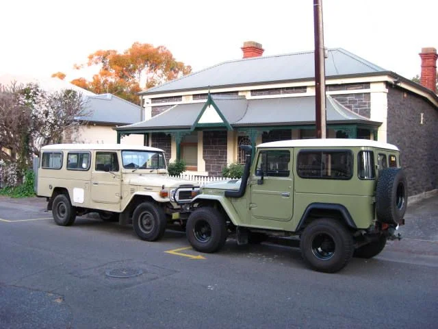

Does you HJ47 have the H41 with the hand brake on back of the split transfer case? Those are rare to find in the US.
Yes, it has the e-brake on the back of the transfer. I want to upgrade to a five speed at some point and the hand brake would probably have be modified at that point.
You can either put your handbrake assembly into the transfer case which comes with your 5 speed (if you buy it used) or build your existing transfer case on to the back of your new 5 speed; you just have to make sure that the back of your existing transfer case has the notches in it to hold the little plastic oiler for the 5th gear. You can use all the transfer case bolts from an 86ish FJ60 with the 4 speed and the faux spacer between the gear box and the transfer case in oder to get the correct length bolts.
Your other option is to get the hand brake backing plates from a 60 series rear axle (or an 81-84 40/42 series) and bolt those on to your axle to have the hand brake on the rear axle. You will need to cut off the two tabs which hold the hand brake cable to the 60 series' axle and weld them to your axle to hold the brake cable, but that is very easily done. You likely already have the female bolt mount on your diff cover to hold the middle of your brake cable. You can then get the hand brake cable from an HJ79 pickup and it should reach just fine. 2manycruisers just did this exact application for his HJ45 with an LX axle.
I like all of Toyota's Cruiser green colours. I will look to see if I can find MJK's rig. My FJ40 LX is the newer light olive green (code 6L4) which I LOVE. If I repaint my HJ47 (not the HJ47 in this photo - that belongs to buckroseau in Mn.), I will paint it 6L4 as well.
