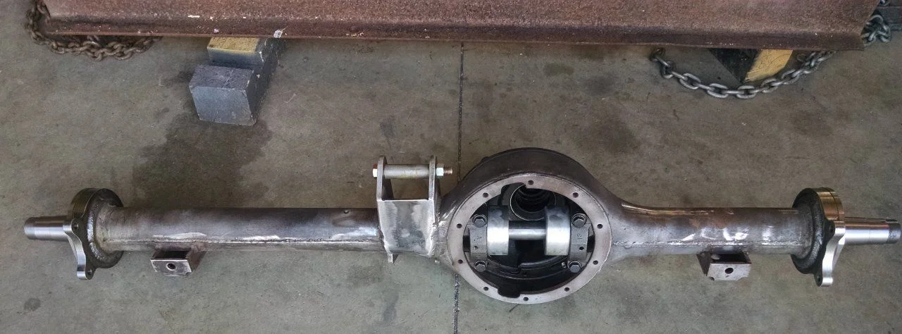

After looking at Lil’john’s traction bar and reading all the comments from and about Georg and Don at Valley Hybrids I decided they have about the best system out there for the antiwrap/traction bar.
I’m no Don but I tried to mimic his mount the best I could from pictures and material I had laying around the shop, time will tell if it works but it’s still stuck to the housing for now and I can start working on the guts to assemble and get my axle measurements.

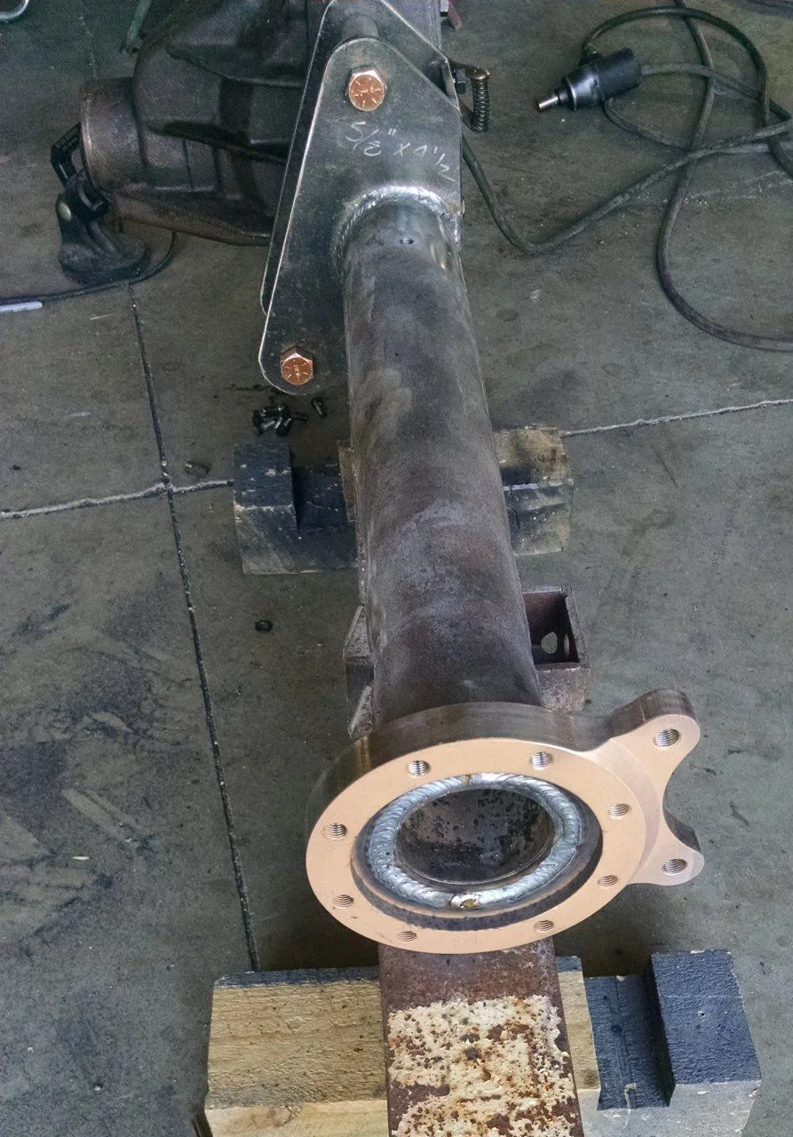

Welded the full floater ends to the housing to make it about 1” wider, I was having some slight rubbing with the 12.5” tires on the inner fenders and this should minimize it and still not push the tires out too far out, after welding the antiwrap/traction bar mount the housing only warped ¼” on the long side that was very easy to straighten with the axle jig, I-beam and portapower.
Ok, let's recap for my benefit. That's a 55 housing with full floater/disc brake flange welded on, right. Didn't have to trim housing down, but will you need to have special size axles made?
Looks very heavy duty, liken it!
Yes stock 55 housing. The flanges were purchased from Ruff Stuff but because of a mix-up they are not the Ruff Stuff flanges I believe they are from Front Range Off-Road Fabrication, I needed to machine the bores to fit were I needed them to go. The chromoly spindles are Trail-Gear. I’m trying to order RCV axles now but may need to settle for Nitro cut to length depending on lead times.
From hub flange to hub flange is 56.250” now or about one inch wider than the total width of the stock 55 rear end , let me know if you need a better description or measurements and I’ll get them for you.
I tried to order a Ruff Stuff housing but they never got back to me with a delivery date so I just cobbled this together and I’ll upgrade later if I need to.

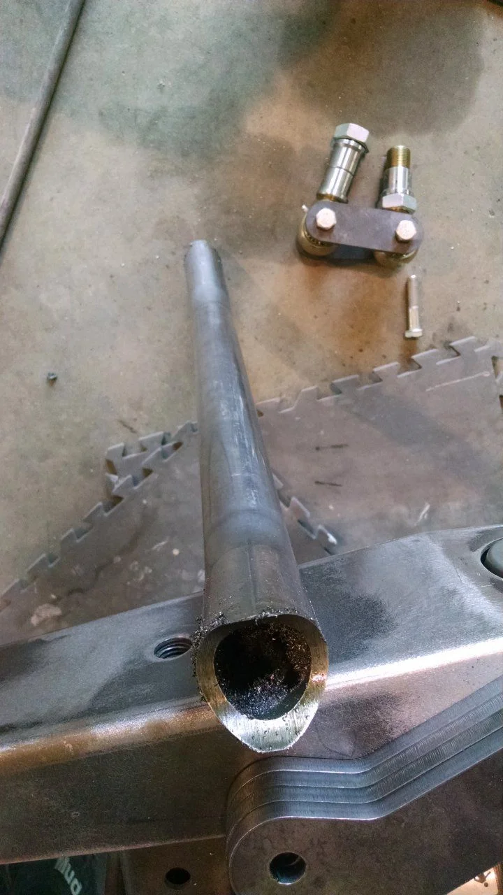

Anti-wrap bar cross member and mounts are tacked together and clamped in about their final location, I still need to make some cross bars to tie the two cross members together and smear some weld on everything in the next couple days.
