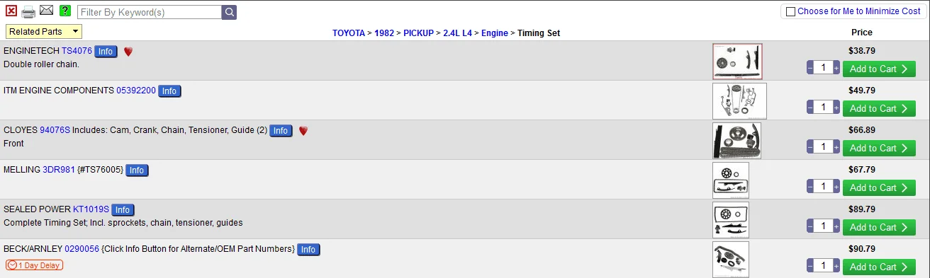

Now I'm planning to replace the timing chain and guides at a bare minimum for obvious reasons. (Considering the dual chain option) Any recommendations from people know the 22re motor better than I?
