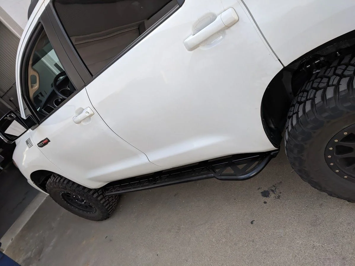

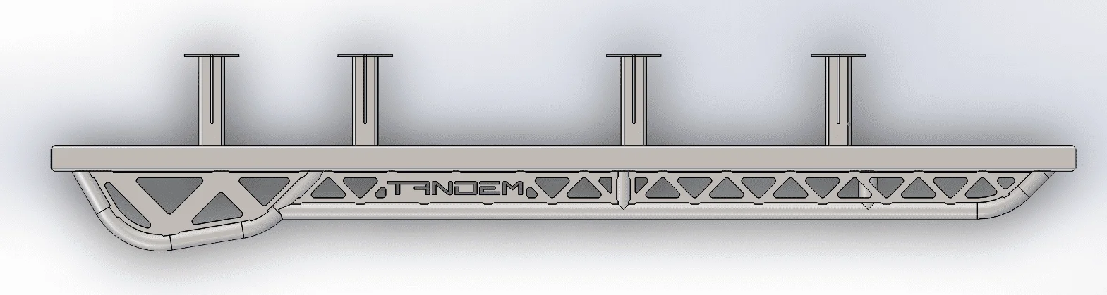

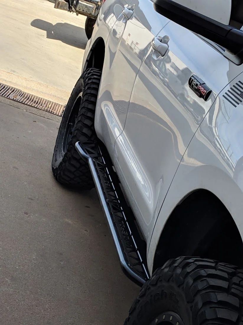

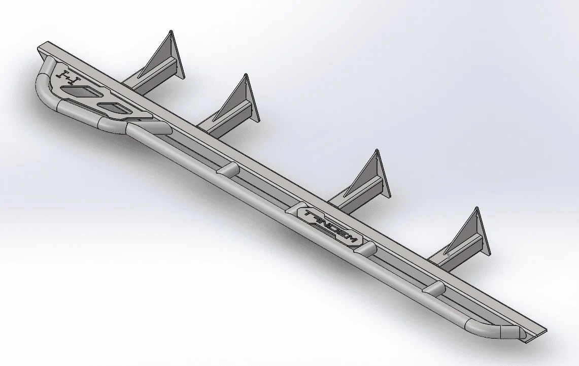

Hello All!
My name is Alex Moreno and I am one of the owners of Tandem Offroad. We are a small shop located in Haltom City, Texas. I had a customer with a Sequoia who SWORE you guys wanted sliders. I drew up some weld on ones for him and I figured since the design is already done I might as well see if there is any interest. I made them as beefy as I possibly could. The spine tube and the stand tubes are made of 3/16" Square Tube steel. The round tube is 1.5" dia. The plates are 3/16" and are shaped like a triangle so that a welder can easily weld the entire perimeter of the plate.

Well, as one of the members here who has sliders on my Tundra Crewmax (so AFAIK a Sequoia slider too - ?????) - your customer was right.
I know for sure 1 other member who did the Slee sliders too - and the IRS of the Sequoia is really pretty cool, and that’s coming from a FZJ80 owner. The G2’s with a 5.7 I could see buying unless a ‘13+ 200 came up for a crazy deal.
Back on topic -
I see the point of all 3 of the sliders you designed the tube & step plates for, but I bet the #2 & #3 would sell best as alot of us use plates in the rear doors/wings for the dogs to get in/out of lifted ‘Yotas.
And plates help so you don’t lose a foot when wet on pure tube.
So the plate in the wing especially would be a help, and for those who like “step sliders” (Slee / Devolro is a step shape) - having the tread plate from the front to the 2nd support arm would be functionally worthwhile esp when you have wet or icey ground or rig so you don’t ‘eat it’ & slip off the slider.
My dog has “grip tape” on the tube near his door, otherwise he’d slip & go nose-to-dirt every time he exits. He’s not smart, but the tube is slick when wet.
Just my opinion based on use / lifted ‘Yotas.

Thats awesome input! Adding the grip tape should be a relatively easy endeavor for sure. Keep 'em coming!
Have you considered added sleeves for the frame and scab plates? I haven’t looked at mine closely, but I’d probably want to make them bolt on.
I was under the Sequoia for quite a while trying to find a way to make the sliders bolt on but I could not find a solution that I felt comfortable with given the heft of the vehicle. When I get a chance I will revisit the possibility of making a bolt on option. The bottom of the Sequoia is surprisingly tightly packed!

We can do powdercoated if you wish! I'll send you a PM with a price. Weld time is approximately 1-2 hours. The Sequoia frame is relatively straight and free of any obstructions so the shop will have to grind off the factory paint, in the sections where the stand tubes will be welded. We actually went out of our way to design a plate that is ideal for the welders to weld on. Its shaped like a triangle which allows the welder to weld the bottom easily then reach both sides of the weld plates so the plates can be completely welded.
Thanks Mexellent. Do you have any more photos of the install--welds, alignment/position? Are they designed to sit flat or angled up? And, have you put the weight of the Sequoia on them (using a jack or otherwise)? Look forward to the powder coat price quote PM, and any other finishing options. Thanks again!
These look great! My only concern is the width of the step. I've read that the factory step is narrow and can be difficult to step on and potentially bang your foot into the panel. Would that be a concern with these bars? Any news on the step holding up the weight of the vehicle?
