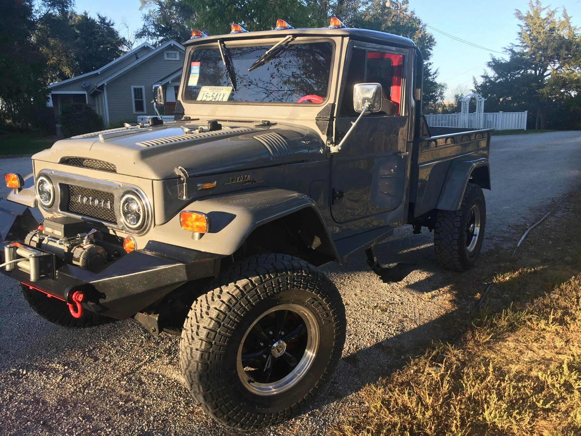

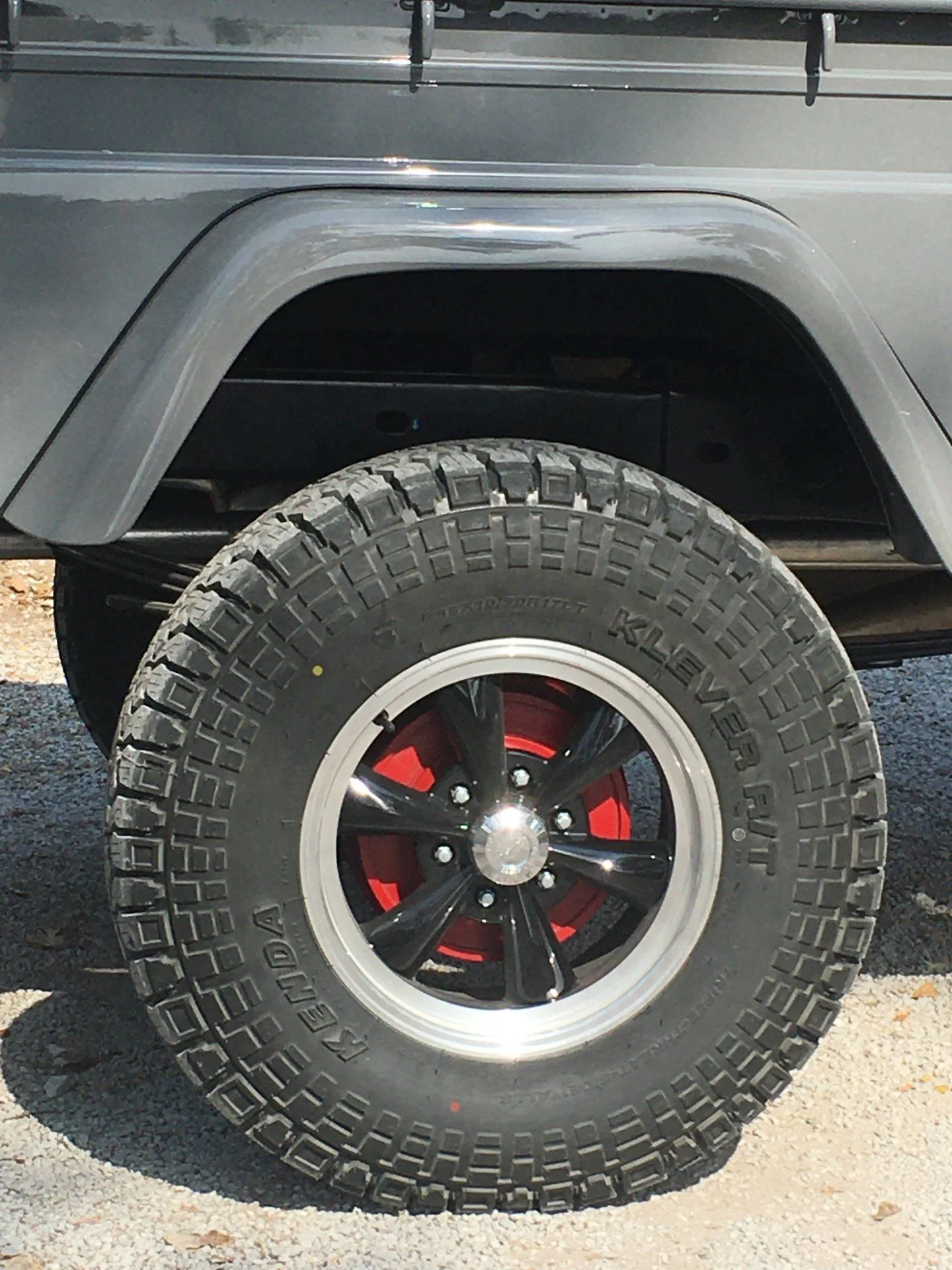

Understood. I have the Kenda Klever RT 35x10.5 R 17 (P/N 601015). They make a 33x10.5 R 17. I used 4Runner 17x7 spare rims and got the tires from walmart back in March (?) when they were on sale for $130 ea. Too good a price not to try them. Mostly the price bounces from 175-200. I just put them on the troopy 2 weeks ago and I like the tire so far- I have spent about 14 hours driving on I40 with them and it is a complete game changer from the MTs on the highway. No off road use yet but they get pretty good reviews from the Taco crew. Definitely, no where near aggressive as your tires, but seem to be a good all around one.
Here's their complete "rough terrain" line.
So far, I concur...I am jealous that I never paid the low $130 (a piece) price for mine... :bang: Noise wise, the Kenda’s are a fine choice ! 👍🏻
Triple ply sidewalls too...
For a 200, I’m looking at 34” or 35”. Example 35x10.5x17(35”) or 275/80r17 (34”) or 34x10x17
Currently on 275/80r18 (35”)
Oh wheel. Yeah 17x7 or 17x8. On a 200 35mm offset. 5x150 pattern 110mm hub
@alphaequipt
A true bead lock would be amazing

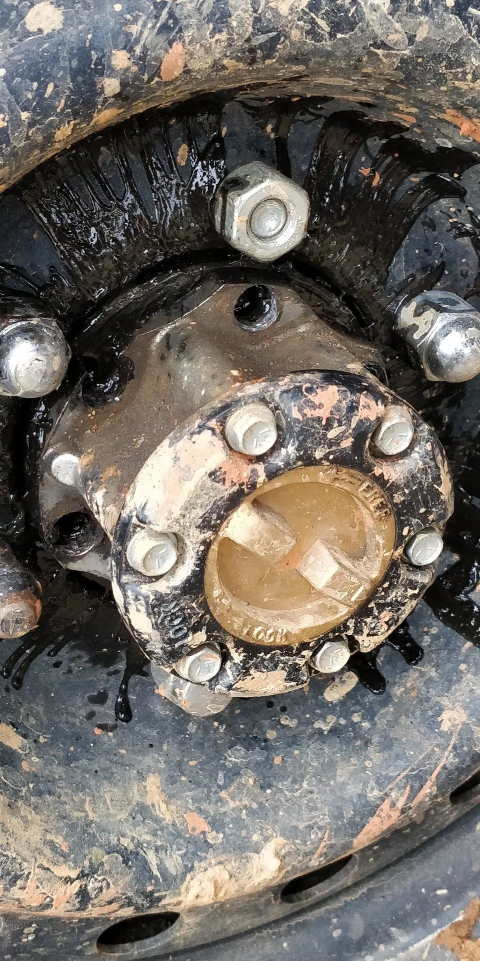

Did uwharrie in the rain last night and today. Lots of slick red clay on the rocks and a few hills. I went up the hill in the picture last night without any real issue. Today a number of jeeps with big wide tires were coming down the hill claiming it was extremely difficult and good luck. I tried to get up the hill but couldn't make it. I felt my skinny 32x8 extra grips had met their match.. as it turns somehow all of the studs holding my right front locking hub on snapped and broke off. My hub was spinning but the wheel was not. Did not know this it happened till I got back out to the road to unlock the hubs. So I was trying to climb up the hill with only three wheels pulling.

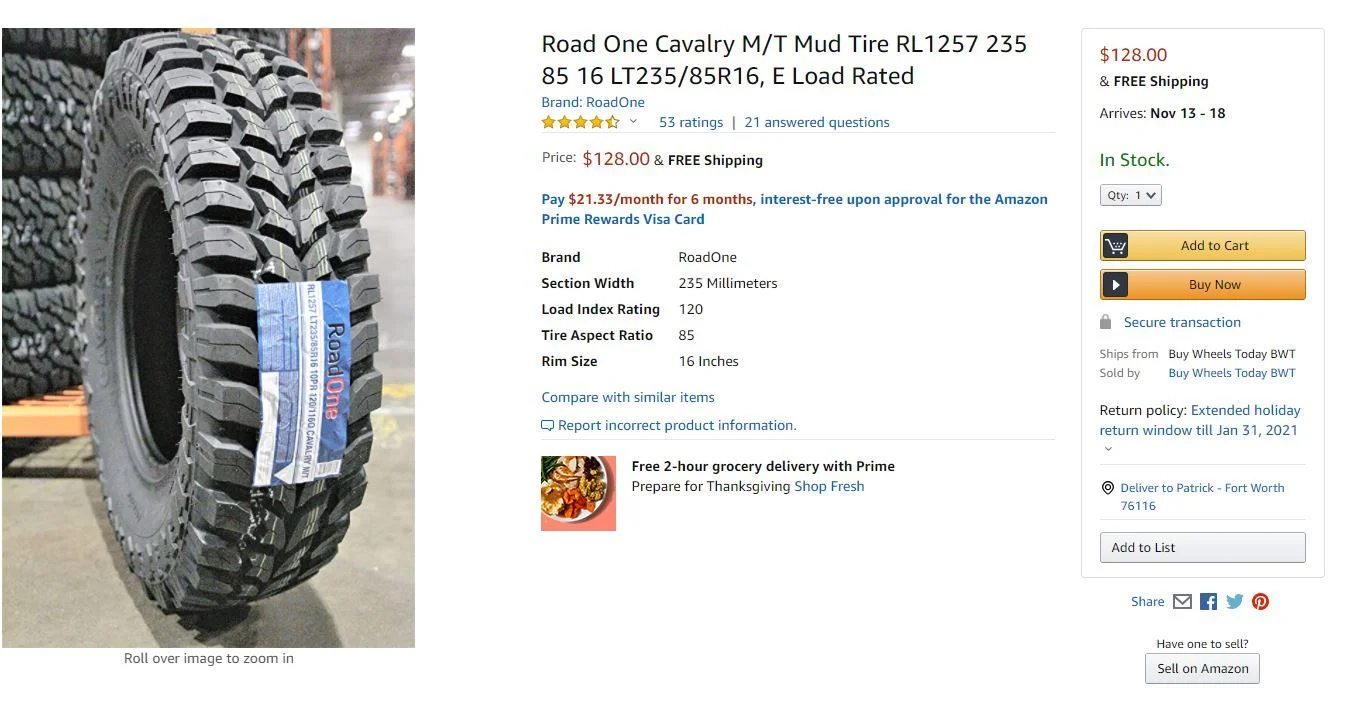

Item specifics
Condition:NewTire Type:Off Road
Load Range:Load Range E (10-Ply Rated)Section Width:235
UTQG:--Aspect Ratio:85
Measuring Rim Width:6.50"Rim Diameter:16
Max Load:3040 lbs @ 80 psiLoad Index:120
Sidewall:BlackwallSpeed Index:Q
Rim Width Range:6.00" - 7.50"Overall Diameter:31.7"
Weight:51 lbsTread Depth:17.30/32"
Manufacturer Part Number:RL1257Brand:Cavalry
Rebate Available:NoCar Type:Truck/SUV
Quantity:4Overall Width:9.30"
UPC:814342026860
These are Chinese made tires. I'd spend a few extra bucks and look elsewhere.
I agree with you **** CHINA!
Never a top choice of mine but the subject is Tall Skinny and I had not seen these before so I post them.
